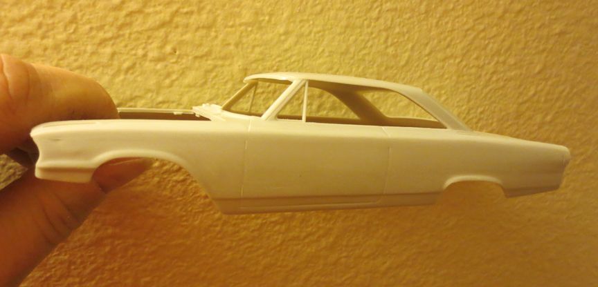

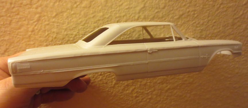

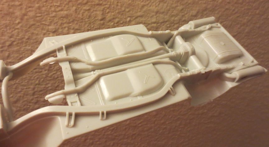

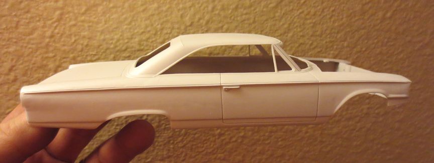

gasser59 Posted November 7, 2013 Author Share Posted November 7, 2013 OK, here's a photo update with a bit of narration. Here's the side of the original body where I've started to remove the trim. Well I got carried away and realized too late that I trimmed off too much of the upper lip. In fact, I completely took it off. Looks really bad. Had to purchase another kit and was a bit more careful on this one. This is shown with a coat of Tamiya white primer. Here's a shot of the original kit chassis. Everything's molded in and I just can't work with this. Stay tuned for more. Quote Link to comment Share on other sites More sharing options...

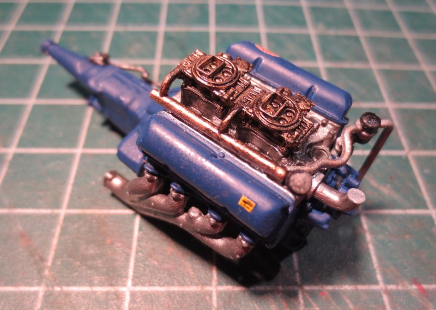

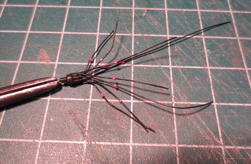

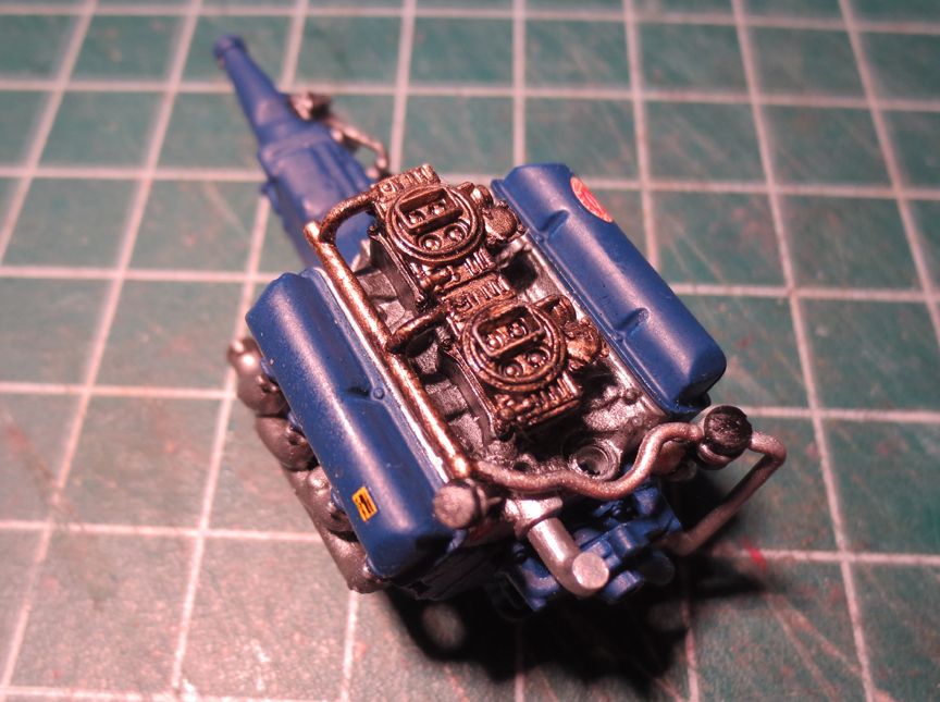

gasser59 Posted November 11, 2013 Author Share Posted November 11, 2013 (edited) Been working on the engine and have most of it done. Distributor is wired up and will be put in soon once the glue on wires dries. Here's the distributor wired along with the red spark plug boots. Here's a couple shots of the engine. Thanks for your interest and as always, comments welcome. Edited November 11, 2013 by gasser59 Quote Link to comment Share on other sites More sharing options...

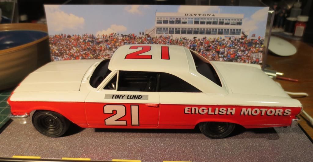

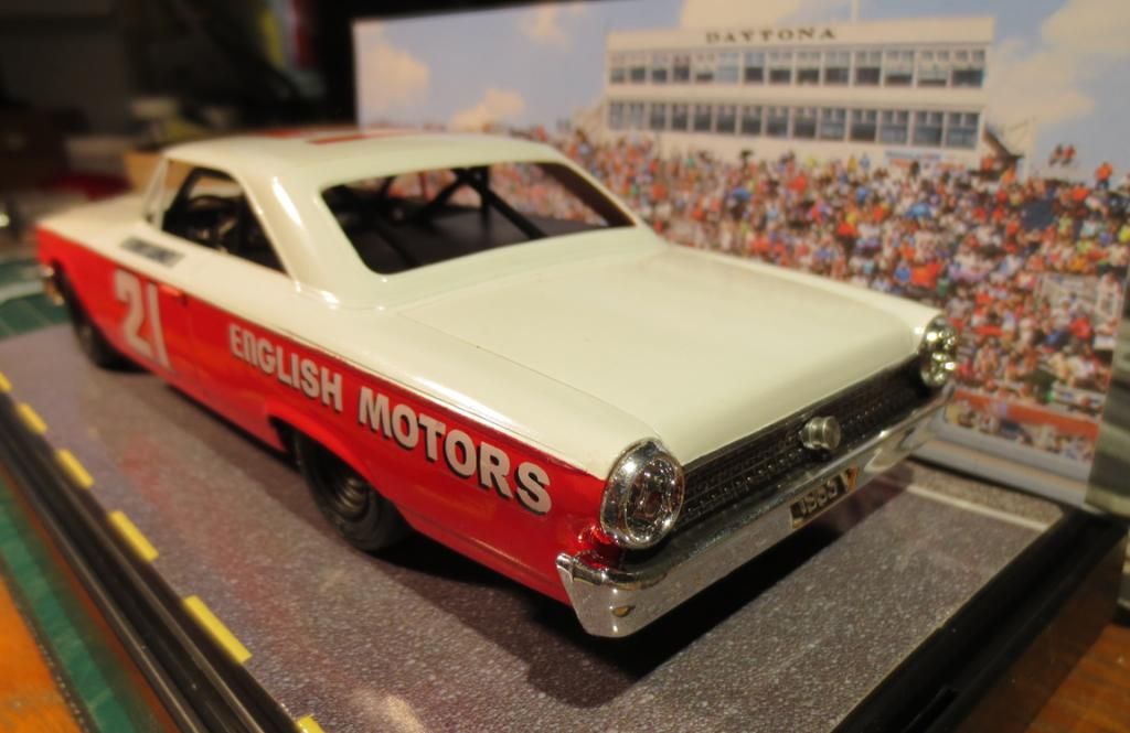

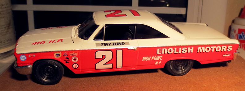

gasser59 Posted December 16, 2013 Author Share Posted December 16, 2013 (edited) Although I haven't updated this build in awhile, I've been working on it steadily. It is now painted and the decals have started to go on. A bit more to do like the head and tail light covers, roll bar padding, BMF the body / trim and a few incidentals. I bought the display case yesterday and created a Daytona crowd backdrop. This is the Revell one. I'll replace the supplied roadway surface for some black fine grit sandpaper. Tiny's name was written on a piece of duct tape covering the original Marvin Paunch name on each door. I've replicated that with the decals. Gas filler neck is sticking out the rear grill work and was fabricated with aluminum tubing and rod. Now for some photos. Comments welcome. Thanks for your interest and following along. Edited December 16, 2013 by gasser59 Quote Link to comment Share on other sites More sharing options...
Mooneyzs Posted December 16, 2013 Share Posted December 16, 2013 Brad.... killer work my friend. That looks amazing. Now time for a 1/16th scale build Quote Link to comment Share on other sites More sharing options...

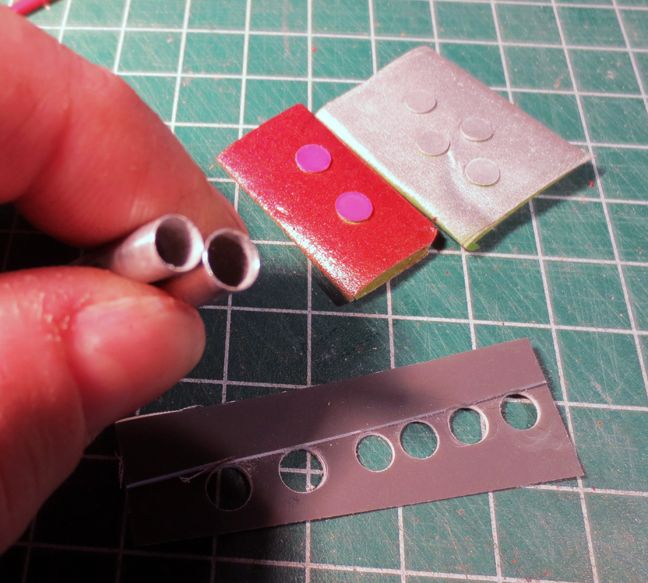

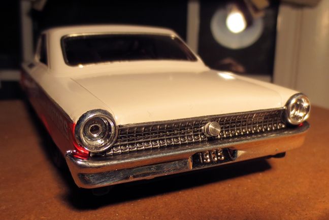

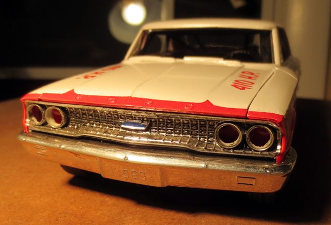

gasser59 Posted December 18, 2013 Author Share Posted December 18, 2013 (edited) Got some foil put on last night and figured out a way to make the headlight and taillight covers. I took an appropriate size diameter of a section of aluminum tubing and thinned out the inside lip to make a sharp edge. I then put it in my drill and used it as a hollow drill bit through some thin styrene. Worked out quite well. They got a coat of paint and hopefully will be applied tonight. Still a bit more foiling to do plus the straps on the rear windows. Here's a couple of photos. That's all for now. Thanks for your interest and comments welcome. Edited December 18, 2013 by gasser59 Quote Link to comment Share on other sites More sharing options...
james460 Posted December 18, 2013 Share Posted December 18, 2013 nice work. You did ask for comments so I'll give you a couple. The stock tail light lens were in place at the Daytona 500. And the little red scallopes that are on the hood are also over the tailights. Great job. Quote Link to comment Share on other sites More sharing options...
gasser59 Posted December 18, 2013 Author Share Posted December 18, 2013 (edited) Thanks for the info James. I found out about the red scallops on the rear after I painted the car and still deciding if I want to paint them on. Funny I never noticed them when I was watching a promo video of the race from Autolite and Firestone that I bought online. The kit red taillight lens looked funny to me and I have other uses for them so I painted the new cutouts the same red as the body too see how they look in the rear chrome bumper piece. I'll know more tonight. Thanks again. Here's a pic of the tubing for drilling the round disks. Sorry the picture is a little blurry. Although it doesn't look like it, the red disks are the same color as the red on the body. Thanks for following along. Edited December 18, 2013 by gasser59 Quote Link to comment Share on other sites More sharing options...
james460 Posted December 18, 2013 Share Posted December 18, 2013 (edited) I've been wanting to build that car for a long time. Taping off the scallopes for the front and rear have kept me from painting the body. I even thought about using decals cut in the scalope shape and painted red to achieve the look. There is an article in both Model Cars and SA that tells how to use the new AMT 60 chassie with the interior bucket from the AMT Galaxie. Take a little effort but I figure the reslts will be worth it. If I remember correctly the tail lights have a chrome piece that fits over them in the stock application. May come in the kit. Just can't remember. Anyway your the Lund Galaxie looks really nice. Keep up the good work. Edited December 18, 2013 by james460 Quote Link to comment Share on other sites More sharing options...
