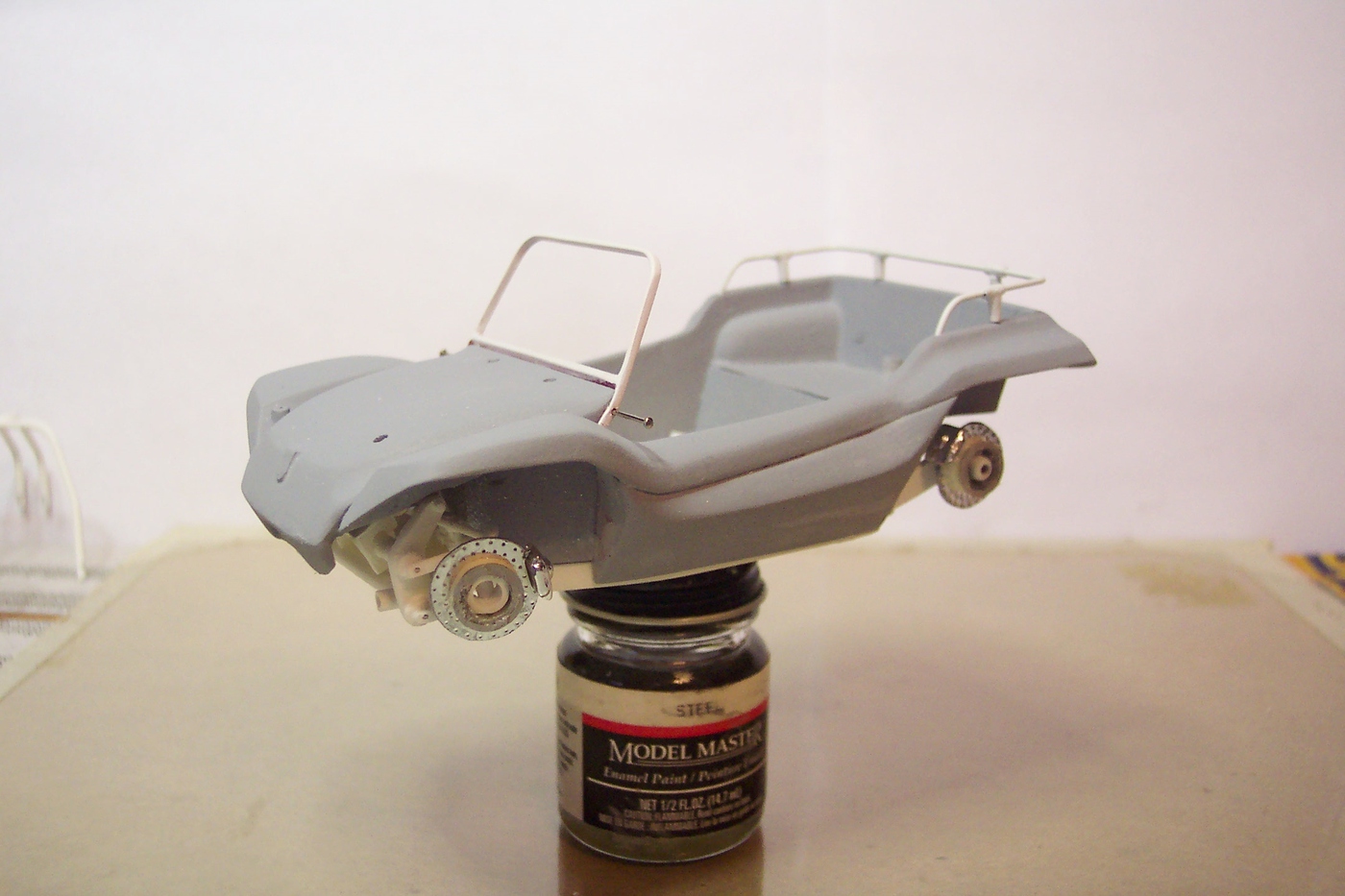

Here's the body in primer with side pods I made first with modeling clay and then cast in resin . The railing around the rear is brass rod and tubing . I also thinned the windshield frame to look more realistic .
9

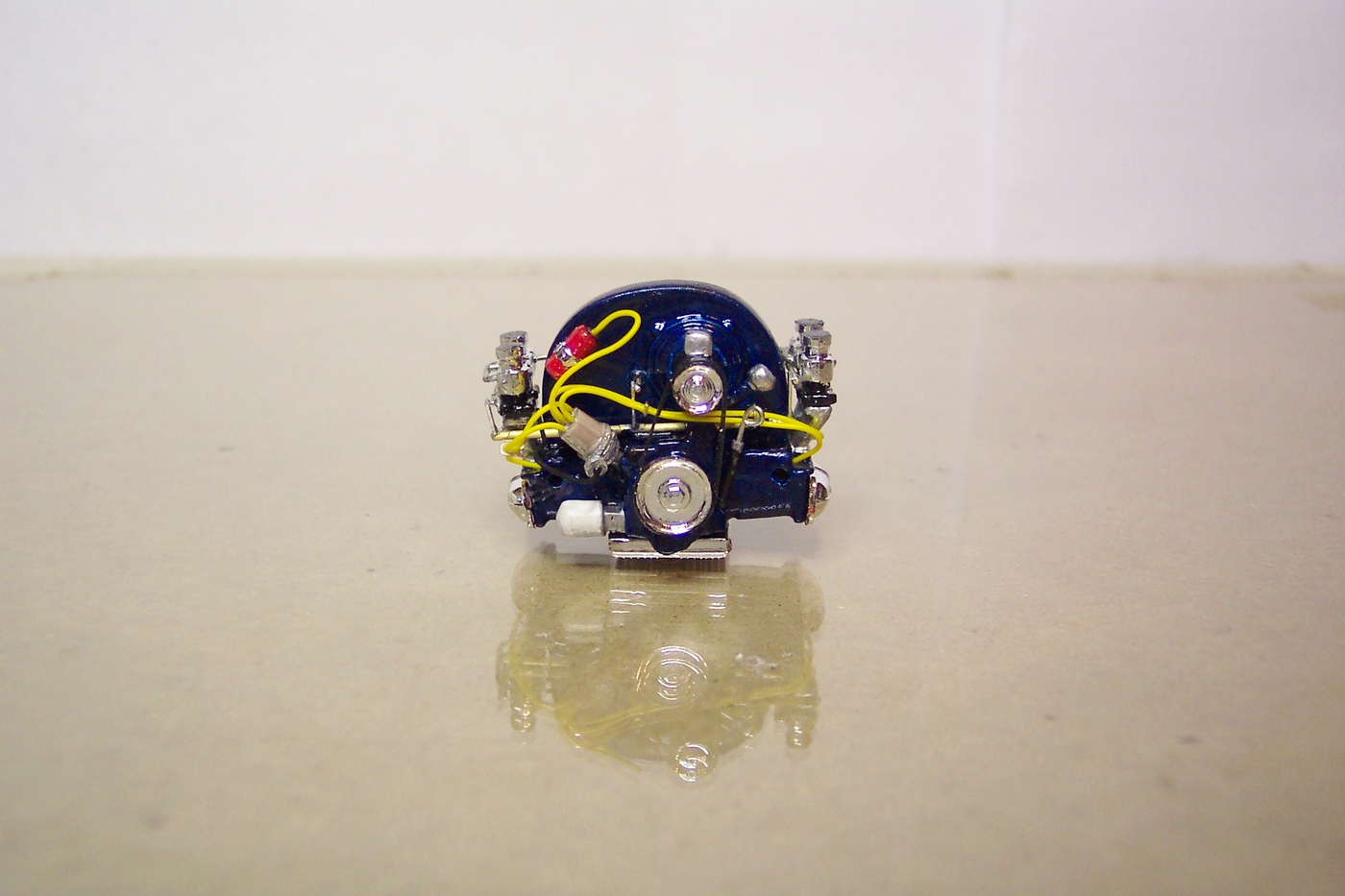

Power is the kit engine with some carbs from my parts box . I made the intakes out of tubing and added linkage and fuel lines . I also made the oil filter and dipstick . The distributor is from M.A.D.
25
Edited by TooOld

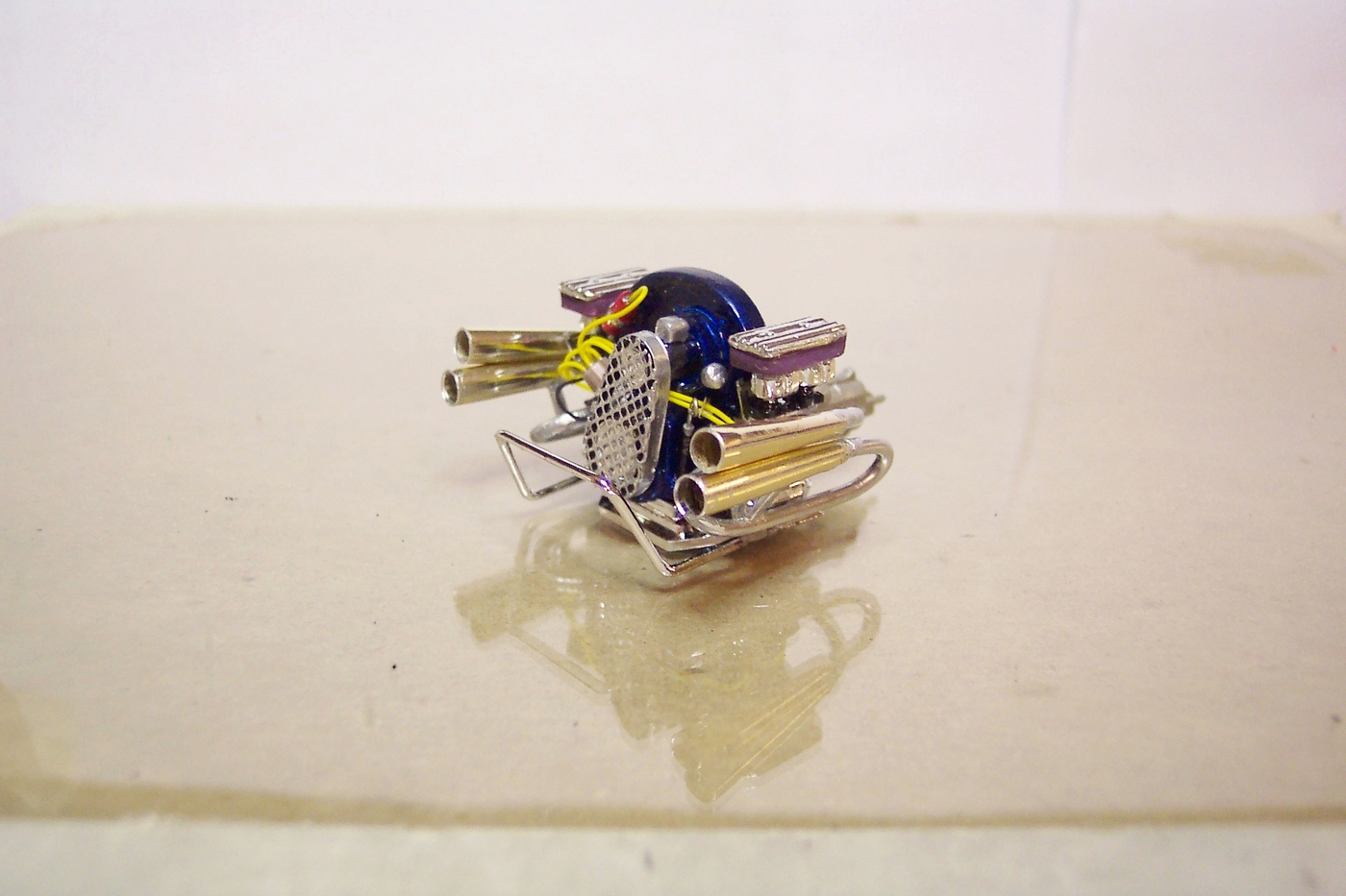

This is the finished engine . The exhaust was made using styrene rod and the ends from some paint brushes . The belt guard is a piece of splatter screen ( used for frying ) wrapped with a strip of aluminum from a soda can . Air filters were shaped from rectangular styrene .
28
29
30

Very nice detail Bob with all the custom and personal touches. Love those crome extentions/tips..
Thanks Carl !
I ruined a few figuring out how to get the paint brushes apart !
Edited by TooOld
