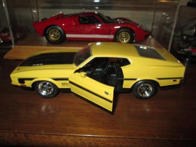

Let's see more of the Ferrari in the '71 Mach 1 link please. Your builds have a very clean style, I am particularly impressed with the paint finish, not over glossy, very authentic scale representation of finish. Very impressive. I want to see more.
Thanks again everyone for your kind words :)
David, I posted a new topic with the Ferrari build. I Hope you like this one too.
Regarding paint finish, in all but the 1971 Mach1, I have been using two part polyurethane clear coats. The 330P4 was my fist try and the BMW M Coupe was the second, were I managed to obtain a candy like glossy surface without orange peel. In fact I found it too glossy so i rubed it down with Gunze fine compound. As it is a very fine abrasive, it toned the gloss down a notch, enough for me to be happy with the result. I decided not to use super-fine compound or finishing wax in my next car builds.
In the 1971 Mach1 instead of the two part gloss coat I used Microscale Microgloss acrylic clear coat (that never gets as glossy as the urethanes) followed with gunze fine compound, to obtain a very similar result as with the two parts urethanes. However, the Microgloss clear coat is not as hard and tolerates a lot less handling of the body during the last stages of the buld. Urethanes are almost rock hard. Hope this helps!
