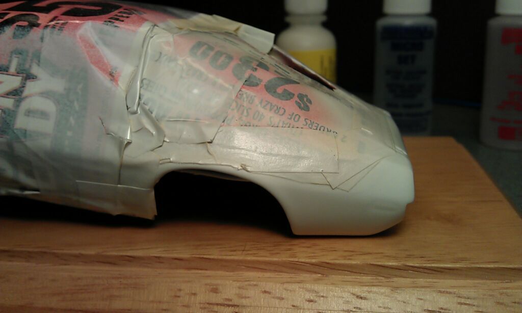

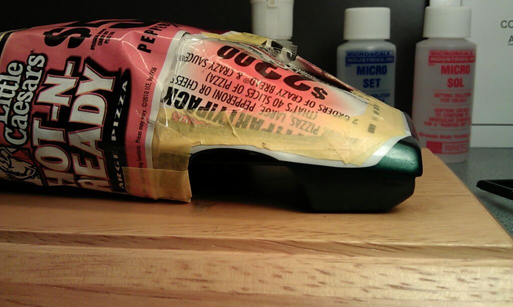

formula1129 Posted April 27, 2014 Posted April 27, 2014 The bike, the plane, and the Tank are all great guys!!! I got a wrench in my spokes on my Camaro. I thought I was almost done with the paint on the body, but something didn't look right with the back quarters, so I looked at a few pics of the 1:1's and there it was. The decals that come with the model are not complete, and they instruct the builder to paint below the decals, and somehow blend the paint into the decal, so it looks like part of the decal. Huh? I sure hope I bought the right color white. All masked up to try to blend the white paint with the decal. And a quick pic with it's first coat of white on the rear quarters. Another couple of coats, wet sanding, and more clear, and hoping the white paint blends with the decals.

mustang1989 Posted April 28, 2014 Author Posted April 28, 2014 (edited) Ben:Whew! Bet you're glad you spotted that in this stage of the build!! Lookin' forward to see how it all blends together. Fingers crossed!!!! Wayne:Glad you're back buddy!!!! This outta be just awesome to watch you build! I'll get you in the intro post!! Edit (just a few minutes later) You're added!! Edited April 28, 2014 by mustang1989

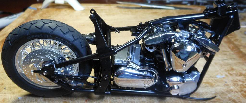

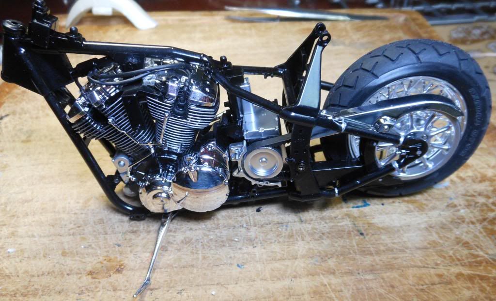

mustang1989 Posted April 29, 2014 Author Posted April 29, 2014 (edited) You see guys! There he goes again building that real bike in his living room floor on that sheet of plywood!! lol Man that's really looking good Mark!!! Awesome paint and detail on this one!!! Edited April 29, 2014 by mustang1989

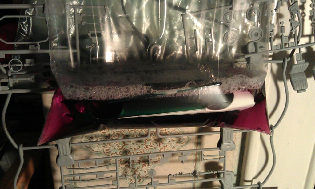

formula1129 Posted April 30, 2014 Posted April 30, 2014 I hate to say it guys, but....... Plus this............ Equals this....
mustang1989 Posted May 1, 2014 Author Posted May 1, 2014 Hey Ben I didn't get that last pic. It didn't melt the plastic did it?????????????????????????
formula1129 Posted May 1, 2014 Posted May 1, 2014 Hey Ben I didn't get that last pic. It didn't melt the plastic did it????????????????????????? So sorry Joe, didn't mean to give ya a heart attack. No, that is a pic of a paint stripped Camaro that I got off the net. Here is mine taking a Purple bath. Good news though. I have passed the depression stage of having to do this. I just convinced myself that I could have done better getting the paint flat, so it's OK now. LOL
mustang1989 Posted May 2, 2014 Author Posted May 2, 2014 It had to hurt to have to do that but am really looking forward to what youre going to do next.

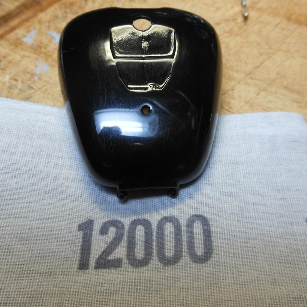

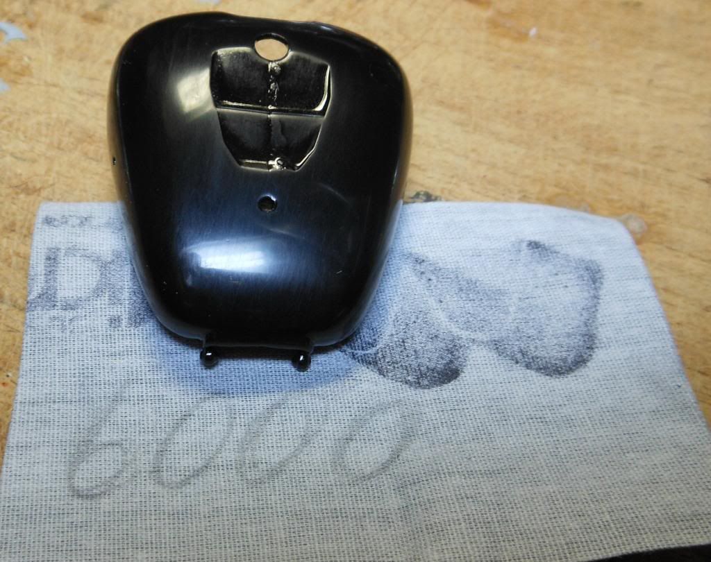

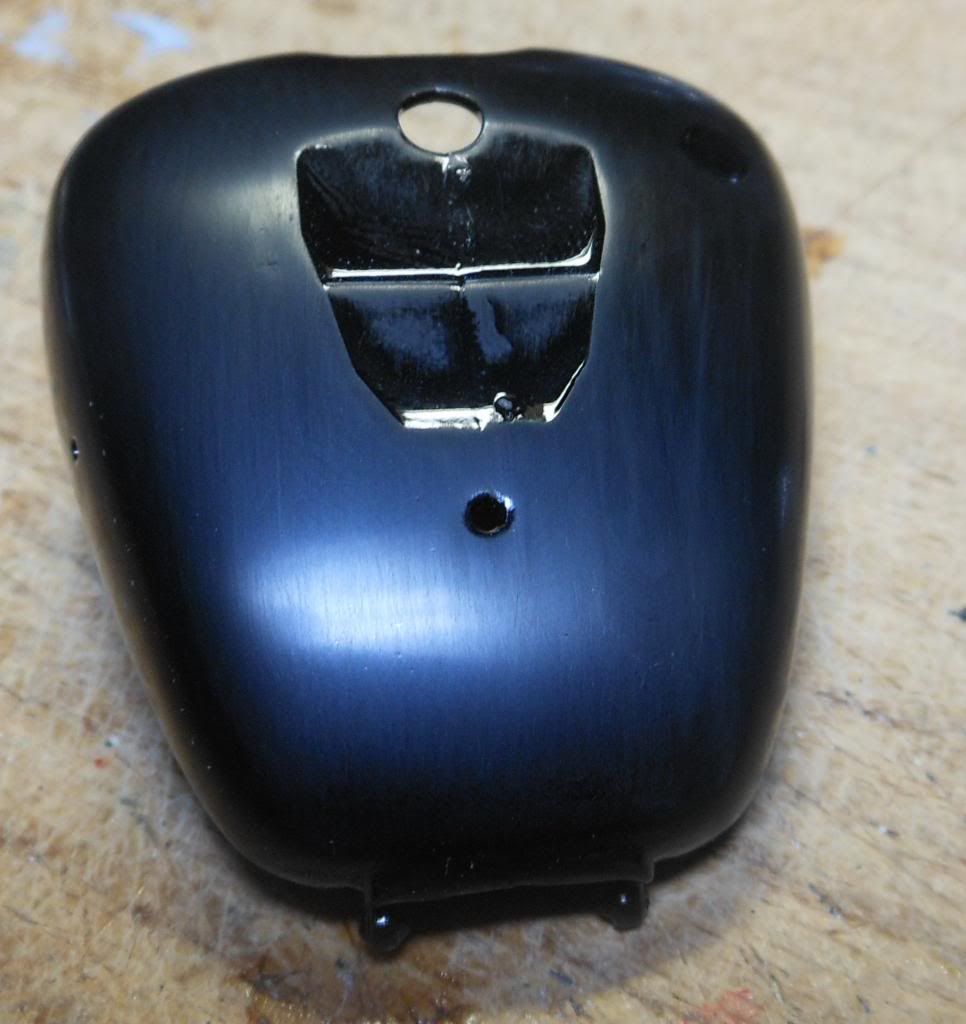

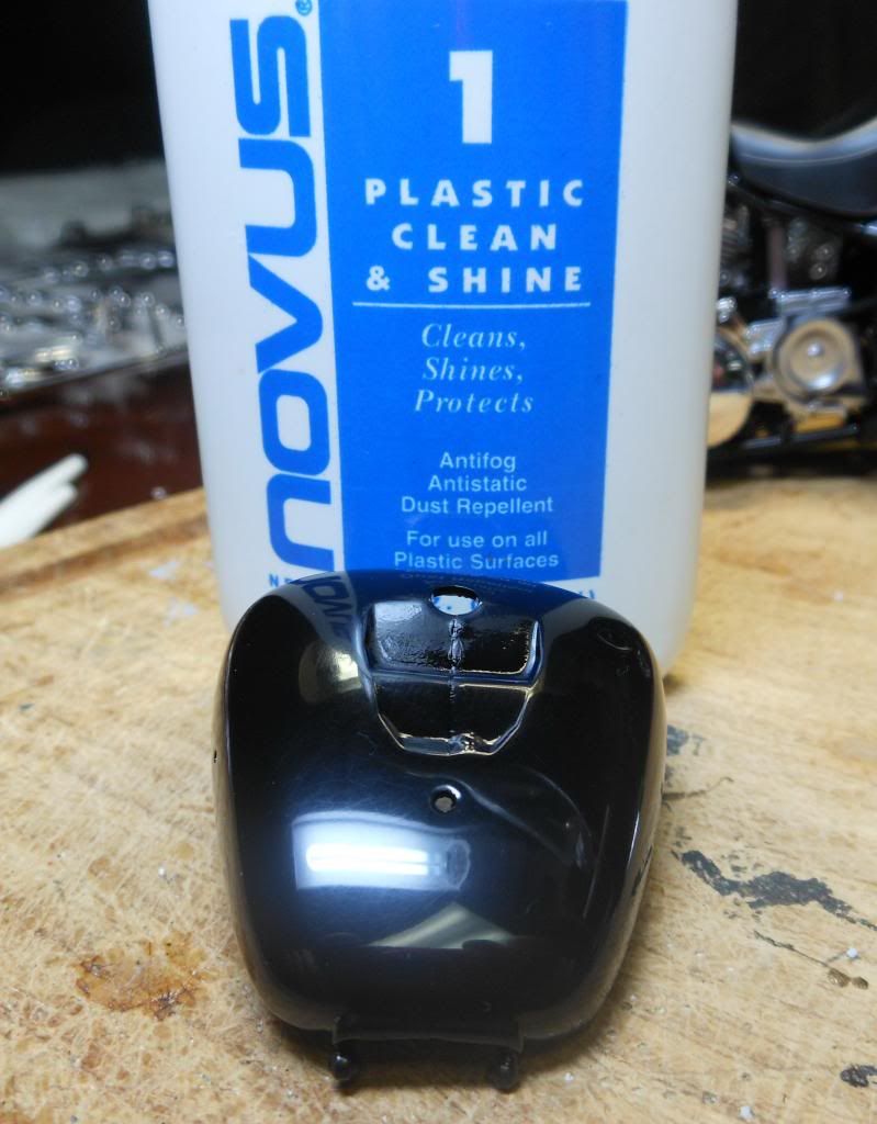

HNTR Posted May 2, 2014 Posted May 2, 2014 You guys are doing GREAT work!!!!! And to take off that beautiful paint job, I couldn't do it. Just to show a little more progress, I painted some fenders and the gas tank. I have some pics of the gas tank showing what I use to try to get the paint shiny. Never had luck with anything but sandpaper. I use to never do anything cause I had a hard time scuffing up a paint job that was always so/so, until I tried the sand paper. I start with 3200 or 3600 and work my way up. Here are some pics of the progress- 3600 4000
mustang1989 Posted May 3, 2014 Author Posted May 3, 2014 (edited) Now THATS a smooth finish! I just picked up some sandpaper/ polishing squares yesterday by chance and I saw this post afterwards. Man am I glad I did!! Good job on this Mark! Edited May 3, 2014 by mustang1989
Agent G Posted May 4, 2014 Posted May 4, 2014 That gas tank is glowing! Great job. Looking forward to seeing more of the Stuka also. G
