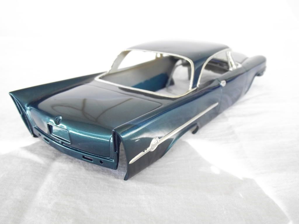

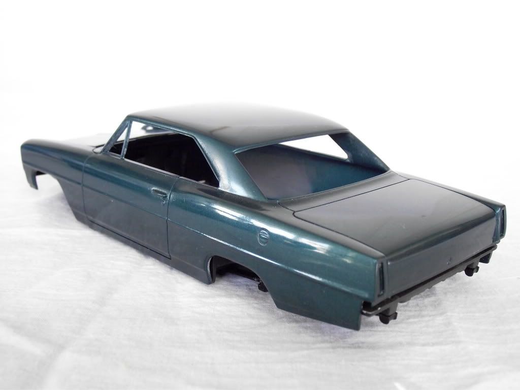

Quick GMC Posted December 23, 2013 Share Posted December 23, 2013 I laid down a pretty nice paint job, only to come back and find a ton of dust in the paint. I painted two bodies in two days, one perfect, and one full of dust. This is airbrushed enamel, no clear coat. i was thinking I could sand it down so the texture is smooth, then clear coat over it, or do more color coats. The thing I'm afraid of is it took 4 coats of color to cover evenly. I think I might sand through the paint. The other body I painted is a basecoat with clear. No dust. Both painted in the same spot 24 hours apart. I'm not sure what happened. My wife may have had the fan on in the room or something. I usually leave the fan off for 2-3 hours before painting. We live in the desert so there is always the chance of dust in the air. the dust you see in the picture is in the paint. Quote Link to comment Share on other sites More sharing options...

Ace-Garageguy Posted December 23, 2013 Share Posted December 23, 2013 (edited) That's a heartbreaker. It looks like you did an outstanding job of laying out a beautiful gloss. To come back and find dust stuck in a surface that nice can ruin your day. The problem with "polishing" first is that it won't remove dust that's actually embedded in the paint, but just ride over it and make shiny raised spots where the dust was. If you think about the mechanics of what you're trying to achieve, what you want is something that will 'cut' the dust flat, level with the surrounding surface. THEN polish to bring the gloss back up. How you approach the problem depends on how deeply the dust is embedded into the surface. It LOOKS like most of it is on the very surface and hasn't sunk in, except for one spot in the left rear corner of the roof. For the deeply-embedded particles, this method works best for me: Sanding pads that are stiff but not hard. The fairly stiff foam backing allows them to cut the dust mote while minimizing removal of material around it. Sandpaper with no backing tends to go through the paint AROUND the dust particle faster than it cuts the dust flat. Start with the 2400 grit using just the corner held flat against the work, and use PLENTY of water with a drop or 2 of detergent in it to help keep the grit clear. Go slow, work with plenty of light (and magnification if you need it), look at your surface frequently, and as soon as you see the mote is gone, STOP. You have 2 options at this point. 1) Add more coats of paint or clear, OR 2) Sand and polish what's there. Option2: Go to finer and finer grit pads progressively. By the time you get to 12,000, your gloss will be almost all the way back. At this point, polish to bring the gloss all the way back up. Your surface should be flat, clear of orange peel and dust, and perfectly glossy. THEN, put a bright light on it to see if you've gone through or if the color is getting thin. If it is, you'll have to scuff it overall and add more coats of paint. IF, ON THE OTHER HAND, the dust is only on the VERY surface and hasn't got down into the paint, a quick polish MIGHT knock it off, and then a light scuffing and a clear-coat as Niko suggests may be the hot setup. Be sure to pay attention to the "recoat window" with enamels. They'll wrinkle sometimes if you rush them. Edited December 23, 2013 by Ace-Garageguy Quote Link to comment Share on other sites More sharing options...

Quick GMC Posted December 23, 2013 Author Share Posted December 23, 2013 Bill, that's great. Thank you very much. I actually have those polishing pads at home. I think the lowest I have is 3600 which should be good enough. I have had it in a dehydrator on and off. I'll put it back in and give it a few days. Thanks for the help. If I can just get the texture cut flat and smooth without going through the paint, i think I can save it. Quote Link to comment Share on other sites More sharing options...

Quick GMC Posted December 23, 2013 Author Share Posted December 23, 2013 I am airbrushing with Scale Finishes enamel. The other body I did with a basecoat and clear was flawless. It's weird. Quote Link to comment Share on other sites More sharing options...

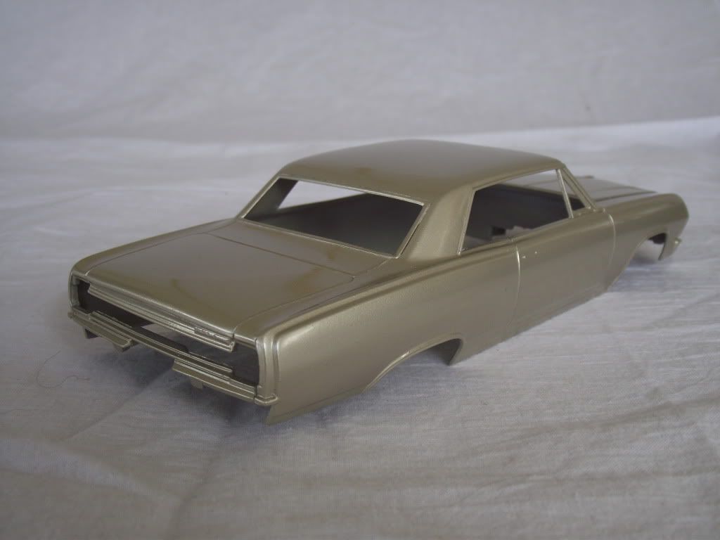

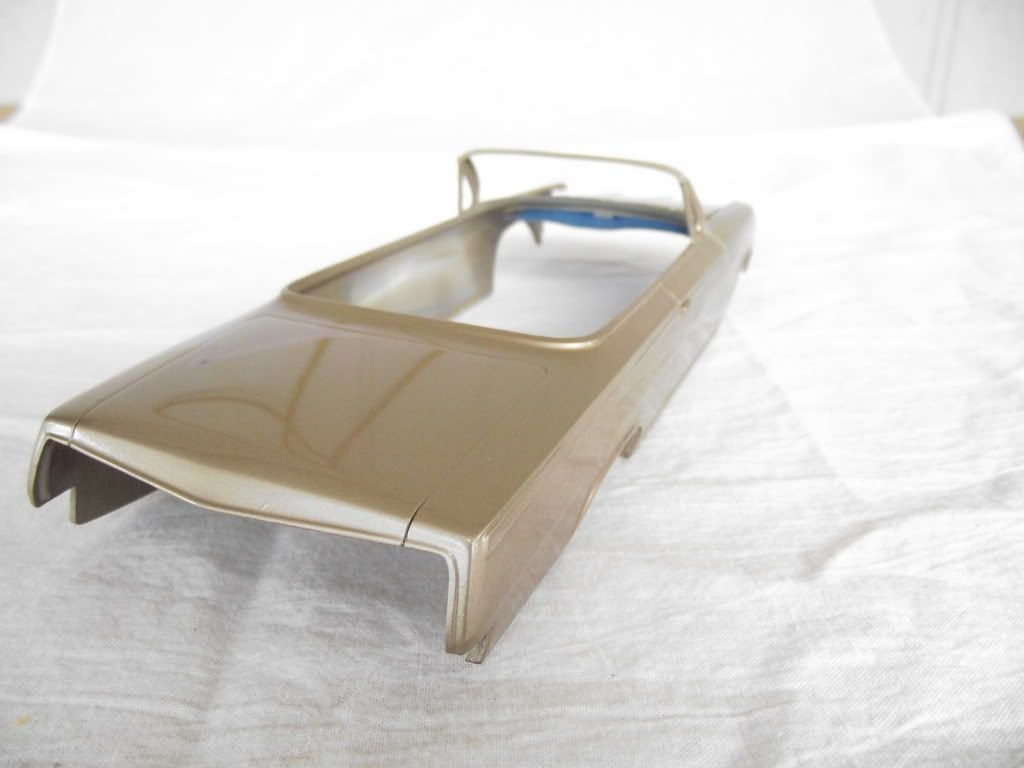

Mike Kucaba Posted December 24, 2013 Share Posted December 24, 2013 Quote Link to comment Share on other sites More sharing options...
Mike Kucaba Posted December 24, 2013 Share Posted December 24, 2013 Those were all painted about 10 years ago. Quote Link to comment Share on other sites More sharing options...
