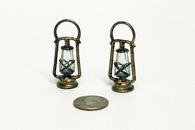

Harry P. Posted January 3, 2014 Posted January 3, 2014 I use a mixture of Future and acrylic black craft paint. Can't give you an exact ratio, it depends on what you're washing and how obvious you want the effect to be. The models in these photos have all had the Future/acrylic black wash applied in many places... Rear wheels, front wheels, "brass" parts, bolt heads...pretty much everywhere: Lanterns sprayed Rustoleum Metallic Brass, then blackwashed: Wheel backs, springs, headlight mounting hardware... again, pretty much everywhere: On all the engine:

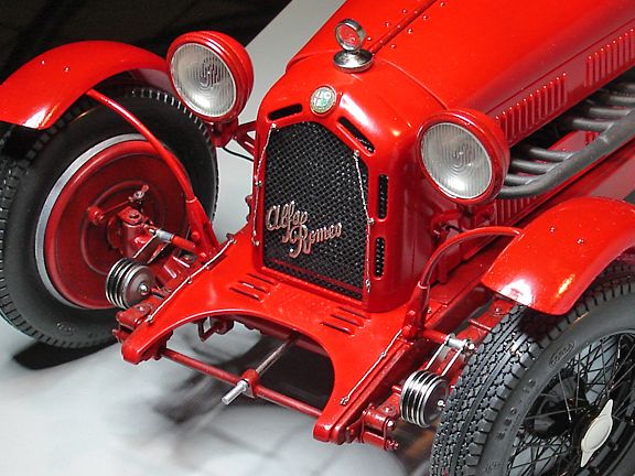

sjordan2 Posted January 10, 2014 Posted January 10, 2014 (edited) What material or tool is best for wiping off the wash where you don't want it? This photo of the 1/1 car shows the effect I need to achieve for the kit's finely molded radiator mesh. I'll probably also hit the mesh with a dulling spray. On prewar Mercedes, the mesh was part of the radiator assembly and unlike later postwar cars, not part of the chrome radiator shell. Or I may start with painting the radiator mesh with an aluminum color, then applying wash. Edited January 10, 2014 by sjordan2
Cato Posted January 10, 2014 Posted January 10, 2014 A moistened cotton ball works well. Test the Dullcote on scrap chrome sprue to make sure it doesn't 'eat' the chrome. If it does, paint aluminum then wash.
