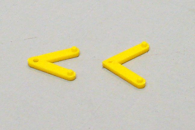

Harry P. Posted February 26, 2014 Author Posted February 26, 2014 The Aurora kit has front shocks but no rears. I used a pair from the Fuman Mercer kit. First I had to change the angle of the shock arms... stock on the left, altered on the right: Then, following the only reference photo I could find of the Stutz rear shocks and their mounts, I scratchbuilt the mounting brackets and added the Mercer kit's adjustable friction disks: This will make more sense once I post the photo of the shocks after they are installed.

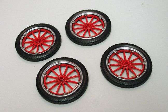

Harry P. Posted February 26, 2014 Author Posted February 26, 2014 The wheels, rims and mounting clips are all molded in one piece, but a little paint detailing works wonders. The valve stems are brass rod, the nuts on them are hex-shaped styrene rod painted brass: Lower left is a front wheel, lower right is a rear wheel.
Cato Posted February 27, 2014 Posted February 27, 2014 Lower left is a front wheel, lower right is a rear wheel. All minus pin stripes...

blunc Posted February 27, 2014 Posted February 27, 2014 All minus pin stripes... what if he just glued a piece of hair down instead of trying to paint a pinstripe that small...
sjordan2 Posted February 27, 2014 Posted February 27, 2014 (edited) I'd say it's already a winner if only the chassis was displayed. By the way, you may find better detail than I supplied for a radiator emblem at this link; it also shows a Bearcat with tufted/pleated pattern on the seat bottom only, not even on the side bolsters. http://www.cartype.com/pages/1682/stutz I don't know that all wooden-spoke Stutz cars had pinstriping on the wheels, and based on the car photos on this link, you don't even have to pinstripe the hood or fenders! Edited February 27, 2014 by sjordan2
Harry P. Posted February 27, 2014 Author Posted February 27, 2014 A lot of my reference photos show no pinstriping on the body at all. As far as the pinstripes on the wheels... that's just not gonna happen!

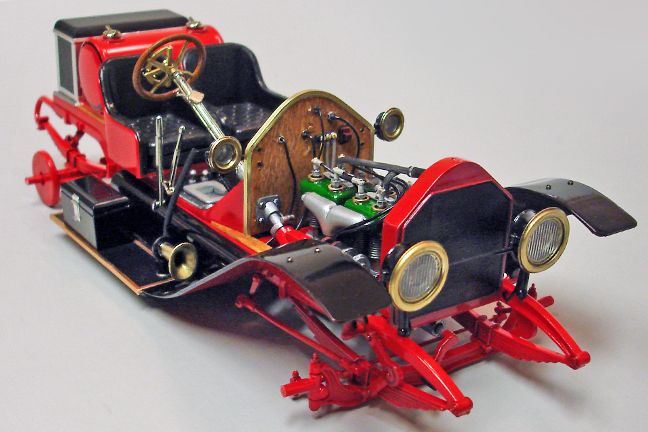

Harry P. Posted March 1, 2014 Author Posted March 1, 2014 OMG! Actual progress!!! Got the front fenders installed. Running boards, tool boxes, steering wheel. It's beginning to take shape now. The tool boxes are molded in one piece, so I used a razor saw to cut the tops off, then glued them back on. Madness? Nah... it just gives a more convincing look... now the tops look like they could actually open because there's a defined gap between the box and the top. The toughest thing to do was the brass trim around the firewall/dash. It's real brass, so obviously it had to be bent to shape. Let me tell ya... it took me quite a while to get the bends exact enough to follow the shape of the firewall without gaps. In hindsight, it would have been easier to bend the brass trim first, then shape the firewall to fit the trim (easier to sand wood than bend brass to a precise shape). In fact, the one in the photo is the second one I did... the first one looked just about perfect, but I cut too much off one of the vertical "legs" and was left with a big gap where there should be none... so I had to make another one. All in all, I probably spent a good hour or more just bending that darn trim piece to shape. BTW... that unconnected bit of tubing sticking up behind the horn is the horn's electrical line. Still have to locate that to the side of the body in that triangular-shaped area just aft of the firewall. Once the glue on the fenders really sets up good, rear fenders are next.
Pocherphile Posted March 1, 2014 Posted March 1, 2014 Nice, very nice.........and too think what kit or kits should I say, you have made this master piece from. Just goes to show, no matter the material, with proper care and work, art comes to life. Rick
Harry P. Posted March 2, 2014 Author Posted March 2, 2014 Yep, these Aurora kits (or any kit, actually) can be made to look darn good if you put the time and effort into it.
Ramfins59 Posted March 2, 2014 Posted March 2, 2014 " any kit, actually) can be made to look darn good if you put the time and effort into it. " Words of wisdom.
