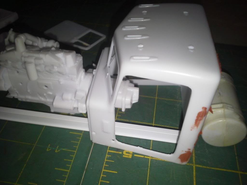

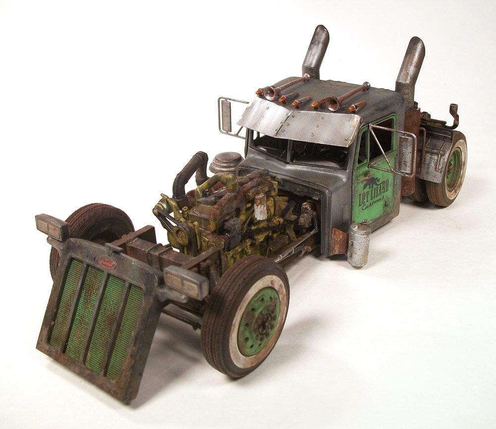

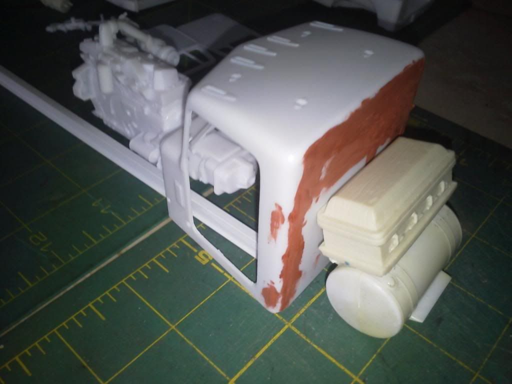

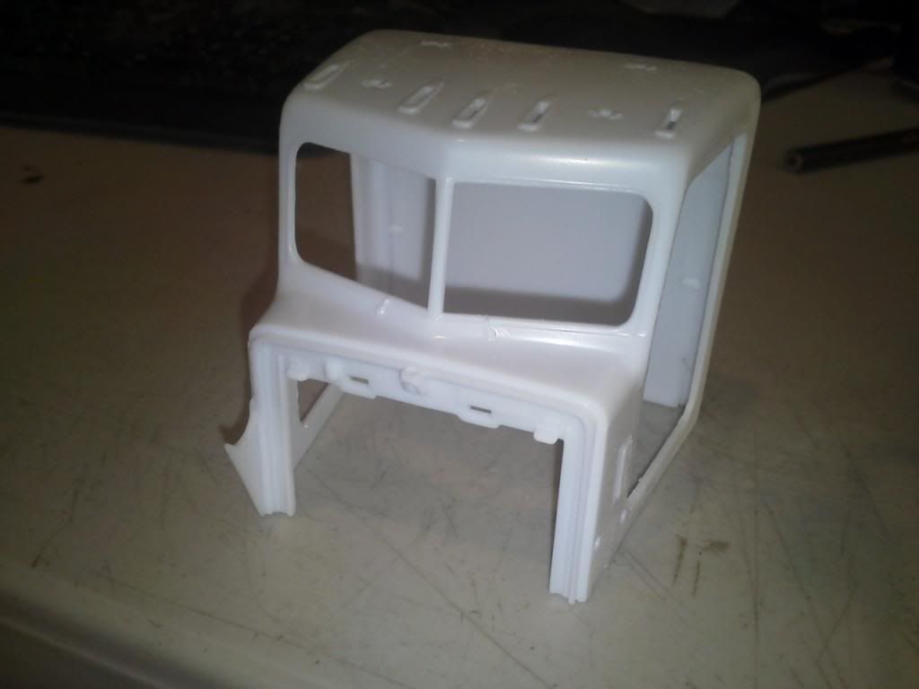

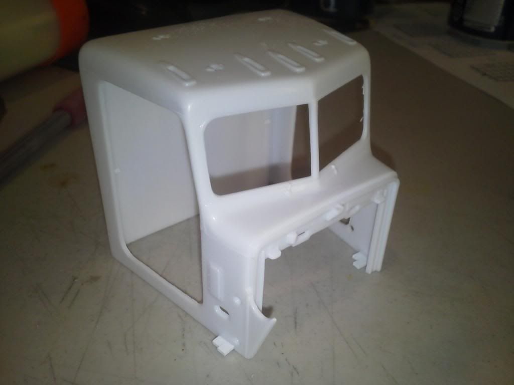

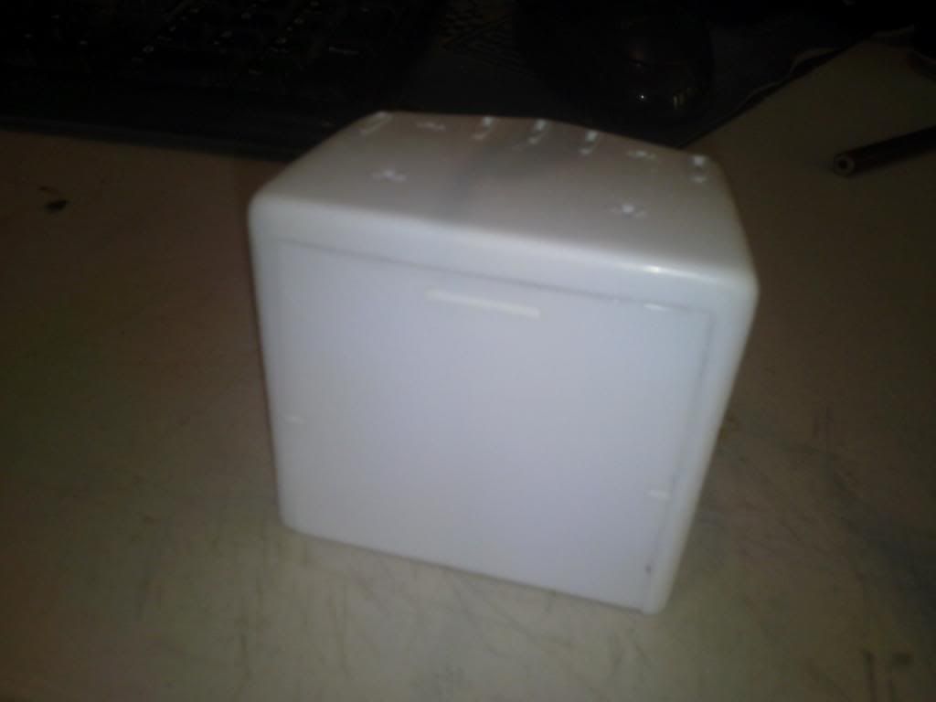

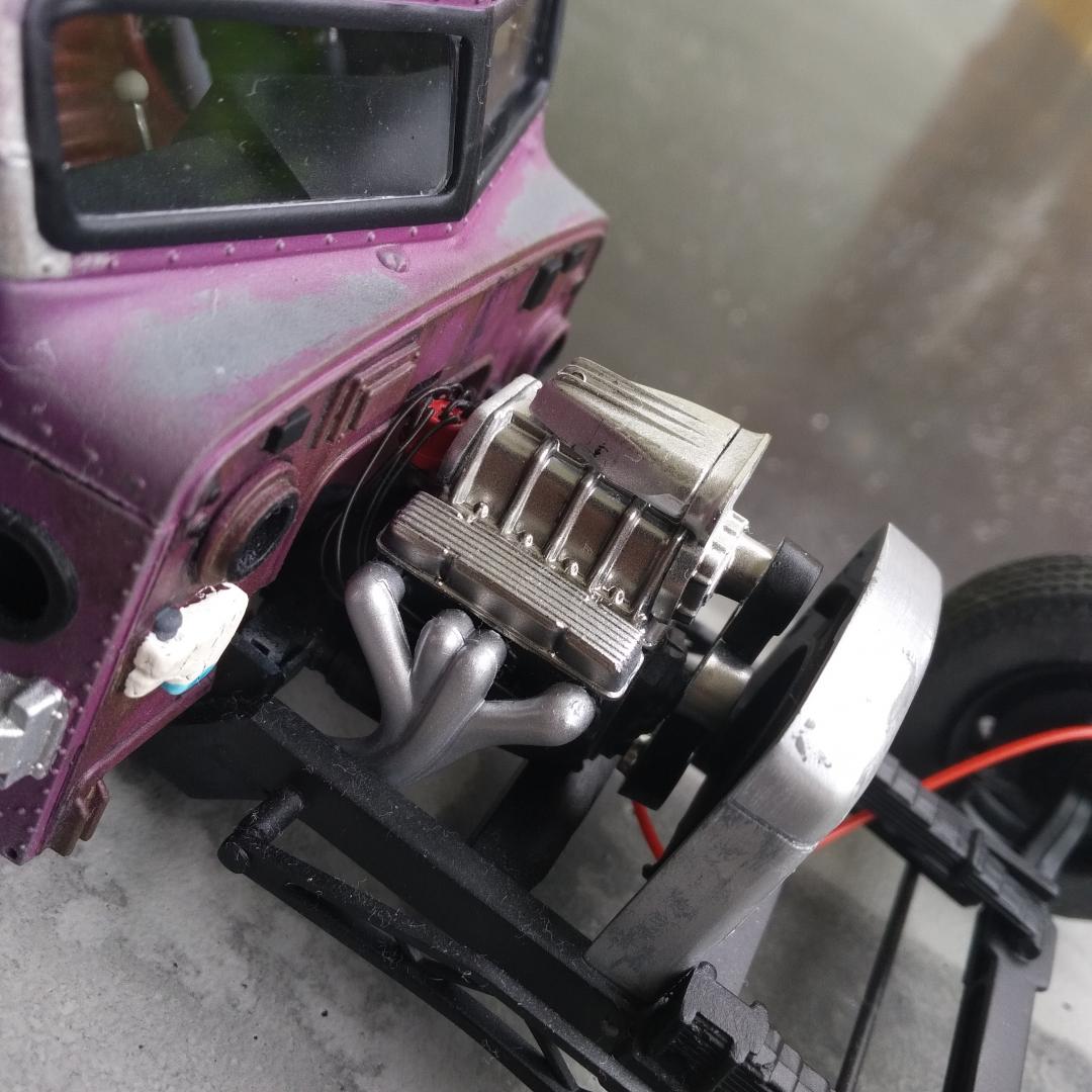

Darren B Posted February 13, 2014 Posted February 13, 2014 (edited) on the scale model addict forum Scott Girvan built a beautiful pete rat rod and Scott got me inspired me to build my own and the ideas have been churning in my mind to how I can build one. Got a start and the last thing I need is a new build but here goes, getting the body ready thats all im at right now till i can figure out a frame for it..... This is Scotts beautiful build: this is my inspiration right here. the following pics are my start: Edited February 13, 2014 by Darren B

Darren B Posted February 17, 2014 Author Posted February 17, 2014 thanks guys Doing a little playing around with layout and ideas.

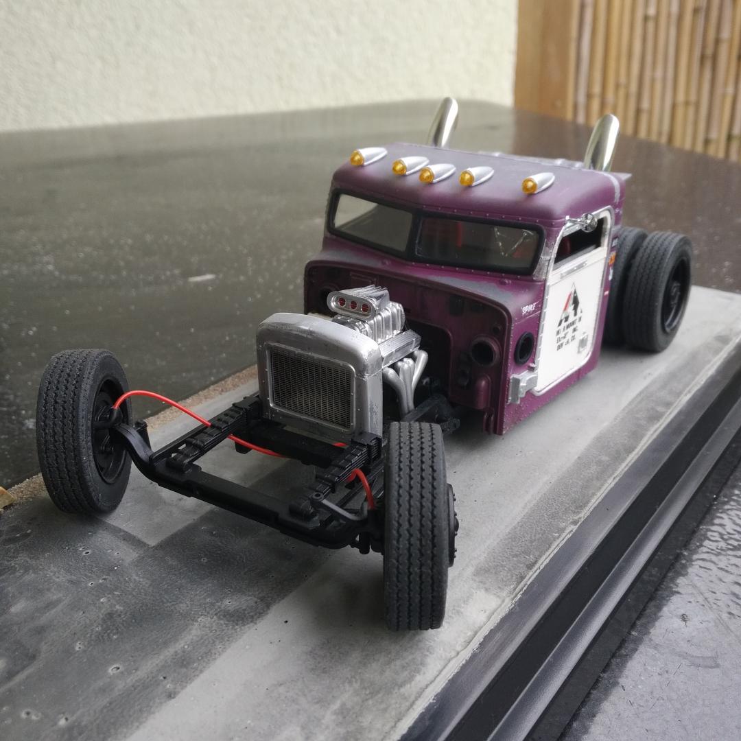

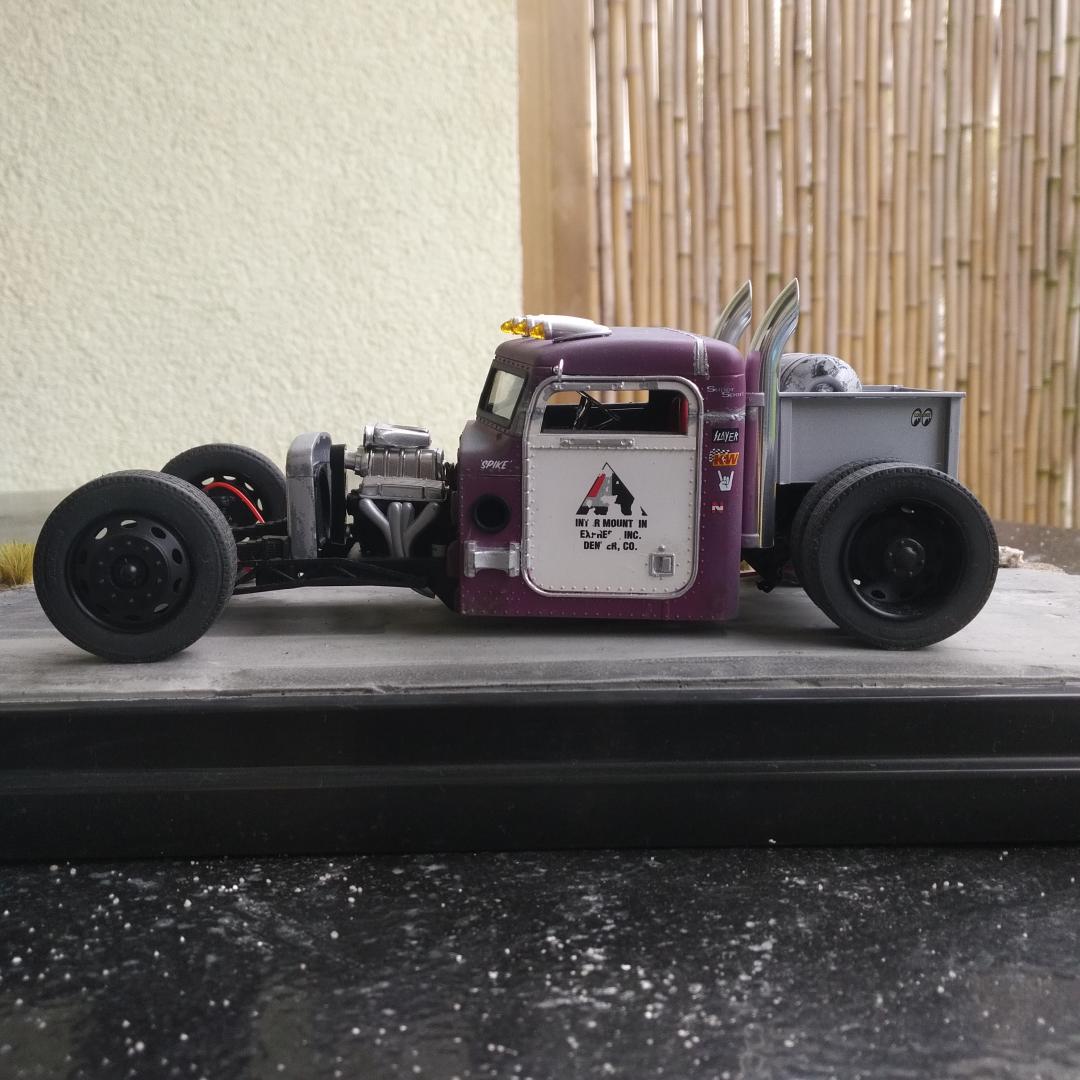

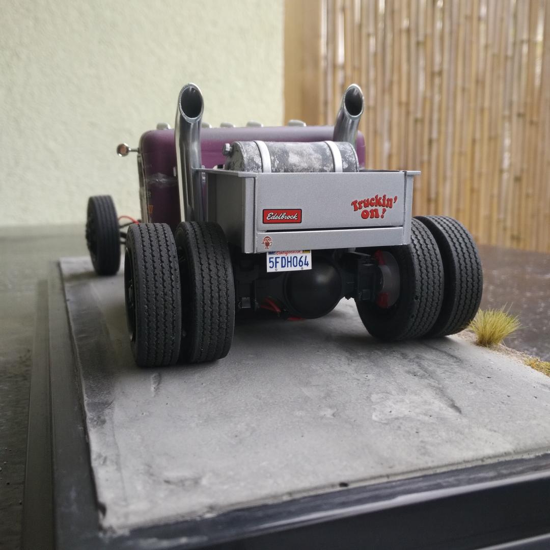

Mr. Horsepower 78 Posted August 18, 2017 Posted August 18, 2017 Looking good so far. Here's one I built a while ago
Darren B Posted August 18, 2017 Author Posted August 18, 2017 Looking good so far. Here's one I built a while ago Jay, that thing is killer!!!! I love the color and the chop top. Wish I had done that before cutting out the doors. I also like the front end, I am not big on scratching a leaf system like the one they built on the other forum. I may go your route......... thanks for sharing.

Darren B Posted August 19, 2017 Author Posted August 19, 2017 I thought this was going to be easy took my time to cut each piece the same exact lengths and it is not staying level. Clamped it to a piece of glass and a soda can to try to get it level. May have to come up with another frame idea.....

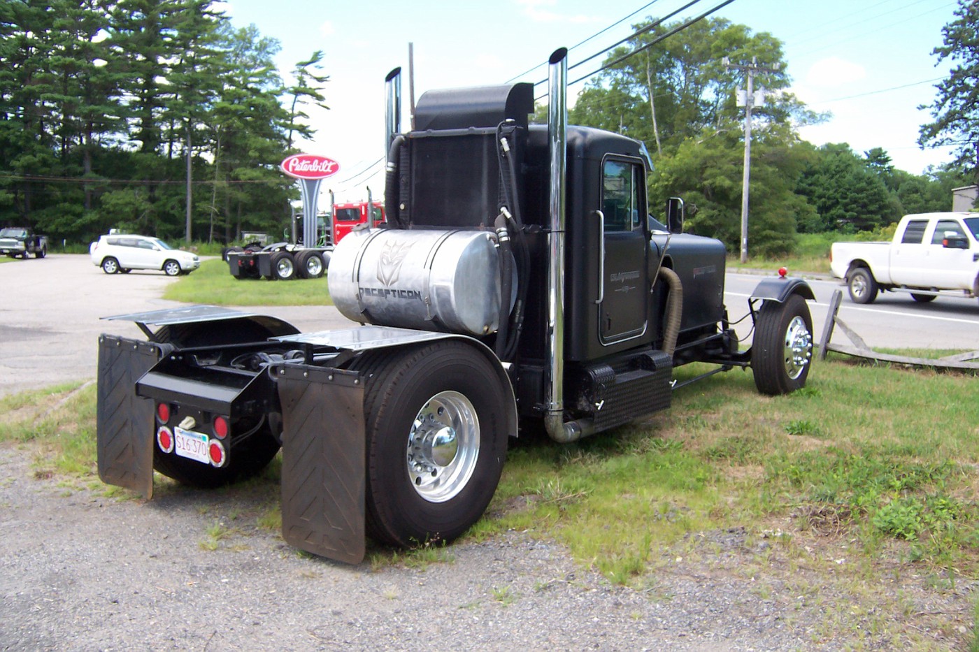

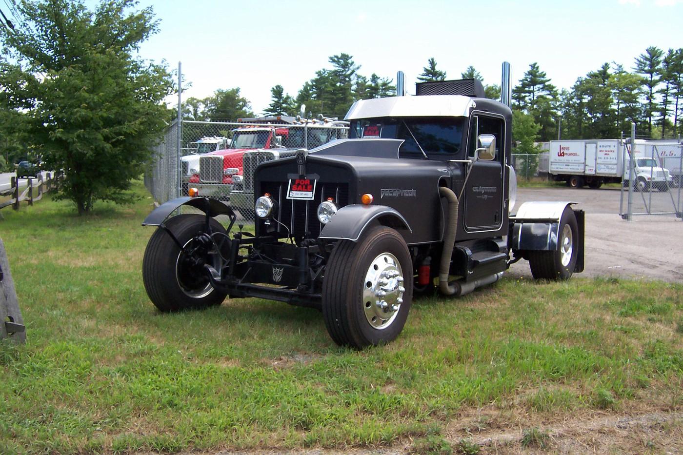

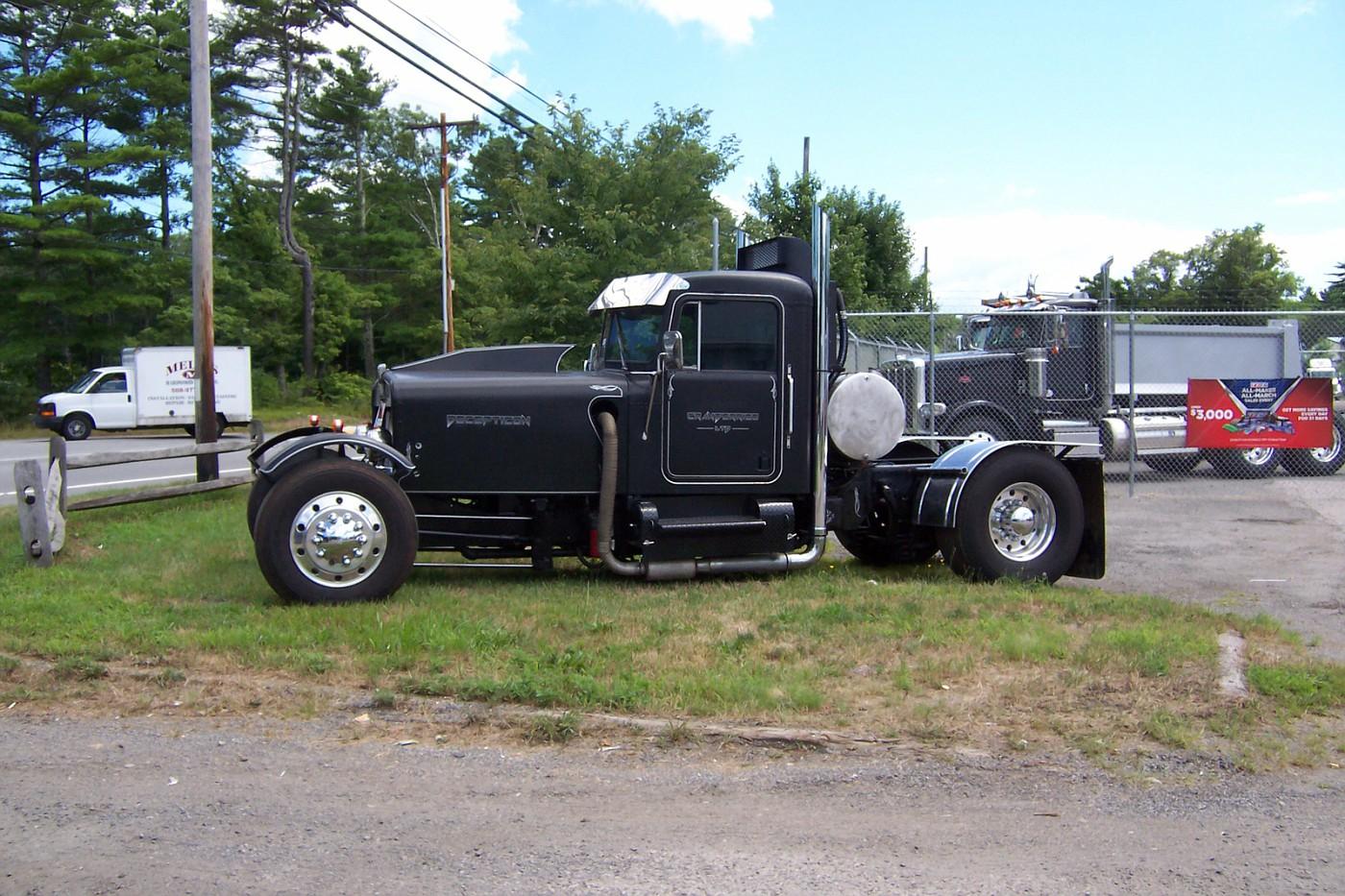

Chariots of Fire Posted August 19, 2017 Posted August 19, 2017 Here's a real one I took photos of a couple of weeks ago. Only difference: It's a KW!
Chariots of Fire Posted August 19, 2017 Posted August 19, 2017 I thought this was going to be easy took my time to cut each piece the same exact lengths and it is not staying level. Clamped it to a piece of glass and a soda can to try to get it level. May have to come up with another frame idea..... Darren: Take the spacers out and use the glass as a base to clamp the separate frame rails on. Clamp some strip stock to the glass to act as a guide for placement and spacing of the rails. Then reattach some new spacers that just fit inside. The frame rails will have to be level if you cut all of the strips the same. Hope this helps. Trying to force it to become level just won't work.
