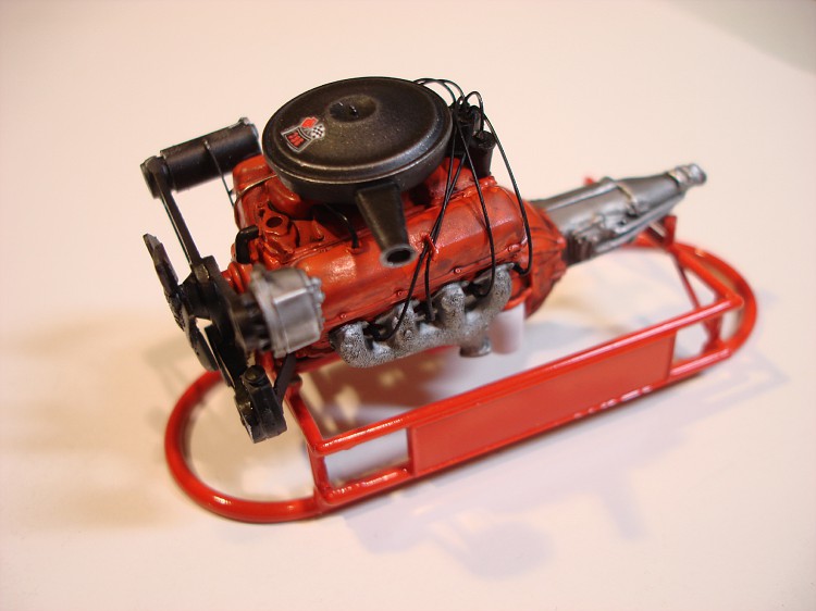

Casey Posted February 22, 2014 Posted February 22, 2014 On 2/20/2014 at 7:01 PM, metznerrob said: I am looking for spark plug boot tubing. Besides cottage industry sites. I would suggest scrounging for wire, measuring the sheathing until you find the correct O.D. to match the O.D. of the boots you are replicating. Straight boots are easy, and you can dull the sheen of the sheathing using a solvent like mineral spirits or lacquer thinner, but be sure to test first. Most plug boots I've seen on models are way too large in diameter, to thick, and too shiny/glossy, so making them on your own can eliminate those.
jedimark14 Posted February 24, 2014 Posted February 24, 2014 (edited) for 1/24 scale I use 30 gauge hookup wire for plug wires then 22 gauge for the boots. found good deals on ebay for bulk wire Edited February 24, 2014 by jedimark14
cruz Posted February 25, 2014 Posted February 25, 2014 I like to use hypodermic needles to simulate spark plug boots on my engines, they look pretty convincing.
