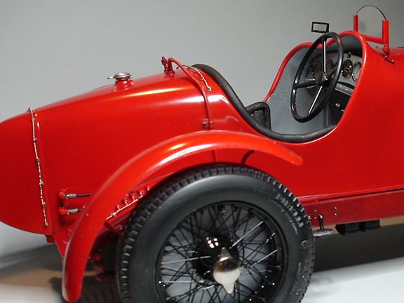

Cato Posted April 28, 2014 Author Posted April 28, 2014 Wire Wheel Pain... I'm showing you the 'glamour' shots-the pain shots are too painful right now. This is the first completed wheel-3 solid days, one aborted attempt and finally a decent finished product. 80 spokes / 80 spoke nipples and lots of hub and rim parts. I won't give a pain-by-pain description because it's too lengthy. But I will give anyone who cares enough a detailed description of successful techniques off line-it's way too much for this thread. Sadly, I was battling brittle (very old) plastic which snapped on me in the beginning causing a vocabulary demonstration known only to aliens. I quickly learned some tricks to deal with it and will be able to salvage some interior damage without outward evidence. Shown with the MML tire which is beautiful by itself: http:// Here's the back side. I bought the whitewalls to give me the option if I want to use them facing out. The black side is very handsome and I may use that out and spray the white side black for the inside. Shown with the cream color the wheels will be sprayed: http:// The tires are supple with a very firm tread area-no fear of collapse. Yes I will sand the parting line when I stop twitching: http:// http:// http:// I'll post a few construction pics to give the idea. The important point is that it IS doable; you must have Koo's notes and photos (he shows a better way for accurate spokes than the kit way), unlimited patience and a determination to get them right. You must acquire a 'feel' with your tools, soldering iron and of course prep every single wheel part meticulously. Now just 4 more to go.... (We need a 'crying' icon Harry...)
Harry P. Posted April 28, 2014 Posted April 28, 2014 (We need a 'crying' icon Harry...) I didn't have any problems assembling any of my various Pocher wheels. They go together just like the instructions say. But assembling them is very tedious, and the parts, especially the spoke nipples, are so small that it tends to stress you out... even though the assembly process is actually pretty straightforward. You need a lot of patience to build these wheels. But from your photos, it looks like you did just fine! They are a thing of beauty when assembled.
Cato Posted April 28, 2014 Author Posted April 28, 2014 Thank you Harry and everything you say is true especially the stress from fumbling. The one wild card was having brittle plastic between the spoke slots on the outer rings. Snapped a couple until I got the idea to use the 'melting method' to heat the spokes into place rather than 'snap' them in as Koo's instruction shows. And Pocher's (jokingly named) instructions don't even tell you that! Then I had to get the feel of how much heat and how hard to press (not at all) before they sunk into just the right depth. All my kit's gray plastic is like that. The black plastic of the frame and body has a different composition. It's harder but less brittle. I melted all those screws in and never broke or stripped one (so far ).
Harry P. Posted April 28, 2014 Posted April 28, 2014 A lot depends on the particular kit you're dealing with, and how it's been stored over the years. So far, all of my Pocher kits have been ok... I've never had a problem with the brittleness of the wheel rings that you describe, so all I've ever had to do is use a very small screwdriver tip to push the spoke nipples into place... the plastic wheel rings have always given way nicely. But you never know what you get when you buy a 40 year old kit. You also seem to have had issues with the kit springs, which I never had. Must have something to do with how the kit spent its previous life before you bought it. But just think how proud you'll be of the finished model, knowing what you went through! Edit: Actually, the toughest part of building a Pocher wheel is making sure you put the spoke nipple on the spoke in the correct orientation... the wide flare goes down into the plastic wheel ring. I use a magnifier desk lamp when building my Pocher wheels... I couldn't have done it using only my natural unaided vision!
Cato Posted April 28, 2014 Author Posted April 28, 2014 But just think how proud you'll be of the finished model, knowing what you went through! Edit: Actually, the toughest part of building a Pocher wheel is making sure you put the spoke nipple on the spoke in the correct orientation... the wide flare goes down into the plastic wheel ring. I use a magnifier desk lamp when building my Pocher wheels... I couldn't have done it using only my natural unaided vision! I'm afraid I'll be proud posthumously... So true about seeing what you're doing with these 1mm parts. I use 5x glasses and an Ott- Lite and it's fine. But changing focal length from the tools a foot away to the workpiece 3" away gives me headaches by the 3rd hour. Snapping the nipples in would have been fine but I had to use the hot iron which added another dimension of stress. But I've got the feel now and the others should go more quickly. I've actually got to take another of those backward steps now. The modified steering shaft came back from Marvin and I will assemble it into the steering box, finish it and install into the chassis, Then the steering arm to the front axle. Then back to wheel fun. I still want a 'crying icon!!'.

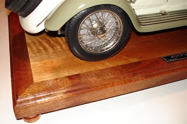

Cato Posted April 30, 2014 Author Posted April 30, 2014 This is only a test... http:// Front axle in place. Wheel / tire and fender mocked-up for relationship with each other. Wheel is correctly centered, ride height very close to what I hoped. Completed weight should settle it a bit more. Everything seems to be playing nice with each other. Will post the axle installation soon. Also gives a ton of incentive to continue down this rabbit hole. It looks gorgeous and big in person-beyond my dreams. I will now happily continue hitting myself in head with this hammer...
Eric Macleod Posted April 30, 2014 Posted April 30, 2014 This looks fantastic. I encourage further rabbit hole exploration! I know the white wall tires look good (and they do look very good indeed!) but I would like to see the same shot with the black-wall tyre (as the Brits would say) out! Just to see how it looks.... Those wheels though. I have to concede that they spectacular and would be a real shame to cover up, even if it might be more historically accturate to have the covers on them.
