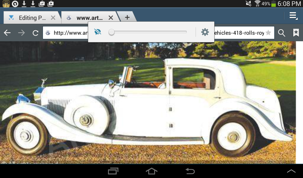

Cato Posted April 25, 2015 Author Posted April 25, 2015 You have to see it with the spare if you go that way. My opinion is to match the crown of the trunk with that of the sedanca top first (like Bob's examples), decide on the spare, and then check the trunk angle. Either way, it'll be an improvement over the straight trunk. You are correct Mike; the reason this takes me forever is the need to test-fit every change with all the other parts in place. Dis and re assembling the main parts many times. Then photos to study. So if I build a new angled trunk form, I'll drill for the spare mounting post and put the spare on for visuals. I have not yet ruled out the square edged trunk; I have many shots of Gurney cars that have it and they're beautiful. They have a charm that is stately and sporty at the same time. Ignore that the fenders are different than mine but here's one:
sjordan2 Posted April 25, 2015 Posted April 25, 2015 (edited) Your example looks good to me. Note how the curved molding at the top of the door sweeps down to the upward curve at the bottom of the roof, which meets the curve at the top of the trunk. An excellent replica of the car in your example can be built with the 1/16 Revell Phantom II Continental kit. Edited April 25, 2015 by sjordan2
