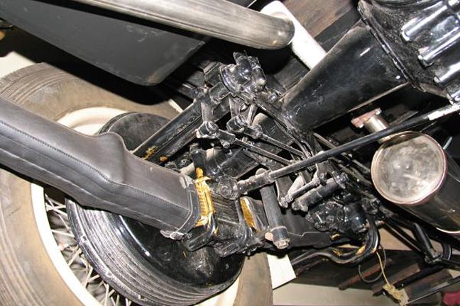

Harry P. Posted April 1, 2014 Posted April 1, 2014 Rolls didn't use wrapping on the springs, they were completely sheathed...
Cato Posted April 1, 2014 Author Posted April 1, 2014 BEAUTIFUL shot Harry. Will you take my first-born for your references?? That ham shows ribbing-I thought the pumpkin was smooth cast-iron, and I finished it as such. Is that a P II?? Maybe talc for the fine dust seen here??
