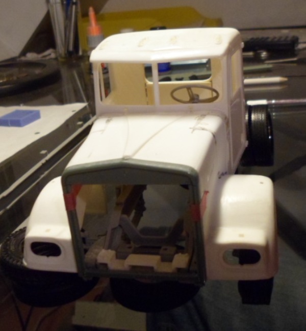

Hello all
this is what I want to build up. I started it with the Revell cab and hood. I think it looks quiet realistic. The right type would be W900-S2 or better said Ithink this it is.
So long
Arnd

Hello guys
I worked last night a bit more on that littel one. To bring the cab to the right shape I have to put it on the frame. I started to work on it but I am not sure about how long it should be. So what WB does a singel Axel truck have with a BBC of 102 Inch?
so long
Arnd
