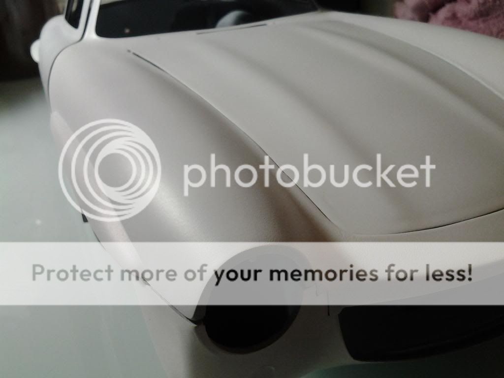

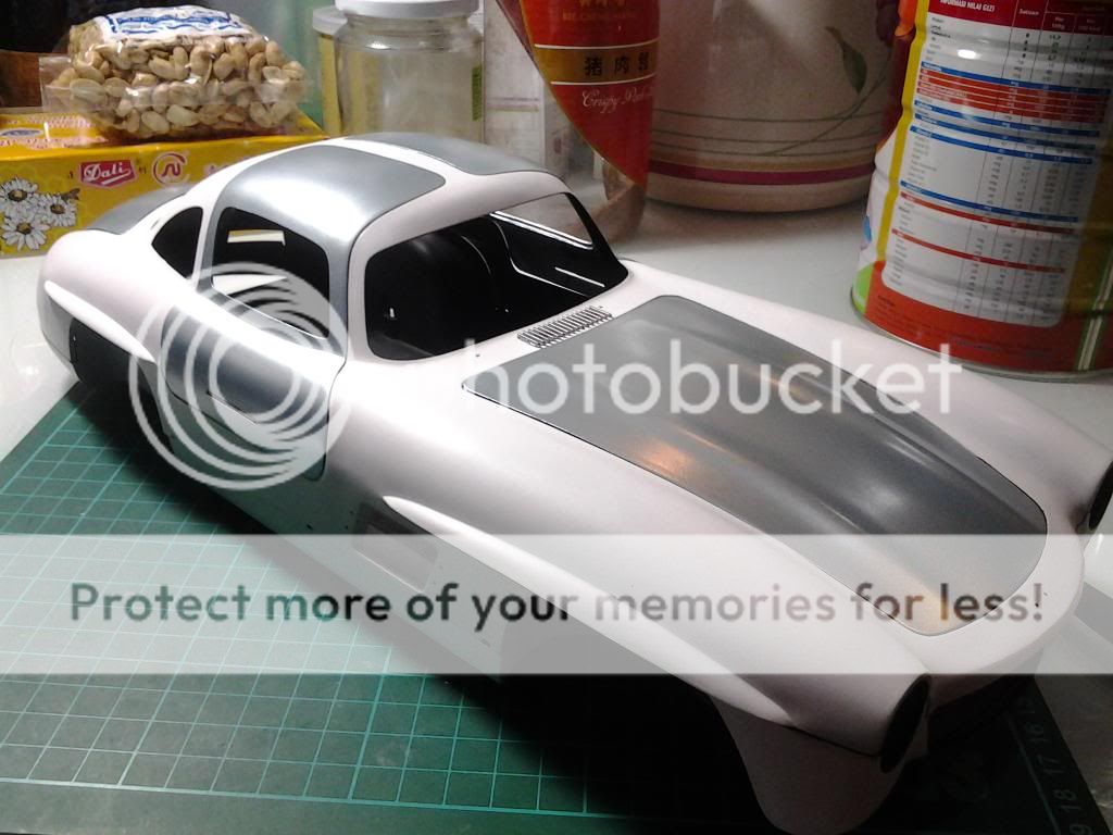

Cien1986 Posted June 1, 2014 Author Posted June 1, 2014 Here is some update... Finish on priming on body...

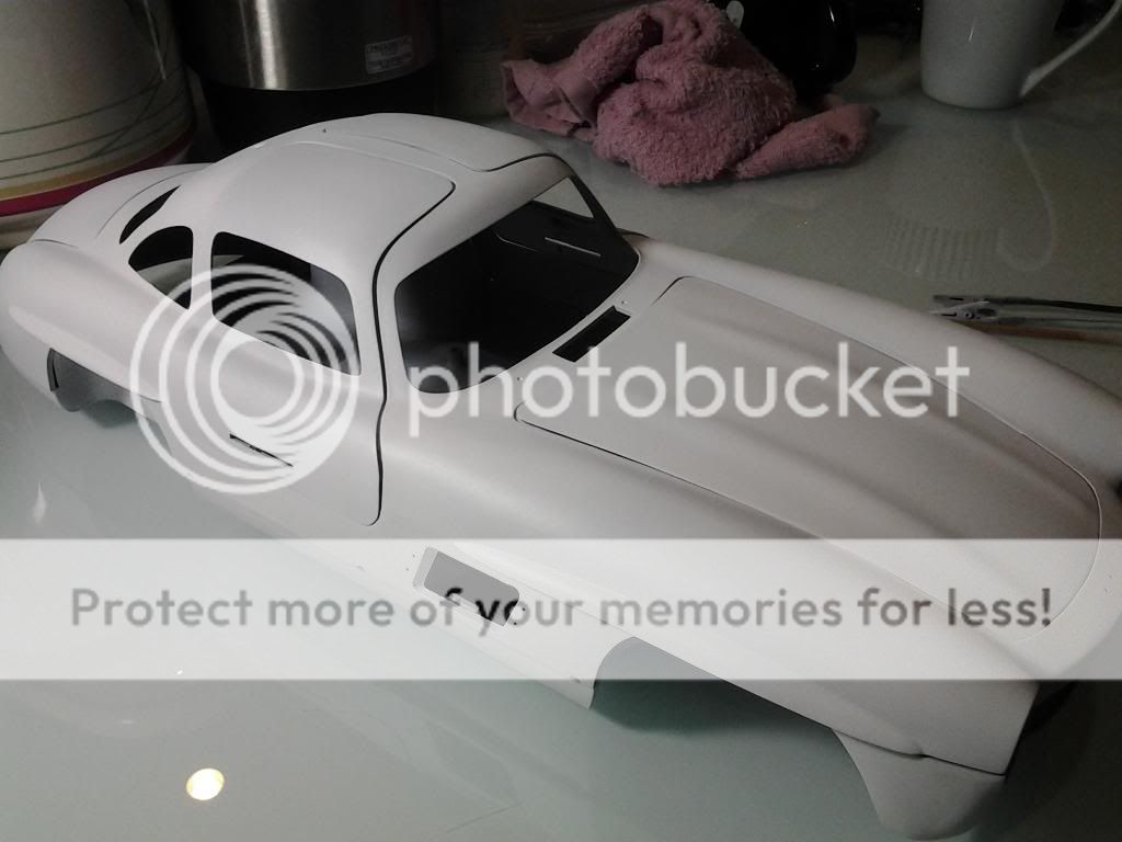

Cien1986 Posted June 2, 2014 Author Posted June 2, 2014 I finnish paint the body shell... update coming soon
Davewilly Posted June 2, 2014 Posted June 2, 2014 Looking very good so far. I like how its turning out..Keep up the great work!
bobthehobbyguy Posted June 3, 2014 Posted June 3, 2014 Very nice job with the fit of the doors and the hood,.
Cien1986 Posted June 3, 2014 Author Posted June 3, 2014 (edited) Very nice job with the fit of the doors and the hood,. Thanks... Edited June 3, 2014 by Cien1986

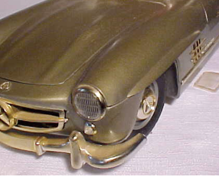

sjordan2 Posted June 3, 2014 Posted June 3, 2014 Did you actually put the seals around the uprights on the bumper? I've never seen another modeler do that.
Cien1986 Posted June 3, 2014 Author Posted June 3, 2014 Did you actually put the seals around the uprights on the bumper? I've never seen another modeler do that. Dont really get what you means on seal... can you be more specific?
Cien1986 Posted June 3, 2014 Author Posted June 3, 2014 Tonight iam glueing all the window chrome part.. and the windows clear part... its mess... i cant really handle it well... i glue the clear part first to the chrome part then the combine part to the body's window slot.. the chrome part need to press when glueing because of the parts abit bent this makes the super glue run to my finger when pressing it and the glue stick abit to clear part.. dissaster... so next i try diffrent method... i fix the chrome part first to body.. then fix the windshield... but what happen.... the windshield need to pressd too to the body... its also not fix real well... No luck....
Cato Posted June 3, 2014 Posted June 3, 2014 (edited) Did you actually put the seals around the uprights on the bumper? I've never seen another modeler do that. That's the green mat reflecting in the Alclad. EDIT: That's not what you mean Skip-I see it now. It may be molded into the bumper. Edited June 3, 2014 by Cato
sjordan2 Posted June 3, 2014 Posted June 3, 2014 (edited) That's the green mat reflecting in the Alclad. EDIT: That's not what you mean Skip-I see it now. It may be molded into the bumper. Nope, it's not molded onto the kit bumper. I've got the same kit right beside me to refer to. I'll have to either find a shot in my files or scan one. EDIT: It's the line (seal)where the upright portion (not present on all Gullwings) is attached to the horizontal bumper. The seal is on both sides; I'm guessing that it's only there for cosmetic reasons to hide the gap. Edited June 3, 2014 by sjordan2
sjordan2 Posted June 3, 2014 Posted June 3, 2014 (edited) PS: as long as you're into painting, I would point out that everything on the inside of the body shell should be matte black - except for the visible exterior parts of the wheel wells behind the wheels, which should be body color. Also, if you're going to spend this much time and effort on making this great, I seriously hope you're going to fix the fender body seams, especially between the headlights and the grille. Further, if you're going to work on making an accurate engine set-up, I can send you correct art that you can make decals or stickers for the cam cover, water tank and oil tank. Edited June 3, 2014 by sjordan2
Cien1986 Posted June 4, 2014 Author Posted June 4, 2014 (edited) PS: as long as you're into painting, I would point out that everything on the inside of the body shell should be matte black - except for the visible exterior parts of the wheel wells behind the wheels, which should be body color. Also, if you're going to spend this much time and effort on making this great, I seriously hope you're going to fix the fender body seams, especially between the headlights and the grille. Further, if you're going to work on making an accurate engine set-up, I can send you correct art that you can make decals or stickers for the cam cover, water tank and oil tank. I finnish it on black matt... just waiting to fix it.... Actually i am interested on detailing the engine... but i never print decal myself.... Will normal inkjet printer be able to print the decal? Edited June 4, 2014 by Cien1986

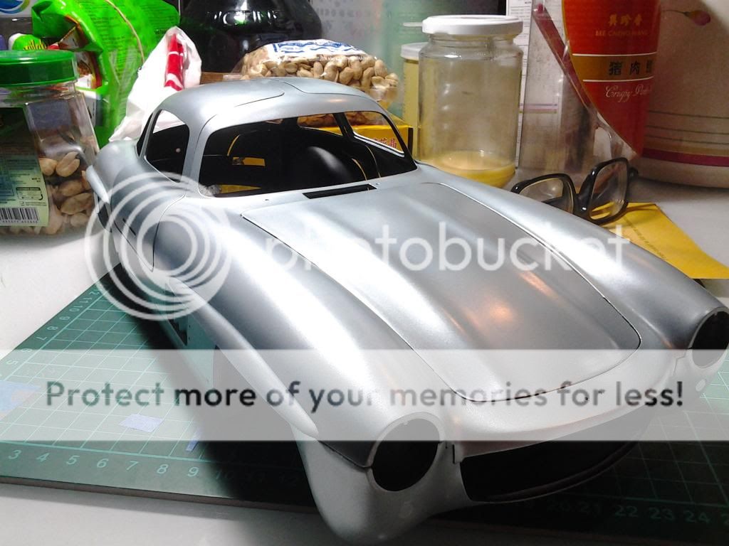

sjordan2 Posted June 4, 2014 Posted June 4, 2014 Another thing to consider on this kit is that the front wheels come way too far inside the wheel well, probably because of the working steering. You'll need to add spacers.

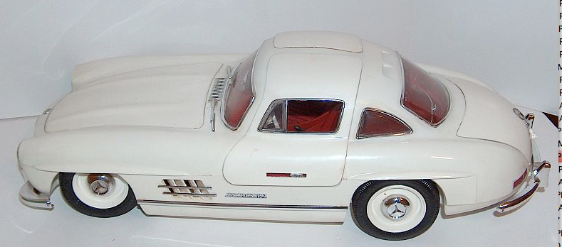

Cien1986 Posted June 5, 2014 Author Posted June 5, 2014 (edited) Whoooa nice decal pattern.... just print it on decal paper... many thanks for your help Is that your gullwing kits? Edited June 5, 2014 by Cien1986
Cien1986 Posted June 5, 2014 Author Posted June 5, 2014 Ithink the problem is on front whell... sink too deep... but the rear seems ok so far
