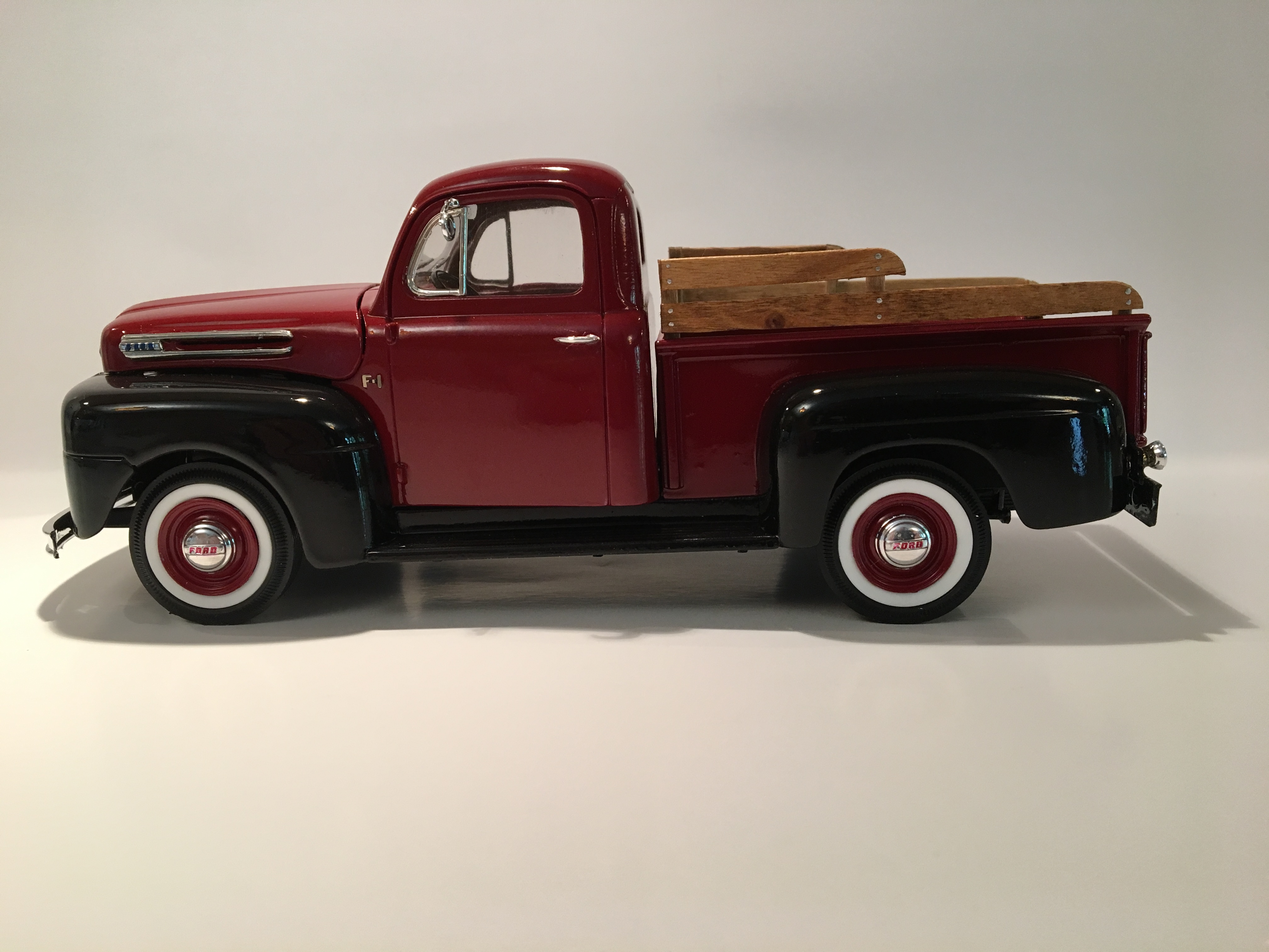

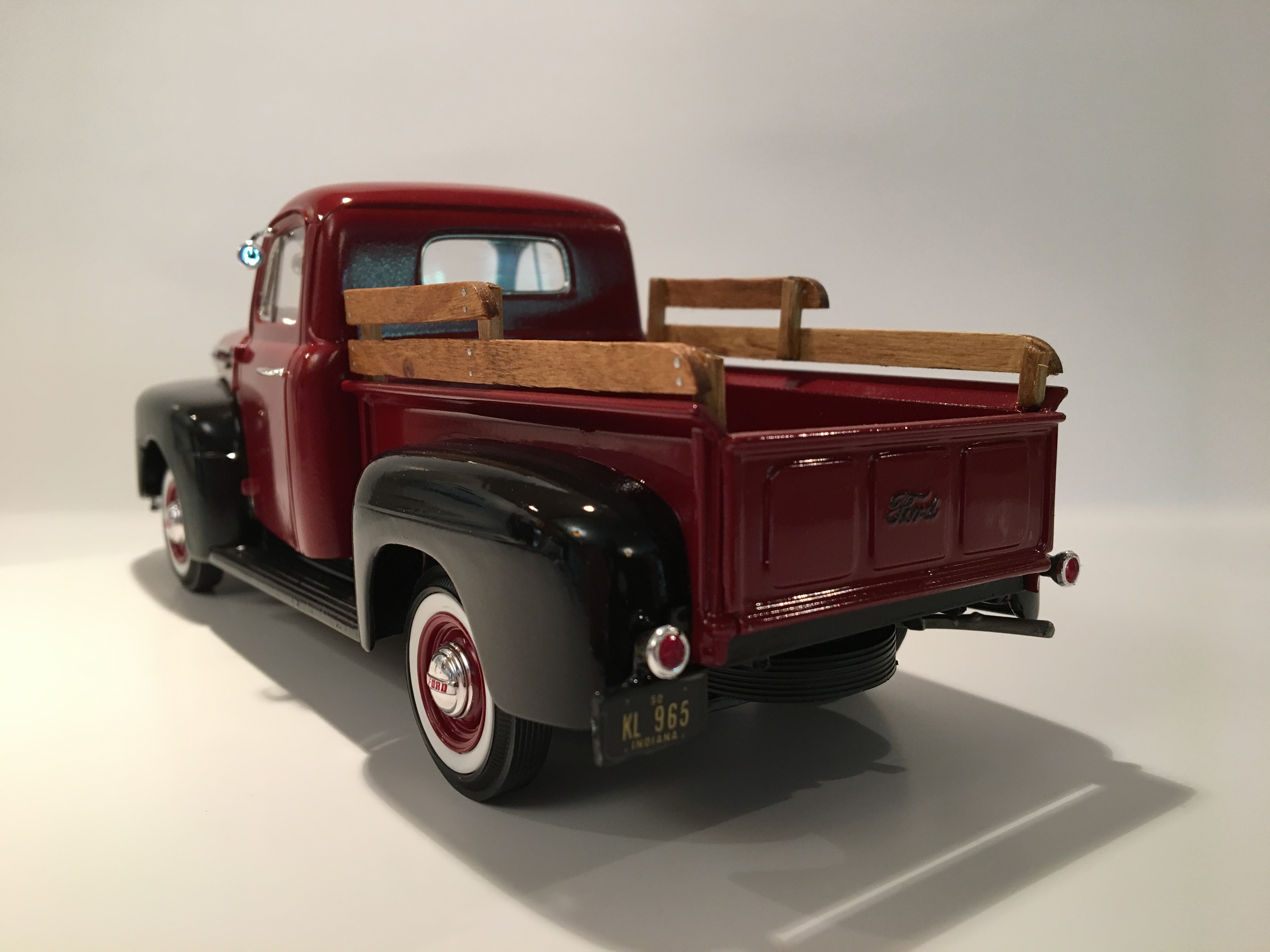

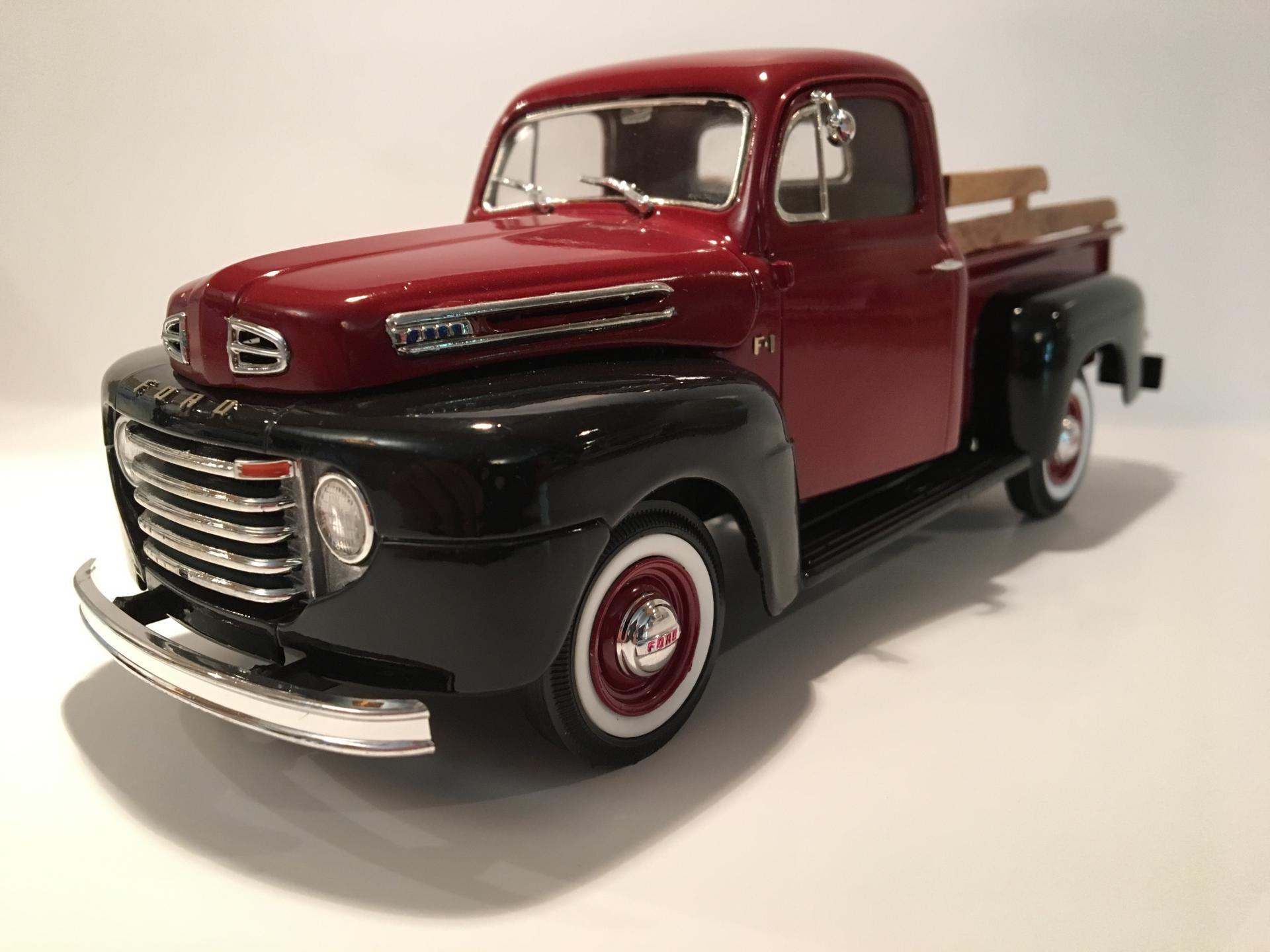

Mercuryman54 Posted November 13, 2018 Posted November 13, 2018 Here's one I built from the blue box version. When it first came out. Dennis
