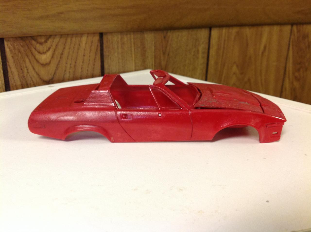

Jaguar man 21 Posted July 20, 2014 Posted July 20, 2014 What works best to remove paint I see that guys use brake fluid does it really work
Art Anderson Posted July 21, 2014 Posted July 21, 2014 DOT-3 brake fluid will strip most any paint off of a styrene body, and almost always with little or no damage to that kind of plastic. However, it's sheer death to resin bodies. Of course, as with any petroleum based product, proper disposal is a must, not just simply tossing it in the trash. Art
angelo7 Posted July 22, 2014 Posted July 22, 2014 (edited) Will brake fluid affect glued parts? You know, like unglue the parts? Edited July 22, 2014 by angelo7
Ace-Garageguy Posted July 22, 2014 Posted July 22, 2014 If the model is glued together with a solvent-type glue, then no, brake fluid has no effect. Solvent glues actually melt the plastic and fuse the two parts together. There is a huge (21 pages) paint stripping thread with all your answers at the top of this heading, called ''Paint Strippers-What to Use?" If that's too hard, click here...http://www.modelcarsmag.com/forums/index.php?showtopic=83153
Jaguar man 21 Posted July 24, 2014 Author Posted July 24, 2014 Does royal purple work I have a tub of it I'm trying to strip this I've heard it works but I wanted to ask first
