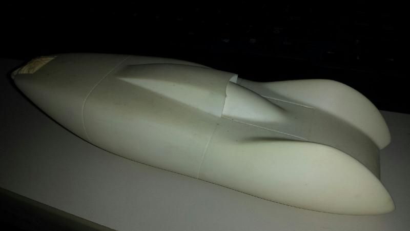

Ira Posted September 2, 2014 Author Posted September 2, 2014 Frame Mods! Looks like I am going to need to remove some excess plastic from the Frame to fit the New Body. I used a Cut-Off Wheel to remove most of the plastic. I ended removing the rest of the excess plastic with an X-acto Knife and a Sanding Block. Top View. More Coming...
