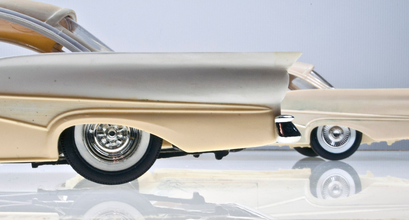

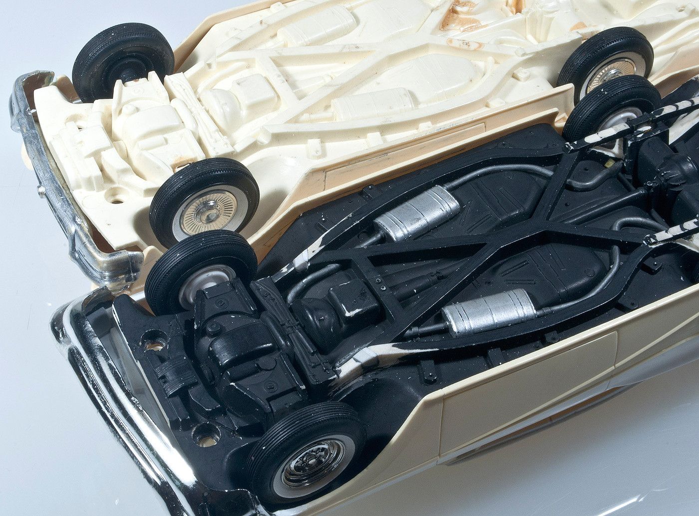

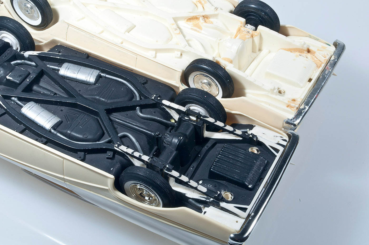

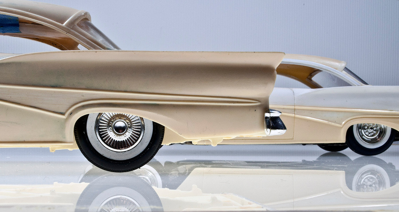

Recently decided to take another step to enhance the curbside view of this model by opening up the space underneath the molded-on rear leaf springs to give the parts some visual separation from the frame. Hogged them out with a Dremel tool and finished up with knife, file, and sandpaper. I added the missing portion of spring over the axle with the appropriate piece from a Revell '59 Ford Skyliner rear end.

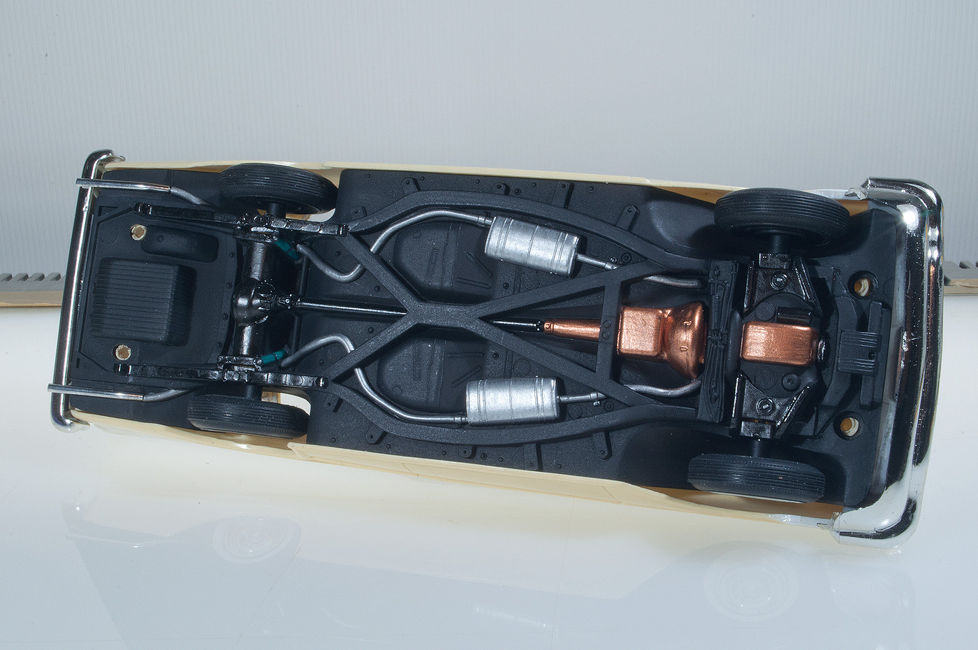

Also, as usual with AMT's 1959 kit chassis, this one has large C-notches that need filling in the frame behind the front suspension where custom lake pipes were meant to be attached. A section of sprue, a piece of square rod, and some cyano did the trick. The photos show it compared to an unmodified '59 Ford chassis in another '58 Ford.
John! That's a neat trick! B)
I'll have to try something like that whenever I'm not in the mood for fully detailed chassis'!
This is one beautiful creation you're bringing together John, and it's funny---------I've been seeing '58 Fords turn up on eBay somewhat regularly for a while, and now I'm tempted to pick up one! :D
Niiiice! Did the same thing to my '61 Comet and '60 Chrysler (used a '62 chassis under that one). Really adds a lot to the look. Will you be dressing up the lower A-arms too?
Excellent idea. That adds a lot visual fidelity since this area is noticeable on the 1:1 car.
Thanks, Bill!  Give it a try, Bill – embrace the simplicity!  Everybody needs at least one '58 Ford!
Thanks, Chris!  On the lower A arms I usually let the difference between gloss and flat black, and careful painting, define the shape of the piece. When viewed from the front the shiny A arm pops a little and the flat black lays back in shadow. The oil pan will also get some gloss color.
Thanks, Dave!  It also helps the illusion of detail in an area that one's eye might be drawn to due to the chrome tailpipes that I'll add later.

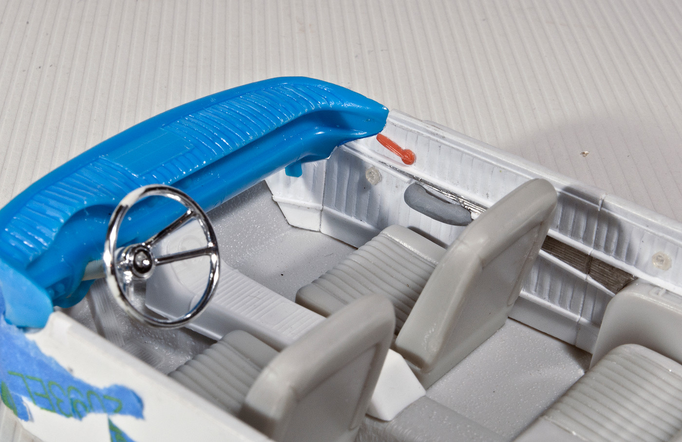

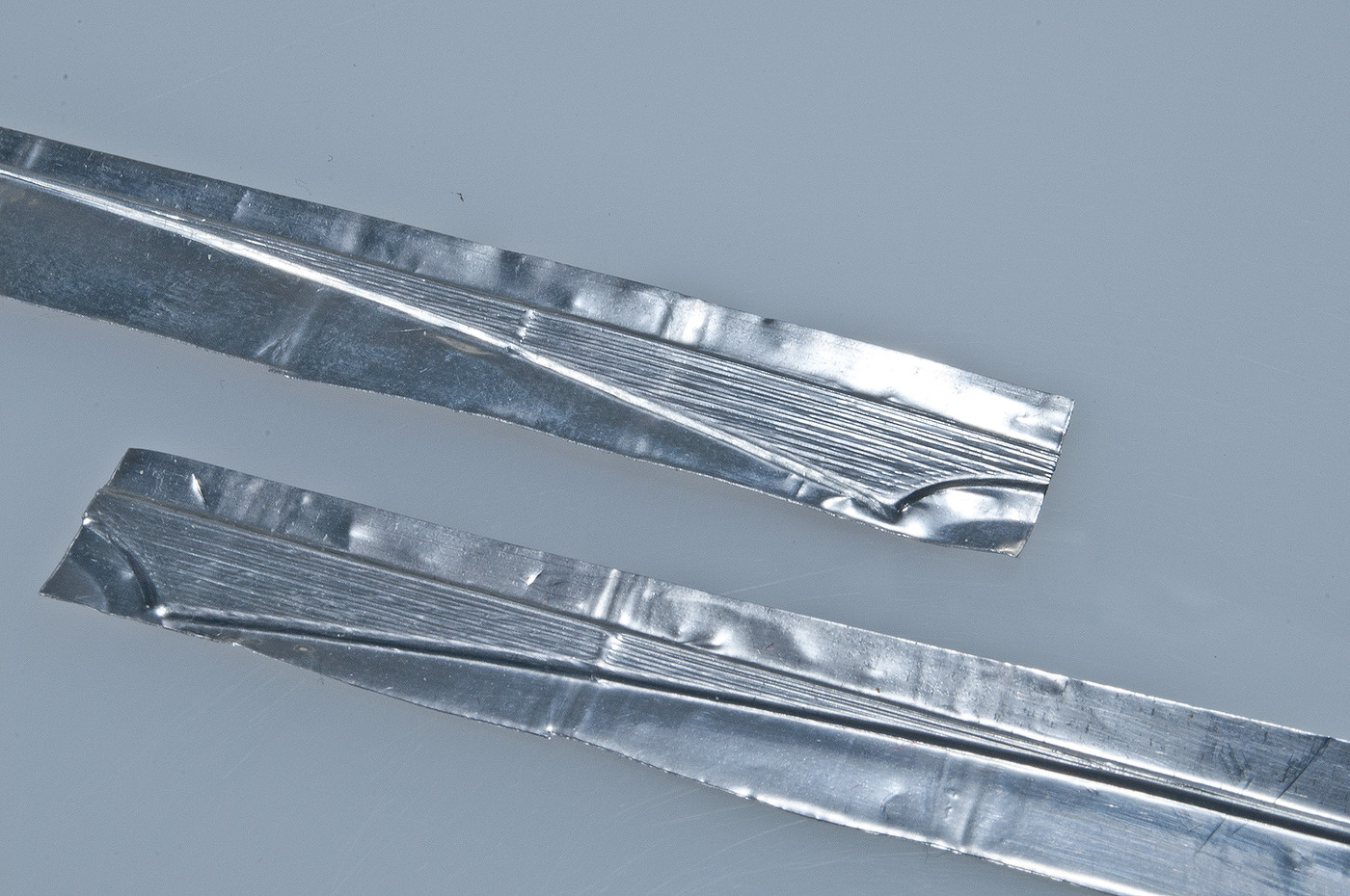

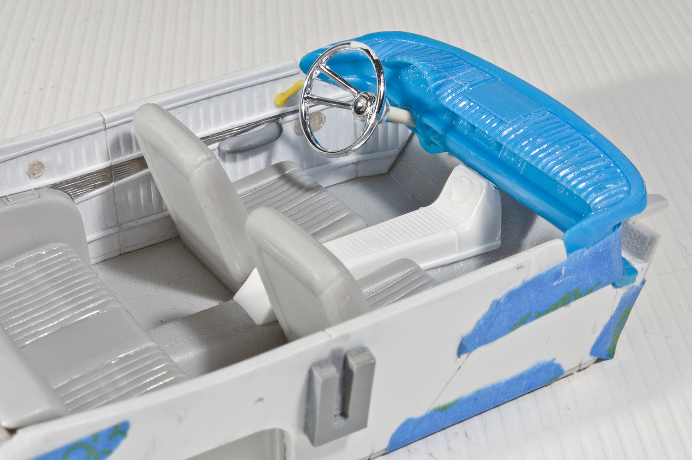

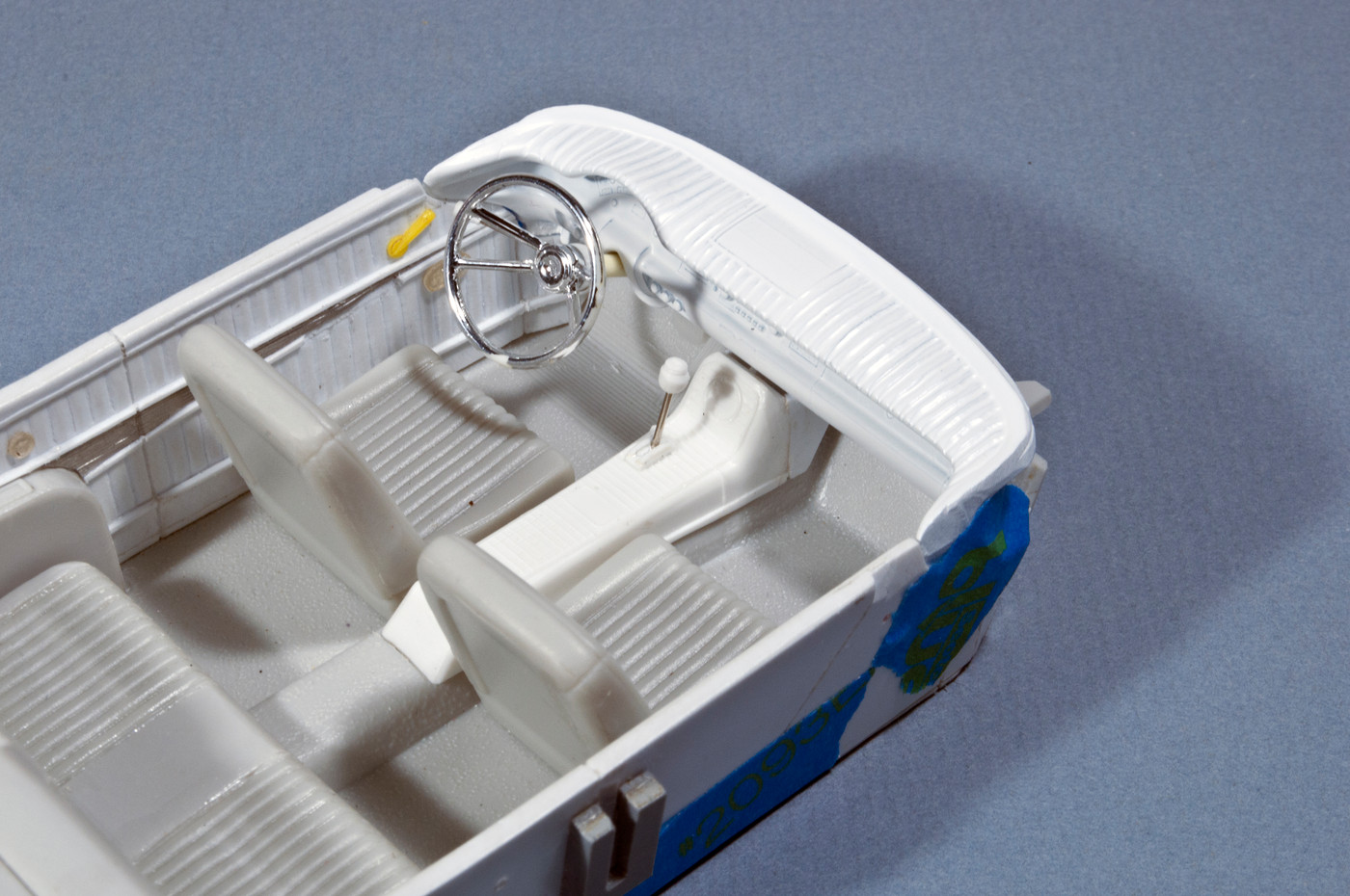

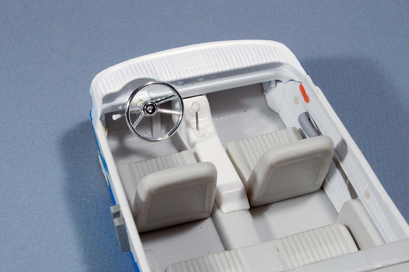

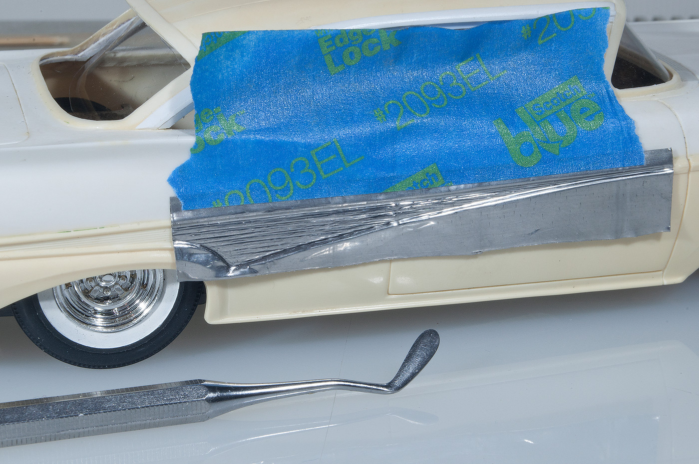

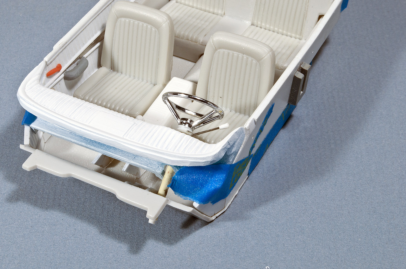

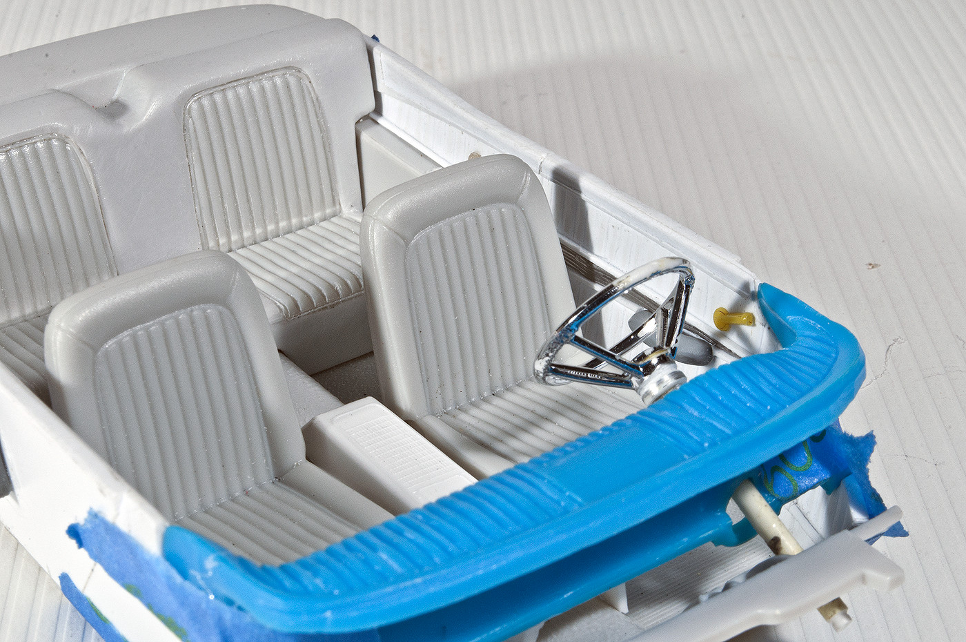

The main project was detailing the interior side panels. I burnished some ribbon solder over the outside trim so it could be repeated inside. This worked reasonably well, though the solder's softness, which is a virtue for copying the necessary detail, is a liability during the cutting fitting and fitting process. Then I added the trim moldings from styrene strip, and marked out, scribed, and carved a tuck & roll  pattern into the panels. The front arm rests were carved from ABS, while the door handles were robbed off of Revell Skyliner door panels. A member of the MCM forum copied a set of power window switches in Bondic from a Revell '57 Country Squire (Thanks, Chris!) Most recently I scribed and carved a tuck & roll pattern to match that on the seats into the top of the dash. Final details will be a turn signal lever, '57 T-bird auto shifter for the console and an inside rear view mirror. I'll also drill the redundant heater control from the console and replace them with a tach dial.

Some more work on the interior details. Created a shifter for the console using a straight pin, and turned a knob with a lock-out button on top from a piece of ABS rod.  The base plate was built-up and shaped from styrene strip. The idea was to replicate a '57 T-bird automatic shifter.  Also made a turn signal lever with a shaft from a dressmakers' silk pin (which is thinner than the typical straight pin) and a turned styrene rod knob.

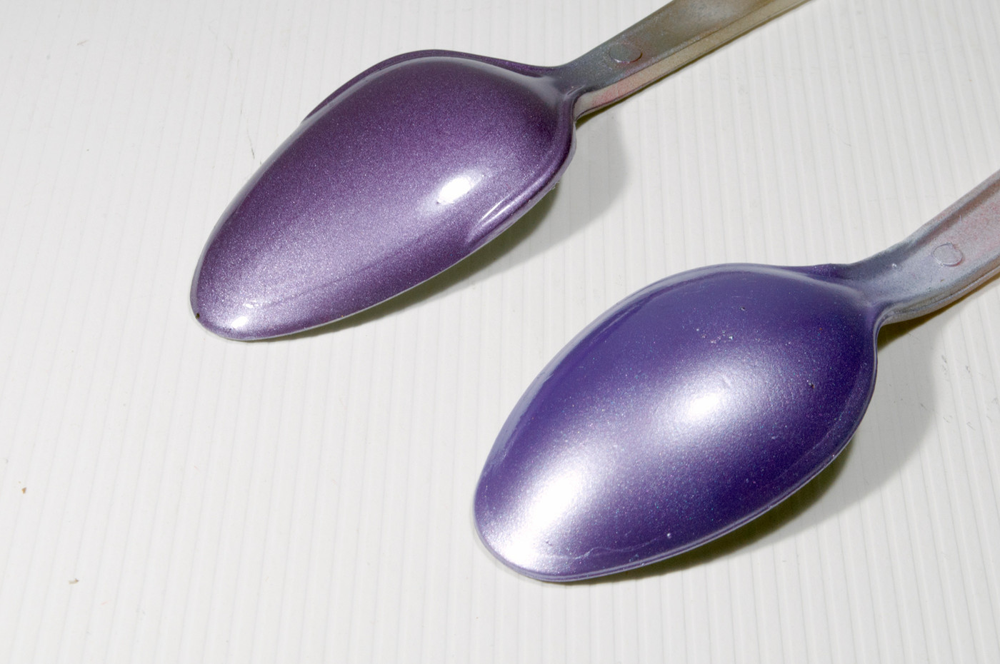

Also agonizing over paint!  These two spoons are where I'm at for the body color (roof will be pearl white).  The color on the left is a mix of tried-and-true Tamiya paints. The spoon on the right is "Plum Ice" by Bob's Paints, which I think has a lot more punch, with a great shift in tone from highlight to shadow.  The problem is I have no experience shooting Bob's on a model. It needs to be thinned with lacquer thinner and I hesitate to risk all the work I've got in this car with a new paint regimen.  Yikes!

Can you simulate the materials/fillers/primers on a scrap body to confirm compatibility before you shoot the real one?
Yeah, Mike, I'll definitely be conducting another one or two paint tests before proceeding.
Personally, I like the Tamiya color but if you decide to go with Bob’s paint I’ subsistute acetone for the thinner. It should lay just fine but you’ll need to make sure to use good sandable hard drying automotive primer first.

Bob's paint is great stuff as I belong to two model car clubs with Bob and he sells a lot to other club members, and their paint jobs are just awesome. Try it and you WON'T be disappointed.

THanks, Mark.  You're not the only who told me they preferred the Tamiya shade!  The acetone is an interesting idea. In any case I'll be using the recommended Plastikote T-235 grey primer.

Thanks, Nick.  I've seen several models done with Bob's stuff an they're always beautiful so I really want to make this work.

John, I have a custom ‘62 Impala project to rebuild and I would like to know the name or number of the Tamiya color you posted. It is very close to a color I hand mixed the first time around.

Thanks, Ed!  Finally, I think I'm going to remain true to my original vision and go with Bob's.
Mark, the Tamiya paint is a mix of Mica Silver, and Clear Red and Clear Blue.
