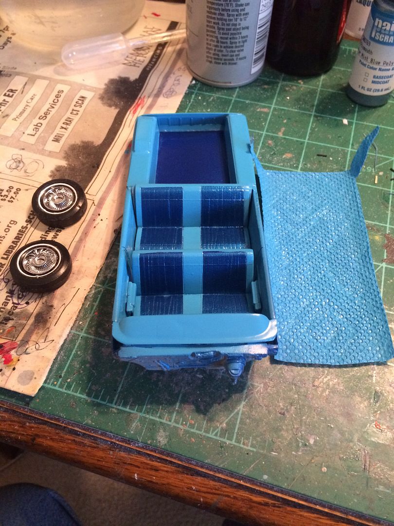

Mopar - D Posted November 9, 2014 Author Posted November 9, 2014 Thanks Tom I was wondering about that too it seamed to big a pattern. Well I did not like the color of the interior as it looked to dark for what I was trying to get so now it's a lighter blue with dark inserts I think it's closer to what it should be now. Also I now have color on the body. I added some black wash on the wheels too.
impcon Posted November 9, 2014 Posted November 9, 2014 Dan, This is really, really looking good! Your decision to repaint the interior was a wise one I think and those stock caps look oh so righteous!! Respectfully, I concur that a finer weave material for the headliner would look good but then, that's just my thought. Believe me, I am not criticizing. I've never seen a headliner done this way before so yeah - it does look awesome just as it is and is a vast improvement over just leaving it bare plastic. The headliner in my 1:1 was I believe, a kind of perforated hardboard with "chrome" plastic strips that ran across the headliner where the panels joined, rather than the normal vinyl or cloth. It's been a few years and I could be wrong on the material so if someone else knows better, feel free to correct me. I thought that I was wrong about something once - but as it turned out, I was actually right. You are doing wonders with this and it sure is looking a lot like the 1:1 that I had which was a light silver blue like your car with the interior being a very pretty blue - kinda like your car. I'm wishing now that I had kept it after seeing this build. Nice work.

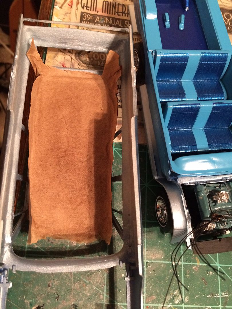

Mopar - D Posted November 9, 2014 Author Posted November 9, 2014 Thanks Gary I know about the head liner bars you mentioned and was already planning on putting them on. Ran over to our mall with my wife and picked up some napkins that have a smaller texture pateren that I'm going to try.

Mopar - D Posted November 10, 2014 Author Posted November 10, 2014 Thanks Dennis, Tommy the kit comes with tail lights for the Fury I trim level that only had the lights on the outer ends. Tom your seats look good. I've got Cinninbun napkin drying in place now.
Mopar - D Posted November 12, 2014 Author Posted November 12, 2014 (edited) Here's try #2 with a napkin I think this will much better with a finer texture. Edited November 12, 2014 by Mopar - D

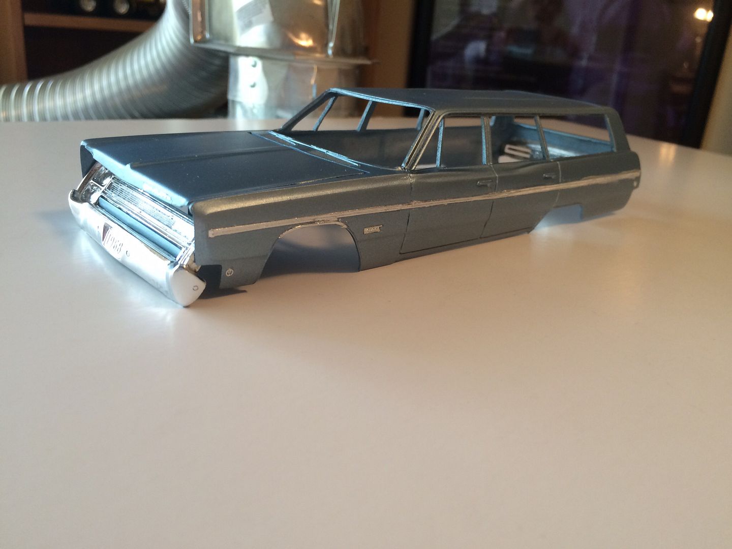

Mopar - D Posted November 14, 2014 Author Posted November 14, 2014 Started some BMF on the side trim molding and trim paint before clear coating.

Tom Geiger Posted November 15, 2014 Posted November 15, 2014 Dan- That left side BMF could use some clean up. I often take photos of my in progress builds just to see things that aren't apparent as I look at the model. You can just scribe lightly (no more pressure than drawing with a pencil) at the edge of the trim and carefully pull away the excess with a toothpick. If that doesn't work, it's easy to pull the BMF off and try again. It's one of the aspects of your model where you get do overs! You did such a good job of creating that trim, I just had to speak up. You can get it perfect!

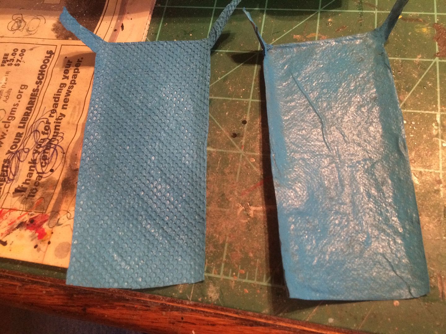

Mopar - D Posted November 15, 2014 Author Posted November 15, 2014 Thanks Jim the head liner came out better after it dryied it took like 3 days. Thanks Carl I like the lighter blue interior better. Thanks Tom yea I'm not done with the left side I'm like you I think I'm done until I take the pictures and then I see that I'm not. Yesterday was my grand daughters birthday so I did not get time to fix it before posting.

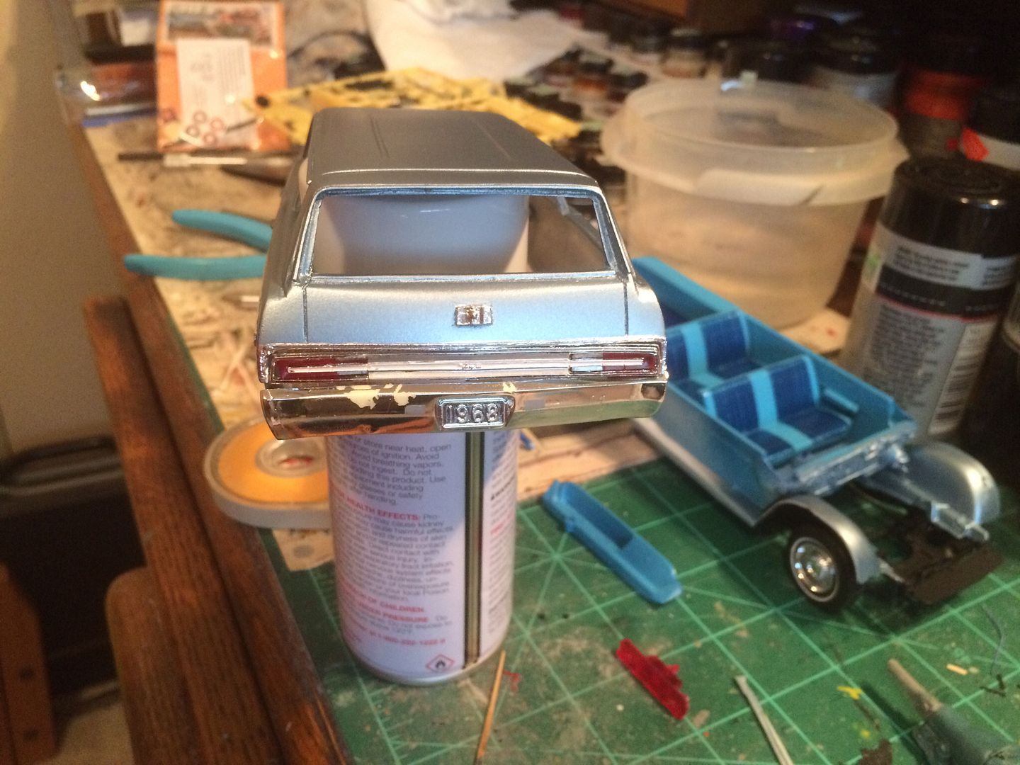

Mopar - D Posted November 15, 2014 Author Posted November 15, 2014 Here's the 2 nd head liner and this is where I'm going with the rear grill and bumper. My chrome peeled when I masked off the back up lights. Will need to come up with a fix for that.
DynoMight Posted November 16, 2014 Posted November 16, 2014 You could wrap the entire bumper in BMF, and try to get it as smooth as possible. Or you could de-chrome it in bleach and Alcad it.

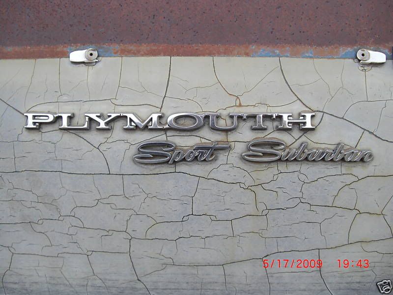

Sport Suburban Posted November 16, 2014 Posted November 16, 2014 Dan, this is a very nice built but I have to pipe in on this one. Jim, The wagons were in fact named Suburban by Plymouth. The name was used from 49 to 77. I currently own two of them. Hence my avatar name and picture. Here is a picture of my 70 tailgate that has the name plate still on it. I can tell you I spent years looking for replacement nameplates for my Sport Suburban as they were easily broken. I have a set of Custom Suburban emblems also.
Sport Suburban Posted November 16, 2014 Posted November 16, 2014 I will say that many people call them Fury wagons because that is what they are based on but Plymouth did not. Here is a shot of the correct fender emblem that would go on the 68 model Dan is building here. It goes in the same spot on the fender that Fury I is on a car.
