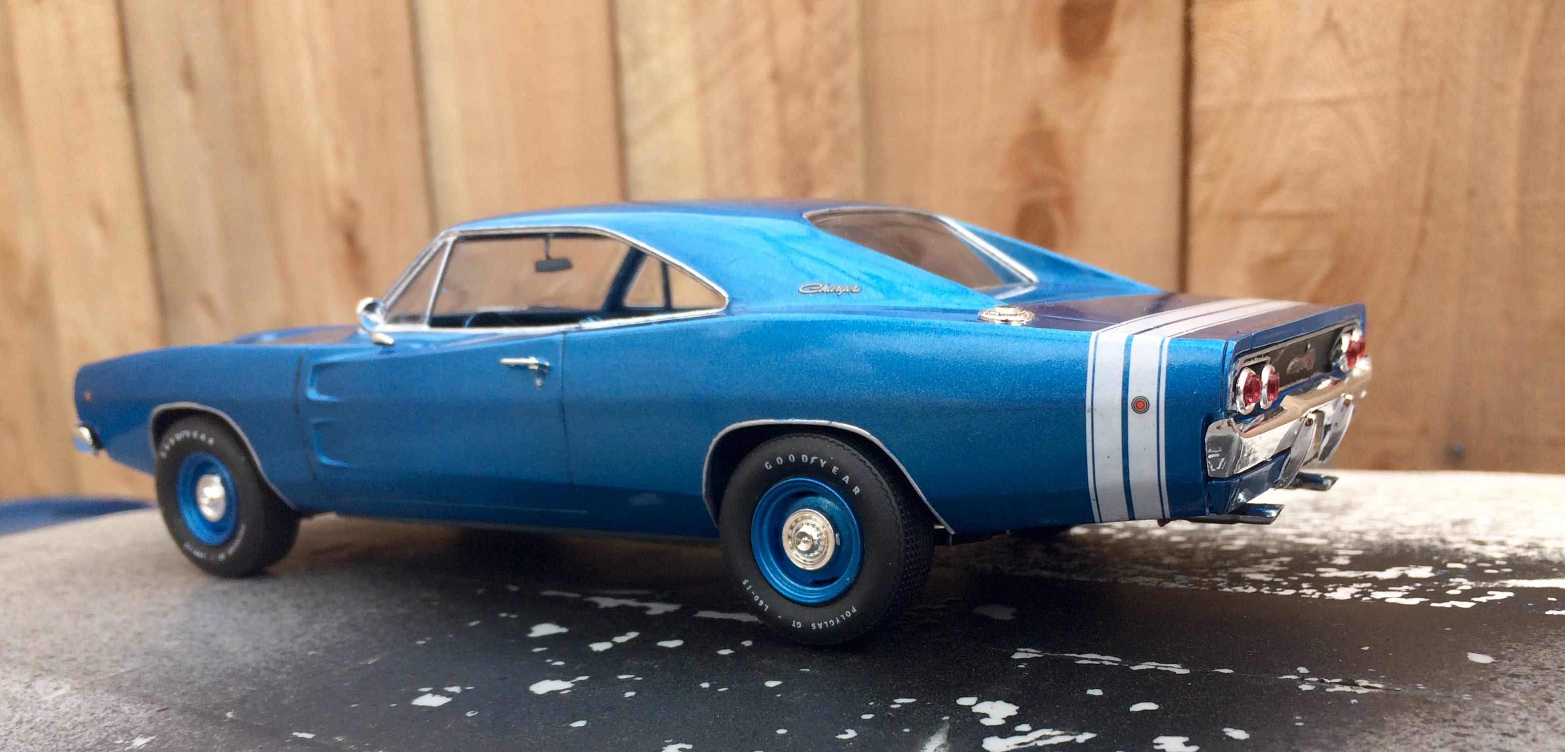

Kmb0319 Posted August 4, 2017 Posted August 4, 2017 (edited) Great work so far, Mike!!! I don't want to steal your thread, but other than wheels, we had the same idea... Tamiya TS-54. Good luck with yours... I'll be watching this one for sure! Edited August 22, 2017 by Kmb0319 Saving space
mrmike Posted August 4, 2017 Author Posted August 4, 2017 Well Kevin, I guess I'll just throw this kit back in the stash since someone already built what I wanted to build! LOL Just kidding! That is a great looking Charger, Kevin! Now i have an idea of what mine will look like with Cragar SS mags and if I can find one, a Hurst T-Handle for the stock shifter. I think there's a racing shifter with a T-Handle that I can steal the T-Handle from in the kit!

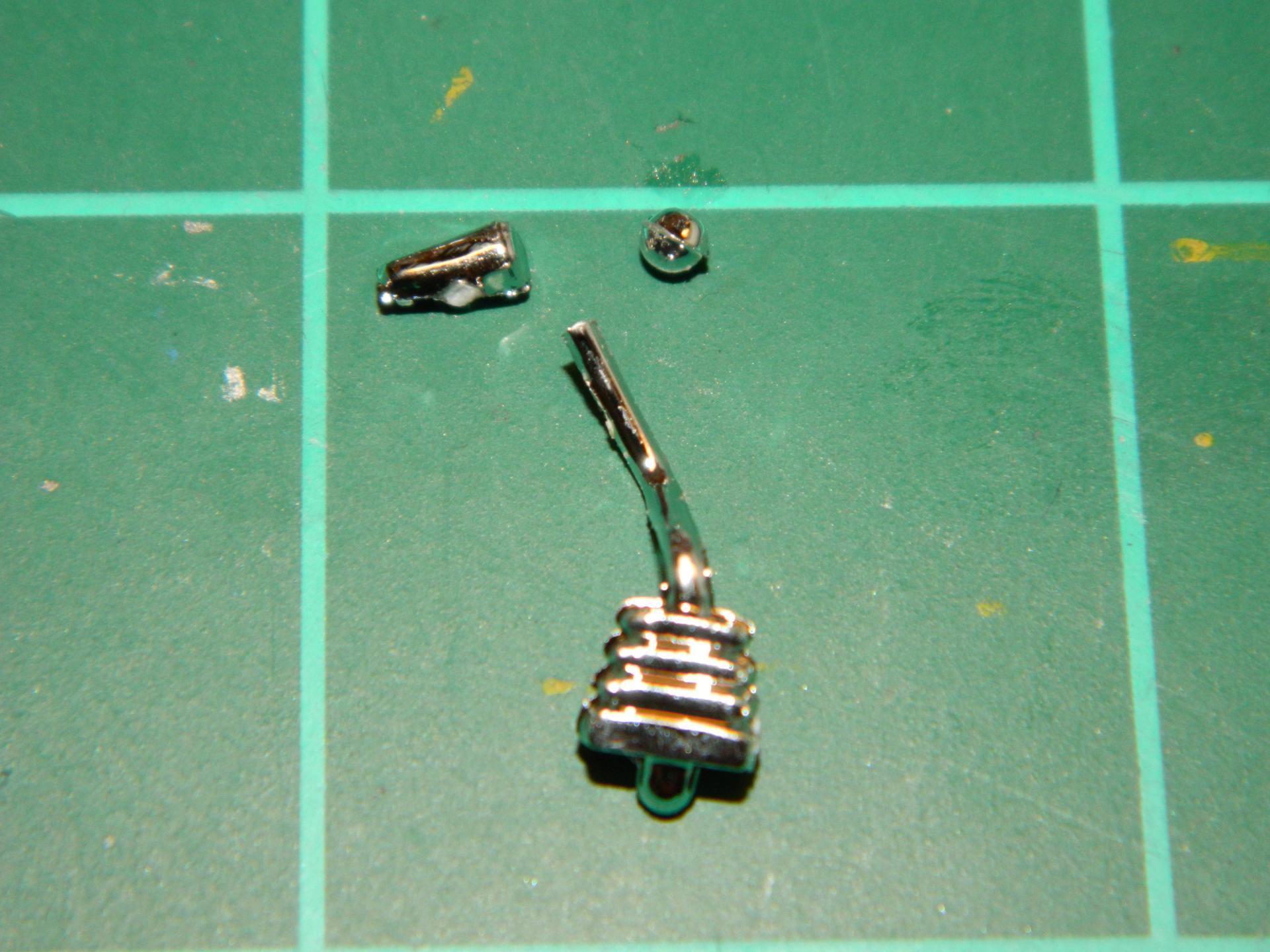

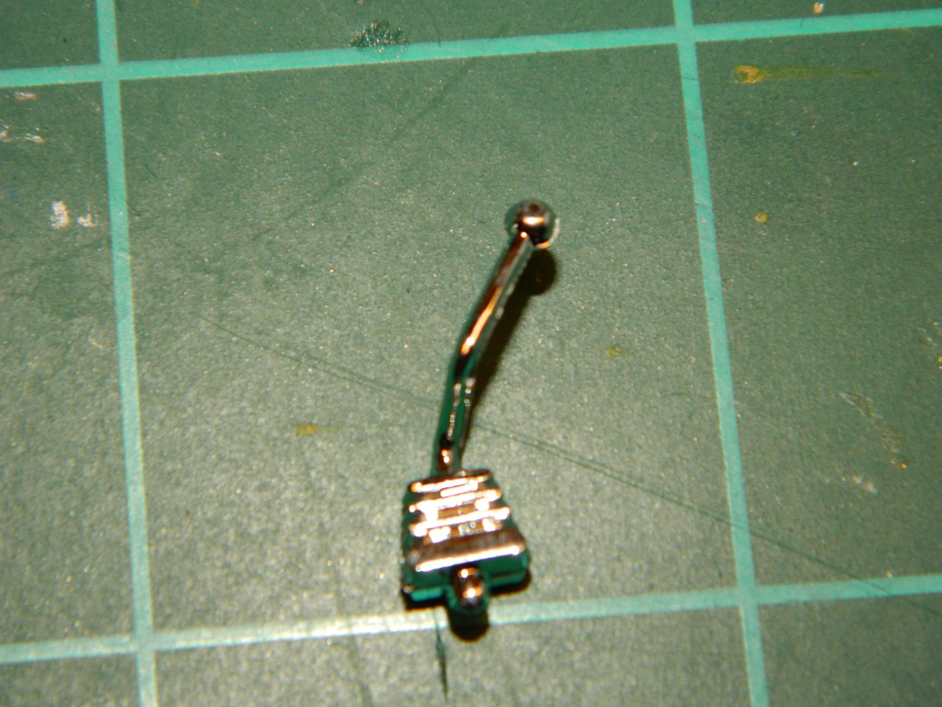

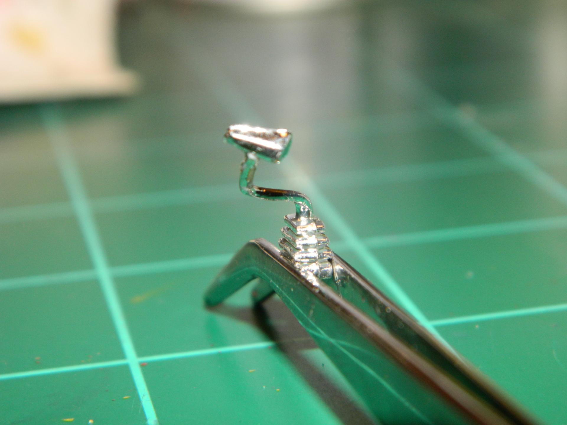

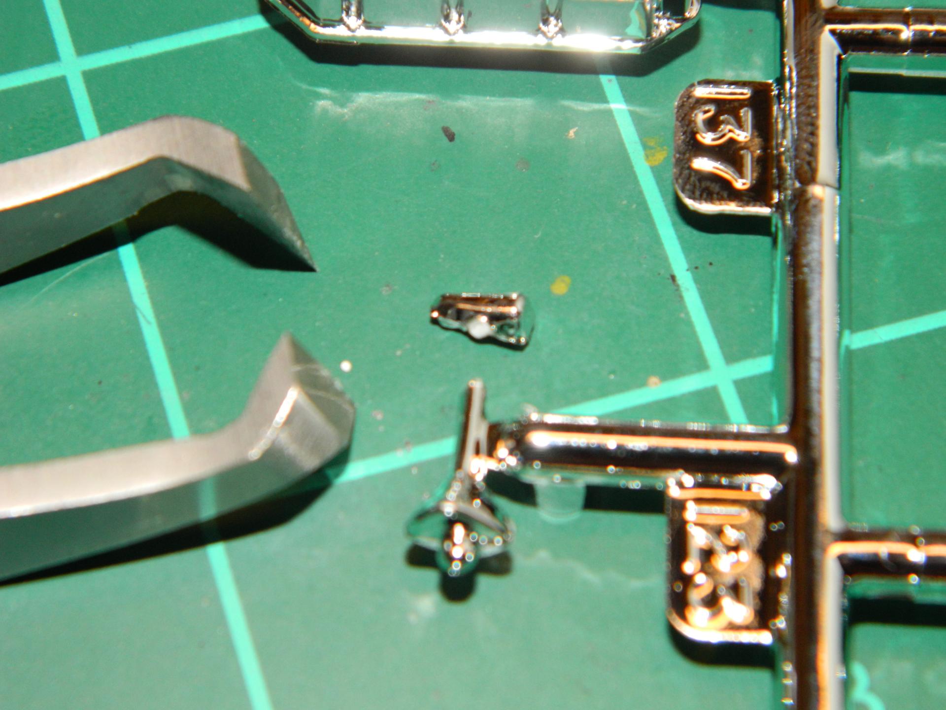

mrmike Posted August 16, 2017 Author Posted August 16, 2017 (edited) I had this in mind for the stock shifter. I took the racing shifter and cut off the T-Handle. Then I took the stock shifter and cut-off the shift ball. Using a pinvise and a drill bit the size of the shifter shaft, I drilled a hole in the T-Handle and then I glued the handle to the shifter shaft. I now have a T-Handle for the stock shifter! Paint the boot black and the handle aluminium and I'm done! More Mopar to come... Edited August 16, 2017 by mrmike

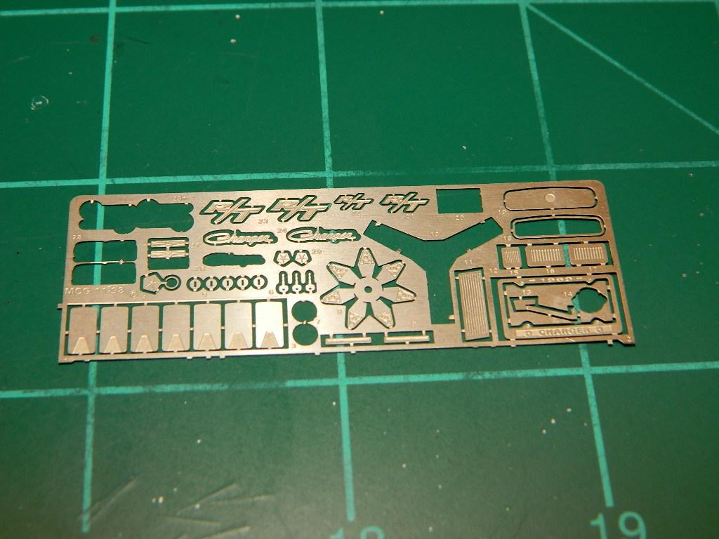

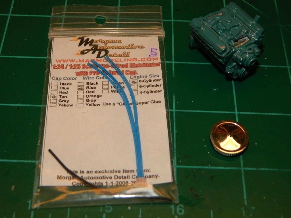

mrmike Posted September 10, 2017 Author Posted September 10, 2017 I was rummaging around the parts box and came across this photoetch set that was left over from another project. I am using a distributor from MAD and maybe the chrome air cleaner on the 440 CI engine. The 426 Hemi is complete except the distributor fell off somewhere and disappeared on me. Good thing there is a second distributor in the kit!

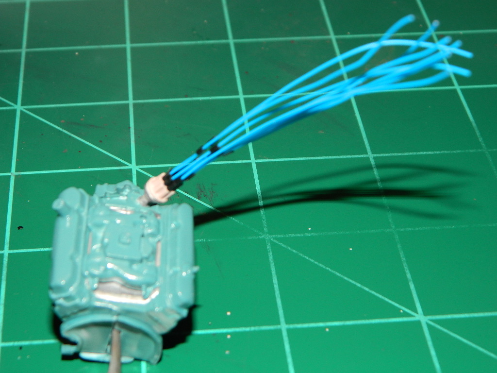

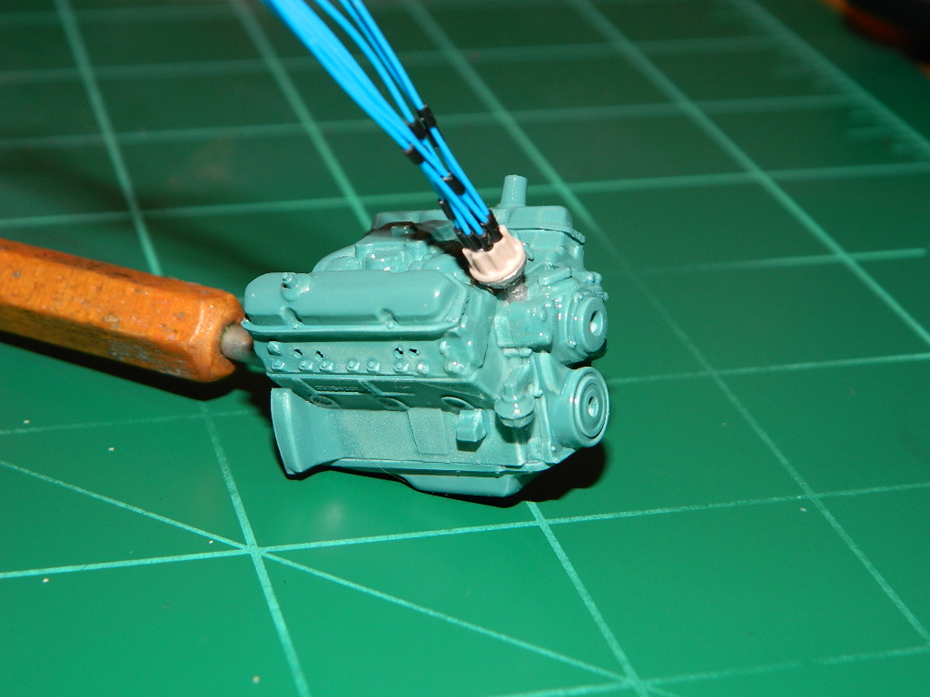

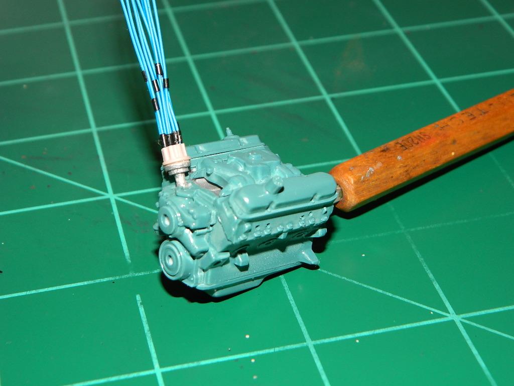

mrmike Posted September 18, 2017 Author Posted September 18, 2017 Progress on the Charger has been very slow. I got the MAD distributor assembled, painted, and installed in the 440 CID V-8. Now to run the wires and finish the engine. More Mopar to come...
Roadrunner Posted September 18, 2017 Posted September 18, 2017 Looking real nice. I've yet to use any P.E., but look forward to trying some.
afx Posted September 18, 2017 Posted September 18, 2017 (edited) Great project Mike. For what its worth I mixed up my version of MOPAR Turquoise from Tamiya bottle paint: X14 Sky Blue - 15 parts X28 Park Green - 1 part The block has a black wash over it as well. I didn't have a paint chip to compare it to but I'm happy with it. With more experimentation I think someone could get the mix very close to the factory color. Edited September 18, 2017 by afx
mrmike Posted September 18, 2017 Author Posted September 18, 2017 Thanks Kevin and JC! JC, I was fortunate to be able to get the can of Chrysler Engine Turquiose paint from Summit Racing! And, I still have plenty left for future projects. I also have a can of Mopar Street Hemi Orange that I got from Summit and that can has been used quite a bit over the years. I am noticing a lot more parts stores (Pep Boys, Auto Zone, etc) are selling engine paint and this color is showing up more often. I'm not sure if it is an exact match for the Mopar color though.

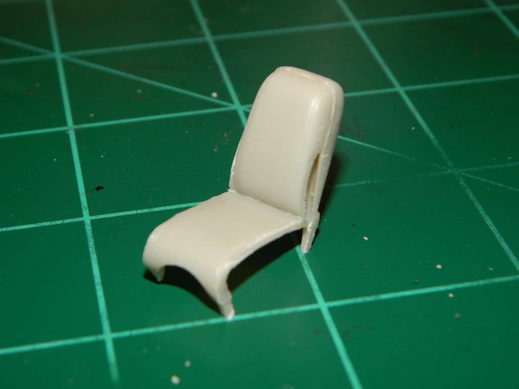

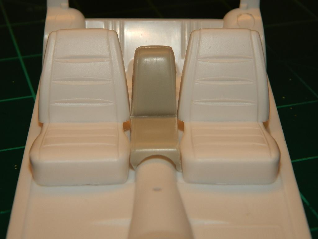

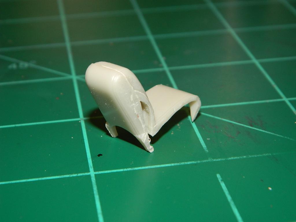

mrmike Posted September 26, 2017 Author Posted September 26, 2017 I dove into my parts box this morning in search for parts to make a buddy seat for my '68 Charger R/T. I found a bench seat from the AMT '71 Charger R/T and started to wonder if I could use the center section for this. I pulled out my razor saw and cut away the seats and removed the fold-down armrest and center cushion. A little sanding and trimming and I have a buddy seat. The buddy seat looks pretty good in a mockup. I need some more sanding and filling in the gaps in the seat cushion and the armrest and it should be good to go! More Mopar to come...

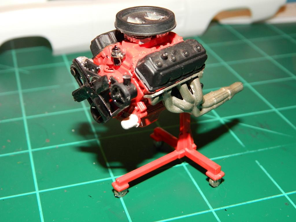

StevenGuthmiller Posted September 26, 2017 Posted September 26, 2017 Great project Mike. For what its worth I mixed up my version of MOPAR Turquoise from Tamiya bottle paint: X14 Sky Blue - 15 parts X28 Park Green - 1 part The block has a black wash over it as well. I didn't have a paint chip to compare it to but I'm happy with it. With more experimentation I think someone could get the mix very close to the factory color. It's pretty easy to mix your own engine colors if you're not overly picky. I mixed my own Chrysler, Buick & Pontiac turquoises, (all very close in color) from Testors flat bottle paints as well as Chrysler orange. I bought a can of Duplicolor Pontiac Turquoise Engine Enamel for my last project & it worked quite well. The Pontiac engine is Duplicolor, The Chrysler engine is a custom mix. Steve
Roadrunner Posted September 26, 2017 Posted September 26, 2017 Looking really excellent so far, and I love the extra seat.
