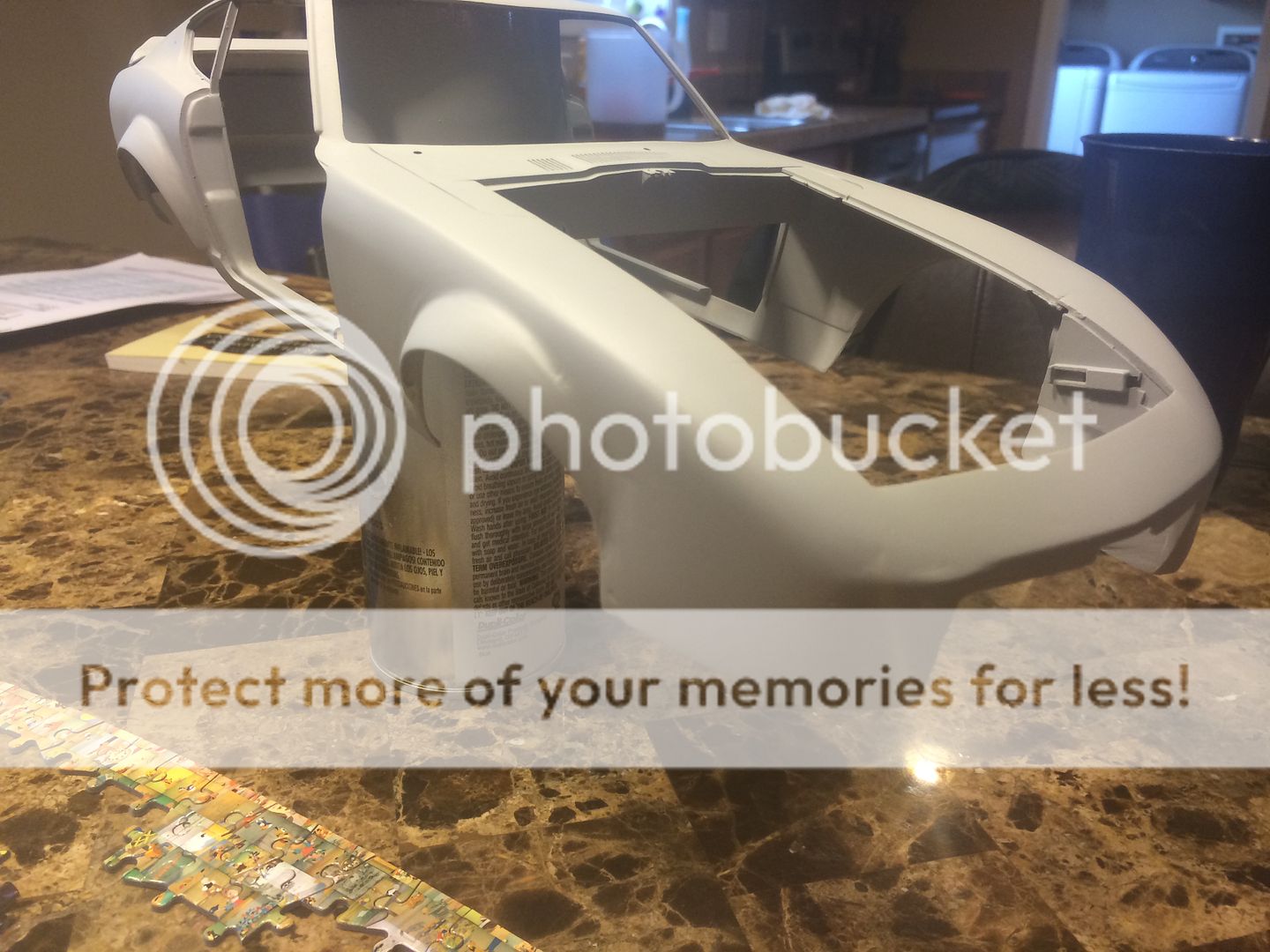

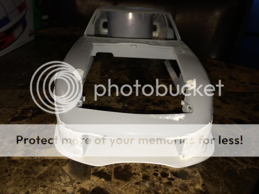

Got the front end smothed out and primed. Pic inserted as soon as i get back home

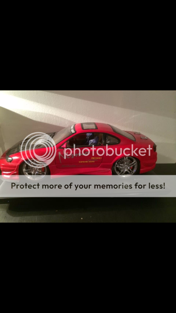

Here is a great little 1/12 i picked up on ebay
39A84ECC-B716-4A93-BC43-DE971966DE90_zps

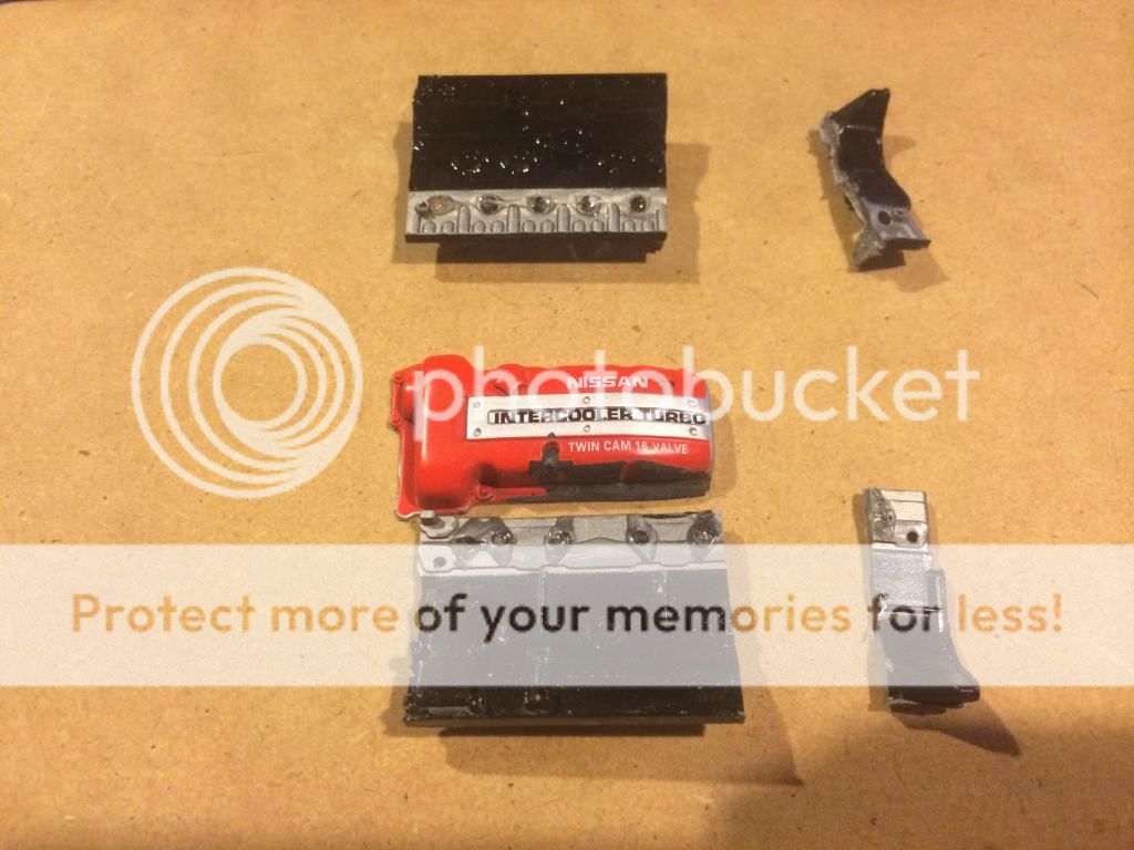

It has an sr20det engine and tons of tuner parts
Im using the engine on this build.
I will try to make resin copys of that engine/turbo and other things. The rims will be nice on another build. Endless cool parts.

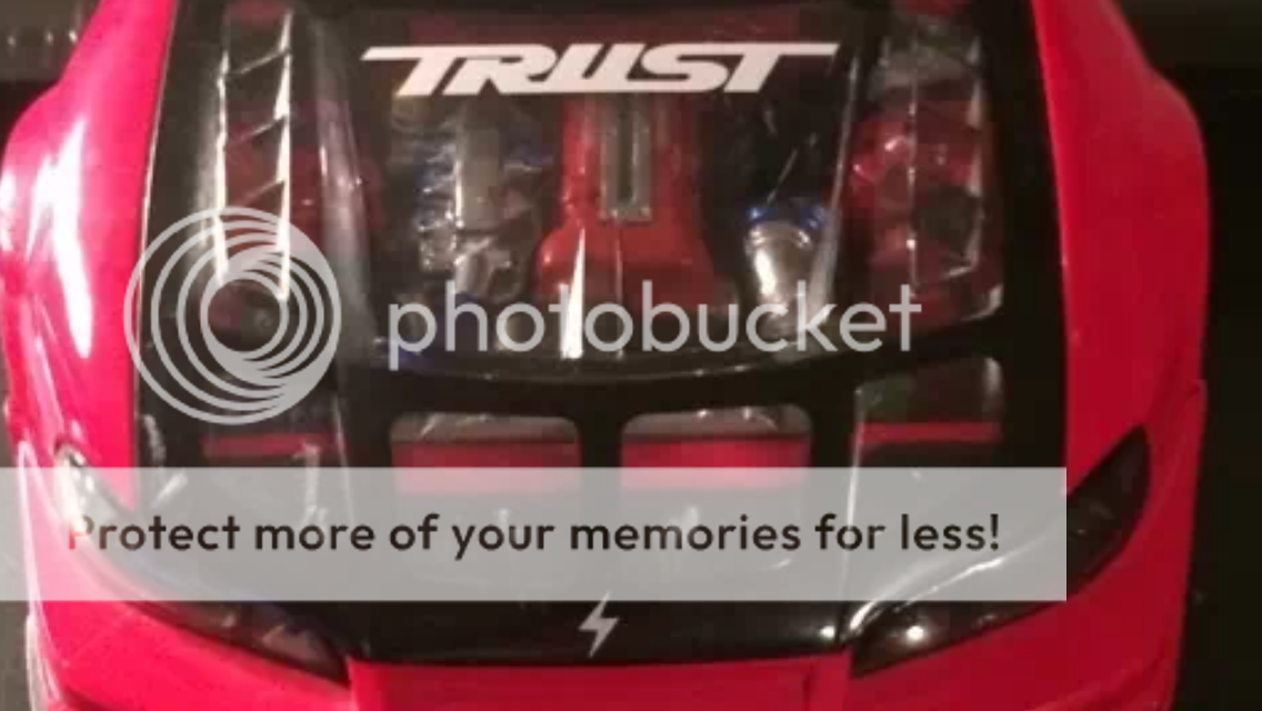

This was posted on another of my builds
A4D70E52-B0FC-4A56-A885-DF46C6188513_zps

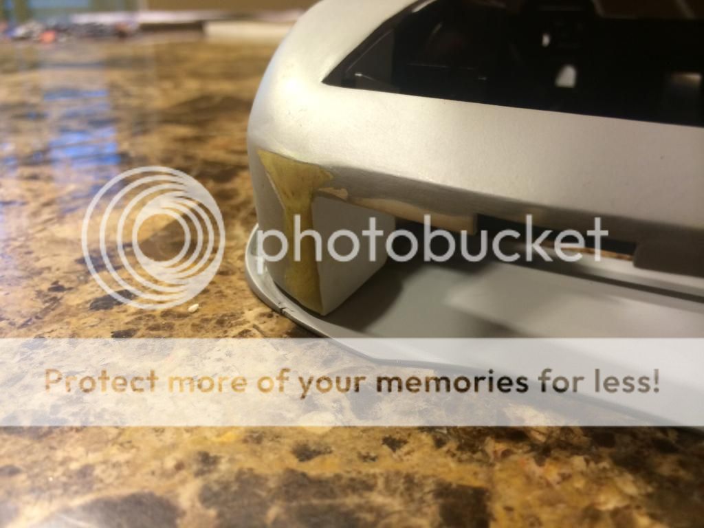

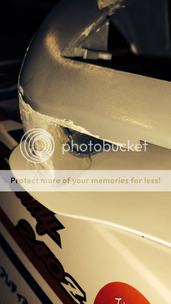

I cant stop this from cracking
B7BD7FC6-5BEA-486E-B047-1C4119E8C2AA_zps
I have fixed it twice
Any advice on how to fix this
70A4A22C-8B16-4358-842B-1B41541DA805_zps
It is where ca glue squeezed out when trying to get the rear deck installed. It was bent all up

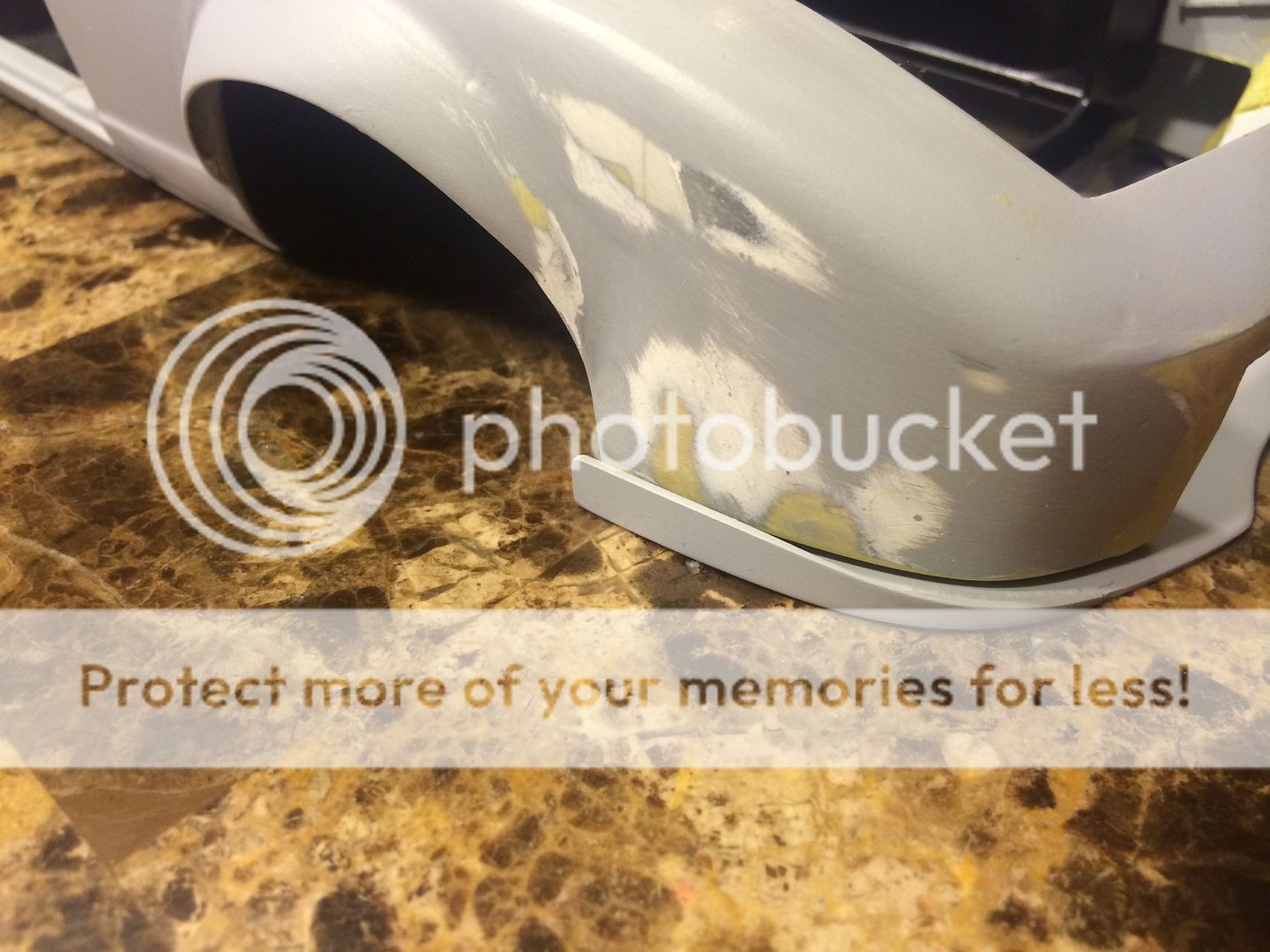

I'm liking how you molded in the wheel arch flares too.....very sleek.

Oh, and that rear hatch. Can you scribe out the excess super glue very carefully with the back pf an X-acto blade??

Thanks mister Stump for the kind words. The fender flares look to bolted on for a race car so thus the molding. Thanks for noticing

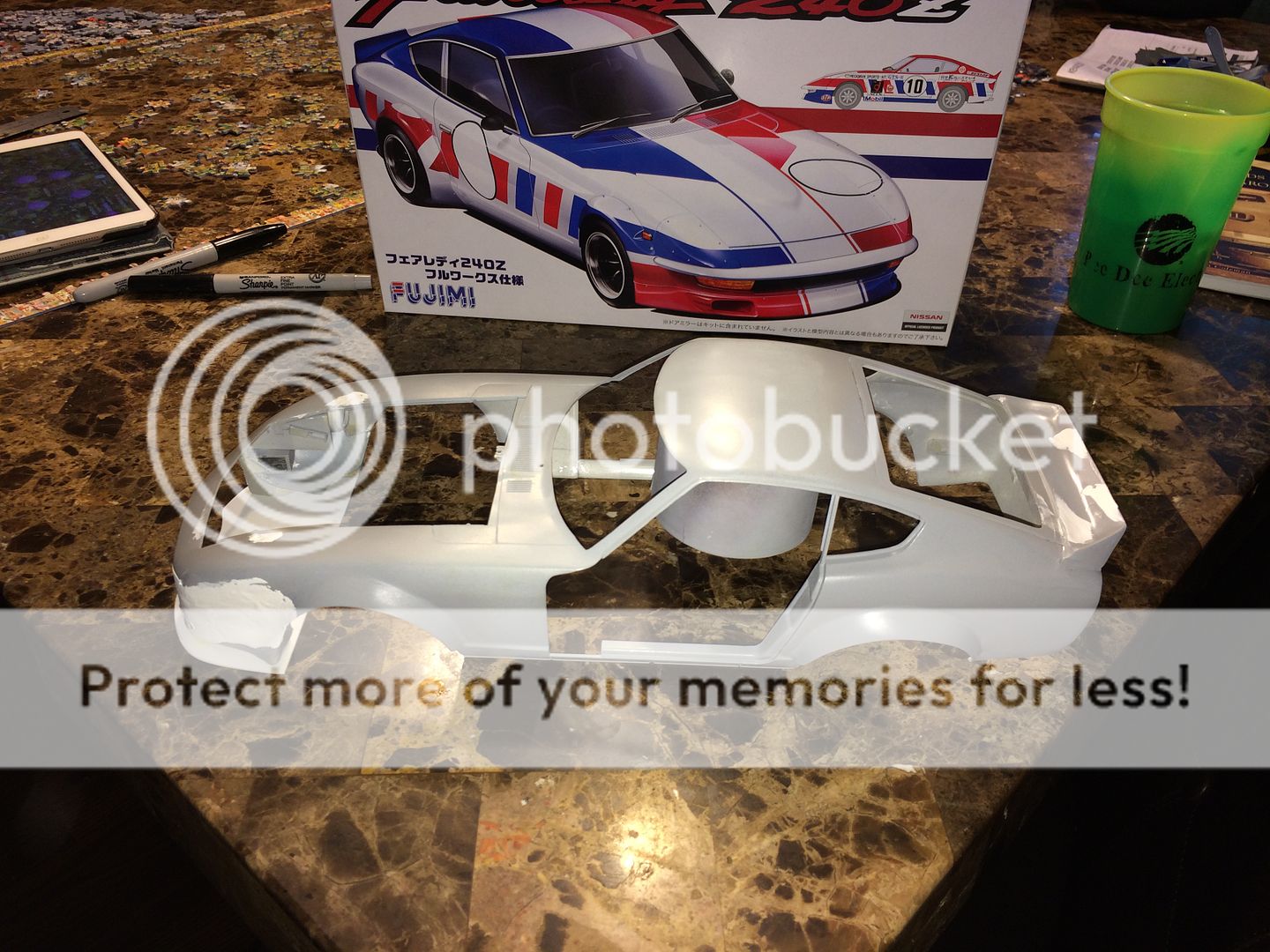

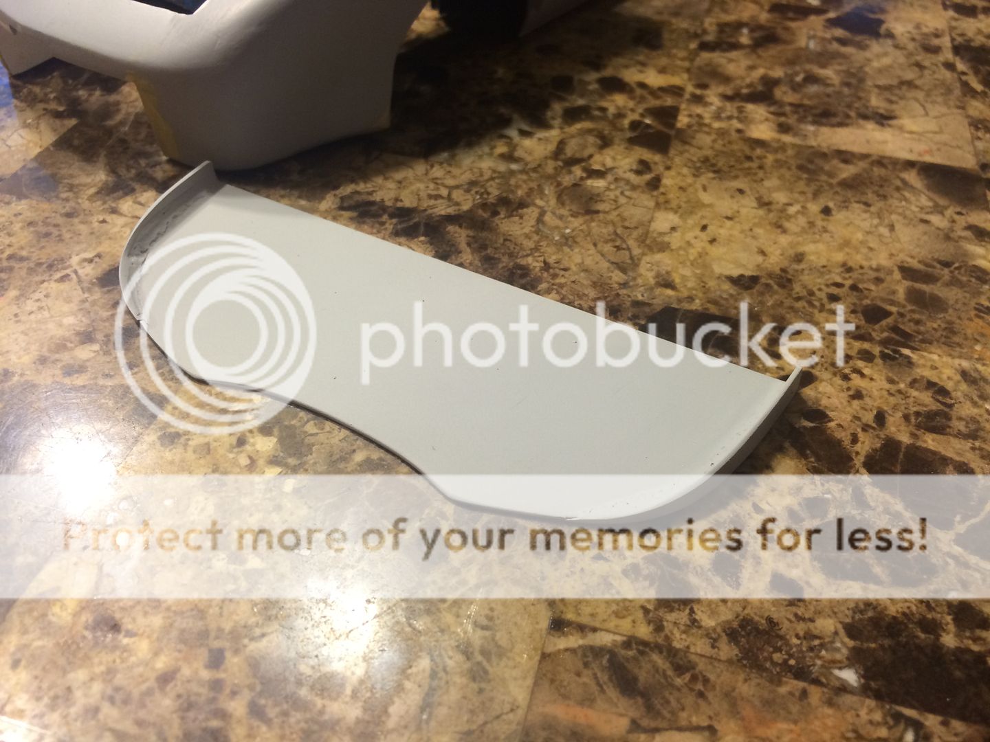

I doodled with the z for 4 hrs today and got no closer to getting the body ready for paint. I also made lip things for the air dam thing. Sorry for using all these technical words
82EBEF02-BA9E-4042-AA77-AD65503FABD1_zps
45F37A5E-DED8-4BD7-BFD8-D95AD2BD096B_zps

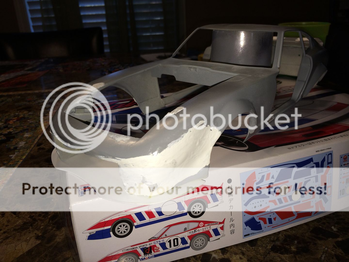

I boxed off the front of the kit with styrene sheet and filled in the back side. I may make air holes and run break cooling vents

I also remove the rear deck and broke it in the process. I removed all the glue and sanded it in areas so It fits better now.

For that part that keeps cracking......you could try a trick that I use when I cut apart and glue bodies together. Re-enforce the backside with ca glue soaked toiletpaper....sounds funny but it bonds to the surface like no tomorrow!!

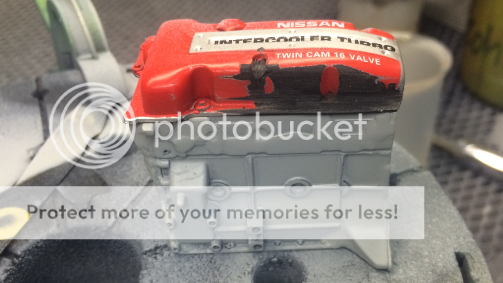

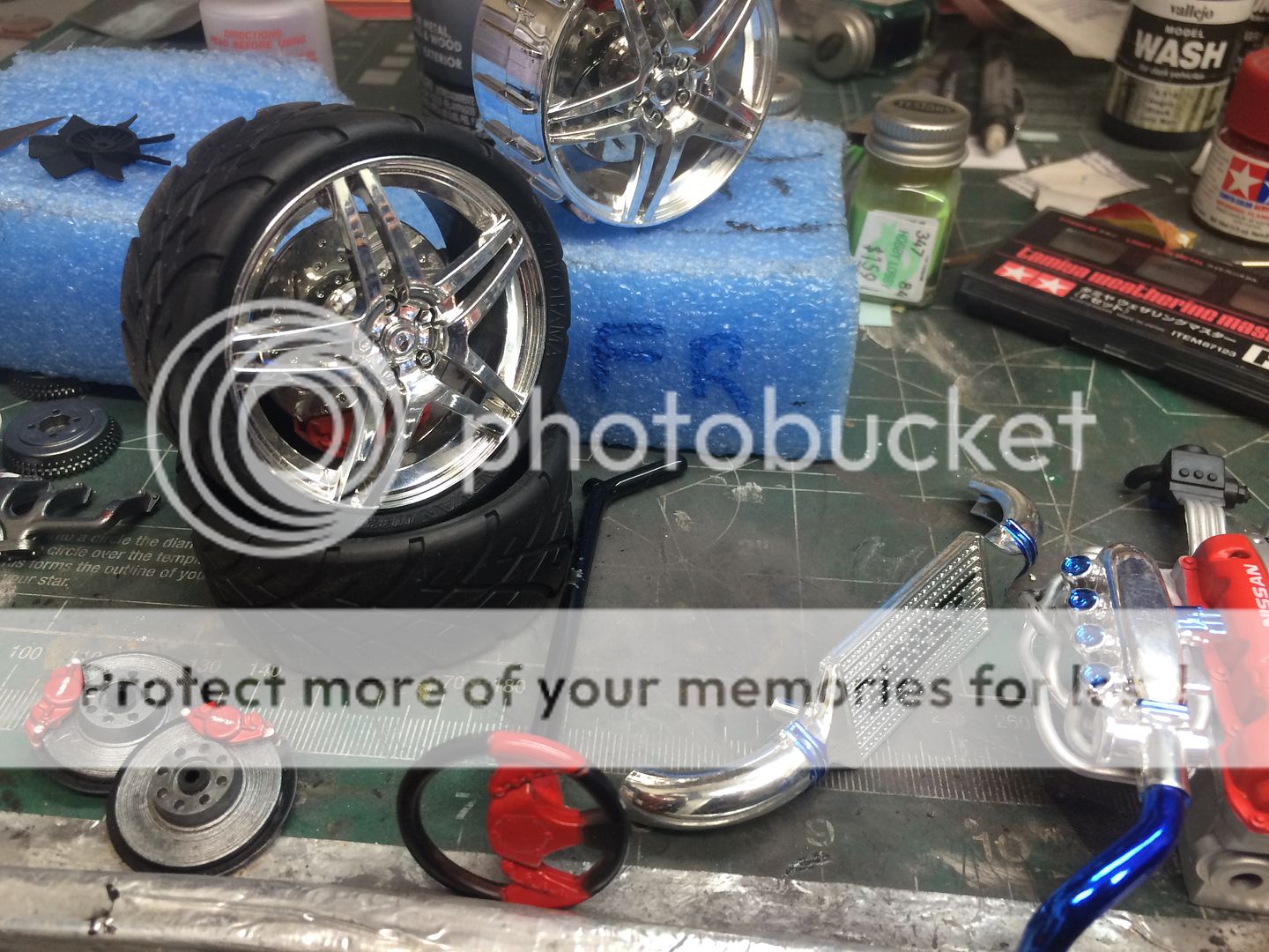

I have made changes to the engine to make it look more realistic. Pic up in a bit

I used the kit in line six engine to be the base of the sr20det. It was longer so i cut it to the right size and then fit in the transmission things at the rear of the enging
7CDFF018-595B-462B-A0C4-70CECD4E373F_zps
I also closed the intake and exhaust ports on the head to make way for the exhaust for the 4 cylender.
7AF86A44-11D7-4F13-9BA2-24A905FD99A1_zps
Im starting to fake the timing chain cover but it is not looking good on the first attempt
