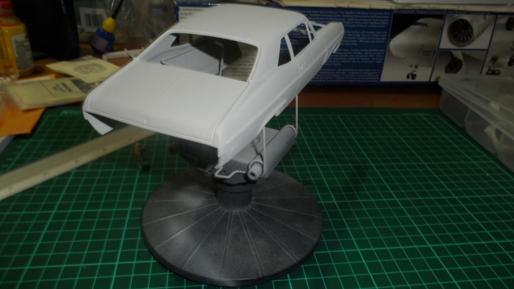

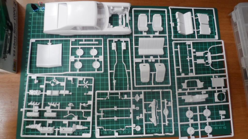

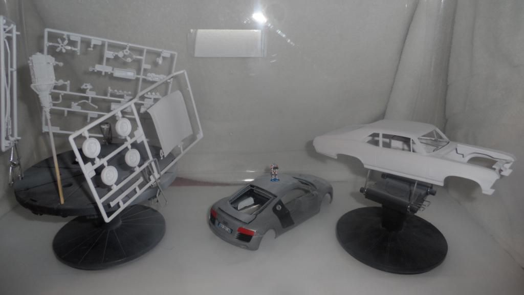

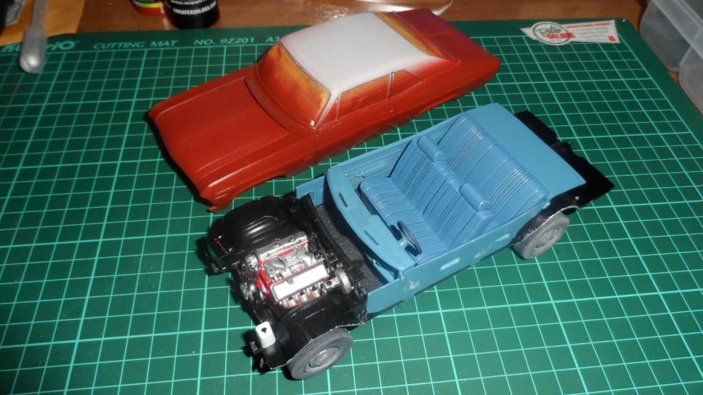

I based my model on the Chevy Nova Copo made by revell with some minor modifications.

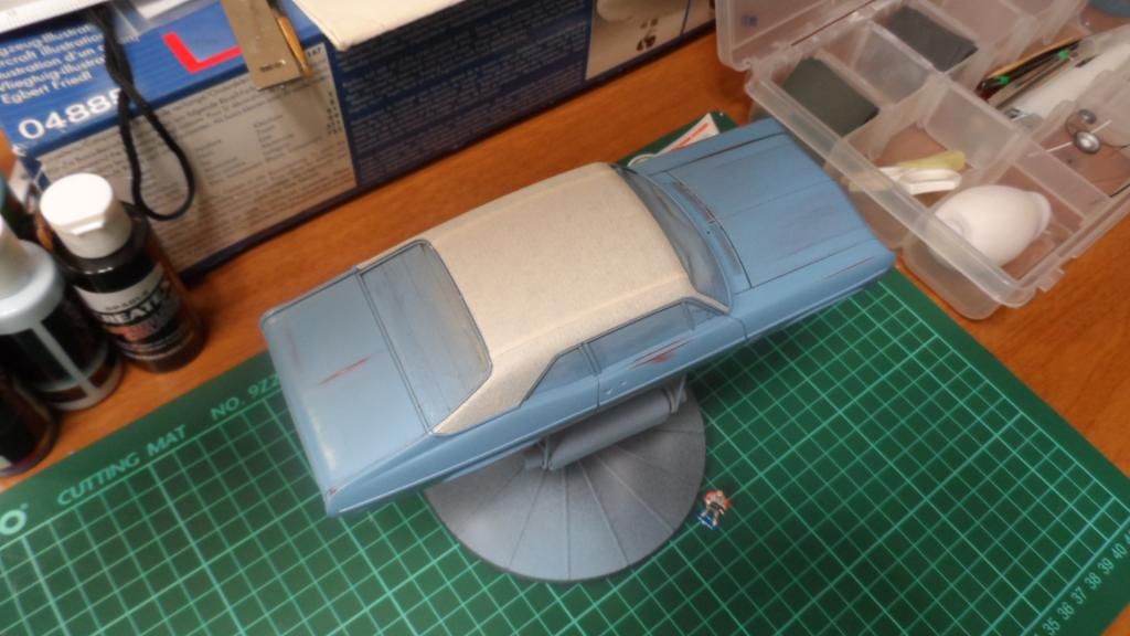

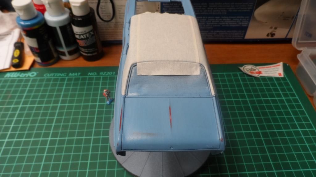

The basic idea is that this is a pretty weathered and rusty chevy car

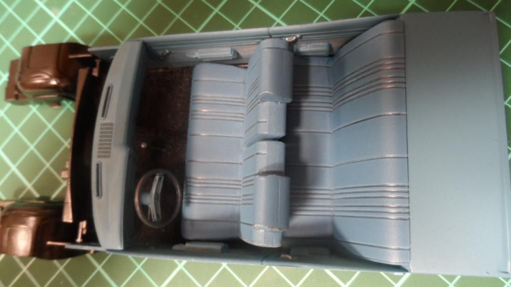

The kit is well manufactured, built in white almost with no flash what make the work easier.

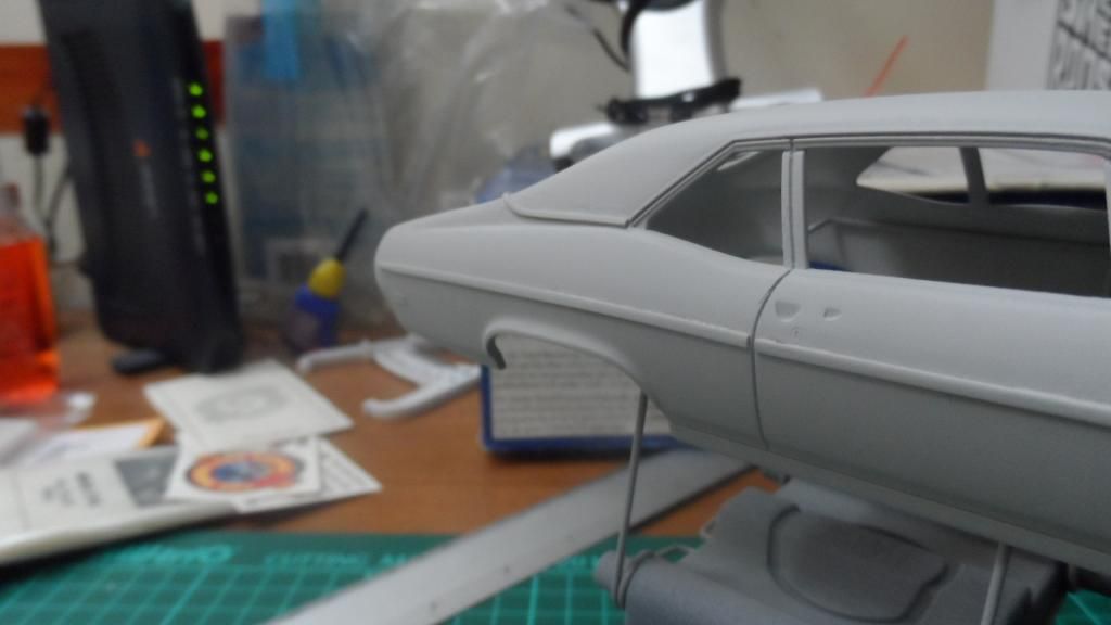

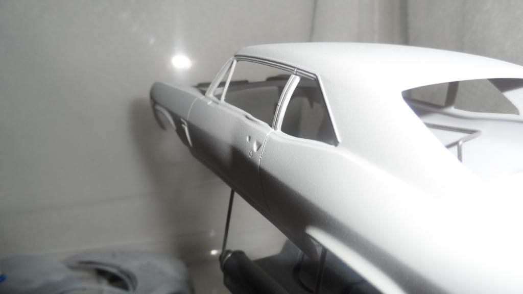

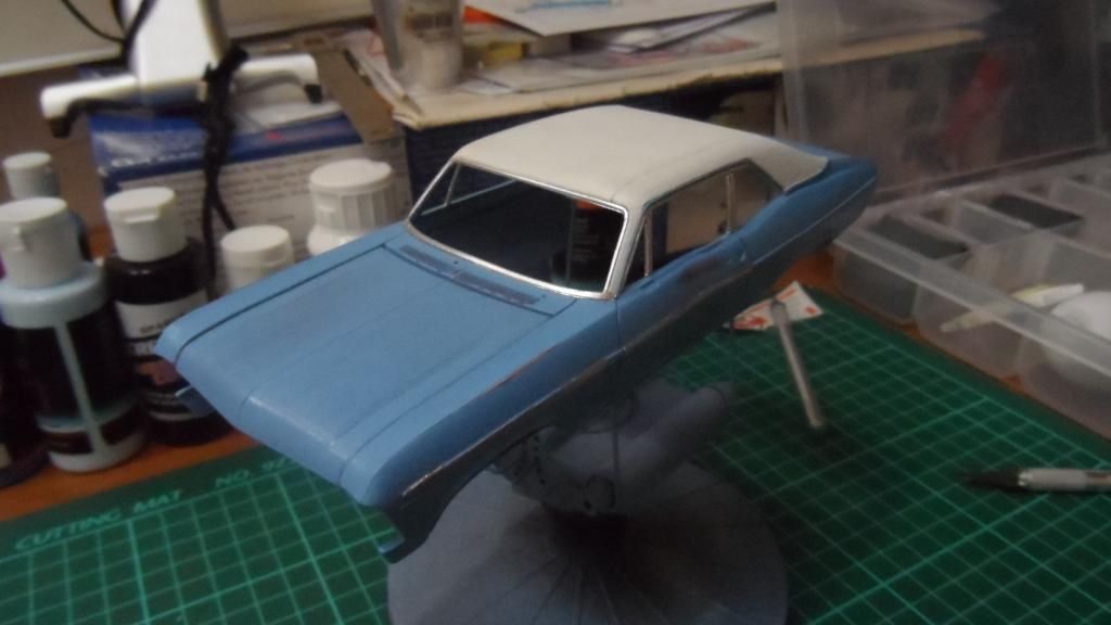

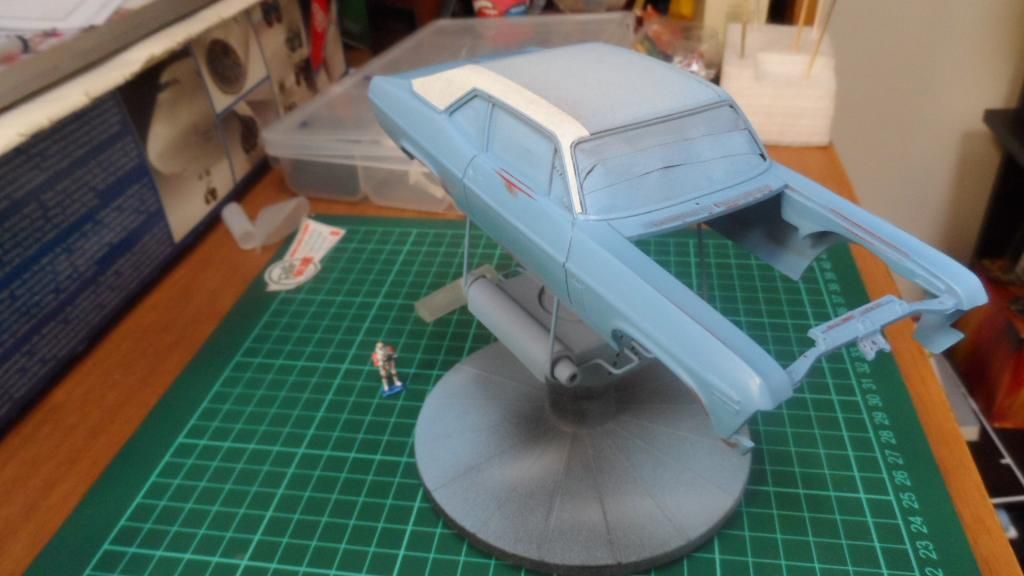

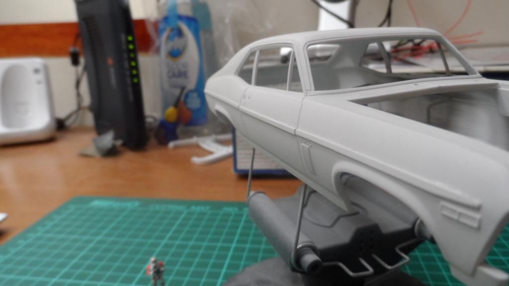

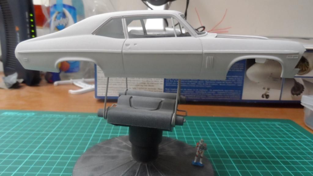

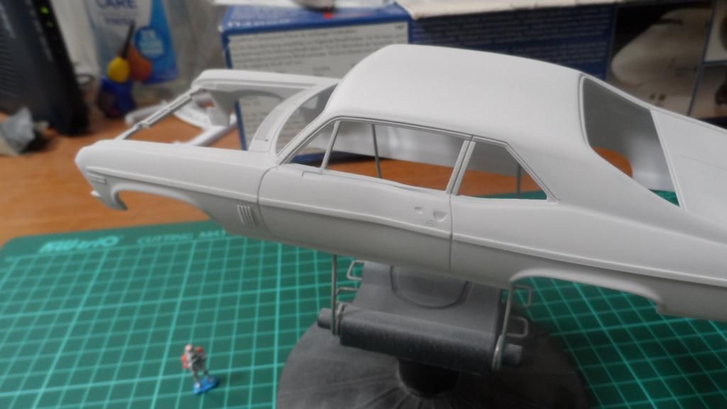

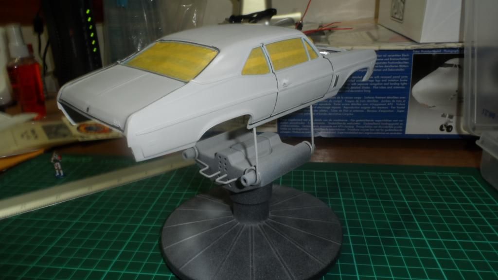

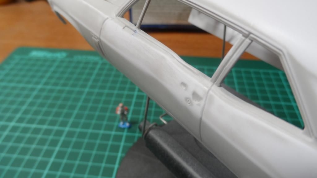

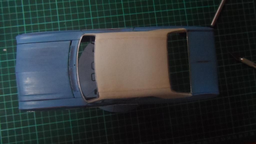

The initial idea was make some dent on the body due to the actual state of the car in the movie.

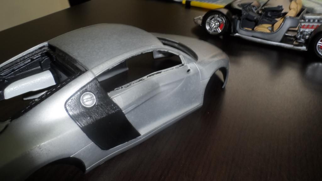

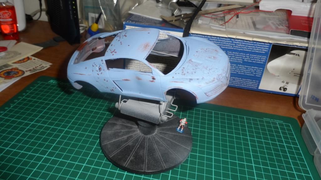

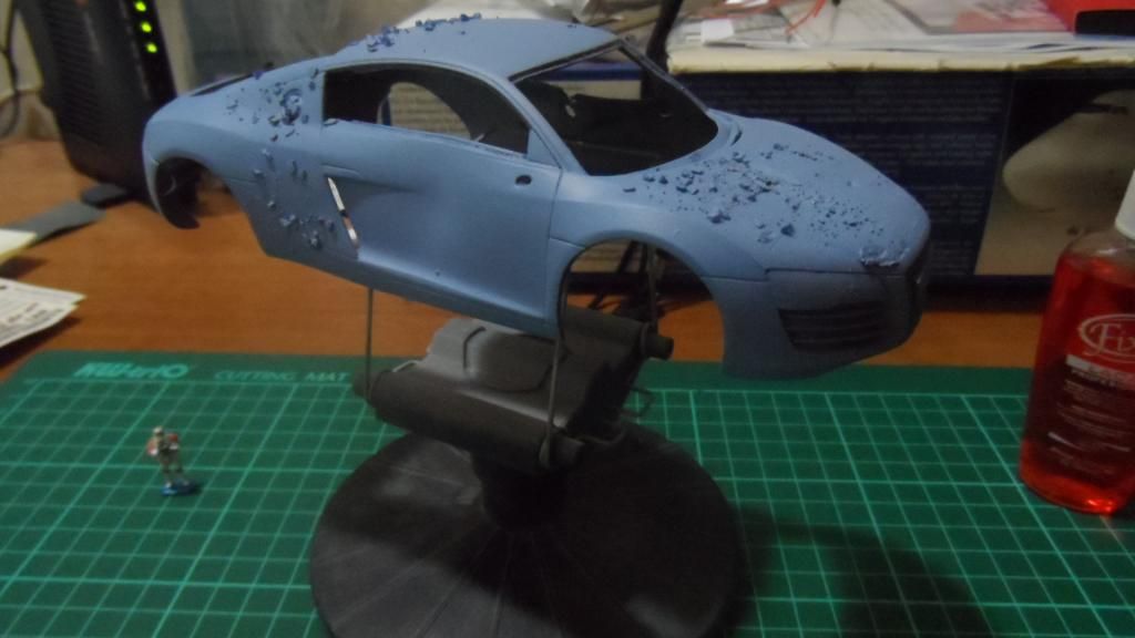

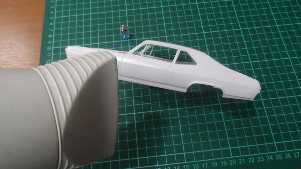

I did some tests onto an old model i have with some heat coming from a hair dryer

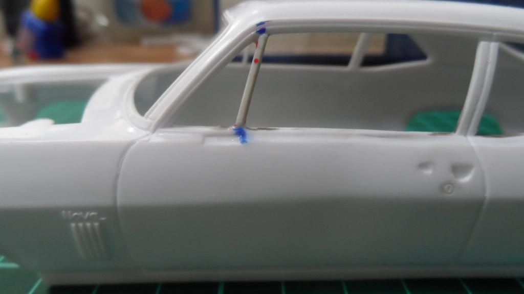

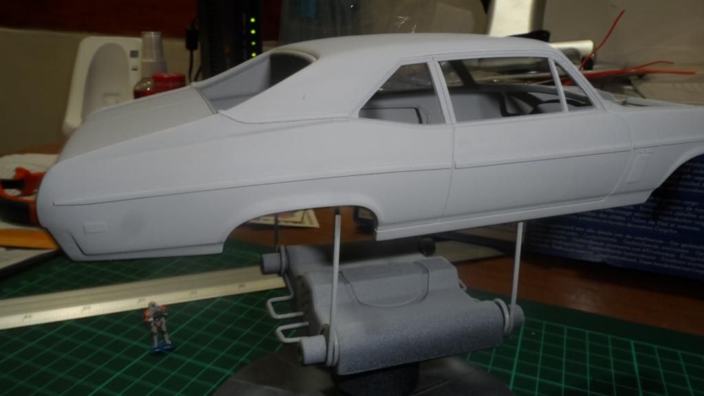

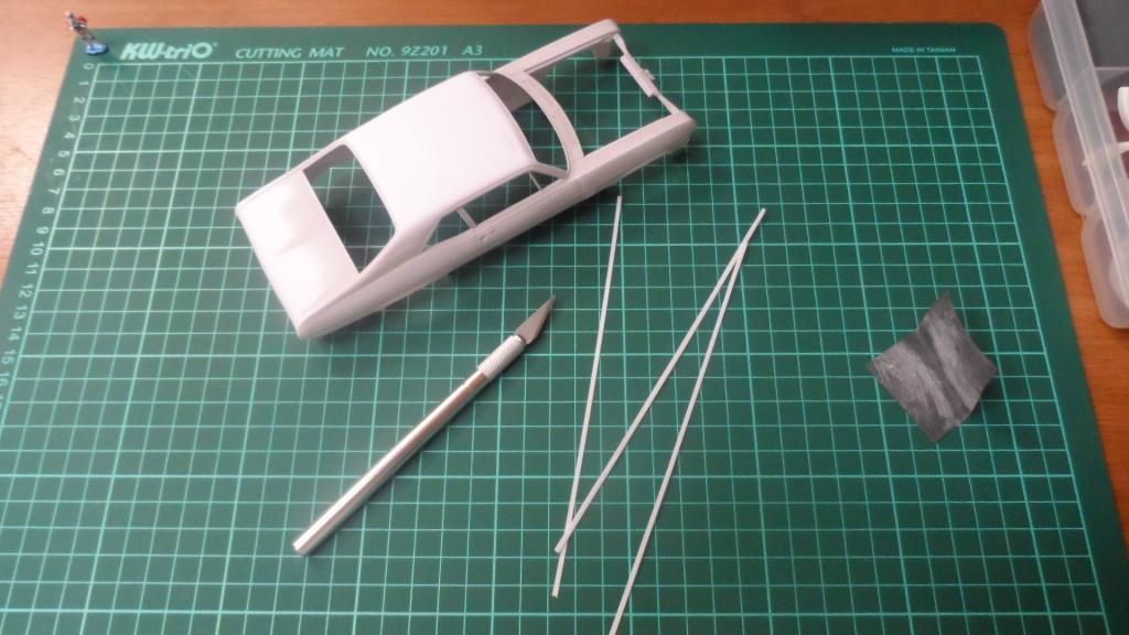

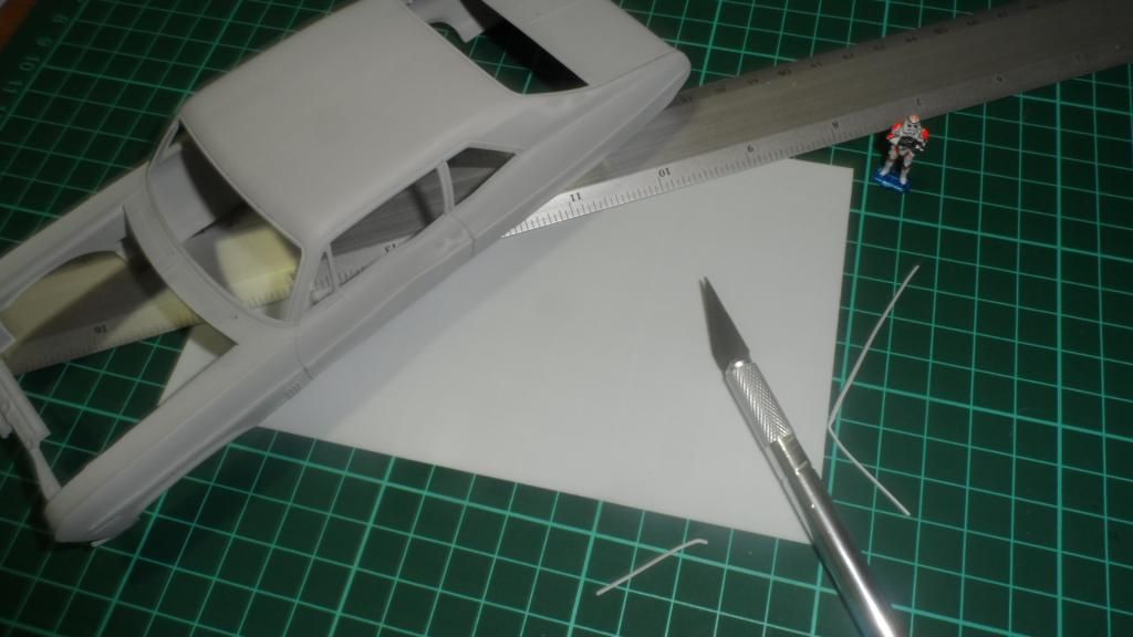

On this Audi it worked pretty good, the plastic was warped easy, however when i tried to do this on the Nova the plastic was really hard to warp no matter how much temperature i gave with the hair dryer., actually i ended breaking the left window pillar.[:S]
I repaired this window pillar with some styrene bar that i had.
The left door actually ended a little dent, i think im going to let it like that and not trying to do this on other parts of the car, because i can end breaking the full body

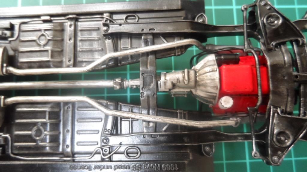

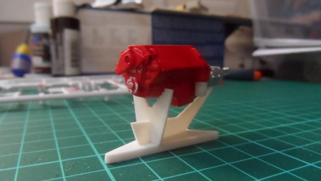

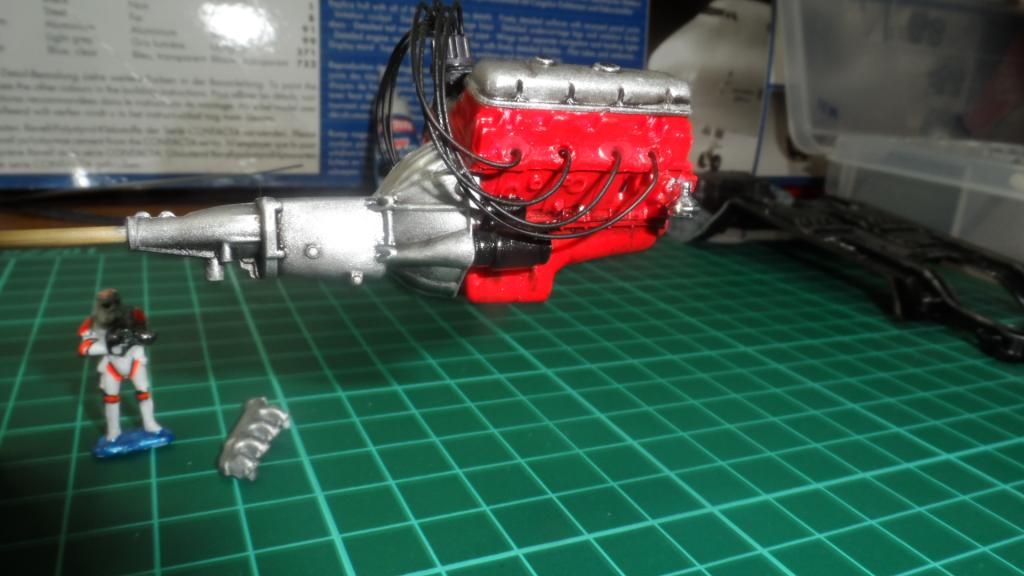

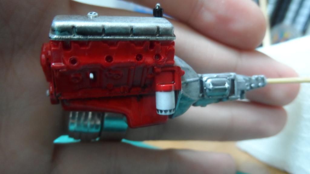

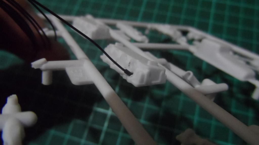

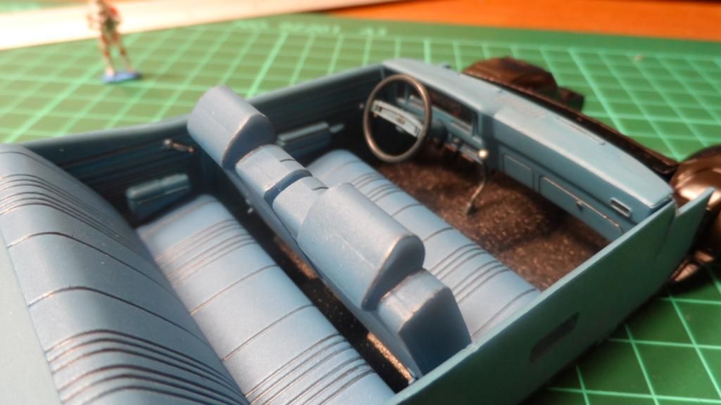

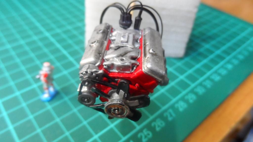

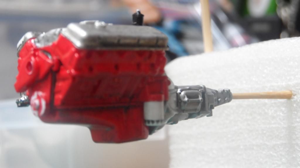

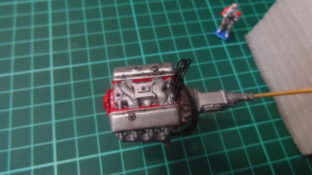

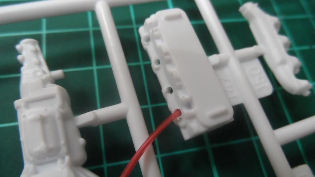

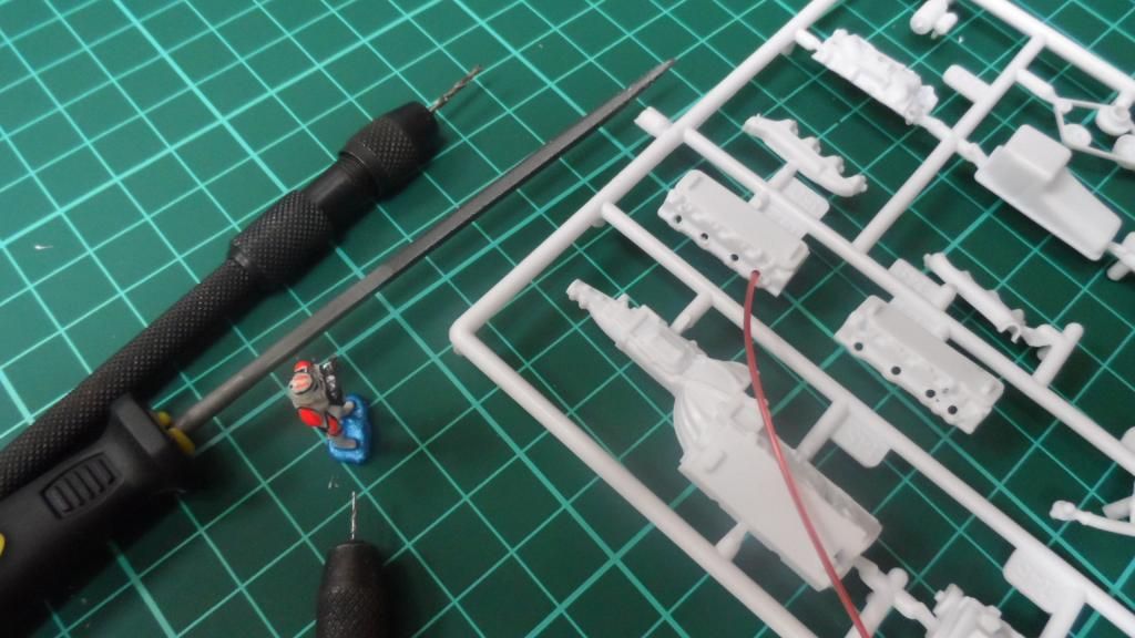

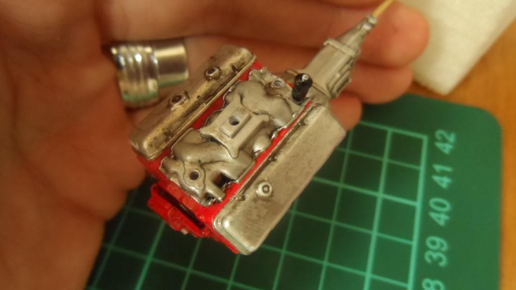

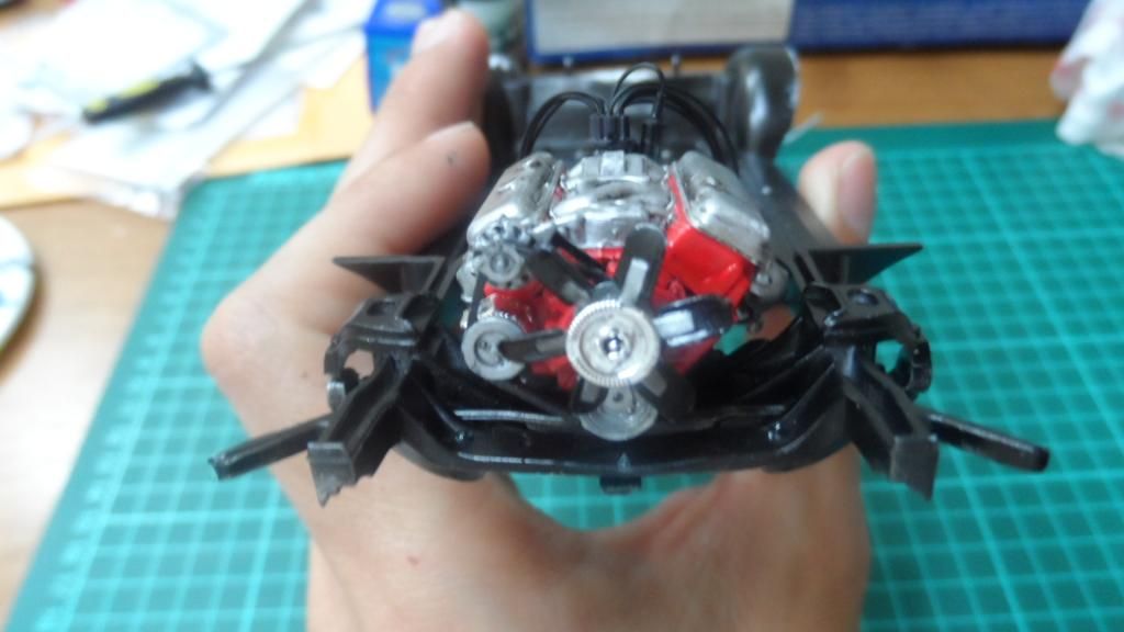

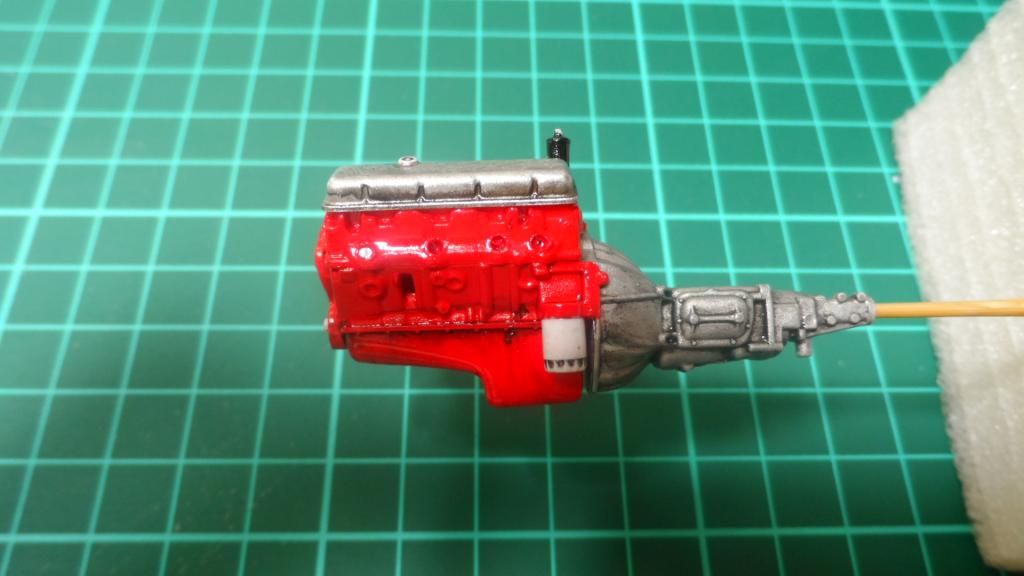

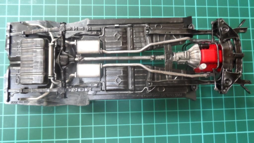

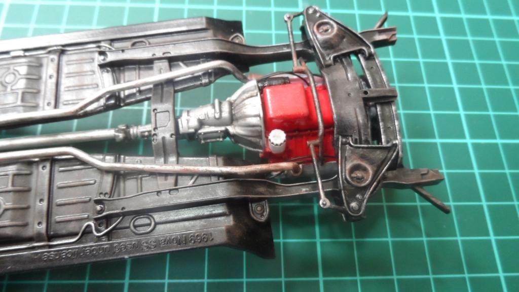

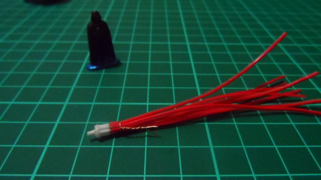

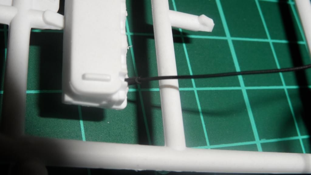

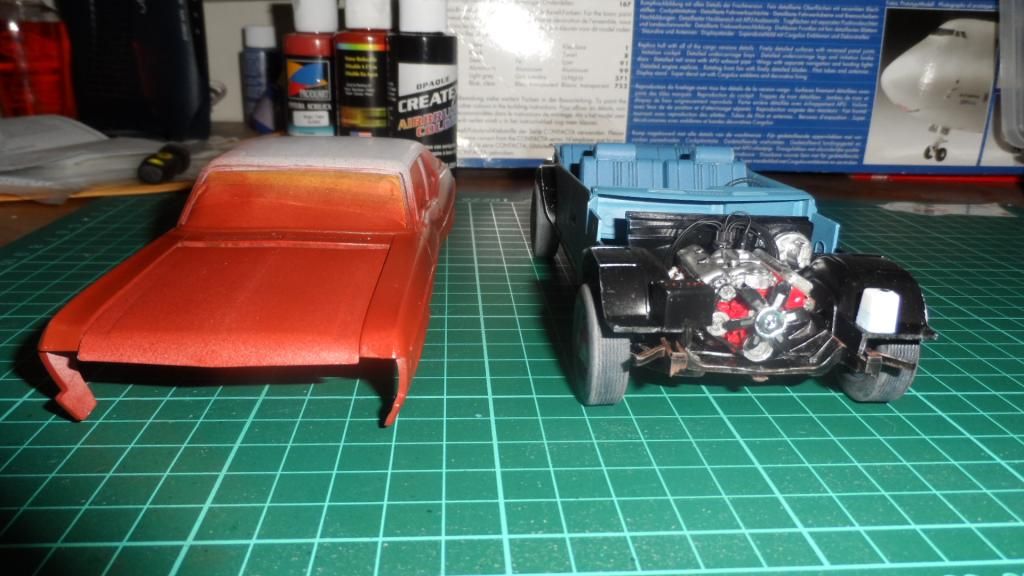

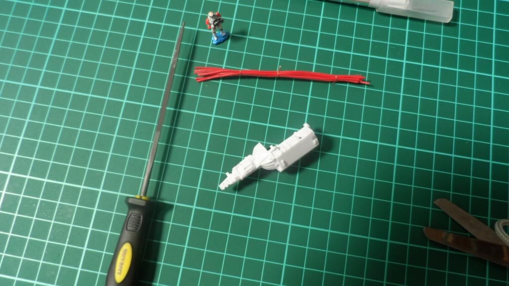

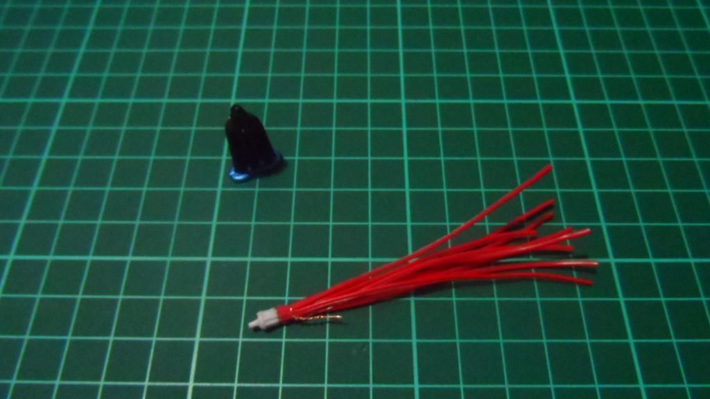

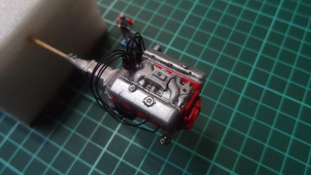

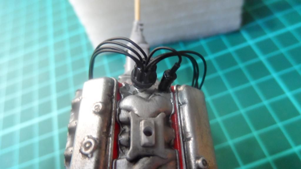

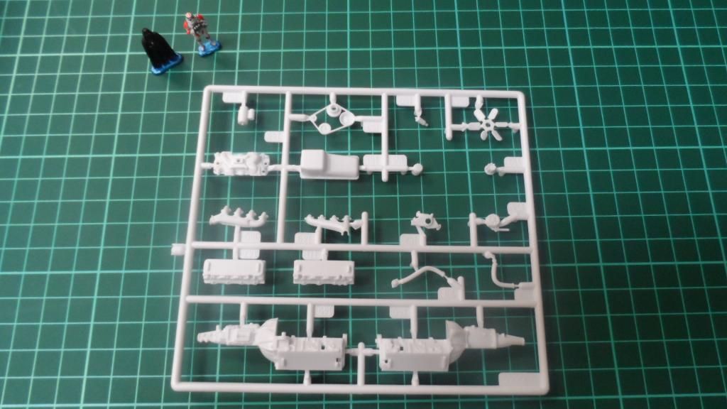

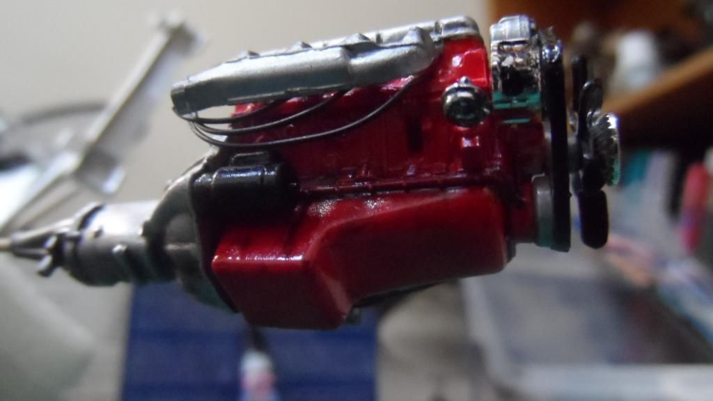

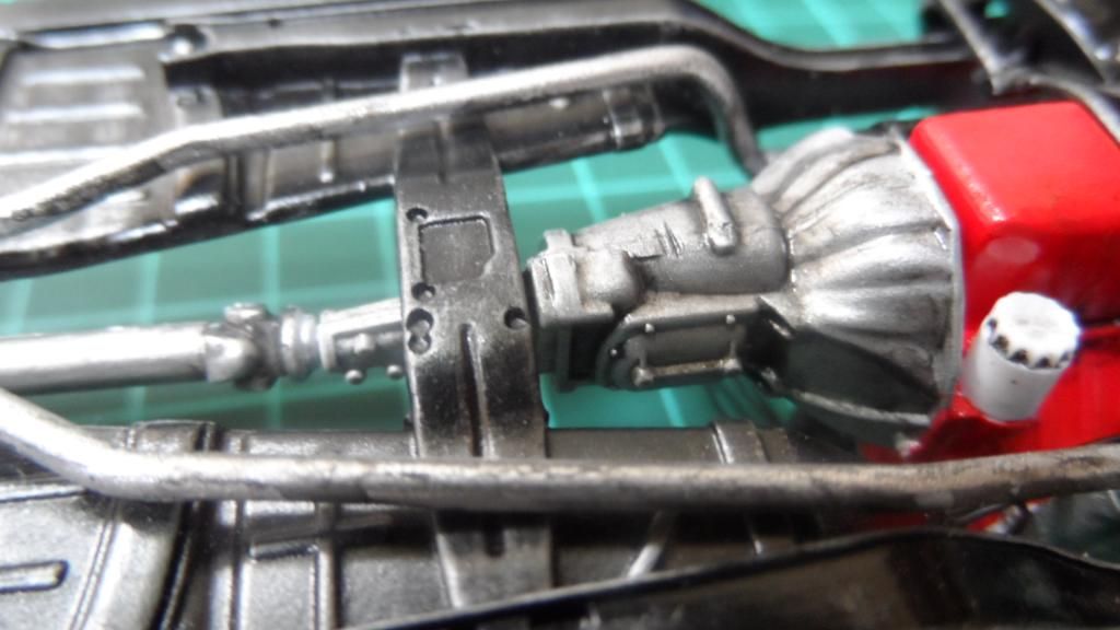

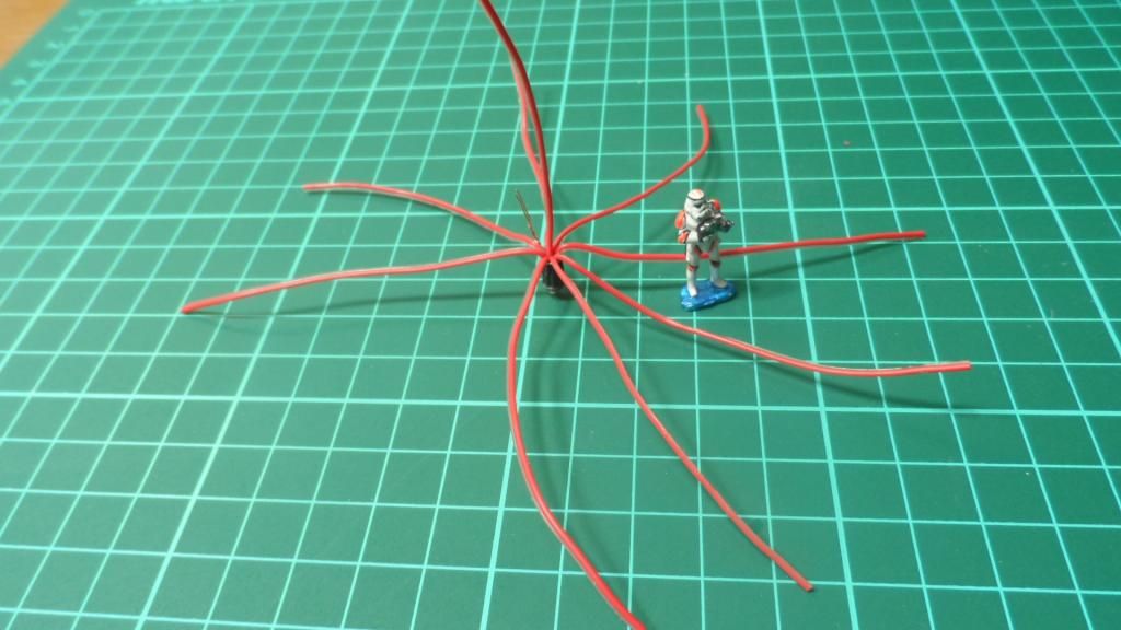

The engine came pretty well detailed, although came with no plug wires, so im going to try building them with phone wires

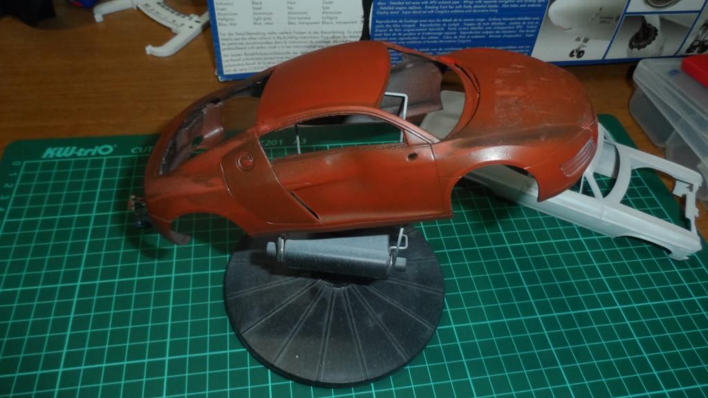

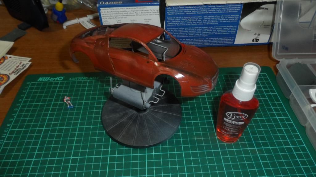

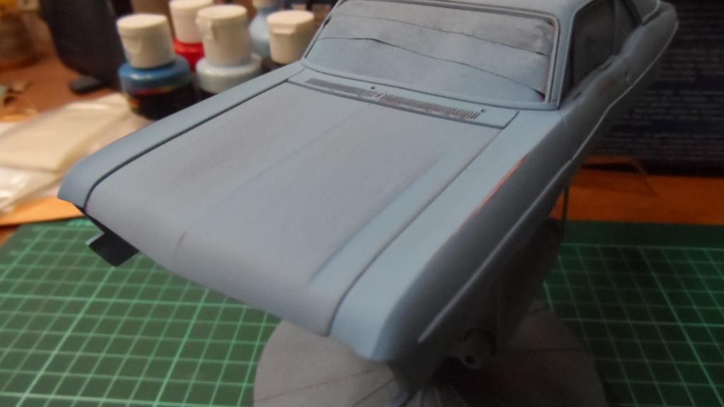

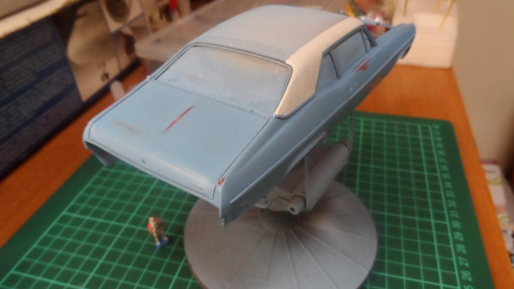

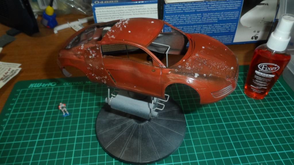

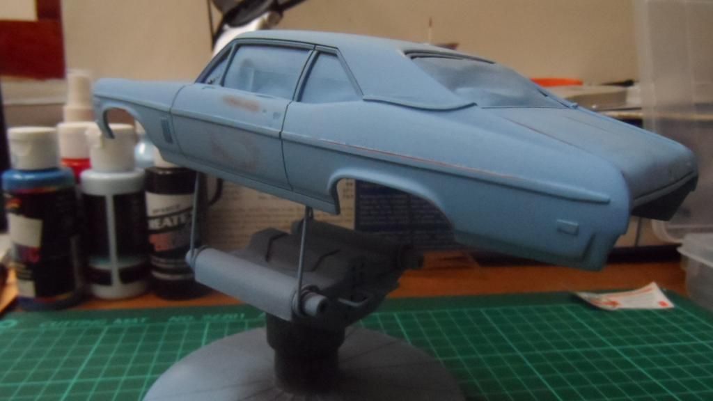

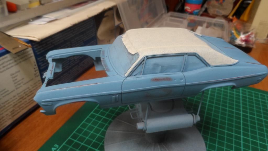

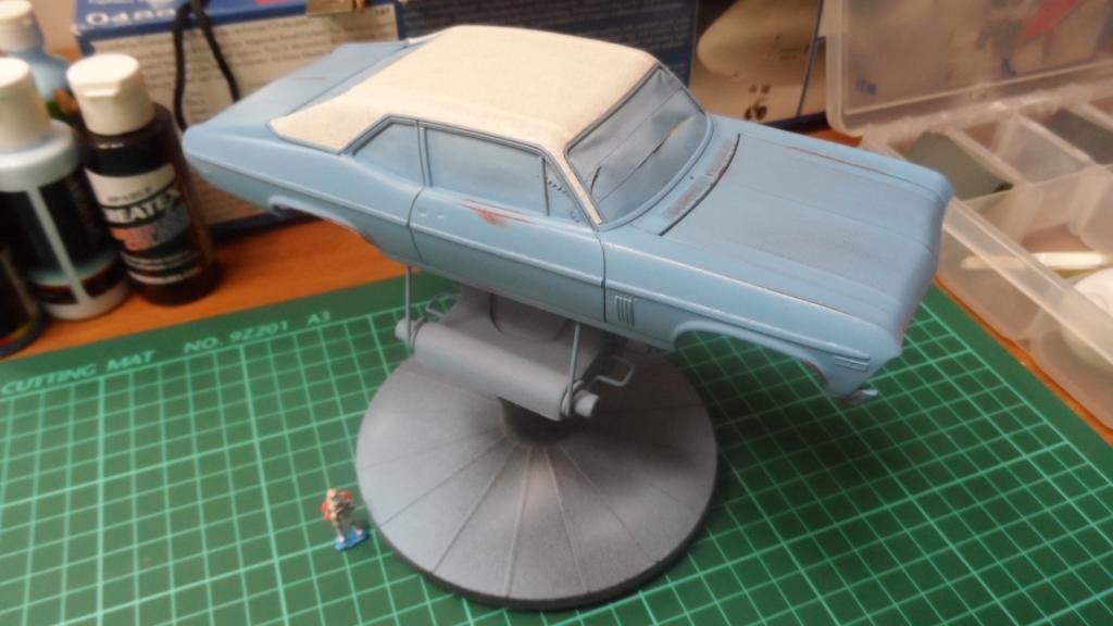

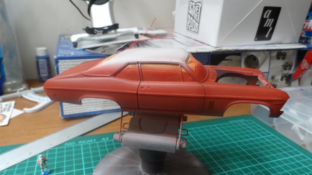

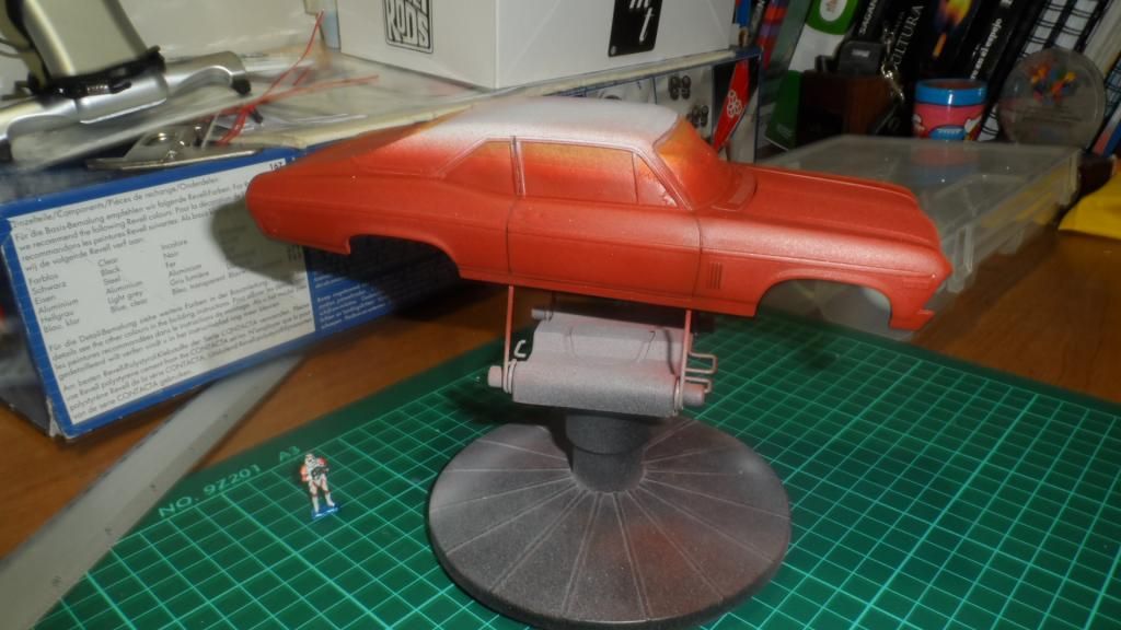

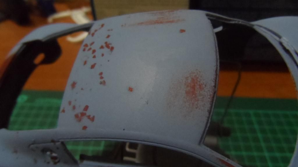

I start with testing some rust paint on the test model, im going to try the hair spray technique and the salt chipping technique
Using the hairspray technique (by the way one of the cheapest i found, nothing special)
After the rust paint was dry, i aply the hairspray with the airbrush and let it dry for about 15 min.

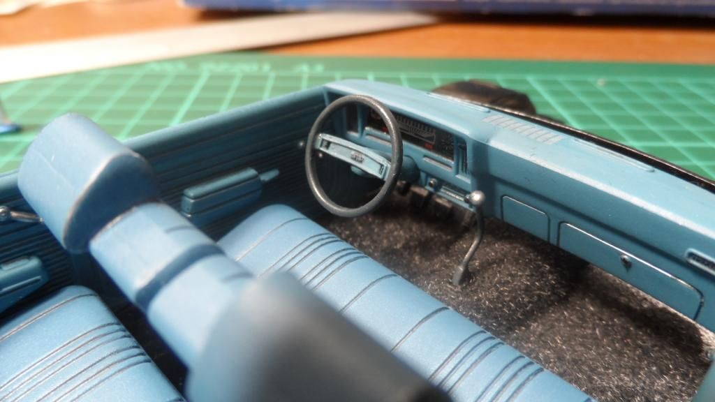

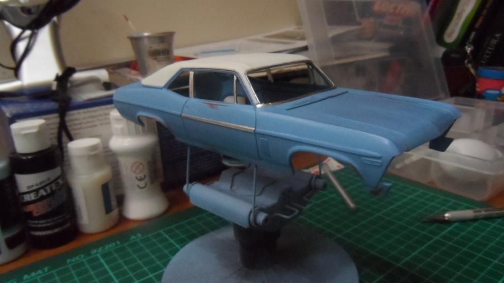

Very nice, can't wait to see it finished!

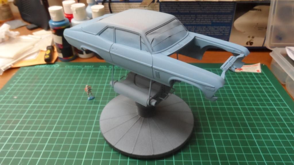

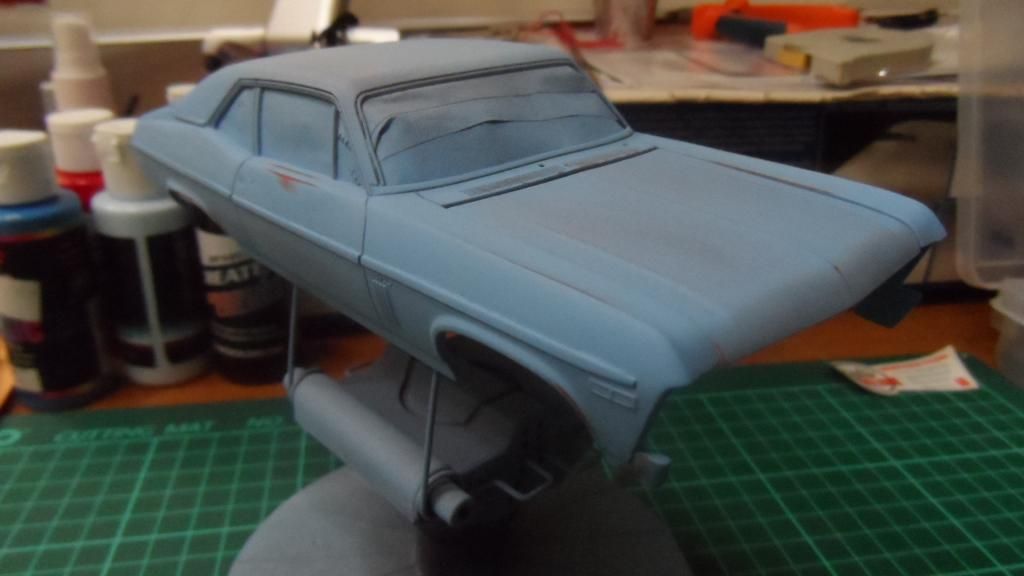

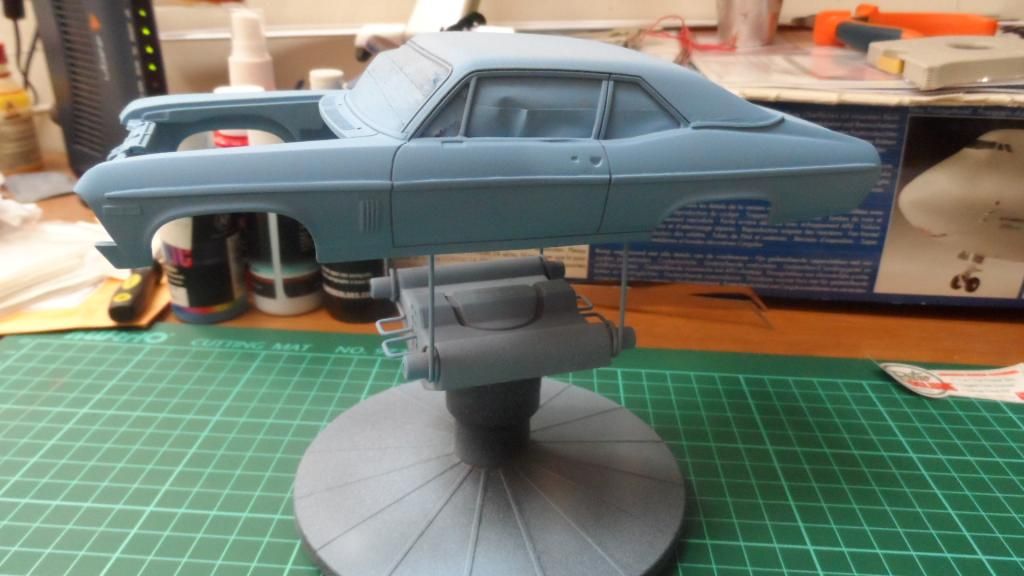

What colour Blue did you use?
Thanks for your feedback.
Because i didnt find any blue color that match that crappy blue, i prepared mine with light blue, 10% dark blue and a couple drops of red.
Your doin a fine job on this. Very nice work. Great detail work.
Agreed. It looks outstanding. Add an black acrylic wash to all the trim and window/door gaps, as well as the cowl.
