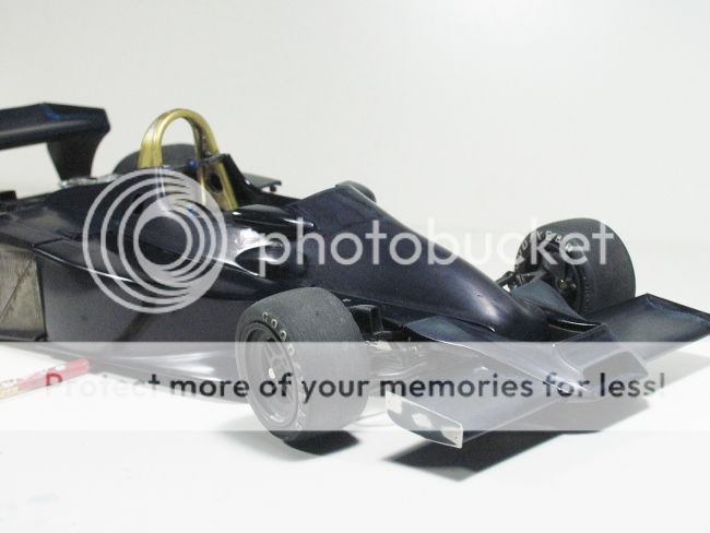

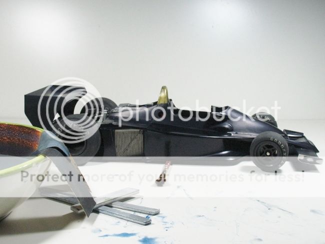

Belugawrx Posted April 1, 2017 Author Posted April 1, 2017 Whoa...am I reading that ...2 years ago !?! Anyway I decided to just go for it and this happened,.... Duplicolor sandable black primer, followed by Tamiya TS-55, then wet sanded 800, 1000, 2000g Going into second coat... Wish me luck Cheers
Belugawrx Posted April 6, 2017 Author Posted April 6, 2017 Uggh, I won't even show you guys that coat,...I have sanded it back out using 800,1000,2000g,...and have DECANTED the TS-55 so I can airbrush it,..Just too much volume coming out of the Tamiya cans , oh well live and learn,...Spray booth is running, so here we go

Belugawrx Posted October 6, 2018 Author Posted October 6, 2018 Ok weather is cooling off again...12 C two days ago now 24 C...? Watching you guys working on these 1:12 Tamiyas has brought the Wolf back out again... I wet sanded 1000g and 2000g, put the tamiya TS-55 in a pot of hot water, and shot the body panels again,... just a couple hangers I need to wet sand out, then decals.. While I was here , I attached a few of the sub assemblies... ... More wiring of the dash cluster and roll bar electrical ... This is getting Done, this year... Cheers

Belugawrx Posted October 11, 2018 Author Posted October 11, 2018 Hey Scott, a late Happy Turkey Day to you too Whattcha workin on these days,...? I was able to get some more exciting bench time in,...Lots of wet sanding, and polishing , and washing, and doing it all over again, going on... It's starting to look like old polished fiberglass gelcoat, i think,.. I also made a start on the decals,..They are in excellent shape, and take MicroSol and MicroSet....Whew...(huge load off my mind) more to come Questions & Comments gratefully accepted Cheers
