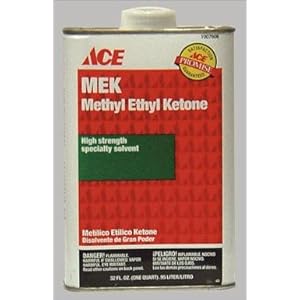

OR,
Here's what I use.  Works great!
MUCH cheaper!
Methyl Ethyl Ketone . . . AKA:   MEK
Available in gallons or quarts.
Trust me ... a little goes a long way.  I can't imagine needing a gallon.  A quart will last half of forever.
I just put a little in a small glass jar for the workbench (in fact, I use my last Tenax container so I have the built-in brush).
Check your local paint or hardware store for pricing.

I also use MEK .  I bought a quart at Ace Hardware for about 10 bucks more than a year ago .
Bill ,  does DCM work better or about the same ?  I've never tried Tenax .

I've been testing them side-by-side for a couple of weeks off and on. So far it seems to me that DCM is hotter, evaporates quicker and makes a deeper bond. That opinion is subject to change as the testing progresses.

Ambroid is also methylene chloride (DCM). I have some Testors Liquid Cement which is MEK. My personal opinion is that the Ambroid works much better. Faster and a stronger bond.

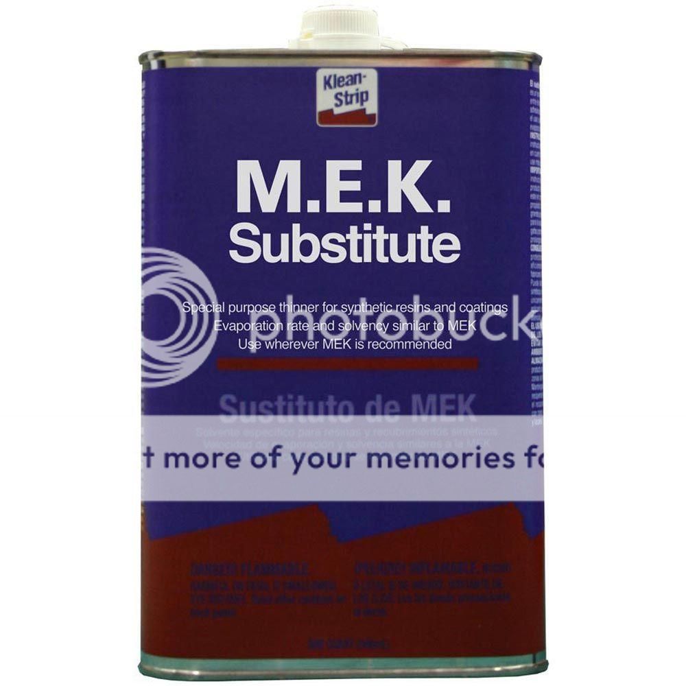

I've been using this for awhile now, It works as well as the old M.E.K. but is a healthier substitute and smells like finger nail polish remover-not the strong smell of M.E.K

Von Zip:
I've wondered about that stuff. Thanks for the info! I'll give it a try.
