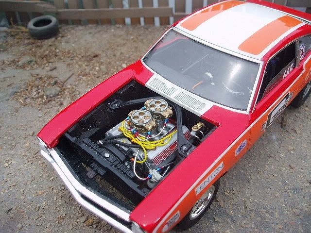

raisin27 Posted January 14, 2012 Share Posted January 14, 2012 The Johan CAMMER from the pro stock Maverick kits is one of my favorites, though it too has a few issues. The oil pan doesnt extend forward enough as it stops before the front timing chain cover is probably the biggest. The most accrate cam covers are found in the old Monogram Tarantula kit. The JoHan CAMMER............ Quote Link to comment Share on other sites More sharing options...
dodgefever Posted January 14, 2012 Share Posted January 14, 2012 Nice job on that. The Jo-Han one looks much better than any of AMT's efforts, but I see they still got the plugs in the wrong place on the passenger side. The covers are not symmetrical on the 1:1 Quote Link to comment Share on other sites More sharing options...
