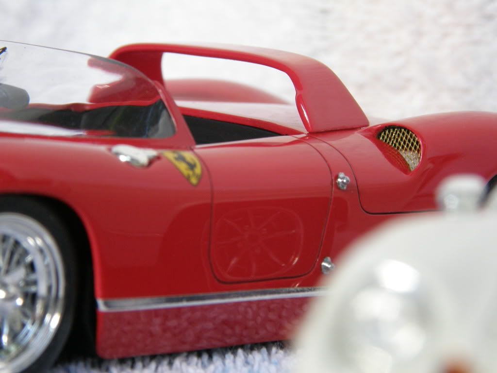

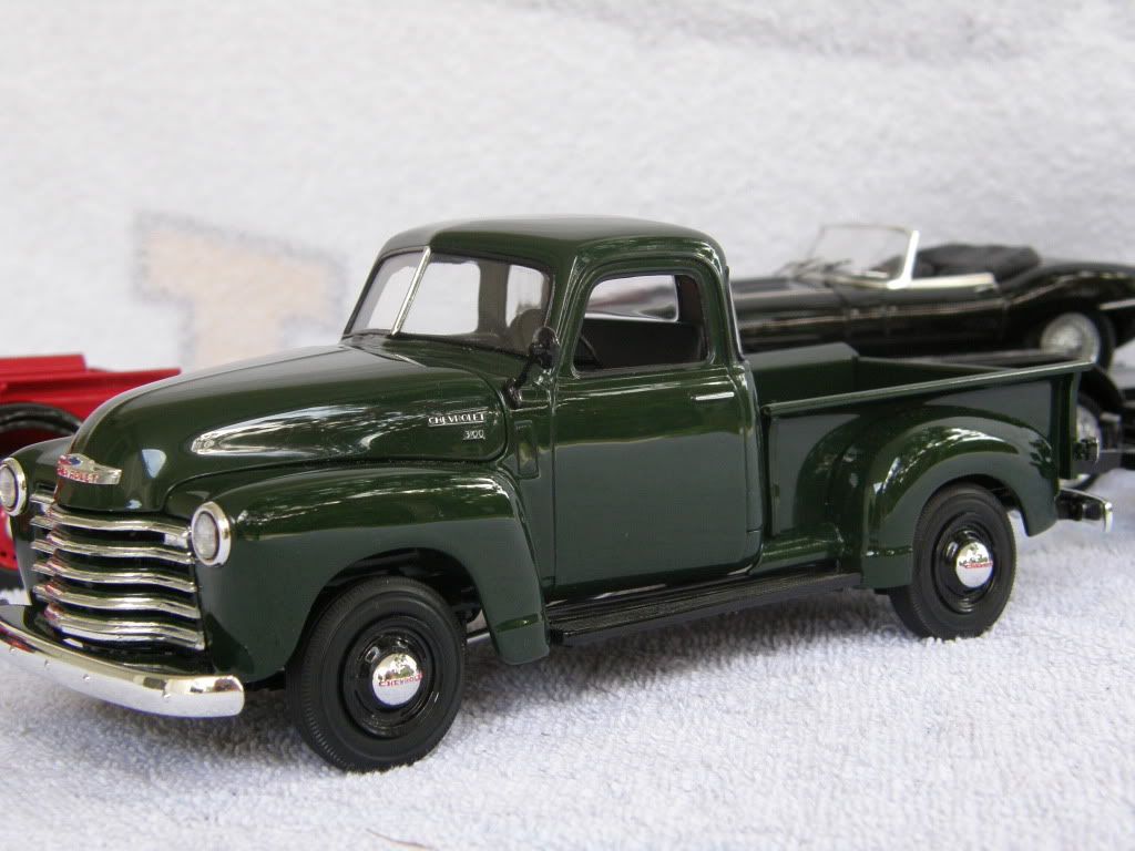

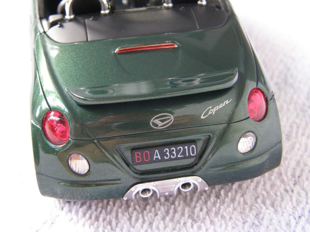

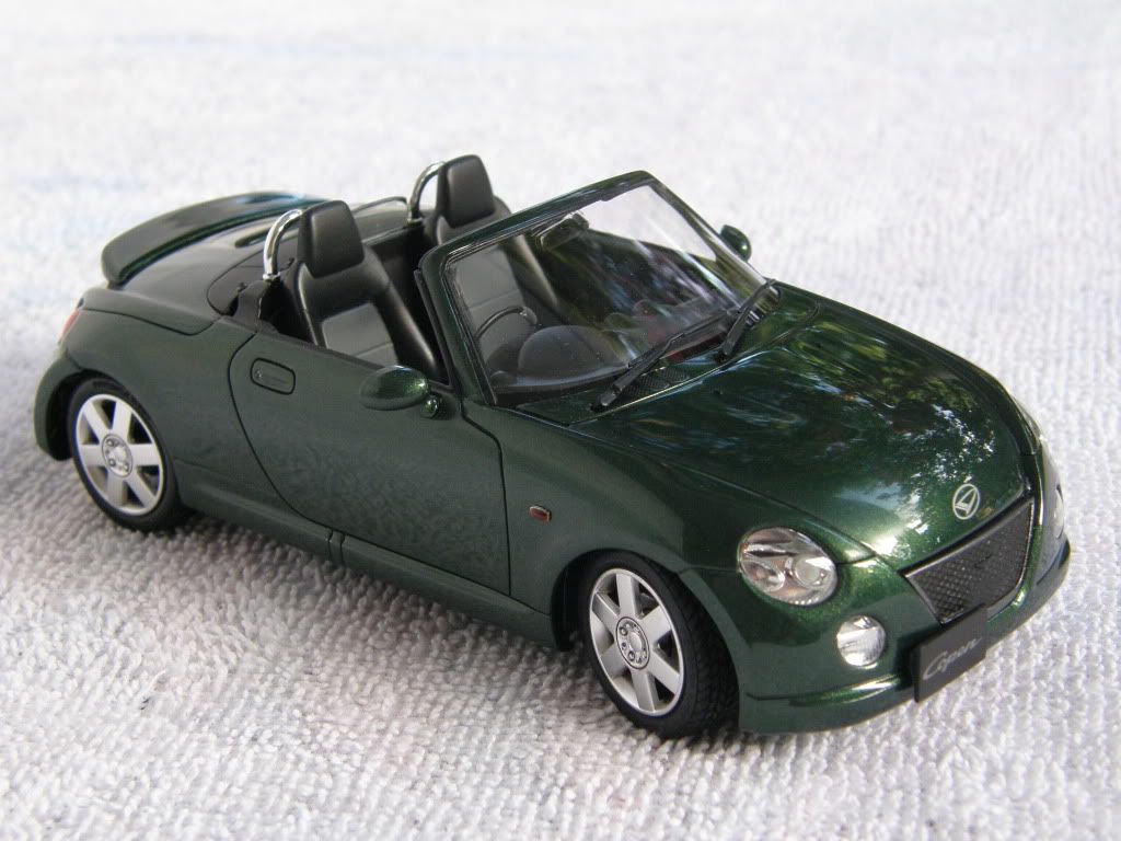

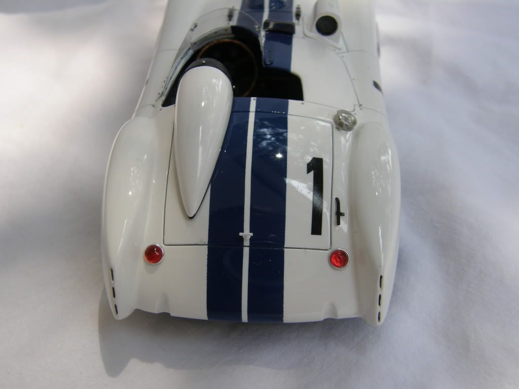

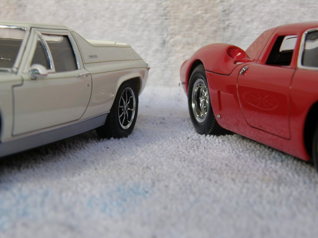

Scale-Master Posted August 24, 2010 Share Posted August 24, 2010 It is my opinion that if you want to learn how to work with urethane's and have the least amount of headaches you should follow David's advice. The points he makes mirror the same experiences I have had, and I have seen his paint/finish work in person. "Dave's way" is one of the many right ways to paint. Just look at his results. Chas's comment amounts to bad mouthing a DuPont competitor's product, instead of accepting someone else has the ability to paint and is willing to properly teach others. Brand loyalty is one thing, ignorant snobbery is another. I know a lot of people who get great results with both PPG and DuPont products. I also use Matrix and PCL clears and DuPont Chroma colors. Snidely portraying a product that looks to be applied with better results (than the product you are using) by someone else is bad form and serves no purpose. Not finishing the paint after it is sprayed is often the difference between being complacent and accepting what was shot, (which is fine if you are happy) and really making a 100 Point finish. Remember, you have to build for yourself... Real car paints look like real car paints when properly applied to models, the only problem is they often look out of scale due to the way they lay down. Cutting and finishing them properly can bring them into scale. Some soft flowing cars can get away with comparatively thick but smooth uncut finishes. But what treatment do the best of the best real cars get after being painted? David's photos really don't do the paint quality justice. That green truck won best paint because it is flawless, I know, I was there. Seriously, no defects. Take a second to think about NO DEFECTS. Honestly, how many absolutely perfect paint jobs has anyone seen? It may look boring, but that just leaves less areas to hide any imperfections. And speaking of those photos, thanks for wearing pants in that last one David! Also follow Ed's advice about the respirators to avoid headaches. You can also add me to the list of lacquer thinner users... Quote Link to comment Share on other sites More sharing options...
Karmodeler2 Posted August 24, 2010 Share Posted August 24, 2010 . And speaking of those photos, thanks for wearing pants in that last one David! You are welcome....it's the least I could do. (Sorry about the past photos....I'll pay for your therapy!!). If you look close, you can see you house!!! David Quote Link to comment Share on other sites More sharing options...
Jeff Sauber Posted August 24, 2010 Share Posted August 24, 2010 Um, judging by the images shown, it's pretty darn obvious that David knows what he's doing. There's lots of ways to try and achieve decent finishes, but David's advice is solid and clearly very effective. I can't see how anyone can argue the point... Quote Link to comment Share on other sites More sharing options...
