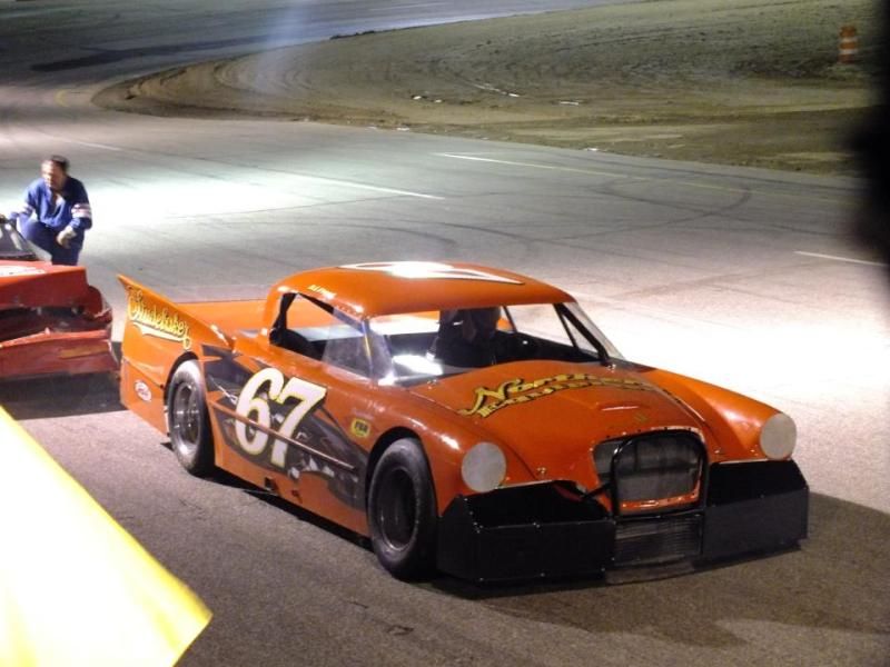

roadhawg Posted July 26, 2012 Share Posted July 26, 2012 ...This will be an unlikely Saturday night short track style car. I say unlikely because I'm not going for the vintage look but more of a modern late model type car which, because of the Dodge Challenger body, would be impractical and uncompetitive, if not completely illegal in just about any sanctioning body in the country.... You mean something like this? Drew, this isn't as far fetched as you might think. Several organizations have sprung up for racing not only restored vintage race cars, but vintage type bodies using modern parts. I was told that Studie up there currently runs in a regular street stock division somewhere in Indiana. They use modern parts, but have no rules on the vintage of bodies, other than they must look stock. There was also this Hudson that ran in Illinois a couple years ago...Hudson body, jig chassis, small block Chevy engine, modern running gear.... So don't say your Challenger will be impractical.....it could very well run with these guys! Is that contraption going to be dirt or asphalt? Looks awesome so far! Quote Link to comment Share on other sites More sharing options...
2002p51 Posted July 26, 2012 Author Share Posted July 26, 2012 Yea Tommy, I know about organizations like that. I shoot the Carolina Vintage Stock Car races which runs cars very much like those. There's mostly not much "vintage" under the sheet metal on these cars. But what I'm going for is a very different look, albeit the differences may be somewhat subtle. Quote Link to comment Share on other sites More sharing options...
