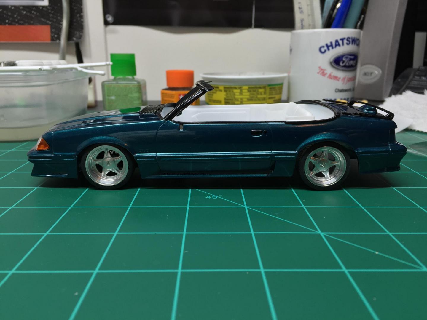

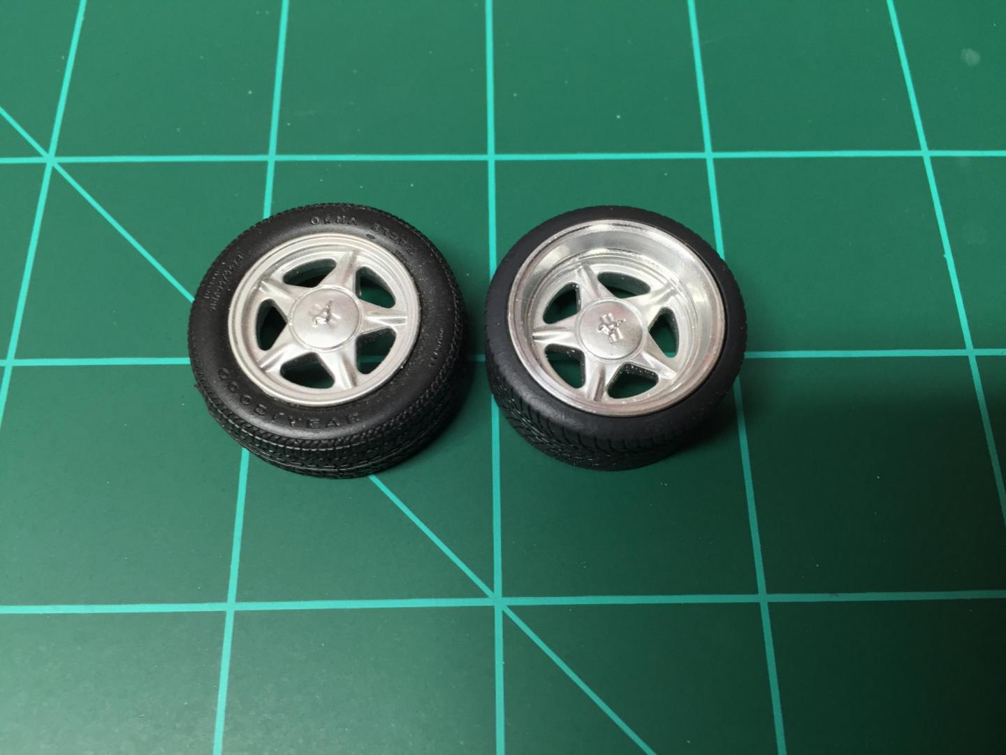

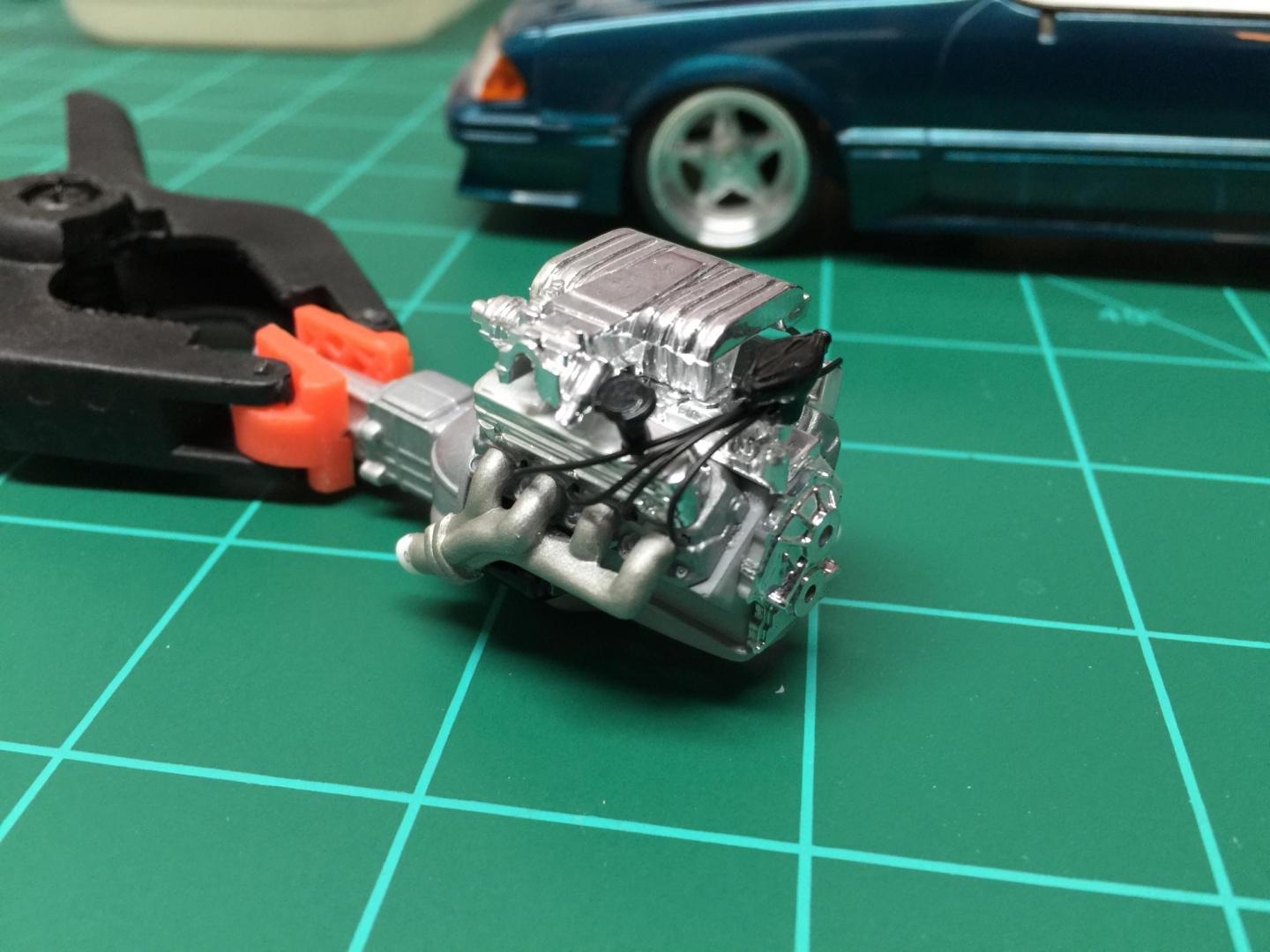

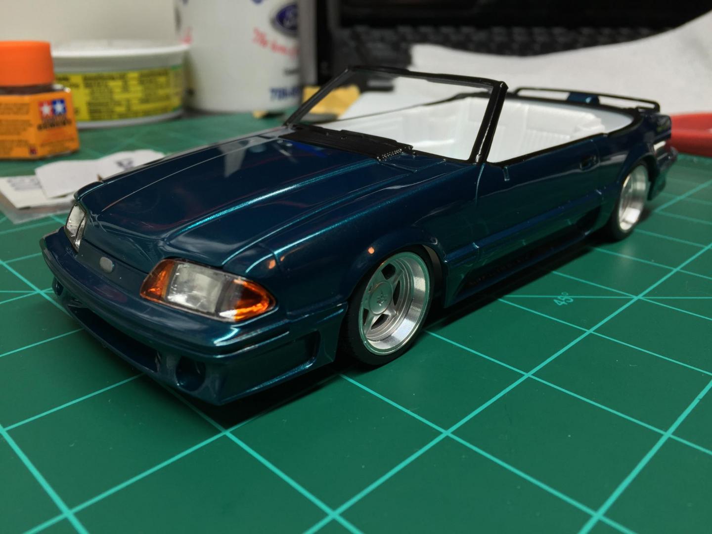

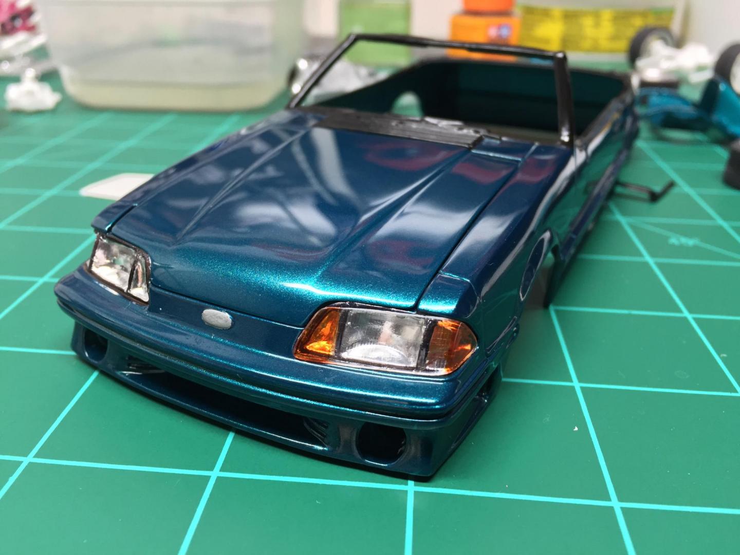

1tim1 Posted January 19, 2016 Share Posted January 19, 2016 Been working on this '92 Mustang convertible. Got it painted in Dupli-color Cayman green, an original Ford color. Got clear on and it's polished. Most of the engine is assembled, I drilled out the kit distributor and wired it. Lowered the rear suspension and still working on the front for the ride height. For the wheels I used the kit wheels and sanded them down until they fit into the 19" Pegasus sleeves. I used bare metal foil in the headlight buckets, it's kind of rough but I'm still fairly new to using BMF. That's about all I have done for now, I'll get more posted as I get more done. Quote Link to comment Share on other sites More sharing options...

matthijsgrit Posted January 19, 2016 Share Posted January 19, 2016 (edited) Rolin'... in my five point oh, with the ragtop down, so the hair can blow!!! Nice looking Pony!! You got me really interested in those sleeves... Just curious: if compared to the kits standard wheels, will the sleeved rims clearly be larger, or ....? I know they will be wider, but larger? Edited January 19, 2016 by matthijsgrit Quote Link to comment Share on other sites More sharing options...

kelson Posted January 19, 2016 Share Posted January 19, 2016 Love the color,how do you plan on painting the taillights? Quote Link to comment Share on other sites More sharing options...

1tim1 Posted January 19, 2016 Author Share Posted January 19, 2016 Rolin'... in my five point oh, with the ragtop down, so the hair can blow!!! Nice looking Pony!! You got me really interested in those sleeves... Just curious: if compared to the kits standard wheels, will the sleeved rims clearly be larger, or ....? I know they will be wider, but larger? Throwback from the early 90's lol. Yes they will clearly be larger, it makes the original 16" wheel a 19" in diameter. Also gives it quite a bit of back spacing which in theory wouldn't work on the front in real life but makes it look cool. Quote Link to comment Share on other sites More sharing options...

1tim1 Posted January 19, 2016 Author Share Posted January 19, 2016 Love the color,how do you plan on painting the taillights?I'm not sure how I will accurately paint the tail lights just yet. I'm kind of stalled from modelers block at the moment. I still have to paint the mirrors so I may try taping up all those little parts of the lenses. Quote Link to comment Share on other sites More sharing options...

crazyrichard Posted January 25, 2016 Share Posted January 25, 2016 looks great ! i like it .. could also be awsome with the staggered look .. dont know how easy it wold be to file or sand the front rings a tad less wide ? Quote Link to comment Share on other sites More sharing options...

1tim1 Posted January 25, 2016 Author Share Posted January 25, 2016 looks great ! i like it .. could also be awsome with the staggered look .. dont know how easy it wold be to file or sand the front rings a tad less wide ?Thanks! With my skill level it would probably be pretty hard to fill the lip on the sleeve down. If I had a lathe I could probably do it. I agree the staggered look would be awesome, but this is the next best thing for me lol. Quote Link to comment Share on other sites More sharing options...
crazyrichard Posted January 25, 2016 Share Posted January 25, 2016 Thanks! With my skill level it would probably be pretty hard to fill the lip on the sleeve down. If I had a lathe I could probably do it. I agree the staggered look would be awesome, but this is the next best thing for me lol. i usually do stuff like that (metals) with small fine metal files .. tape around the ring and with patience file ... and the last mm i put a piece of sandpaper on the benc and press the pice on it and rub the piece over the sandpaper .. but that said it ooks awsome the way it is now so ....just keep it like is Quote Link to comment Share on other sites More sharing options...
