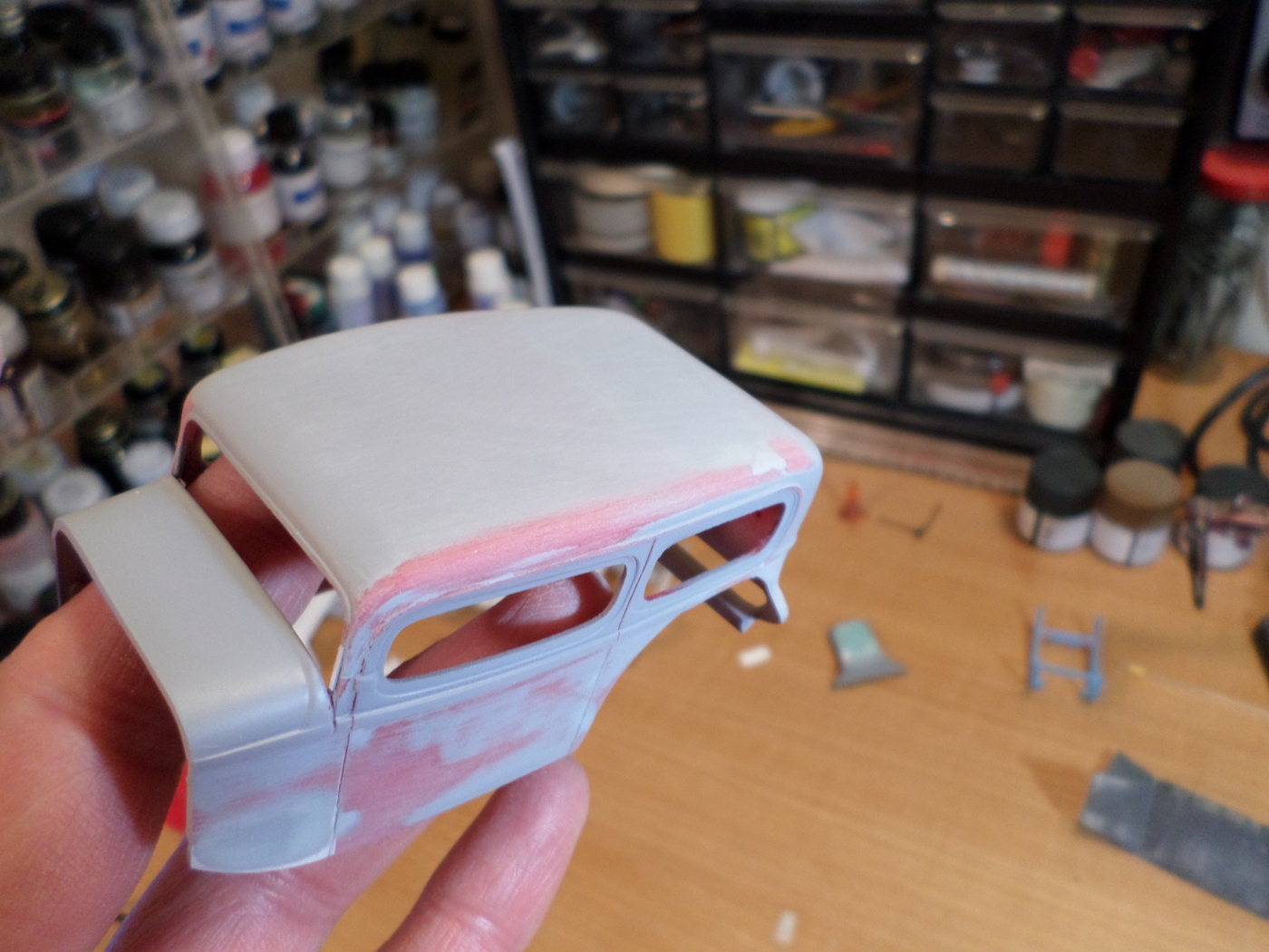

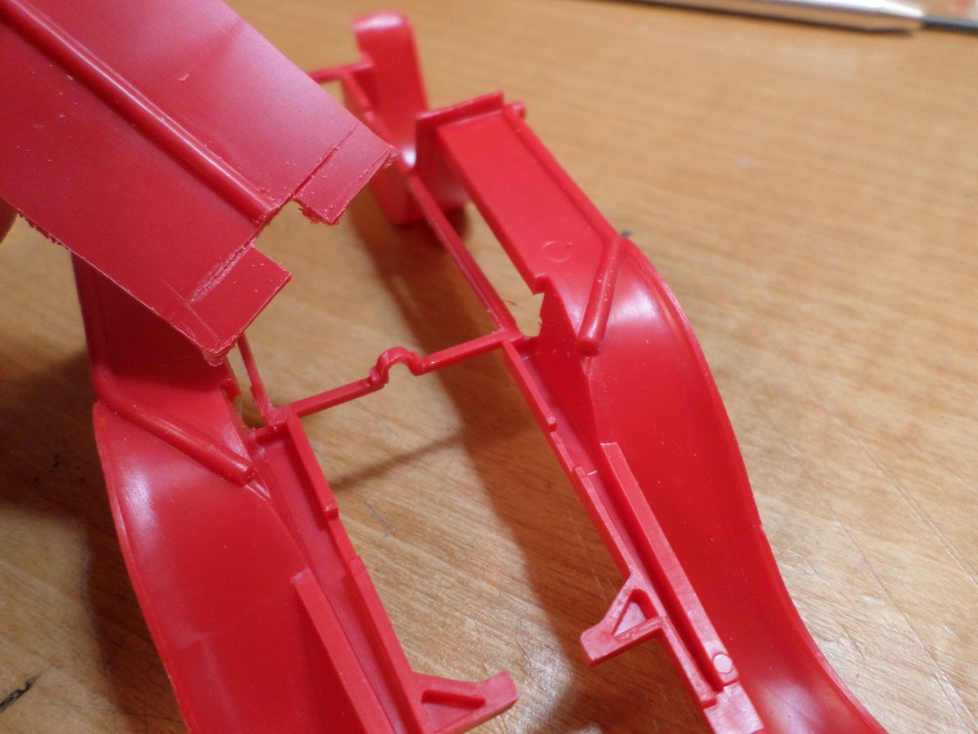

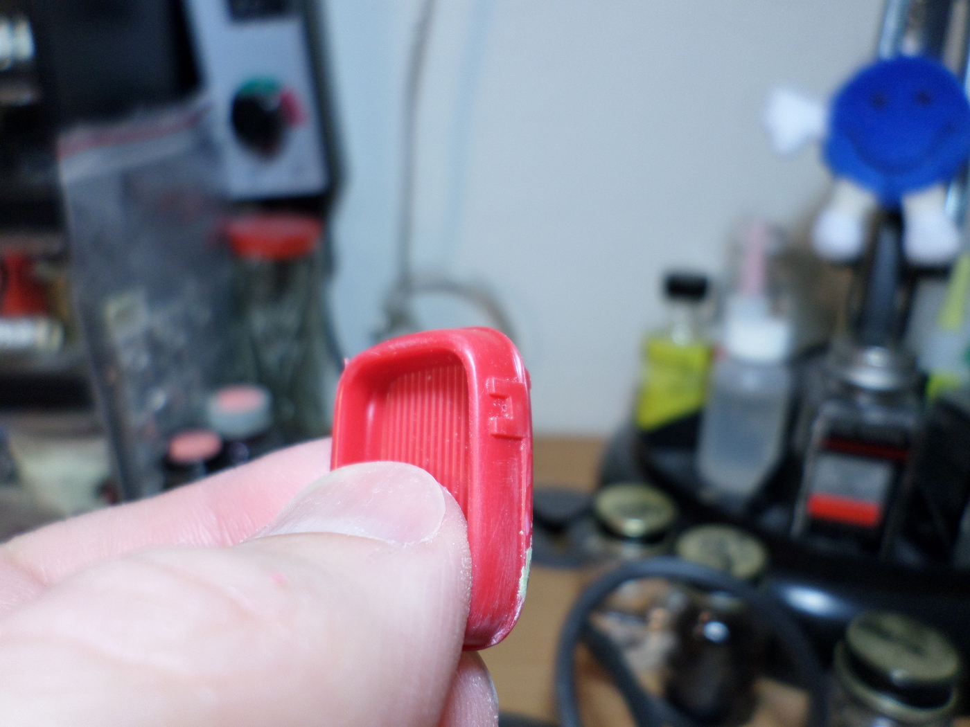

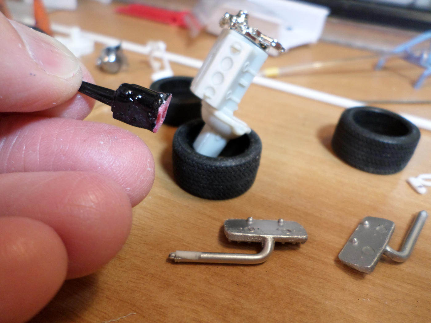

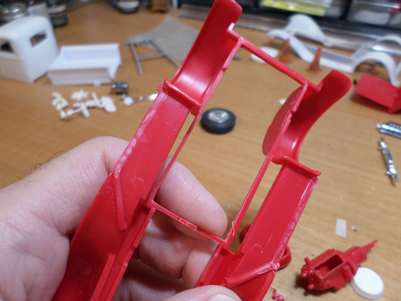

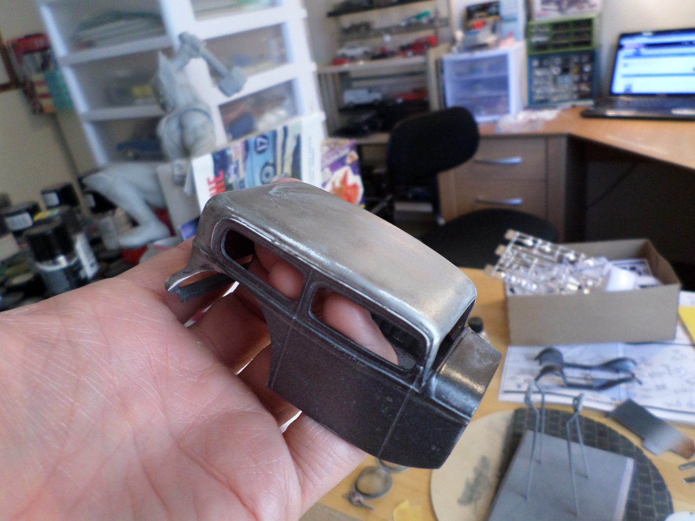

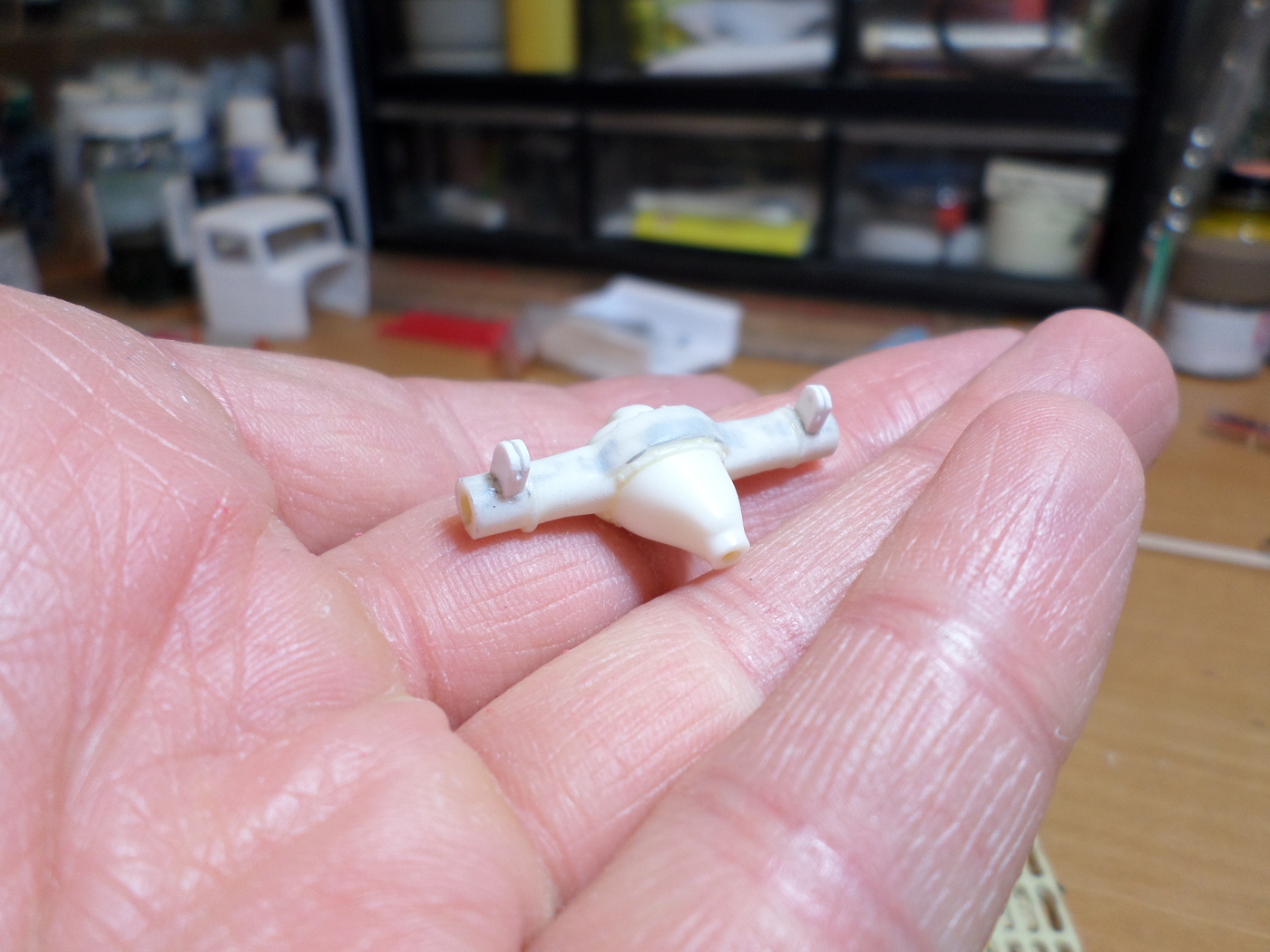

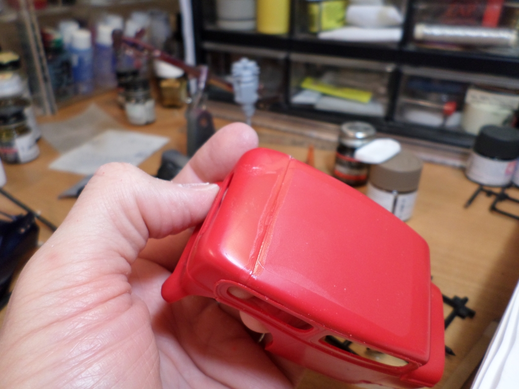

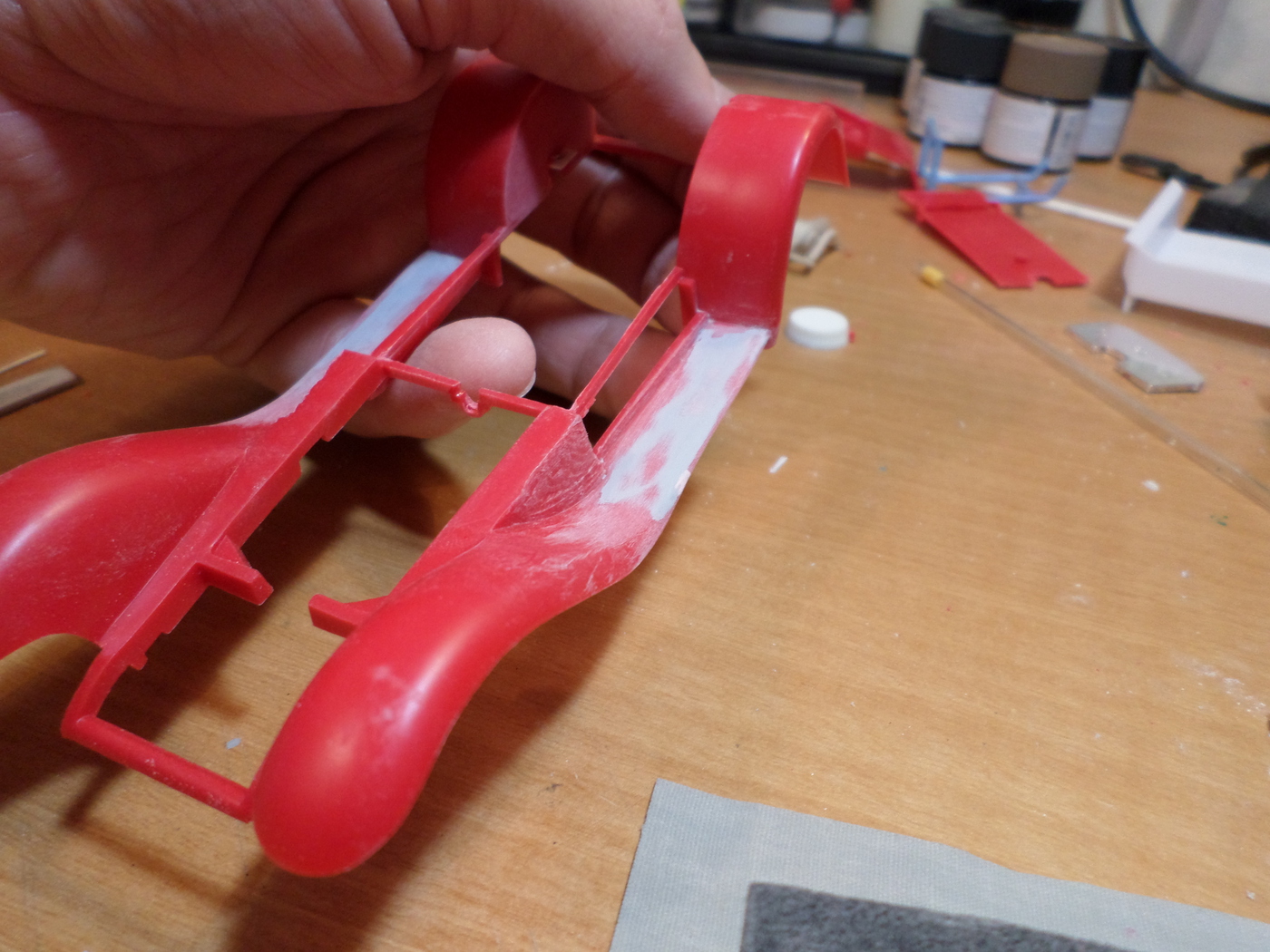

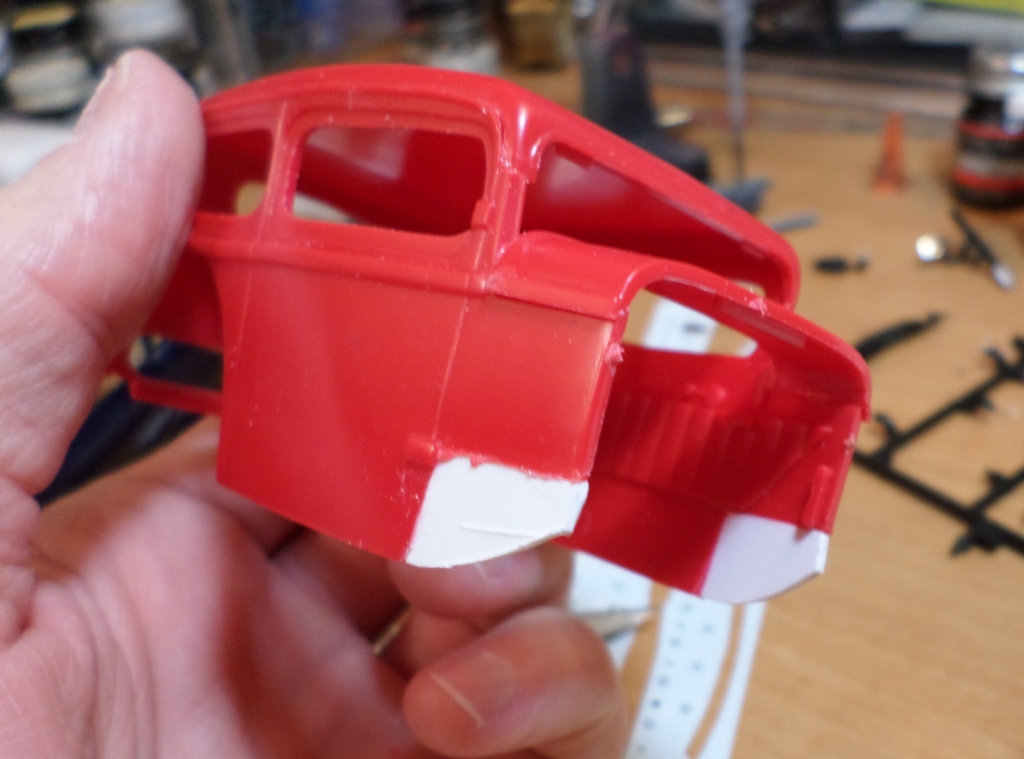

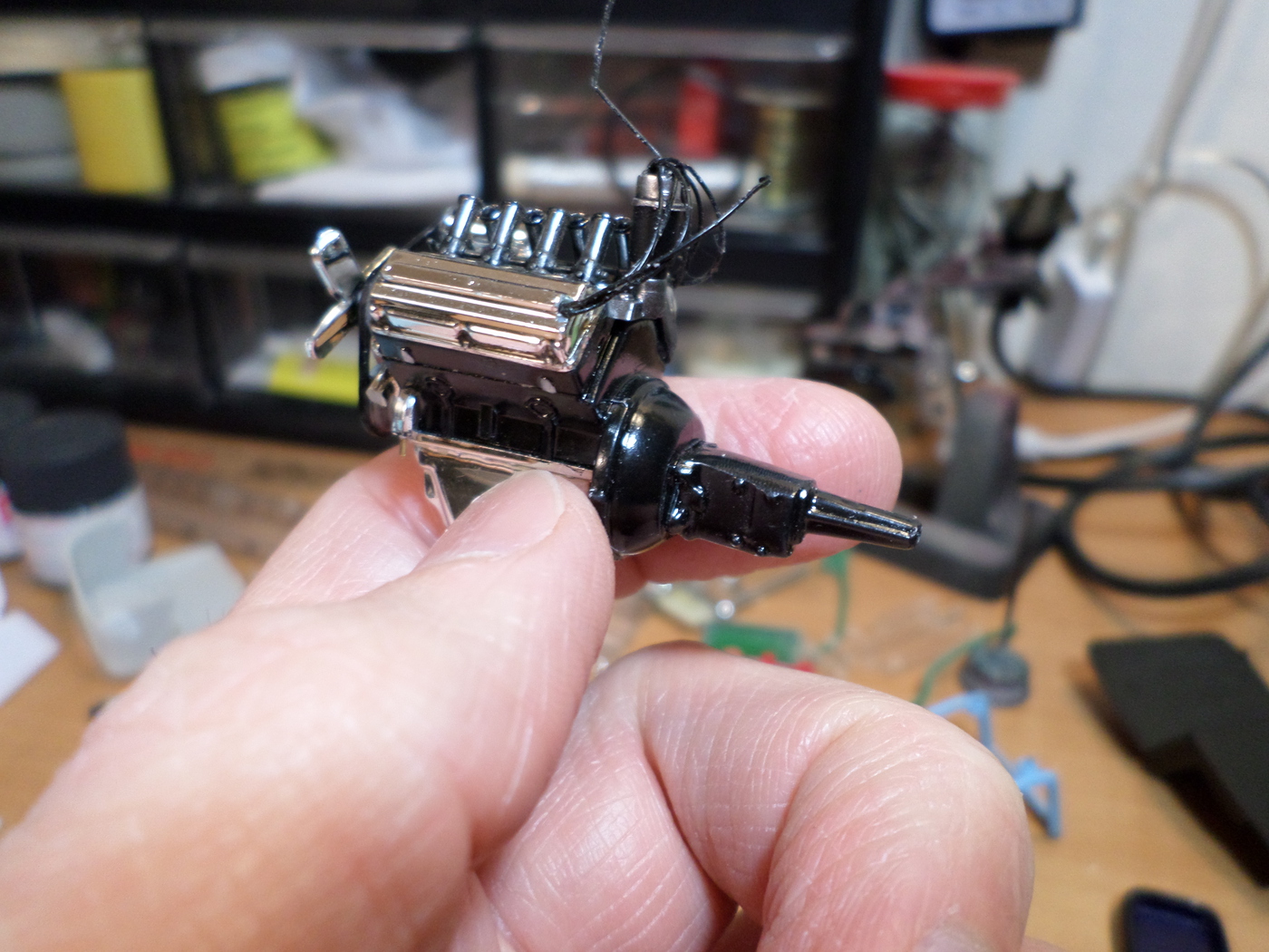

Modelbuilder Mark Posted January 24, 2016 Share Posted January 24, 2016 OK, let me try this again. I have no idea why the pictures were not loading the other day, but I did post from my phone. I picked up this older kit at the Phoenix Desert Scale Classic this past spring. The box was in pretty rough shape so I pitched it, and I did not get a picture and do not have instructions. I know it is an Aurora, is 1/32 scale and seems it may have been a friction model our slot car at some point. I do not recall the kit name. It has a multi piece body, which did not want to align. There were also large gaps in the body sides that needed replacing. There was also a really bad roof texture that needed removing. Hosted on Fotki Hosted on Fotki Hosted on Fotki I also cut away the molded in drivetrain to give the chassis a bit more realism, as well as remove the molded in side pipes. Hosted on Fotki Hosted on Fotki Hosted on Fotki The grill shell also has these awful light mounts than needed to be sanded away. Hosted on Fotki The original motor for this kit was way too large and comical. I have heard several times over the years that the red ram hemi in the re-done Ala Kart kit is a little under scale, so l thought it would work here. The kit transmission was too large, so I swapped it out from the parts box. Hosted on Fotki Hosted on Fotki I will be using a bit more modern style "spoked" wheel. Hosted on Fotki Parts box rear end. It will have a rudimentary air bag suspension. Hosted on Fotki The car was originally going be a dark metallic grey, but the paint job did not agree. So I re-shot it in Testor's Deep Purple Pearlescent. The fenders fell of the paint stand on my last wet coat, and fell right into the carpet, so they had to be sanded down and shot again. My wife got me a dehydrator recently, so I got to use it for the first time, so I did not have wait so long on the fenders. Hosted on Fotki Polishing not complete yet in this photo. The color looks lighter in this picture than in person. Hosted on Fotki I hope to get the sub assemblies coming together over the next few days. Quote Link to comment Share on other sites More sharing options...

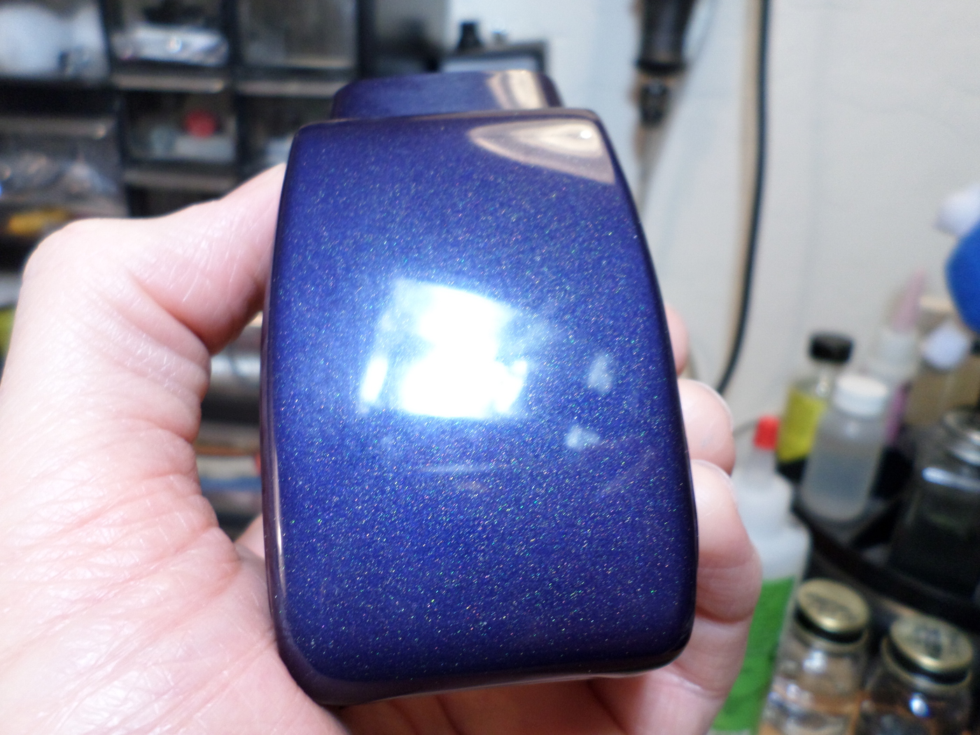

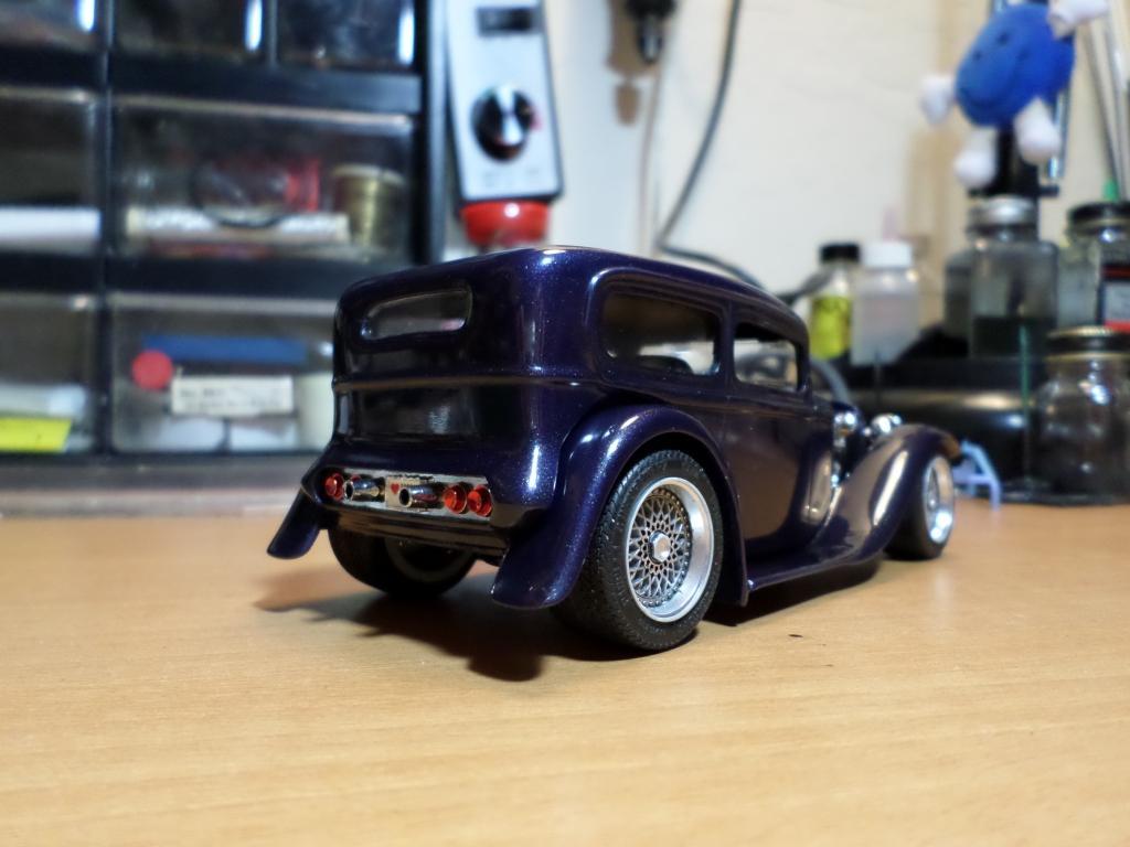

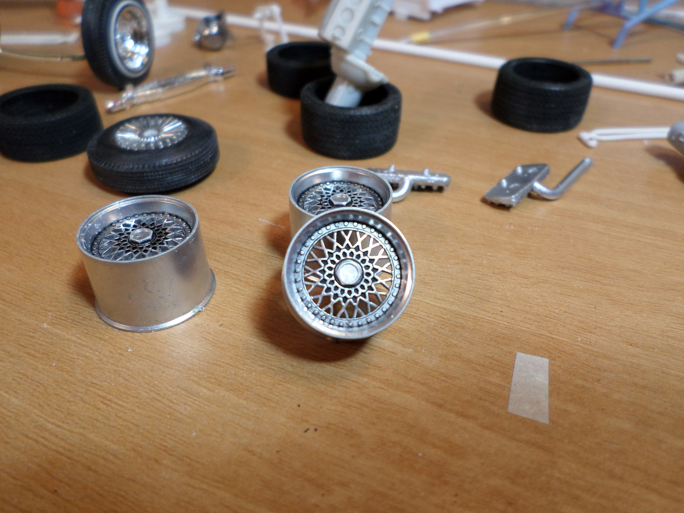

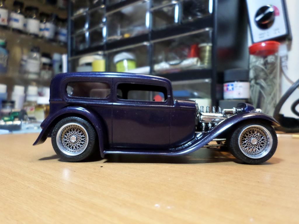

Modelbuilder Mark Posted April 11, 2016 Author Share Posted April 11, 2016 (edited) My first finished project of the year! Finally! Sorry, I did a lousy job keeping photos. This started life as an Aurora kit, 1/32 scale, multi-pieced body kit, thus the moniker 32-32. This one had the molded in chassis, with exhaust, side pipes, and rear axle all molded in place. I cut out the chassis to add the rear end, scratch built the links, aluminum tube for exhaust and the mufflers were pilfered from an AMC Hornet chassis that was on the parts bin. They looked undersized for 1/25 scale, so they looked right here. Same with the Ala-Kart motor to some extent. Gas tank is from the parts bin, and am not even sure the kit source.The wheels and tires are also parts box, and I were supposed to be 1/25th but looked undersized as well. Shot with Testors Deep Purple Pearlescent decanted and shot through my airbrush. This was intended to be a fun departure for me. I think it turned out OK, but there are things I wish I had done better. Thanks for looking. What I started with. became ... Mark A Hubbard Edited April 11, 2016 by Modelbuilder Mark Quote Link to comment Share on other sites More sharing options...

blunc Posted April 11, 2016 Share Posted April 11, 2016 (edited) That would be the Aurora 32 Ford Sedan kit which was also had an earlier version released as "32 Skidoo", it's on my "to do" list since it is basically a replica of one of the early iterations of the Lil Coffin. I took some photos of Mark's 32-32 at DSC12, it looks real good to me. Edited April 12, 2016 by blunc added text Quote Link to comment Share on other sites More sharing options...

Foxer Posted April 12, 2016 Share Posted April 12, 2016 I do see the pics .. and it really looks good! Has a wicked stance. Quote Link to comment Share on other sites More sharing options...
GTJUNIOR Posted April 12, 2016 Share Posted April 12, 2016 Looks really good. Quote Link to comment Share on other sites More sharing options...
1930fordpickup Posted April 12, 2016 Share Posted April 12, 2016 Sure looks nice. Quote Link to comment Share on other sites More sharing options...
Art Laski Posted April 28, 2016 Share Posted April 28, 2016 Really clean, Mark. I like this one a lot! Quote Link to comment Share on other sites More sharing options...
