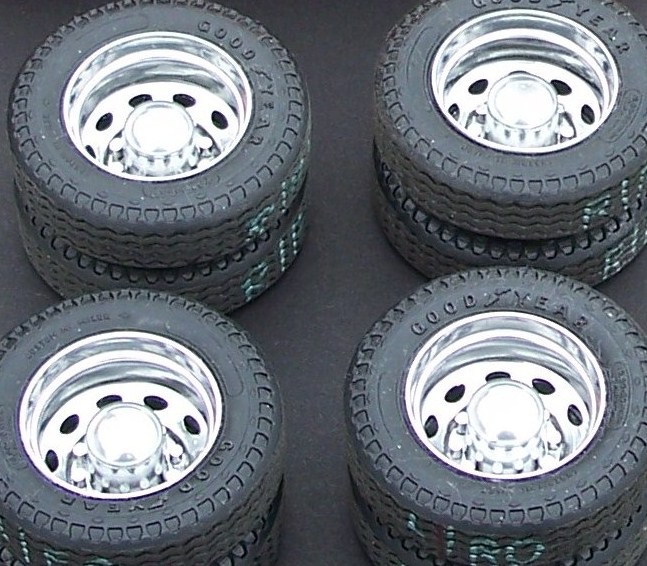

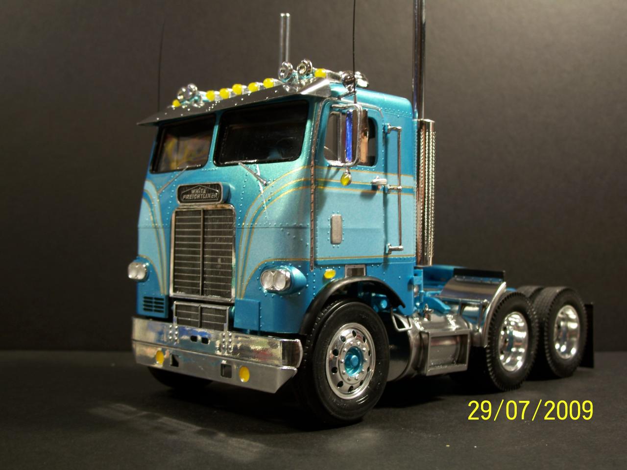

Mike, I would like to offer a couple of words of encouragement and advice if I might. I do not claim to be an expert, by any means, but I want to share my results.
I use both Alclad and Spas Stixx, another version of Alclad, and have gotten, what I think are very satisfactory results. What I think is the trick, for me anyway, is lots of VERY light coats, and after it has cured overnight, polish with a dry Qtip. I have a Passche VL that has a control to limit the trigger's rearward travel, limiting the amount of material picked up. By setting it so low, you have to watch the surface you are painting to see the SLOW color change. Build the coats very slowly, let it dry, rub it with a Qtip, and this is the result. I have even used S n J polishing powder, finely ground aluminum,  in conjunction with Alclad with really good results. The wheels are pieced together Italeri and Revell parts and the tanks, quarter fenders, and visor are kit parts mist-coated until very bright and then polished. It is fairly easy to do, just time consuming. But patience really does pay off. A little practice and anyone can get this look. post-11762-0-05358900-1405711508_thumb.jpost-11762-0-45466600-1385254990_thumb.j
