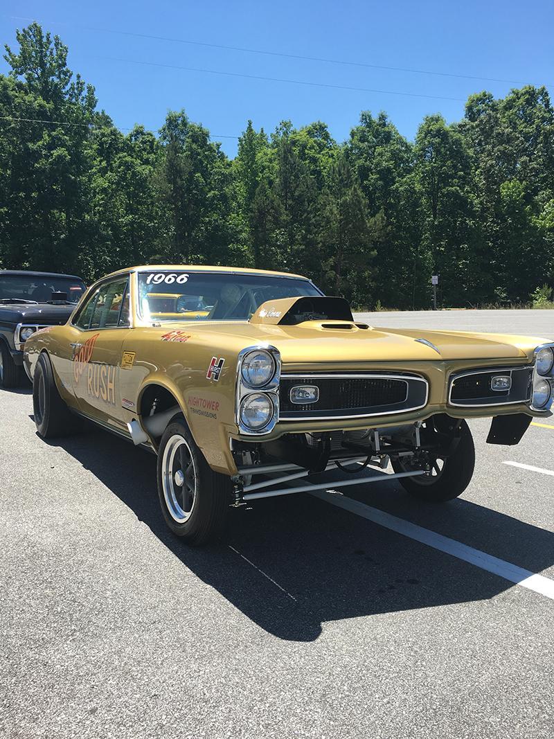

Can someone please explain this front suspension to me? I'm not seeing any springs. I see a tie rod and what I think is some sort of panhard bar, which might make sense in a racer that expected to bring the front wheels down hard with some regularity.
Share this post
Link to post
I didn't get under this one to look. I don't think it's a southeast gasser, so it probably has a different set up that is outside of their rulebook. It's hard to tell how it is sprung
Share this post
Link to post
I blew the photo up and had a good look...though it gets pixelated and is still hard to interpret. I'm pretty sure the axle, which is entirely straight and made of tubing, is suspended by coil-overs mounted to the axle just inboard of the brackets that the radius rods mount to.
You're right about there being a Panhard bar, which would be absolutely necessary to control side-to-side movement of an axle suspended by coils. Upper and lower radius rods, which are present, would control fore-and-aft axle movement and resist braking torque...though if front brakes are fitted, they're tiny.

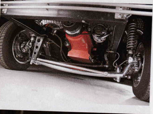

Something like this then. Thanks Bill. I've never seen this before. I'm going to have to build a model with this setup now. :D
Yes sir, that's the general idea. That's not a particularly well thought-out example though. It would benefit from having a straight axle if possible, as those dropped ends have a way of introducing odd twisting forces into the whole mess under braking loads. They act as lever arms that tend to try to rotate the top of the axle forward more than a straight axle would (and yes, dropped axles that we love on old street rods do the same thing, but are pretty much necessary to get a car down low).
