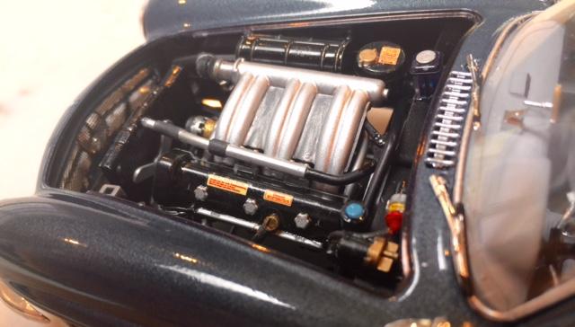

  • Wired the distributor... sort of.  The spark plug wires go right into an intake tube, and the kit part isn't hollow and has the wires molded coming out of the bottom.  The only space is a very short spot between the tube and the top of the distributor where the wires come together into the tube.  I took six pieces of spark plug wire, twisted them together and put a drop of super glue on them.  Once dry, I cut them off to make a 1/8 inch bundle.  I glued the bundled end to the intake tube, and pulled the other ends apart and moved them toward the distributor.  They don't even touch it, but the intake tube is highly visible, and looks empty with no wires, so it was a simple fix
  • Ran a wire from the starter into the other end of the intake tube

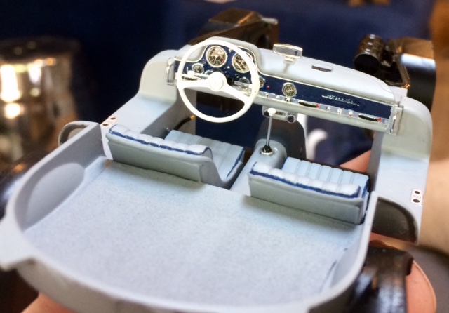

Interior completed:
Tamiya_300_SL_12.thumb.jpg.c8bdcdbc8973b

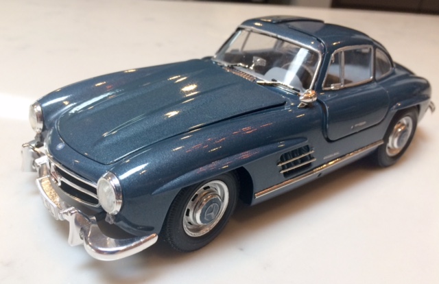

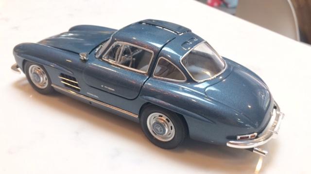

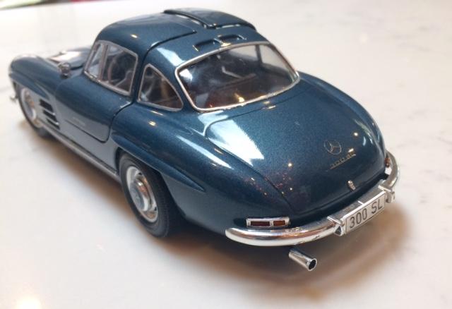

And all together:
Tamiya_300_SL_15.thumb.jpg.c330690f03d68

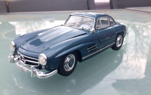

I was hoping for sun... it's been raining for a week straight.  Bright cloudy was the best outside pic I could get:
Tamiya_300_SL_20.thumb.jpg.b4781449d03e9

A valiant effort considering all the issues. Paint looks very nice. Sometimes I think you may just have to grab a hold of the hood and bend it to the breaking point. Or maybe that's just my heavy-handed ways.

Shame abouttge a-pillar, the build came out really nice. Engine bay and the other details are very nice. Nice job.
