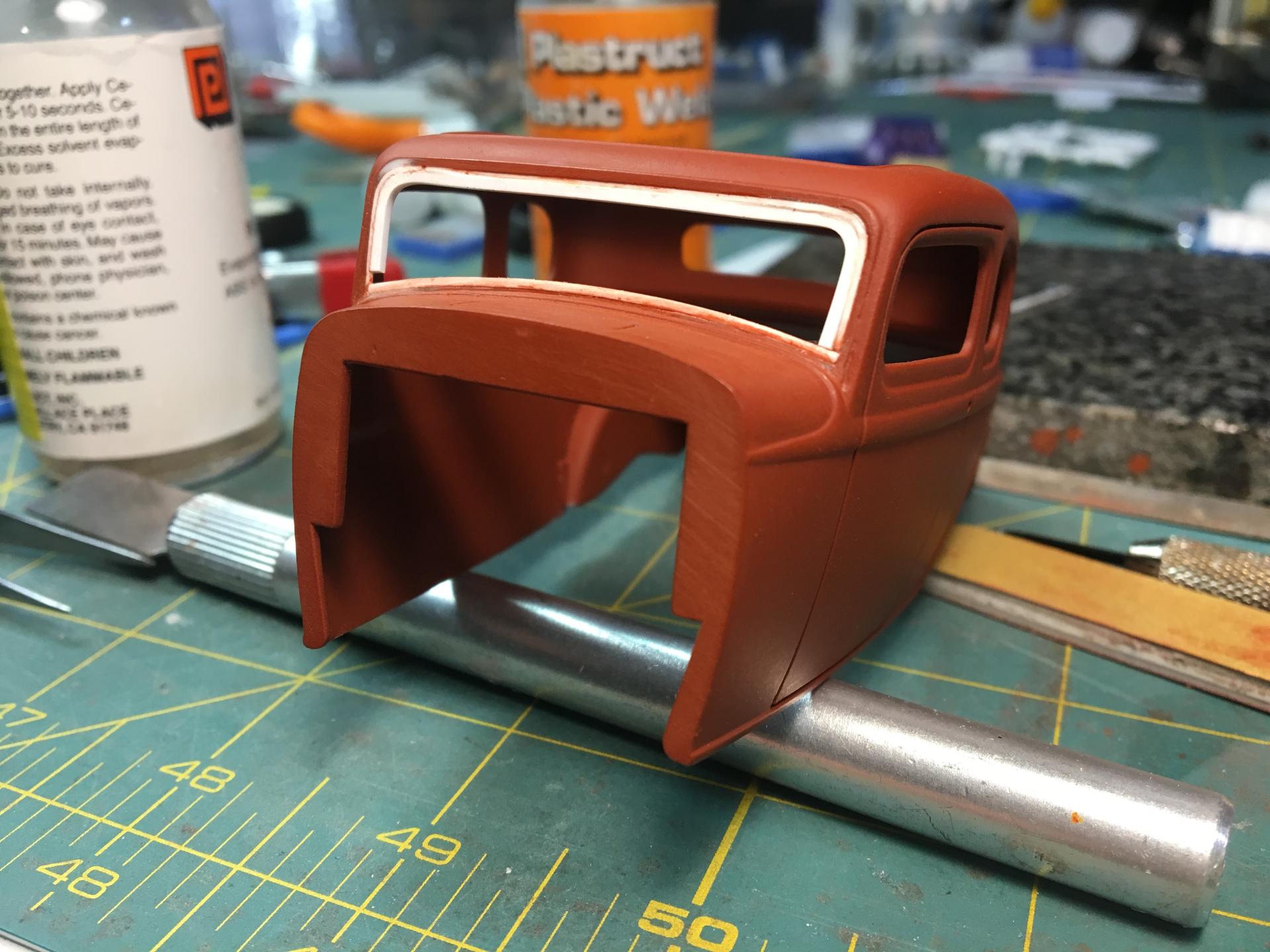

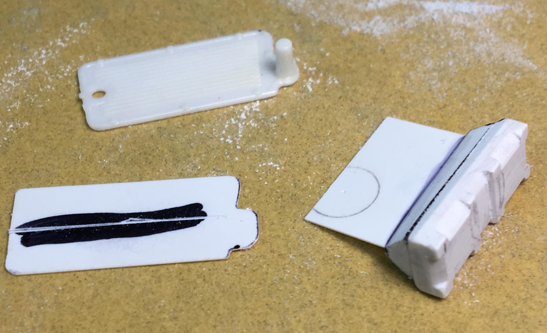

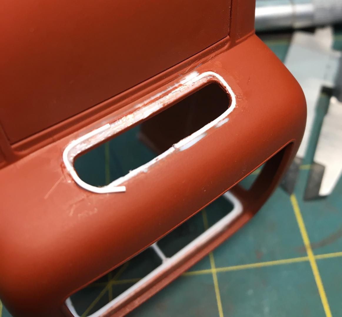

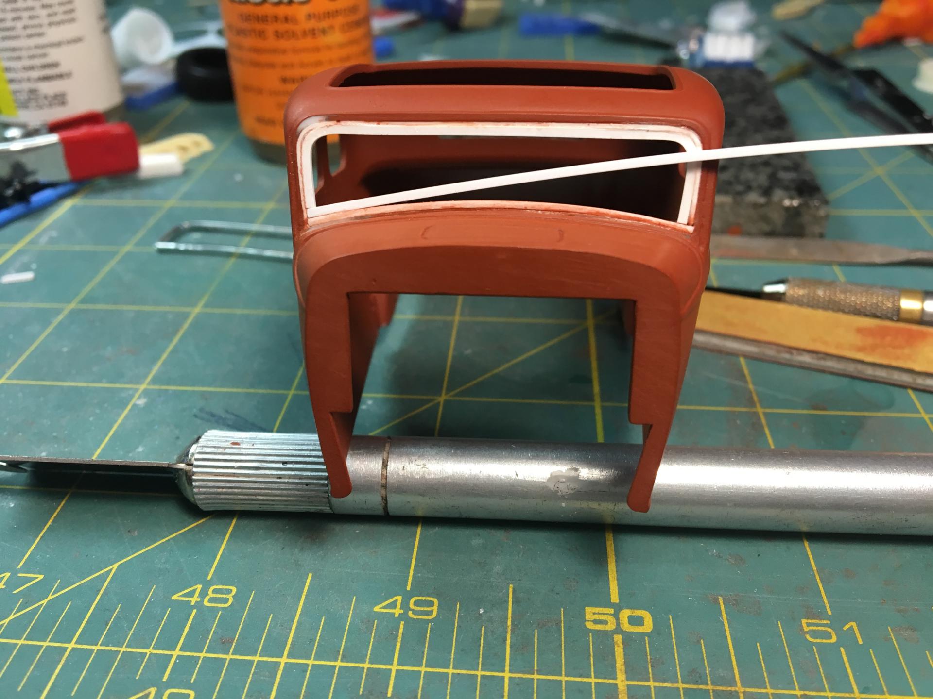

Rider Posted April 7, 2018 Author Share Posted April 7, 2018 Worked building up the windshield frame and making it into a split window. Also messing around with wheel ideas and carriage on with the gear theme. Quote Link to comment Share on other sites More sharing options...

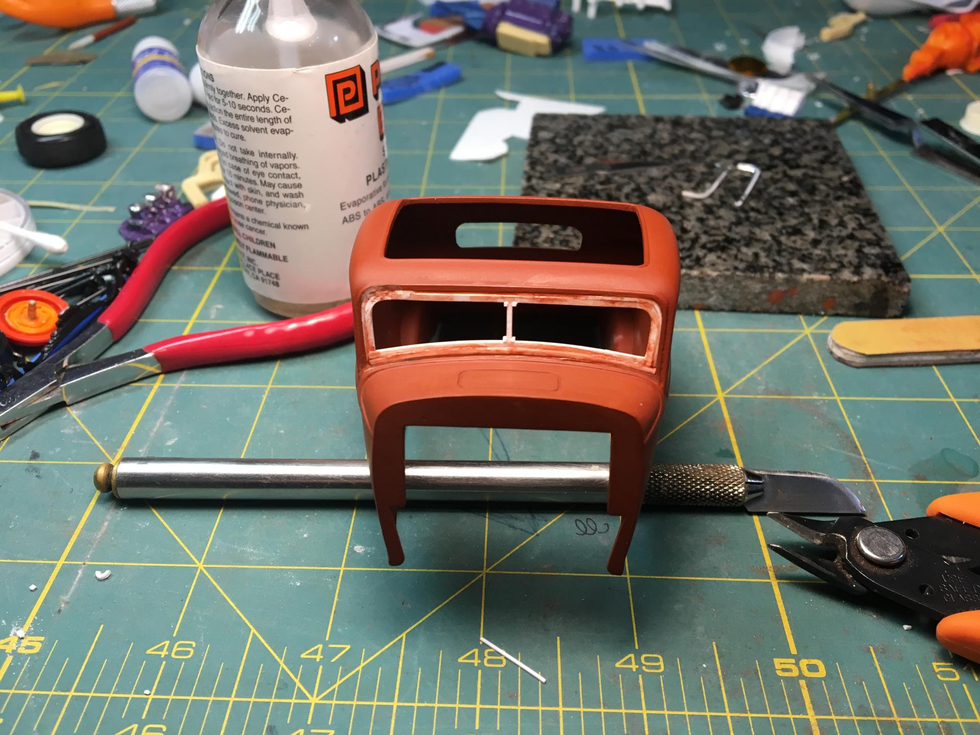

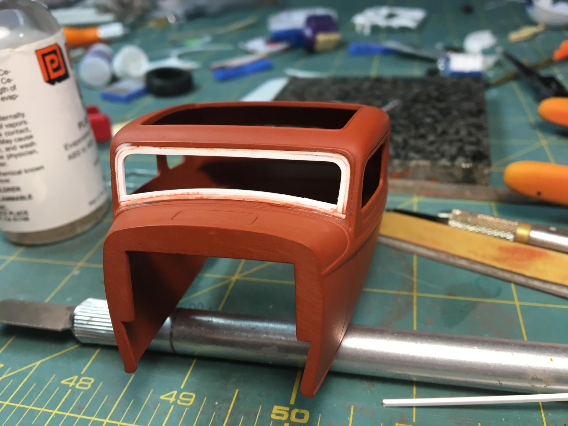

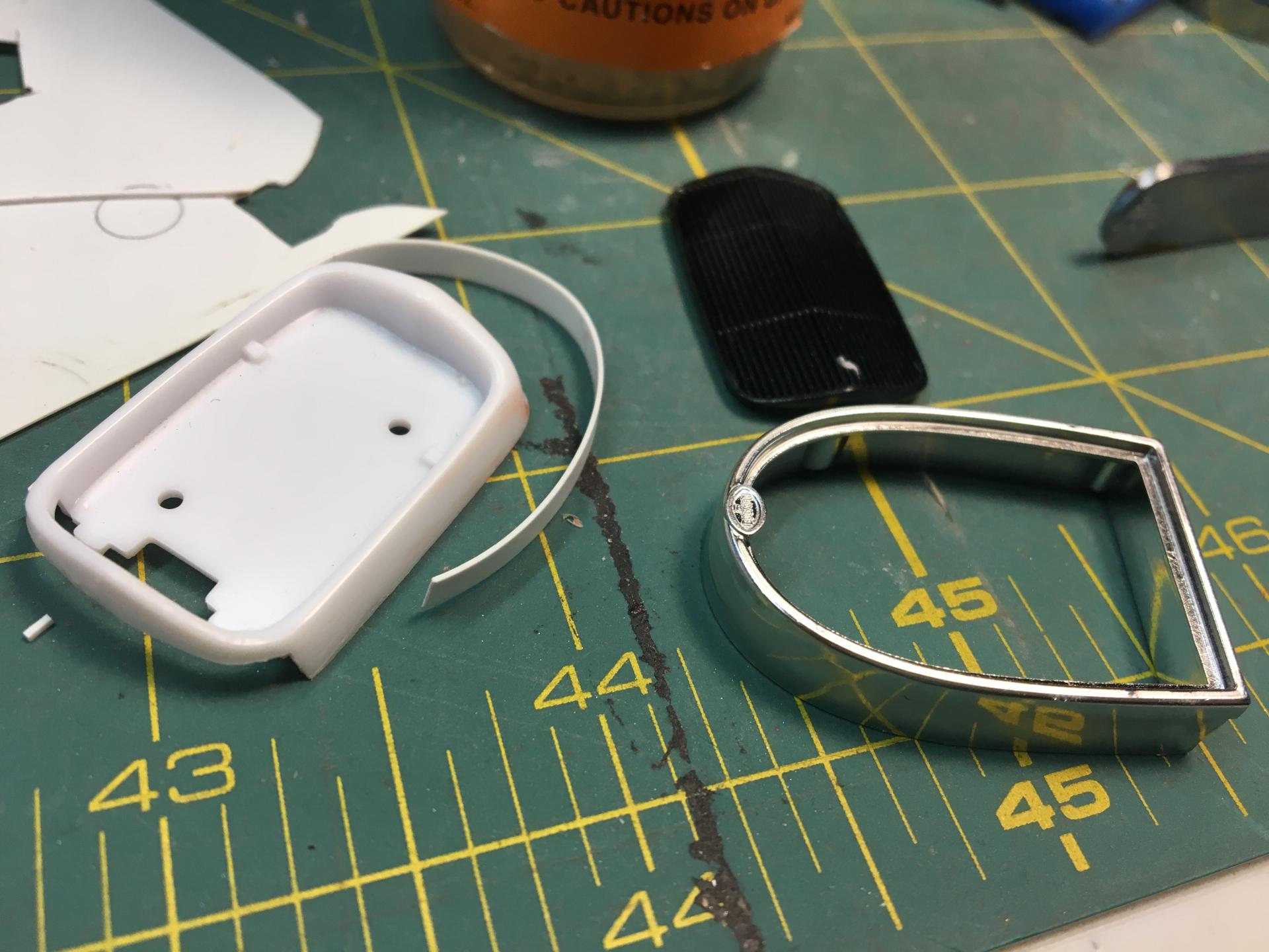

Rider Posted April 8, 2018 Author Share Posted April 8, 2018 A small update. Because I am lazy and have never learned how to measure and make bends I have to do the corners in pieces. Last night I was able to nail half with one piece. No luck tonight with the other half. So I decided to do each corner as a separate piece. I am not sure what I am going to do with the window. As I type this I am thinking of actually making it wider and taller. Did some more work on the windshield and started messing with the grill body. I started this build with chopped top only and the rest an OOB mindset, that has gone way off the rails. Quote Link to comment Share on other sites More sharing options...

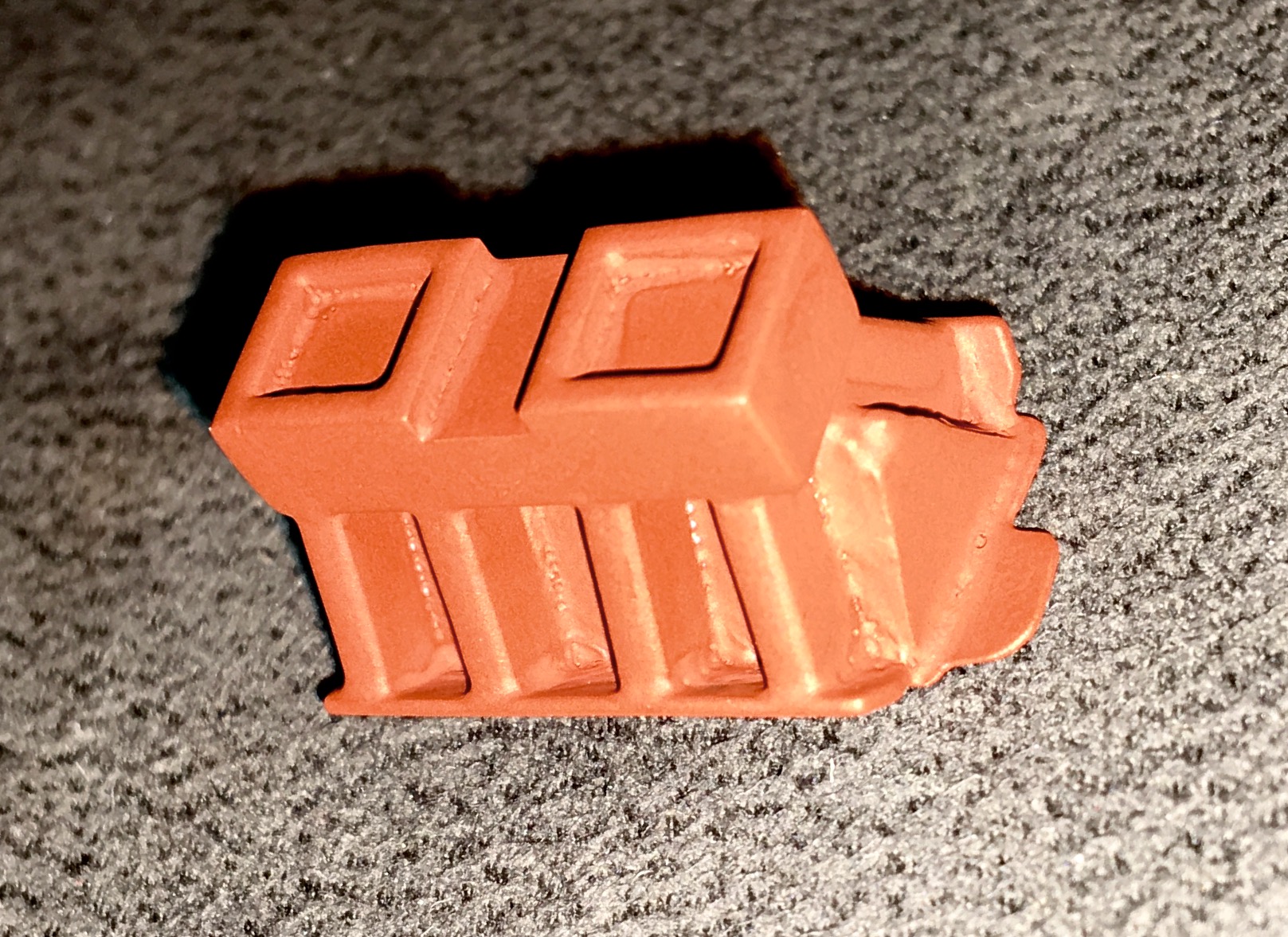

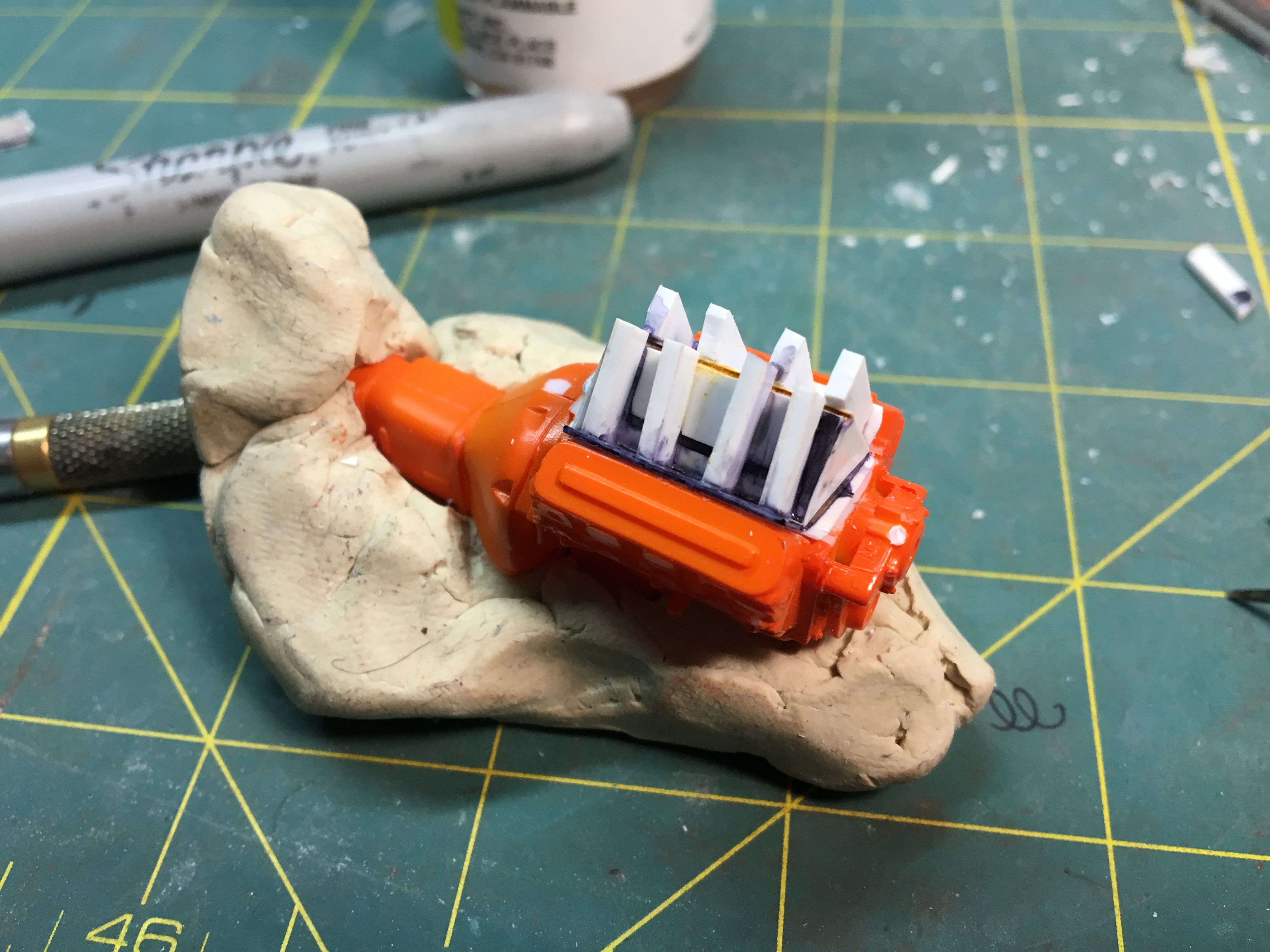

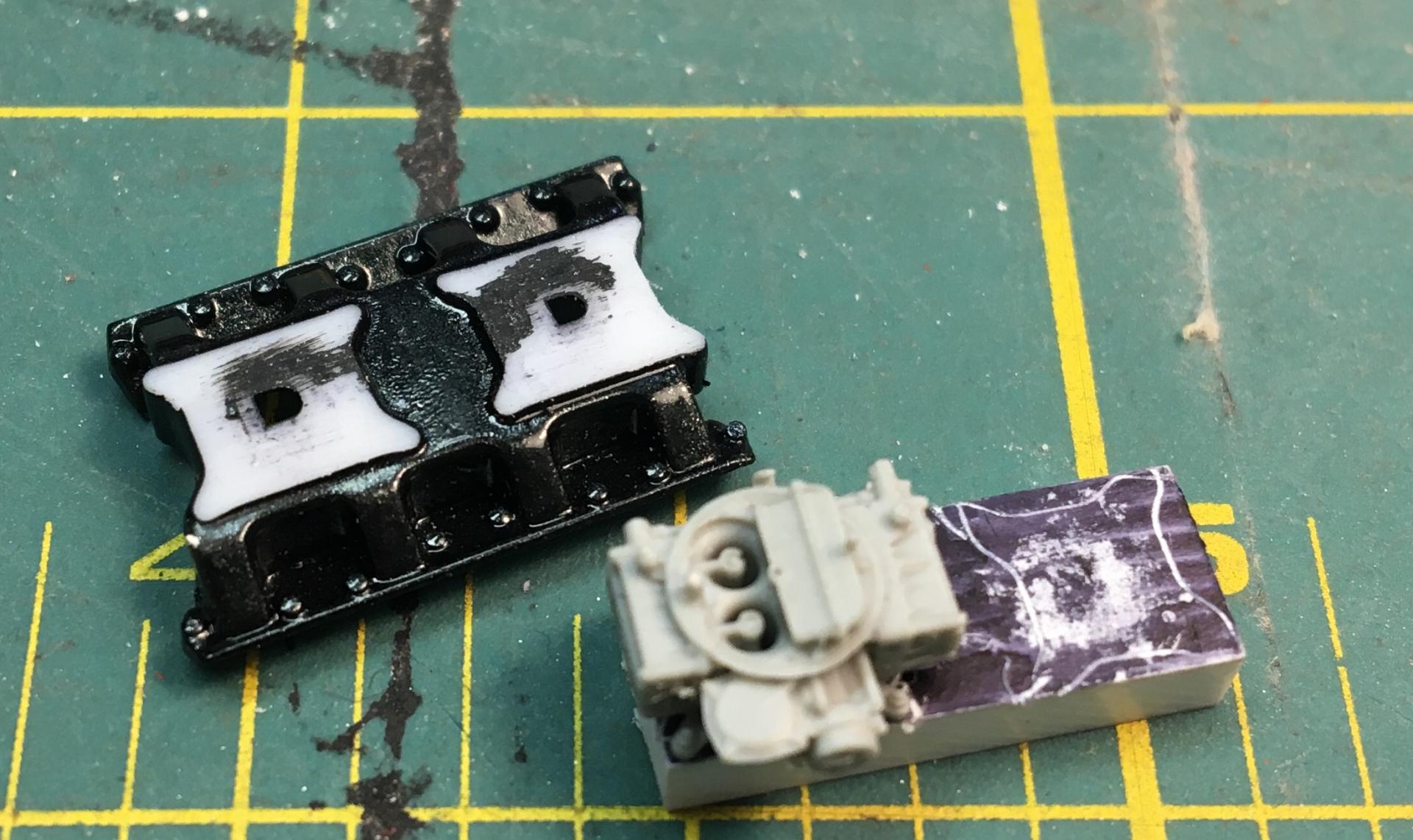

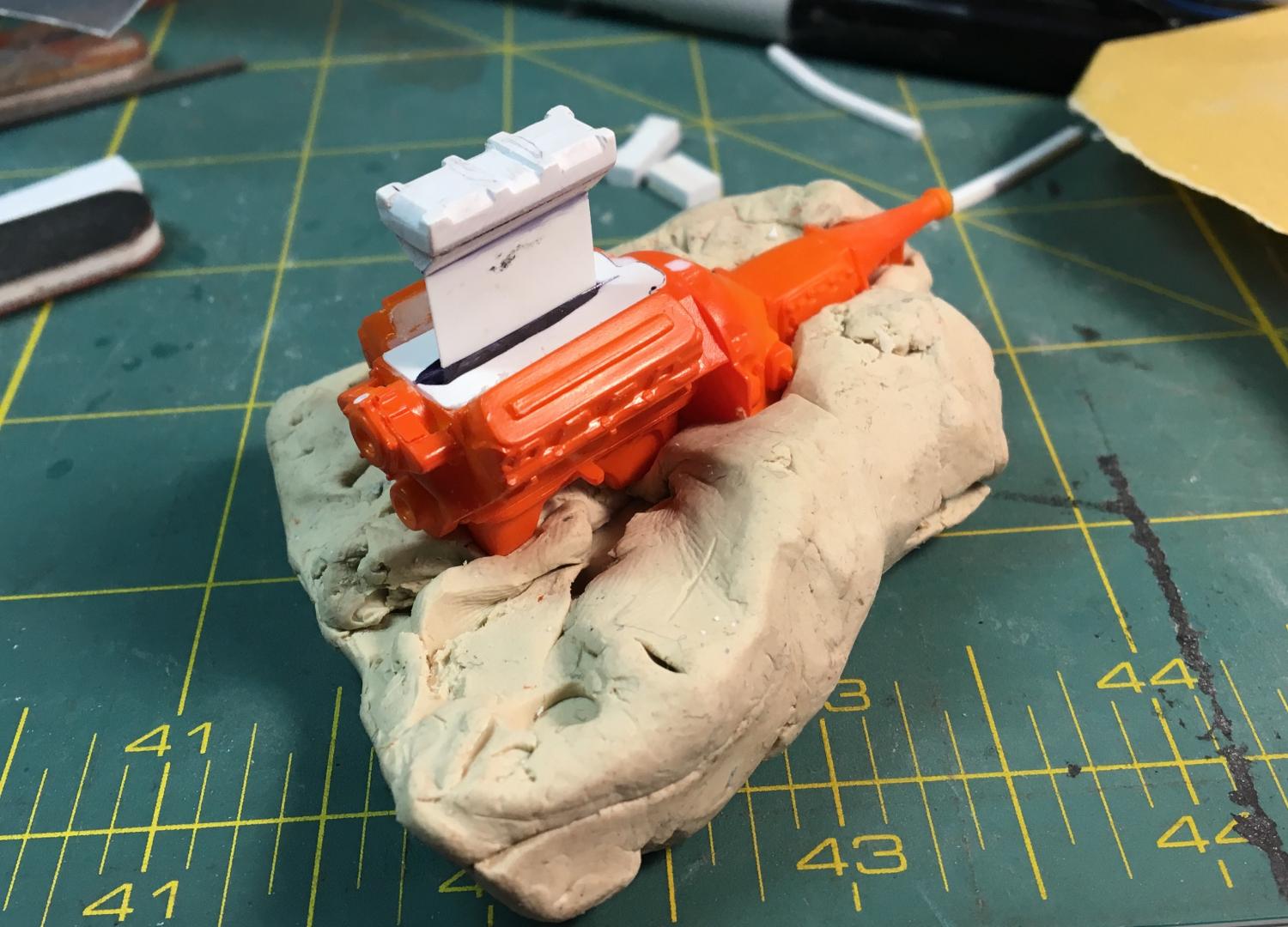

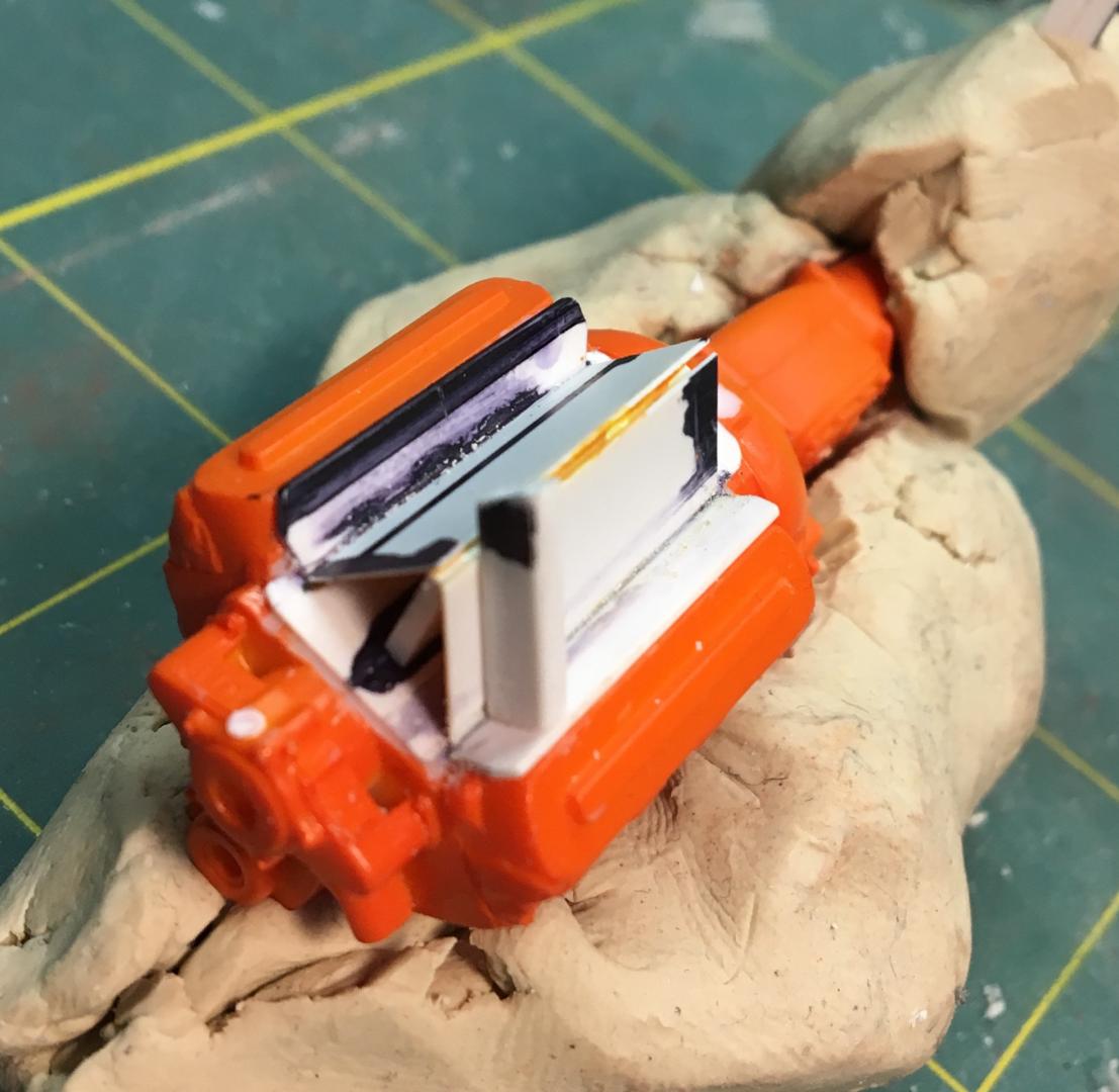

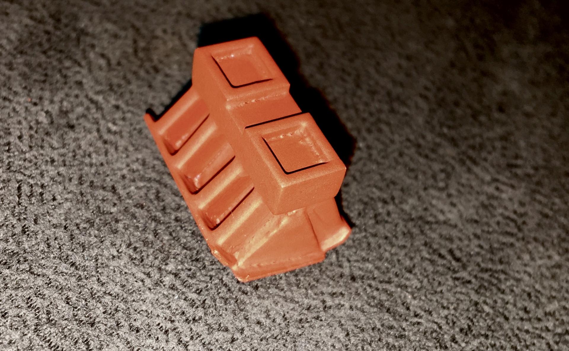

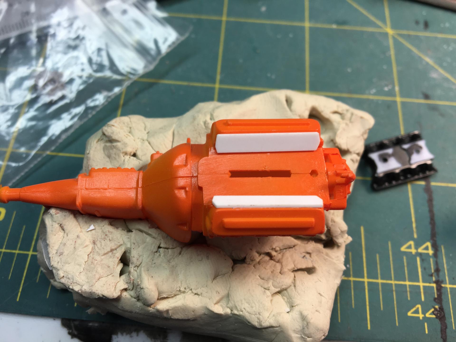

Rider Posted April 9, 2018 Author Share Posted April 9, 2018 Making a new tunnel ram intake. The carb mounting flanges are not very symmetrical but once the carbs are installed the flanges will not be seen, so I am not to concerned. Quote Link to comment Share on other sites More sharing options...

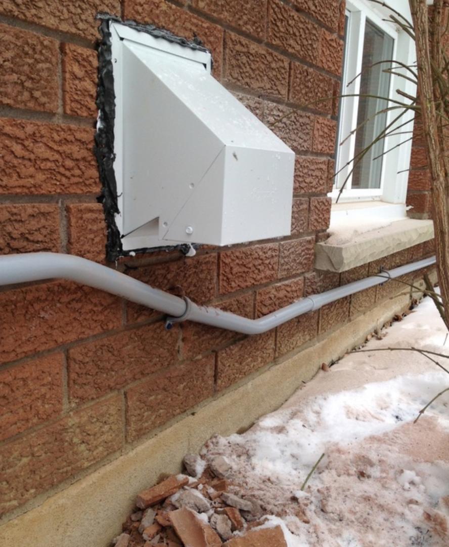

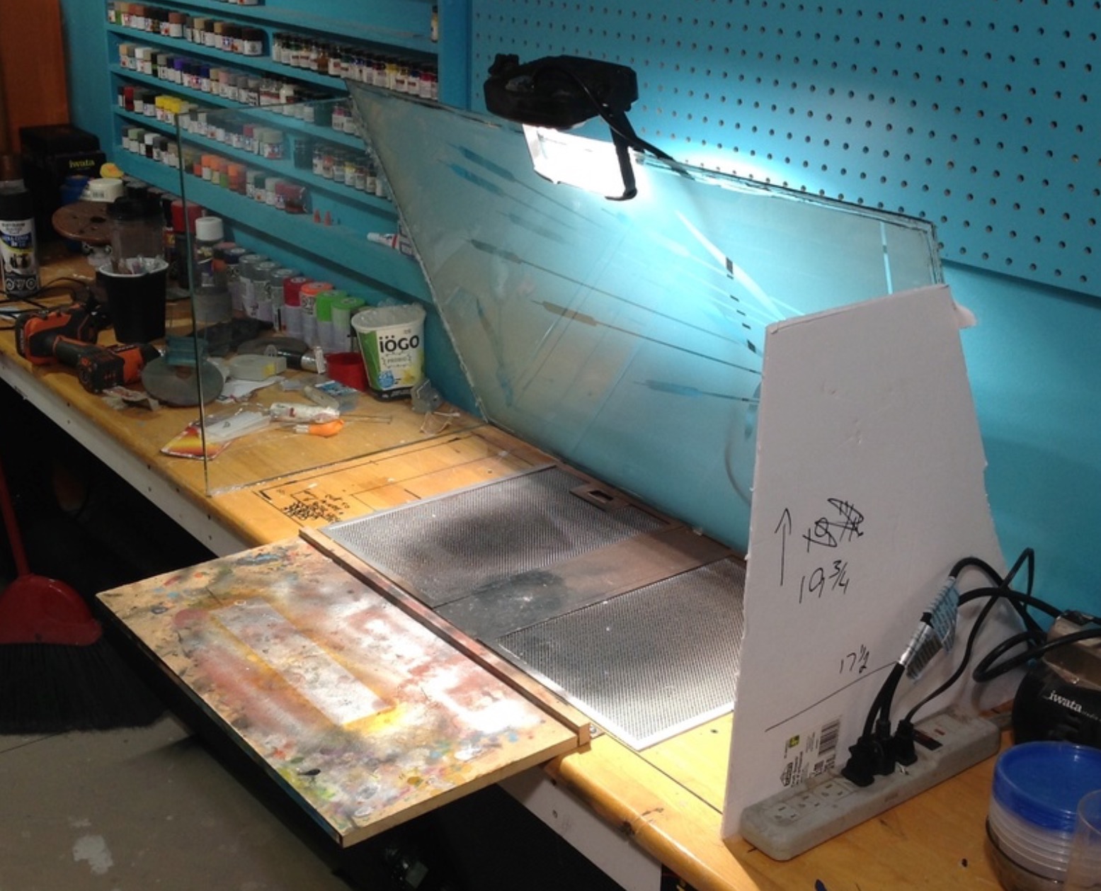

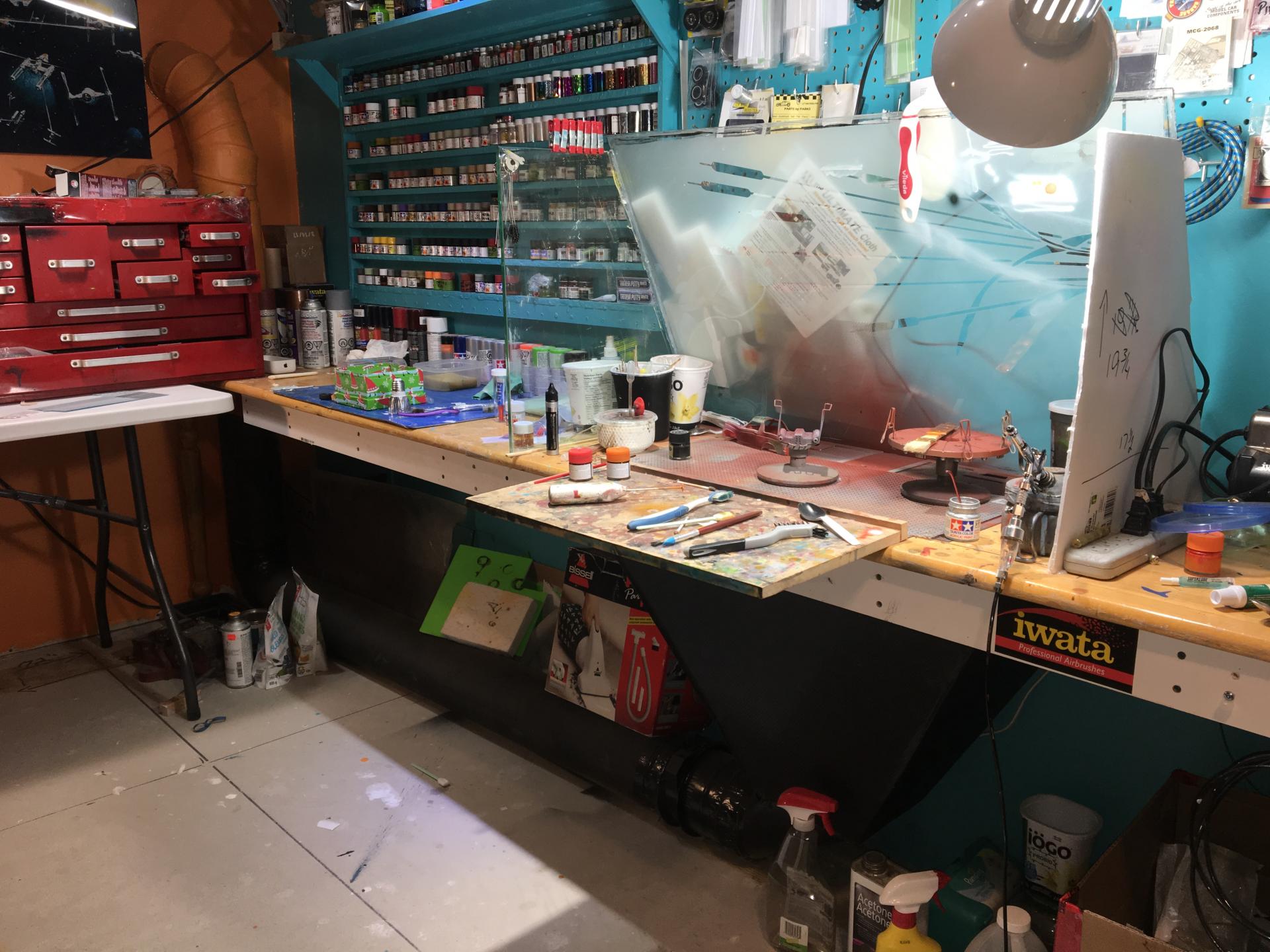

Mr Dedo Posted April 11, 2018 Share Posted April 11, 2018 Wow, now that's clean...but tell us about your spray booth. Is that a reclaimed industrial unit? Quote Link to comment Share on other sites More sharing options...
Rider Posted April 11, 2018 Author Share Posted April 11, 2018 (edited) Thanks Mr D. The spray booth is of my own design. It is a down draft design using a 6" sono tube, like the ones used for forming post holes, 6" ducting, a large server cabinet fan, grease grills for a large over head stove exhaust fan, reclaimed door windows, and a kitchen table ripped in half and mounted to the wall. I added a small work area that which you see extended out. I still need to replace the foam core end piece, I dropped the glass for that end during the build. Edited April 11, 2018 by Rider Quote Link to comment Share on other sites More sharing options...

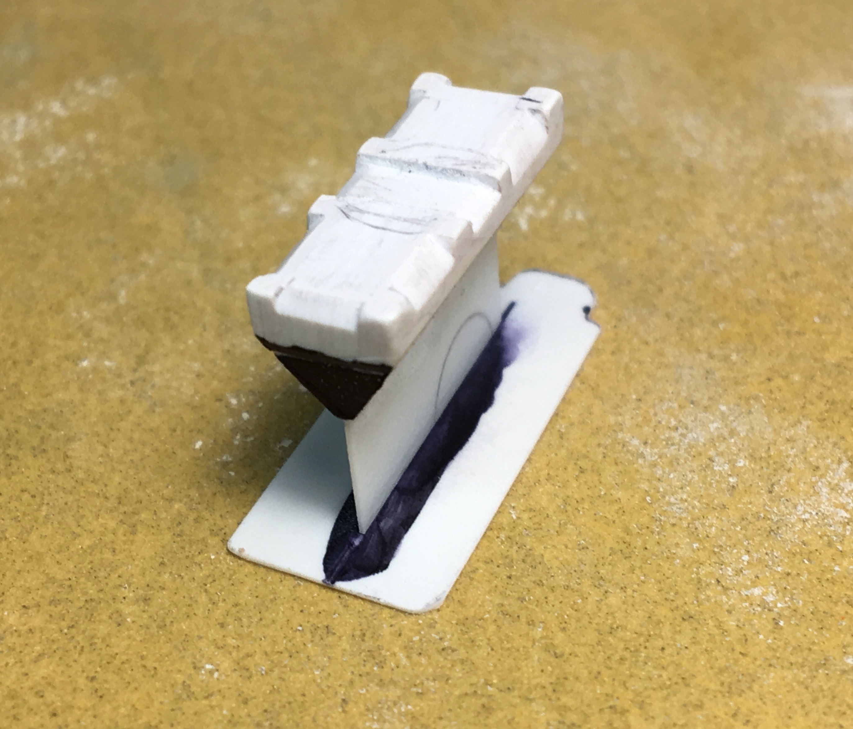

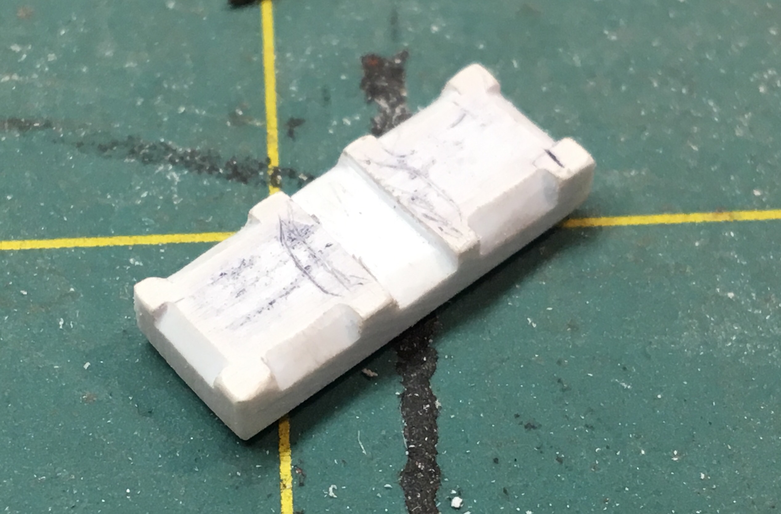

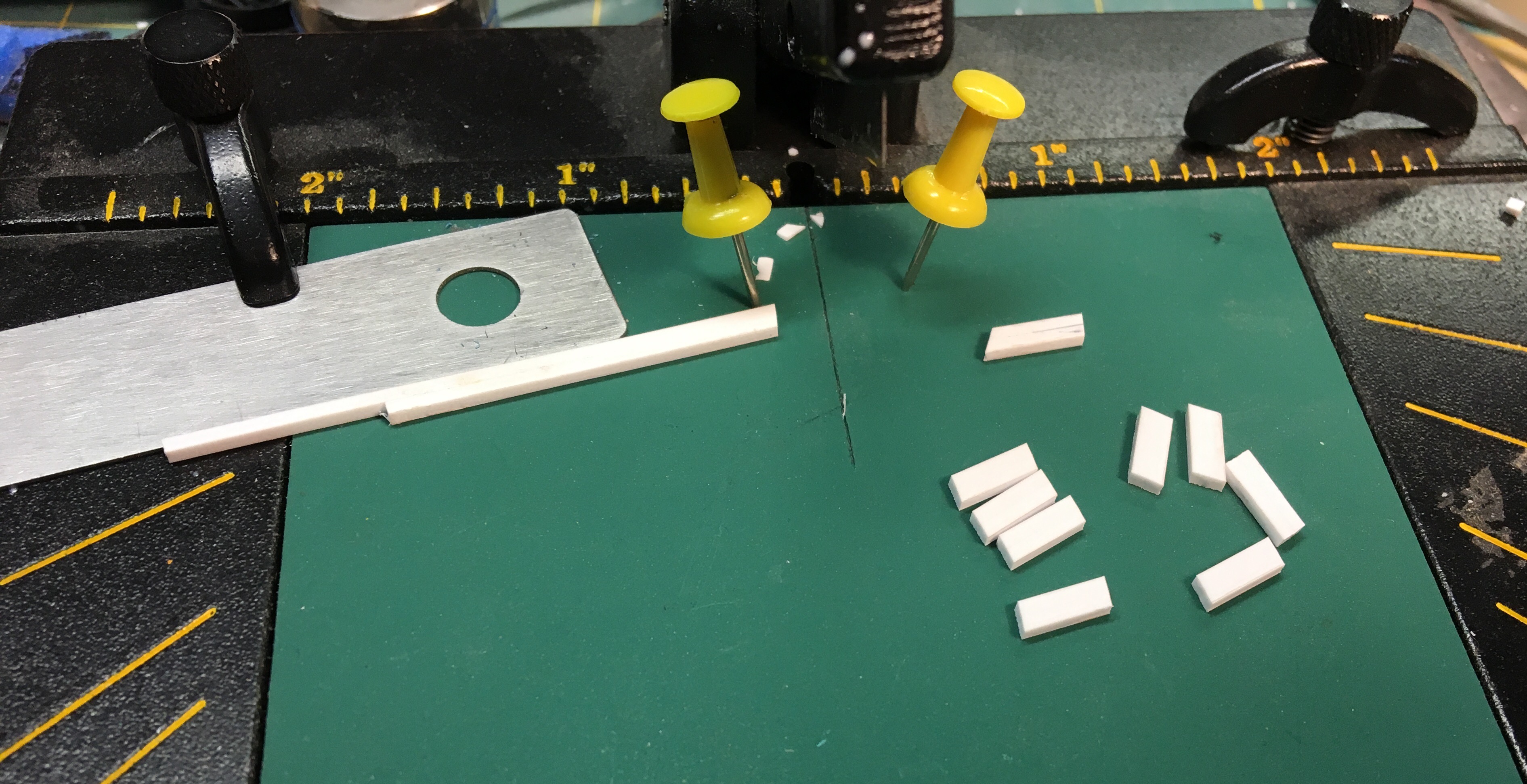

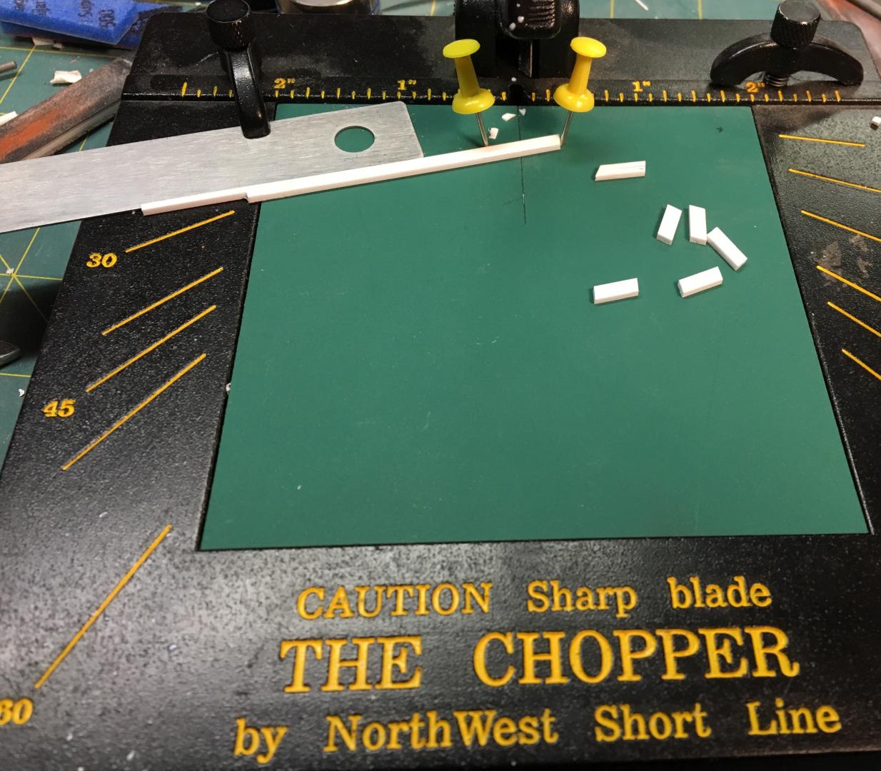

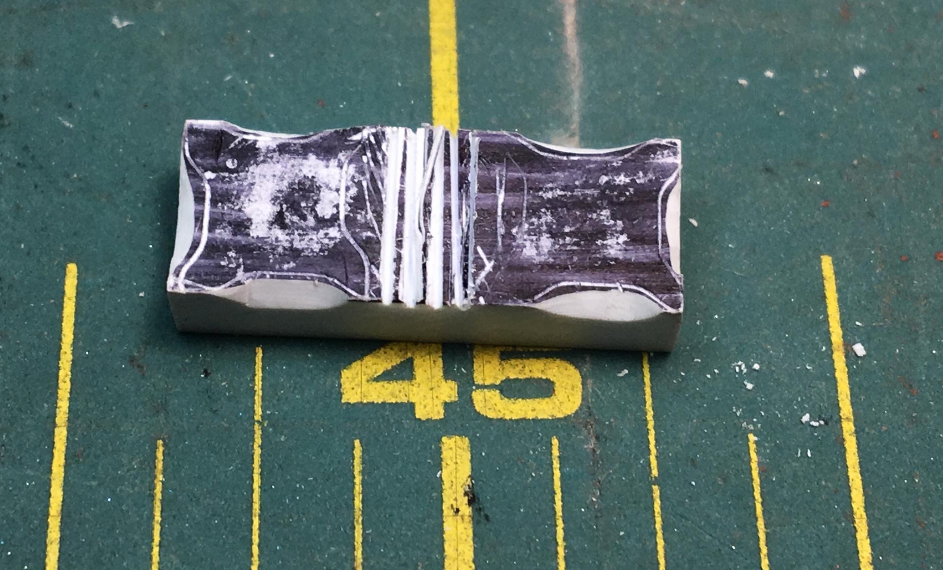

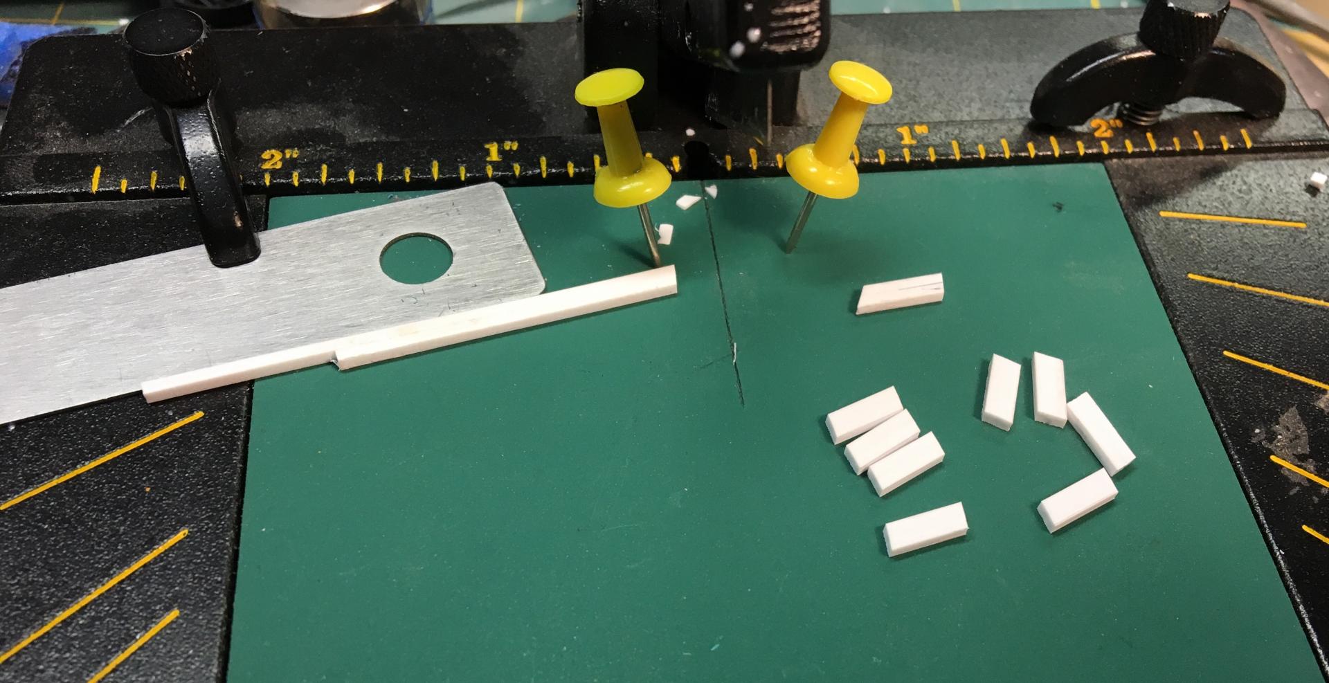

Rider Posted April 14, 2018 Author Share Posted April 14, 2018 Small update, I really had to work to get to this point with the intake. Once I got the first intake runner I made a fixture for my chopper, easy peasy. The intake looks pretty crude or racy right now, it will soften when it all comes together. At least I am hoping that is the case. Quote Link to comment Share on other sites More sharing options...

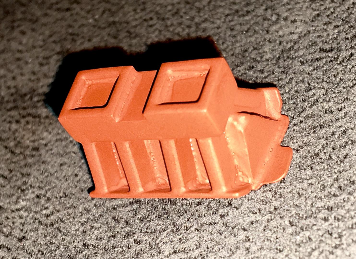

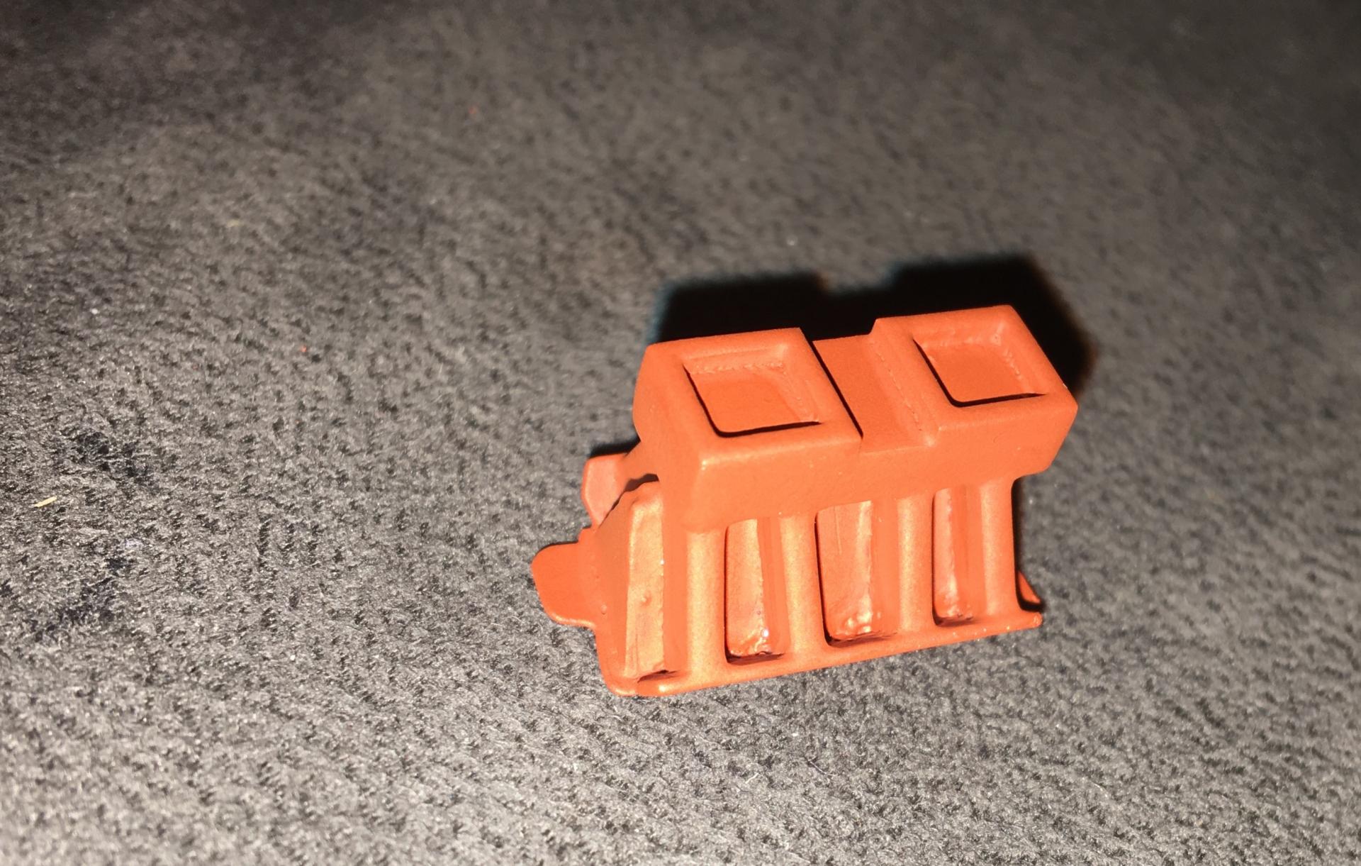

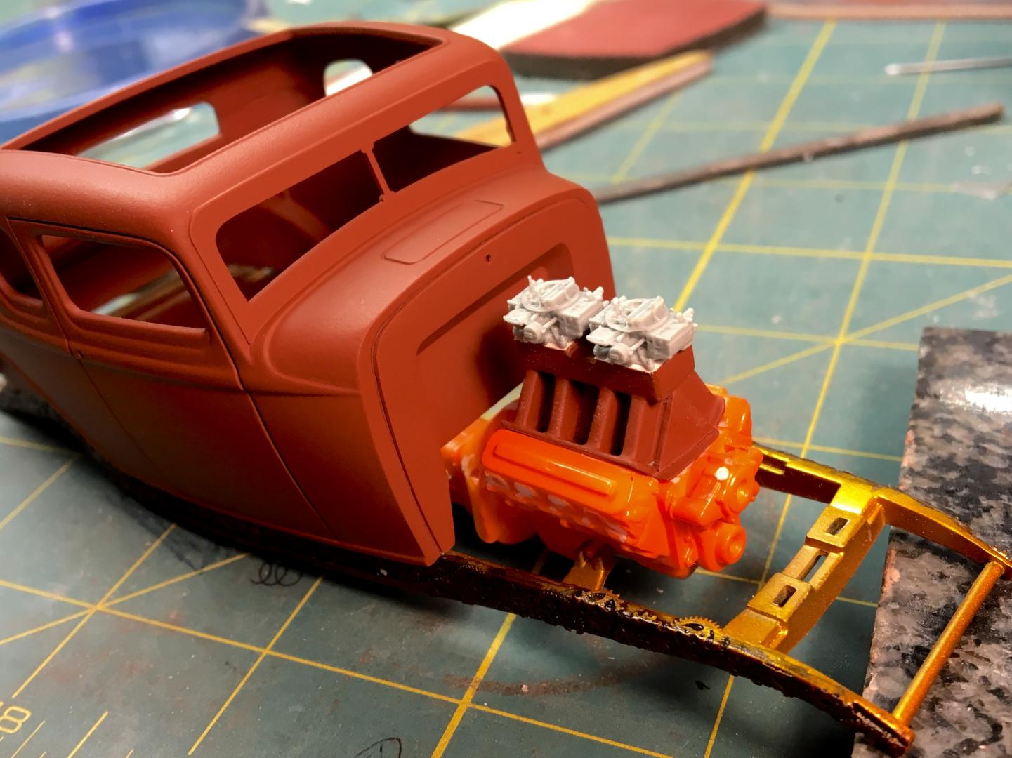

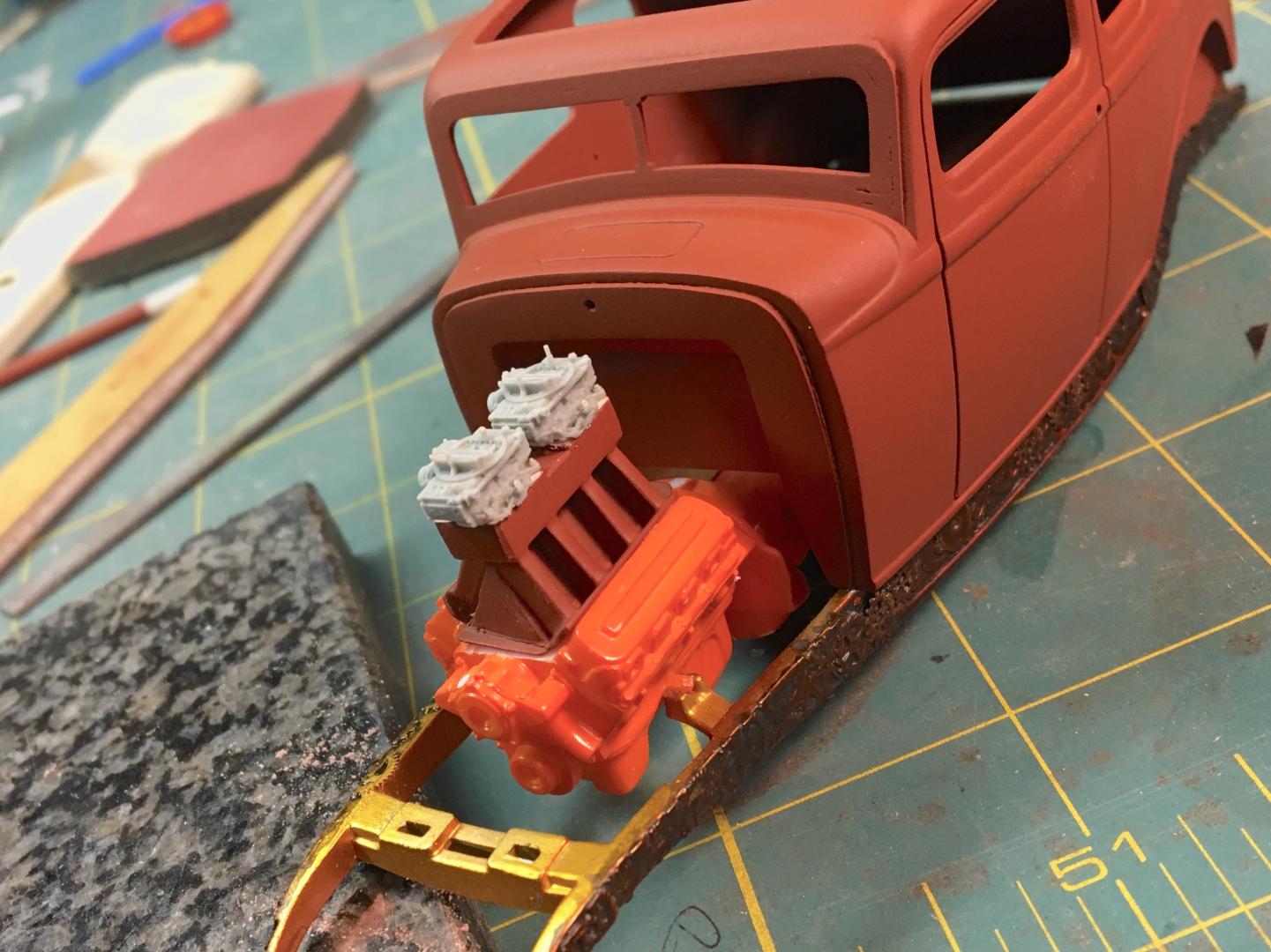

Rider Posted April 15, 2018 Author Share Posted April 15, 2018 On 2018-04-13 at 11:45 PM, DumpyDan said: Man that spray booth is awesome, I think I am going to stop painting and just send them to you instead. And that 32 project is very cool, I will send you some pictures of the Camaro I am working on. Thanks Dan, ya send Camero pics my way, would dig seeing them. Got the intake together and shot it with some primer, still needs a good shape sanding and clean up. Quote Link to comment Share on other sites More sharing options...

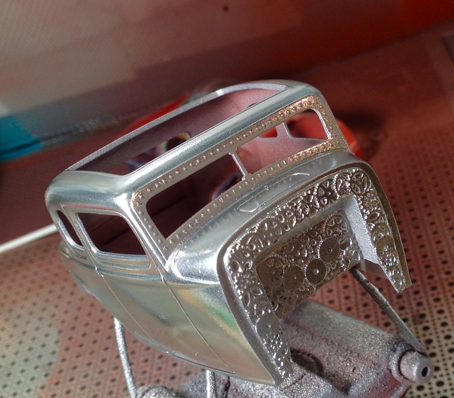

Rider Posted April 16, 2018 Author Share Posted April 16, 2018 (edited) 19 hours ago, DumpyDan said: Man that is some good work, impressive detailing......I Like! Thanks lots Dan. 12 hours ago, Dann Tier said: Love the weld lines!!! -this is so unique and impressive, that it should be in magazines!!! It does look like welds, but unfortunately they are not, they are just airbubbles in the primer. I think this is as good good as it is going to get before paint. I am still tweaking the shell and the chop. I think I am going to go with large iron work rivets around the front and rear windows. Edited April 16, 2018 by Rider Quote Link to comment Share on other sites More sharing options...

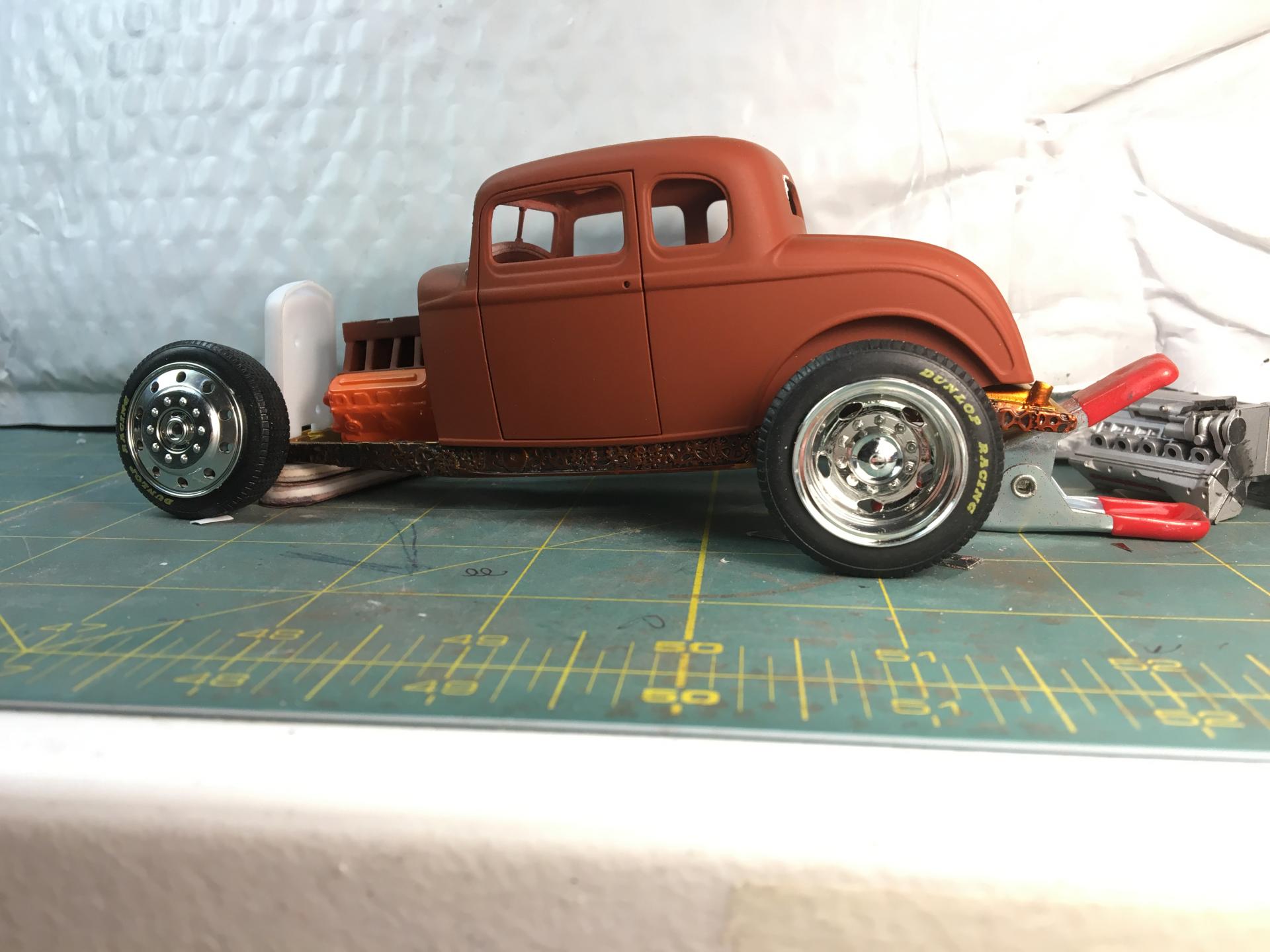

Rider Posted April 20, 2018 Author Share Posted April 20, 2018 Thinking maybe these wheels/tire's. Quote Link to comment Share on other sites More sharing options...

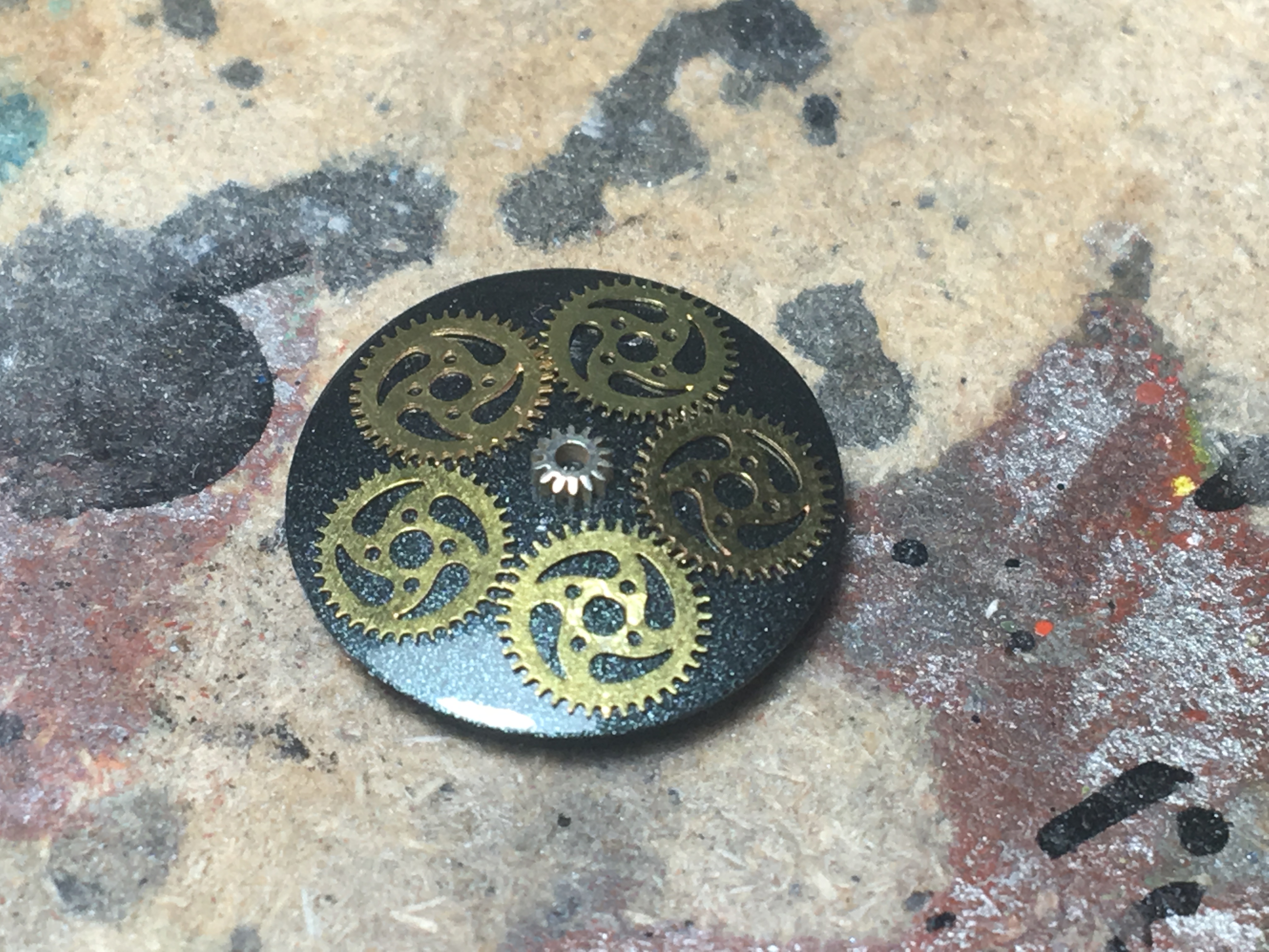

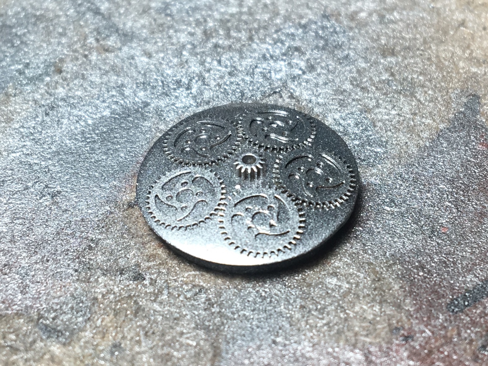

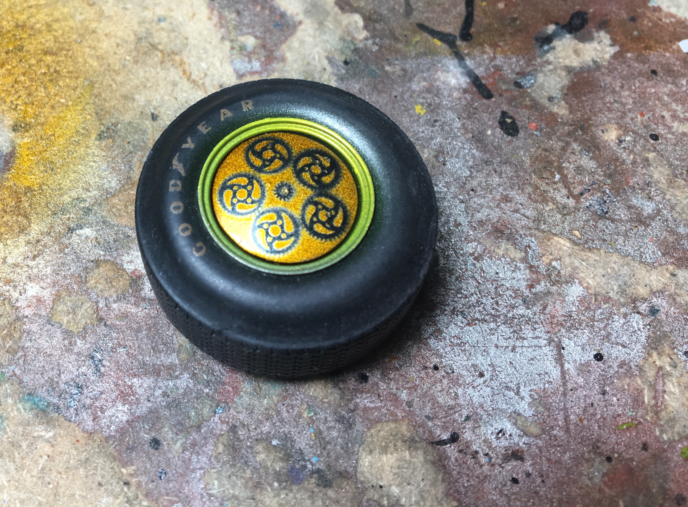

Rider Posted September 3, 2018 Author Share Posted September 3, 2018 (edited) I have add some detailing to the windshield, the Molotow Chrome turned out ok. This is just a base, I am not too concerned about the orange peel/rough surface, it will eventually get buried with multiple layers of 2x Poly-U clear. Edited September 3, 2018 by Rider Wrong photo Quote Link to comment Share on other sites More sharing options...
