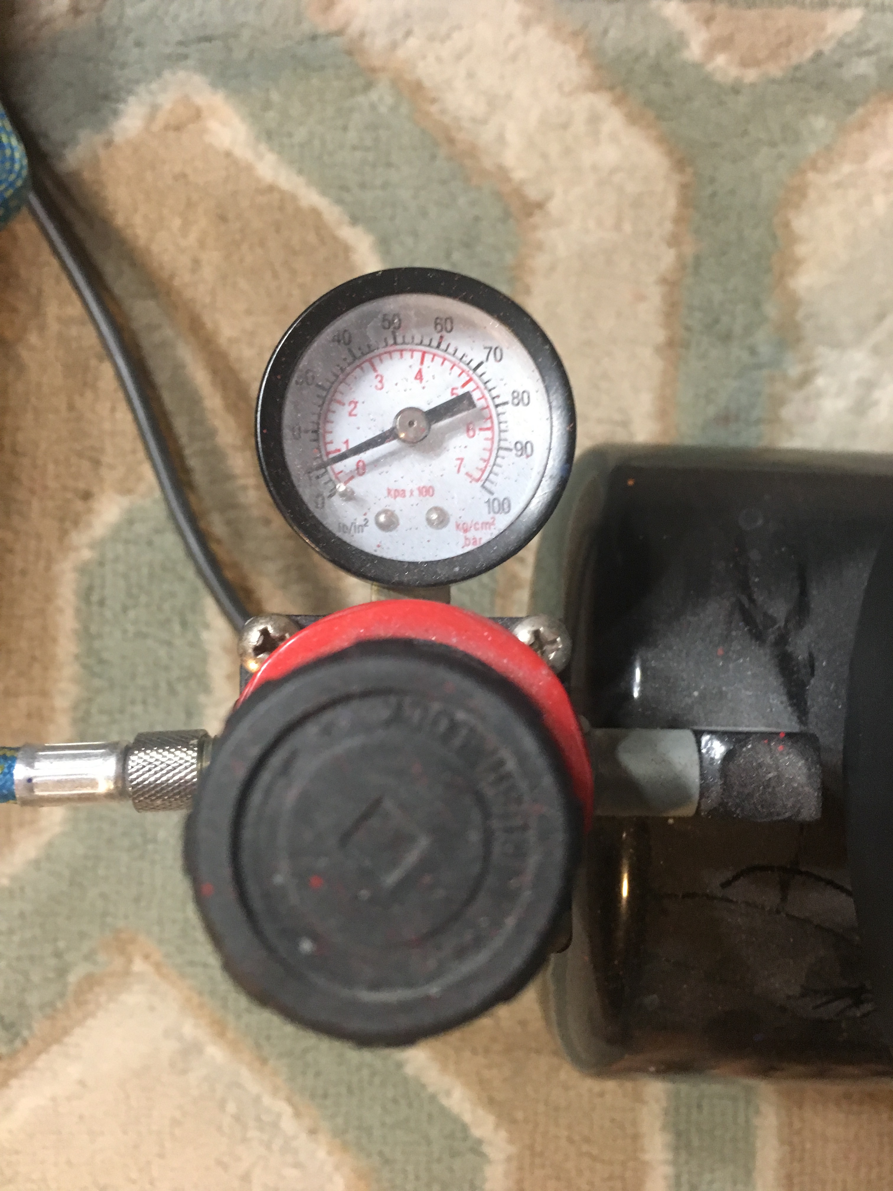

I may need a new regulator?
Hi,
My air compressor seems to work well.  However my inidicator never seems to go below 10PSI
Attached is a picture of it off and empty.
I'm curious if a new regulator would allow it to register 0 as well as allow dialing it down to below 15PSI as anything below that seems to not work too well.

When you turn the regulator all the way down (off), is any air coming out of the regulator? If not it is the gauge, not the regulator that is bad.
Hi,
I see.  Well turning it down all the way with the compressor on, yields no air coming out of the regulator.  So the gauge is and has been since I bought it, sorta broken.
Thanks for the tip.  I'll see about replacing it.

Do you know what brand the regulator is?
Hi,
It's a PointZero air compressor and came complete with the regulator etc...    I'm unsure what exactly it's a knock off of.
PS Looks like any 1/4" side mount gauge would do.  I'll probably look for one with lower max PSI as I rarely have it over 30.  Seems like 0-60PSI gauges are common enough.

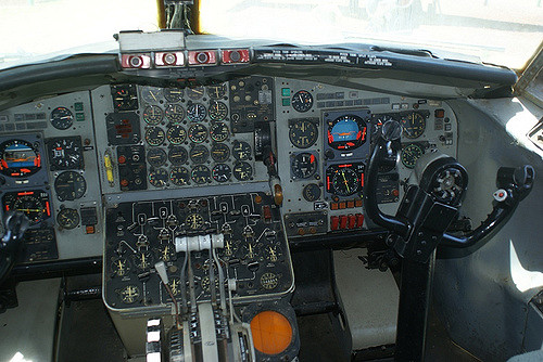

Still prefer analog gages.  Frankly they are easier and quicker to read especially if you have a row of them.  Digital require that you read the number and then mentally process it.  Analoge just requires that you "look to see if it is the right position".  :D This is my old "office"
