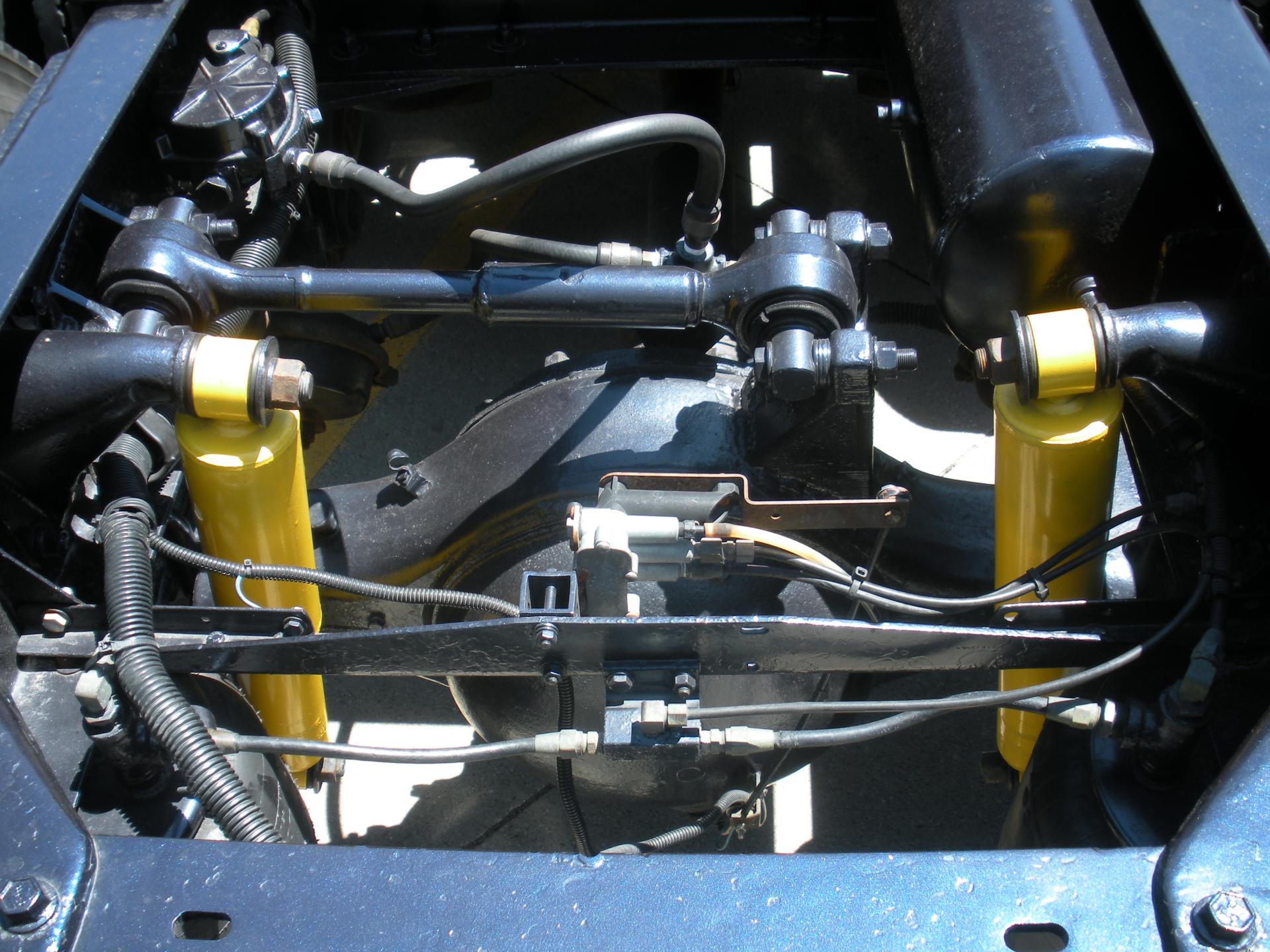

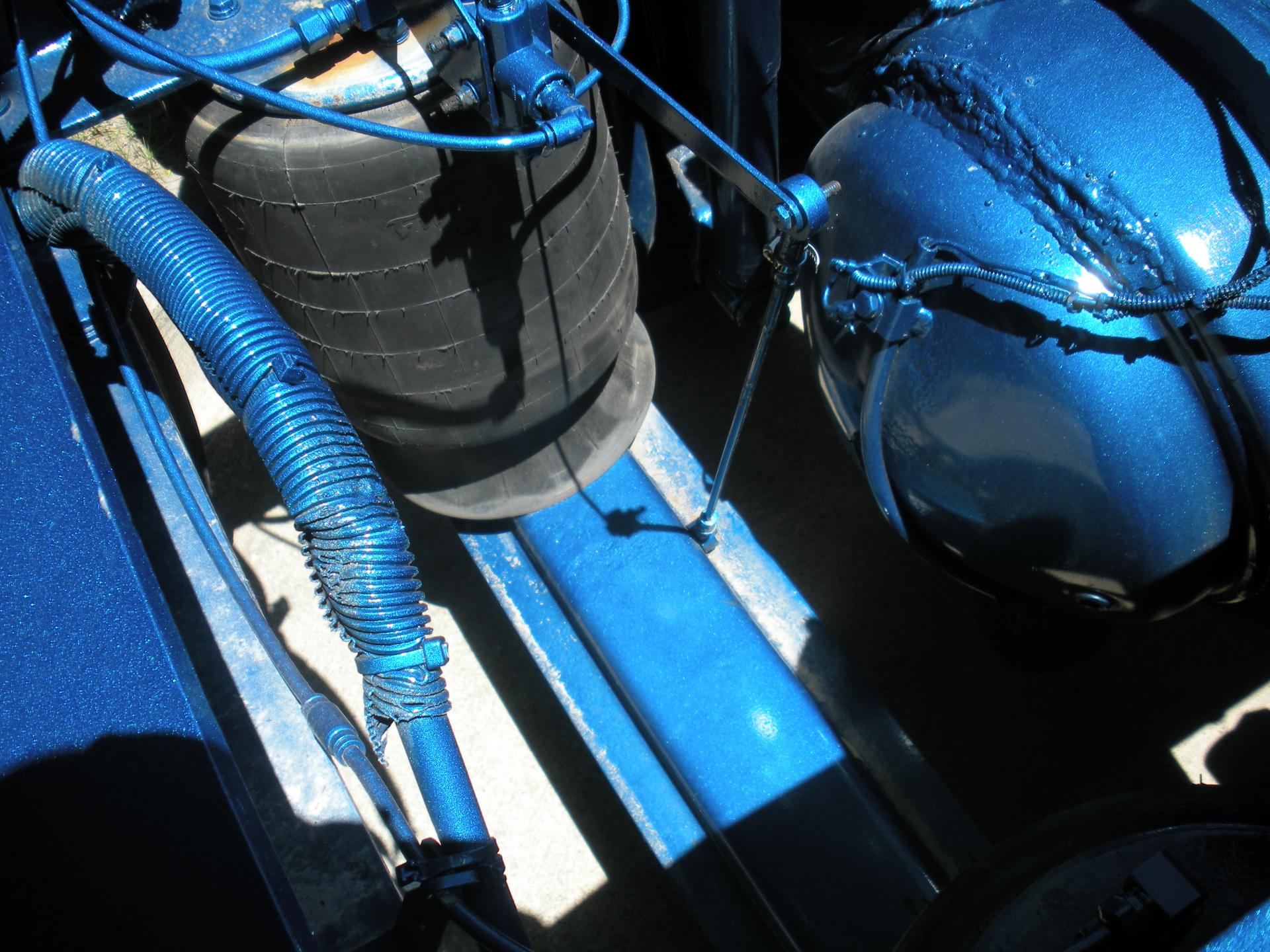

Yeah about the air leveling switch piece -- I saw a couple different ones at the ATHS truck show in Des Moines and I couldn't make sense out of the piece in the kit or what it was patterned after.   These are the kind I saw (on KWs).

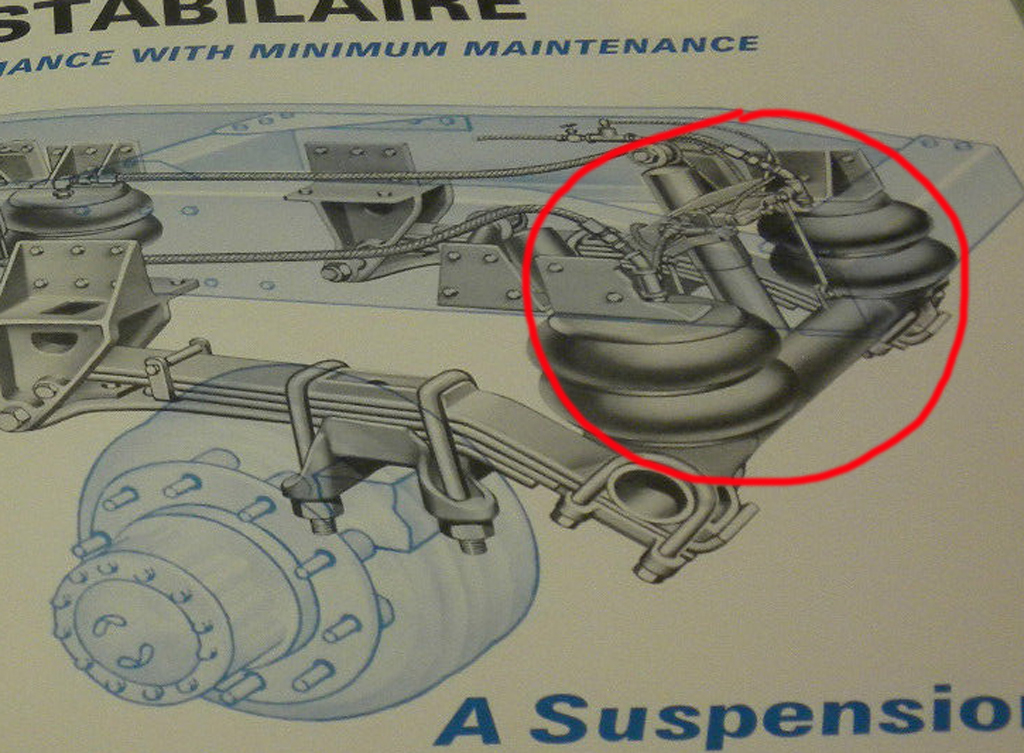

The rear suspension on the 359 "Small Window" and 352 kits is the Western Unit Stabilaire, later Peterbilt did the later Air Leaf and Freigtliner took over the Stabilaire, called it FAS Airliner and used it up to the late 80's when it was replaced with a more modern unit.
In the beginning they used two ride hight/level control valves per axle like in the kit, but this has later changed to one as the axle itself is solid and you don't need more than one, the ride hight/leveling control valve actuator rods are mounted on the round bar between the leaf springs the air bags are mounted to and not to the axle itself, so the kit instructions is right as the valves are supposed to be behind the axle facing rearwards...they are quite crude tho' and need some improvement.
Here is a picture from a Peterbilt broshure to explain.
Edited by Force
Share this post
Link to post
Well,   Shazam !!!     Wow.    Thanks so much for posting that picture.  That explains a lot.   That photo also is nice as it shows the 1:1 suspension -- much better than the AMT kit instructions.
I'd love to get a copy of that brochure  !!     If it could be copied and maybe emailed ?
Thanks again for this !!
