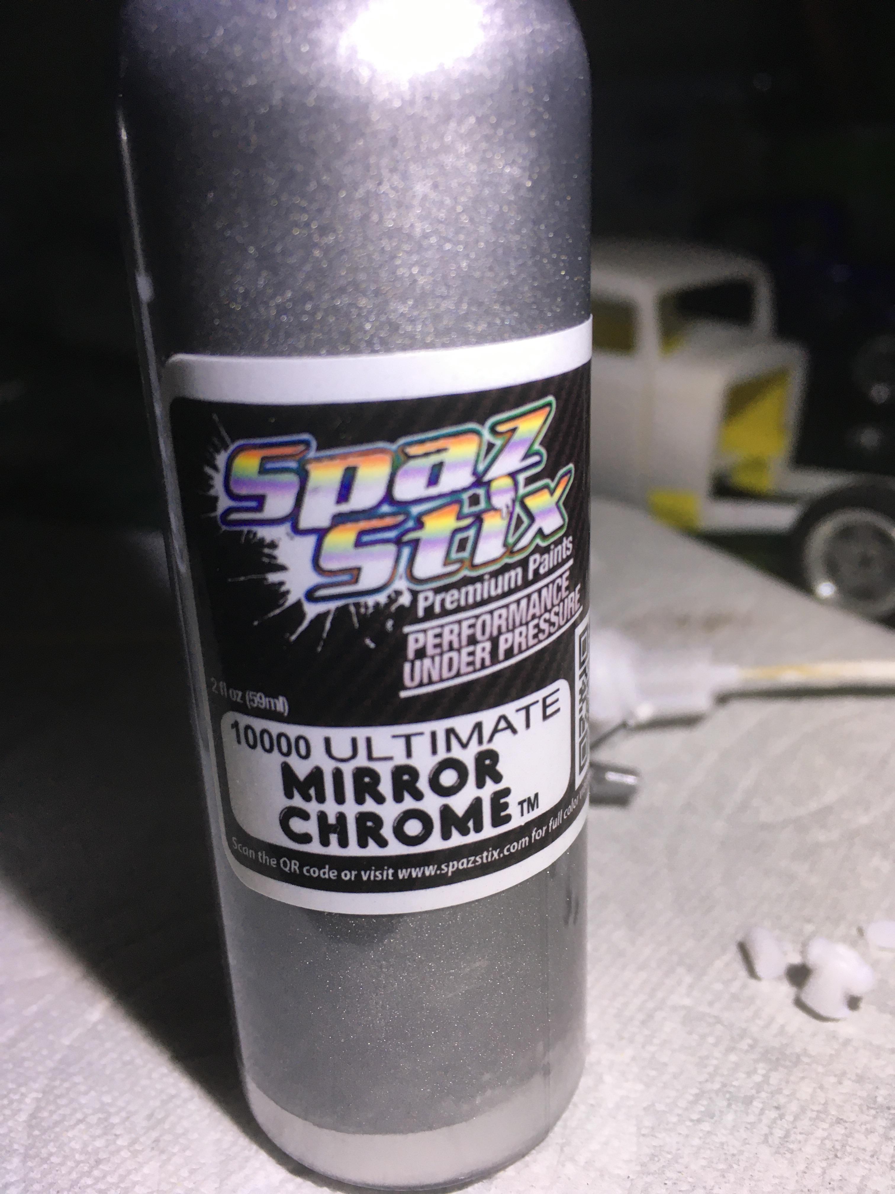

My friend Mark tried this stuff. I ordered it from amazon. Not really expensive. Just apply like alclad . Base black with this over it. He says it’s a little stronger than alclad. We will see this weekend. I have a 32 ford I’m having trouble deciding a color. Might use this and see if it will work. It might work for you.
Share this post
Link to post

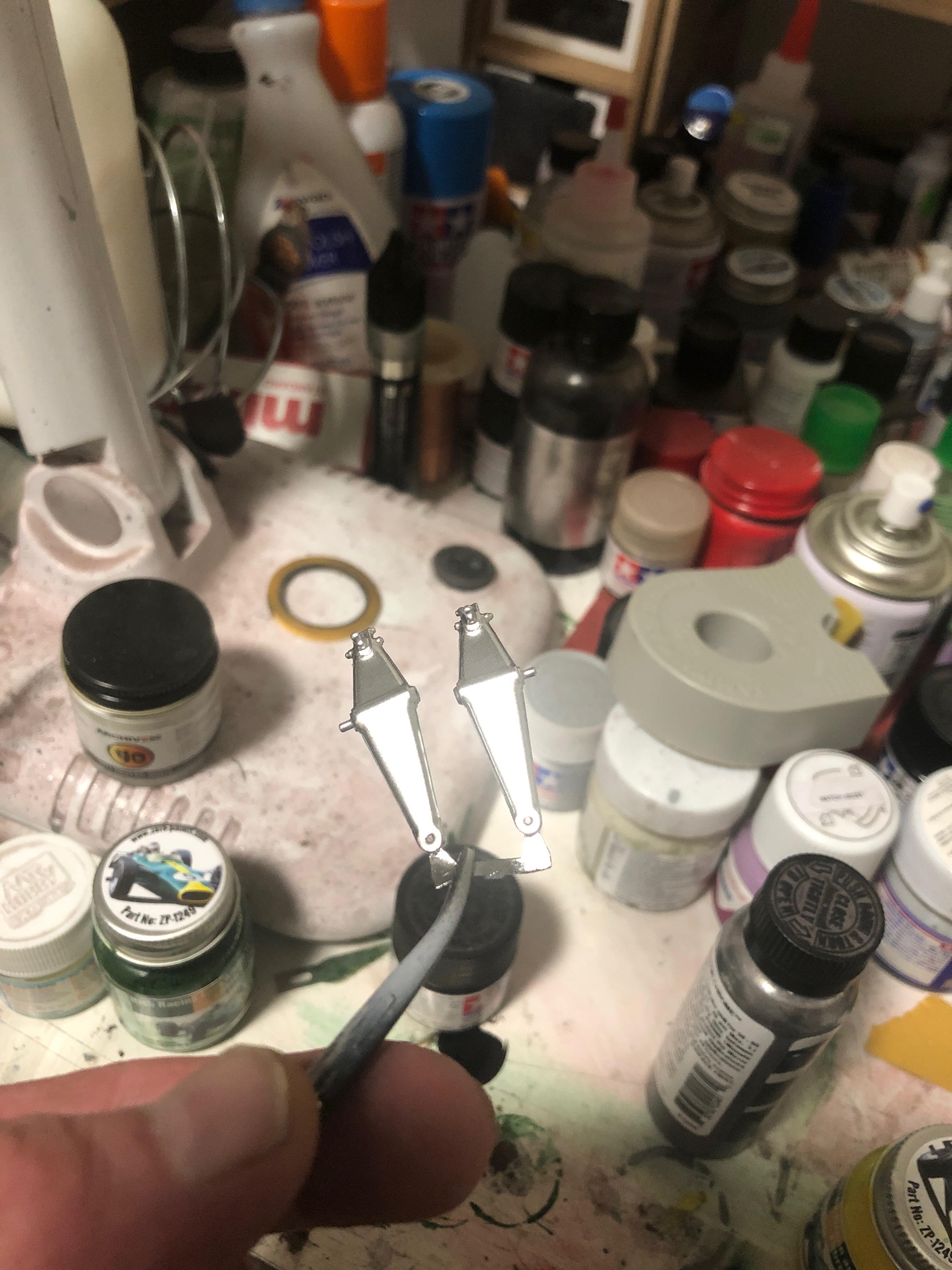

Here is what he sprayed. Model factory hiro lotus 49 front upper control arms.

I just shot some Spaz Stix on some smaller engine parts.  I have used it several times on smaller parts.  I have been pleased with the results.  Not truly chrome but way better than silver spray paints.
