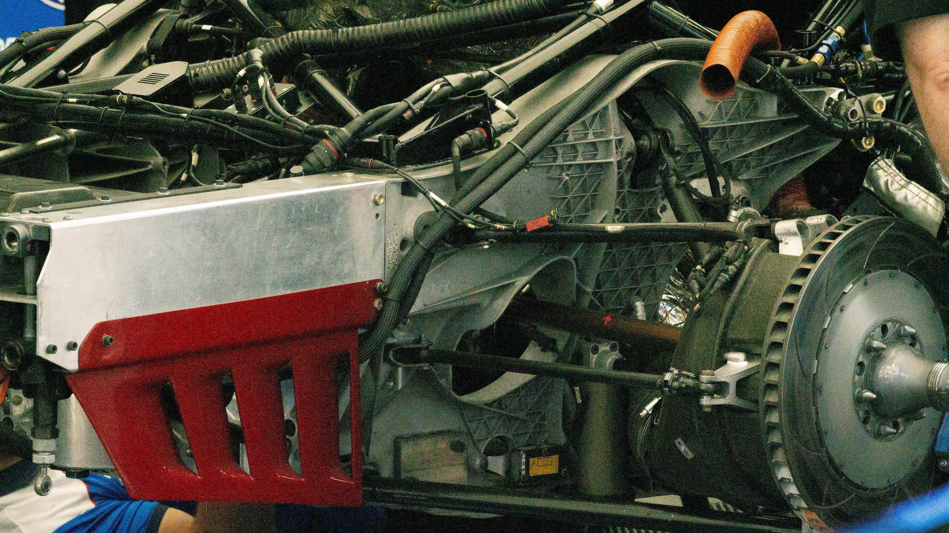

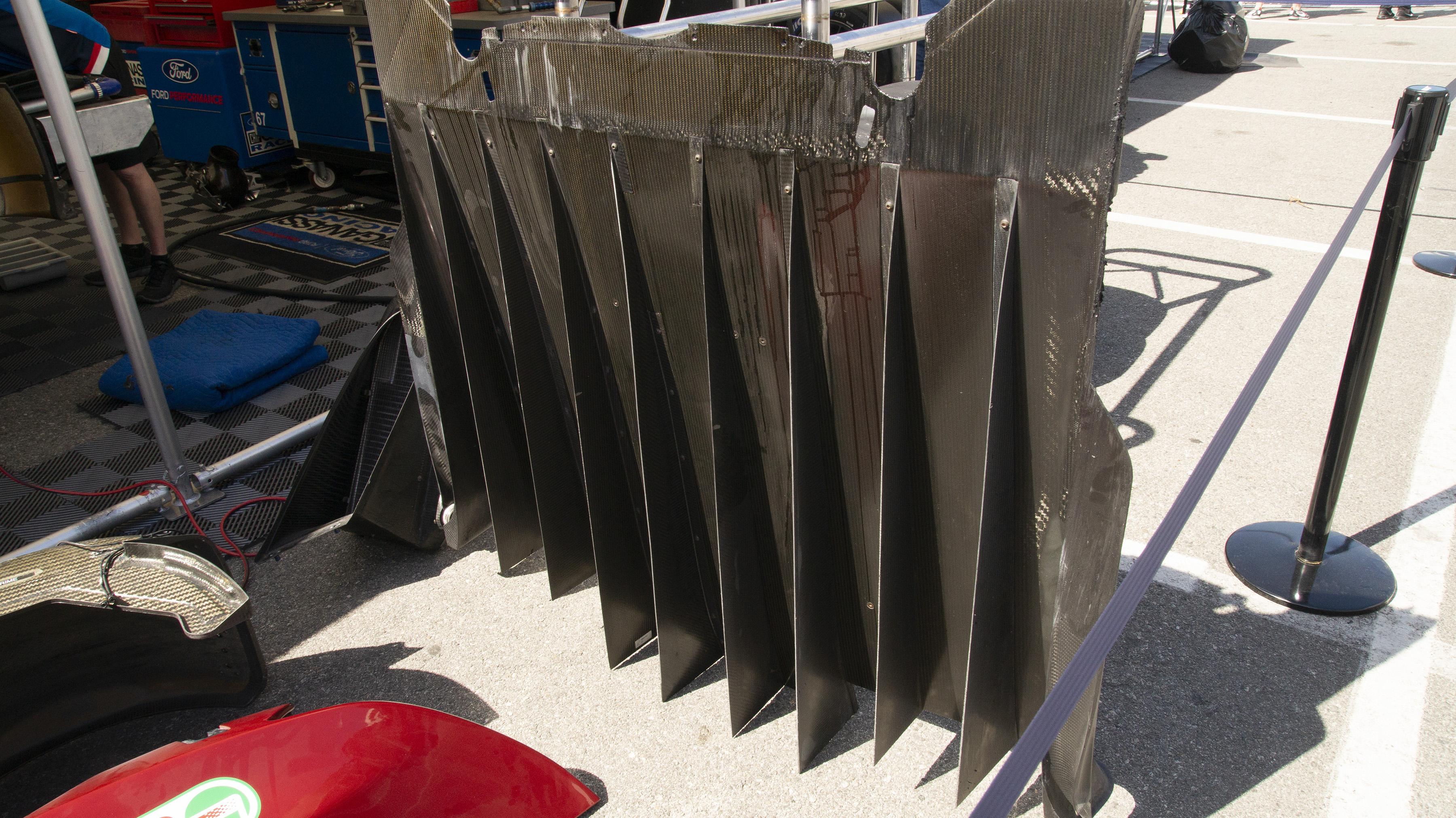

djflyer Posted August 16, 2019 Posted August 16, 2019 (edited) Some of the shots I took at the Roar in 2018 do look more of a matte finish, but it certainly looks like they shined it up a bit for the race. I picked a few of the chassis shots for anyone that's interested. Edited August 16, 2019 by djflyer
