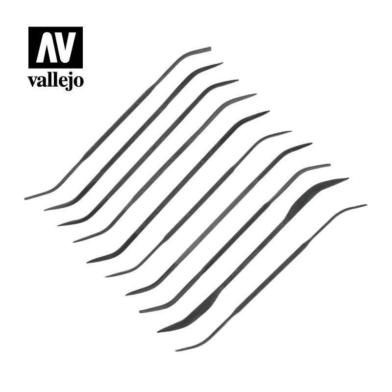

NOBLNG Posted October 6, 2019 Posted October 6, 2019 (edited) I picked up a set of these curved files to go along with my straight ones. They are quite aggressive and work well for rough shaping and contouring. Plus you can get into places where straight files can't. Edited October 6, 2019 by NOBLNG
