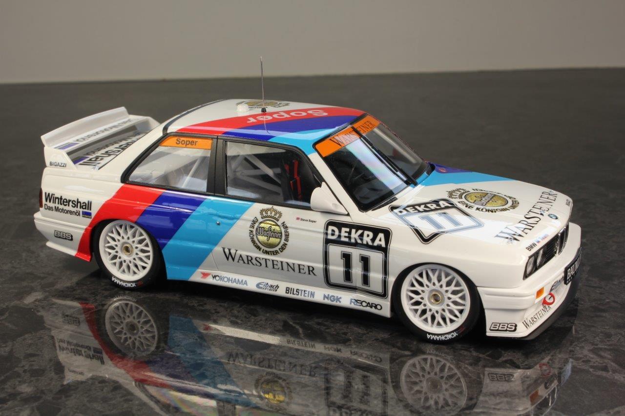

I get my sand paper from the local auto parts store. I also got my meguires polish there ( 105 and 205). As for the flat black, do you plan to clear over it? Or have you cleared already, and then applied the black ?
this is what I get with the process I mentioned

Nice finish and foil job on that car Tom , looks great , well done .
