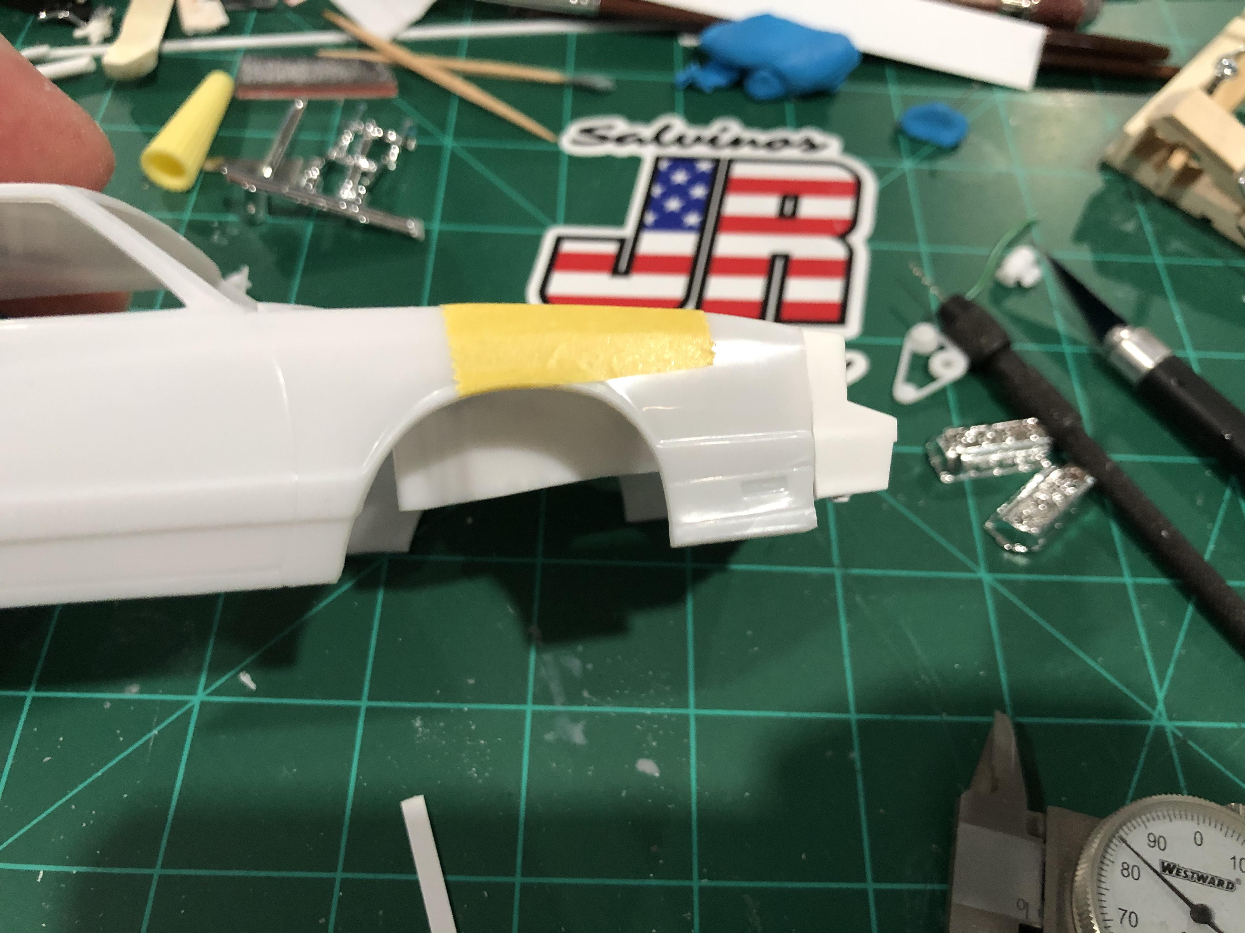

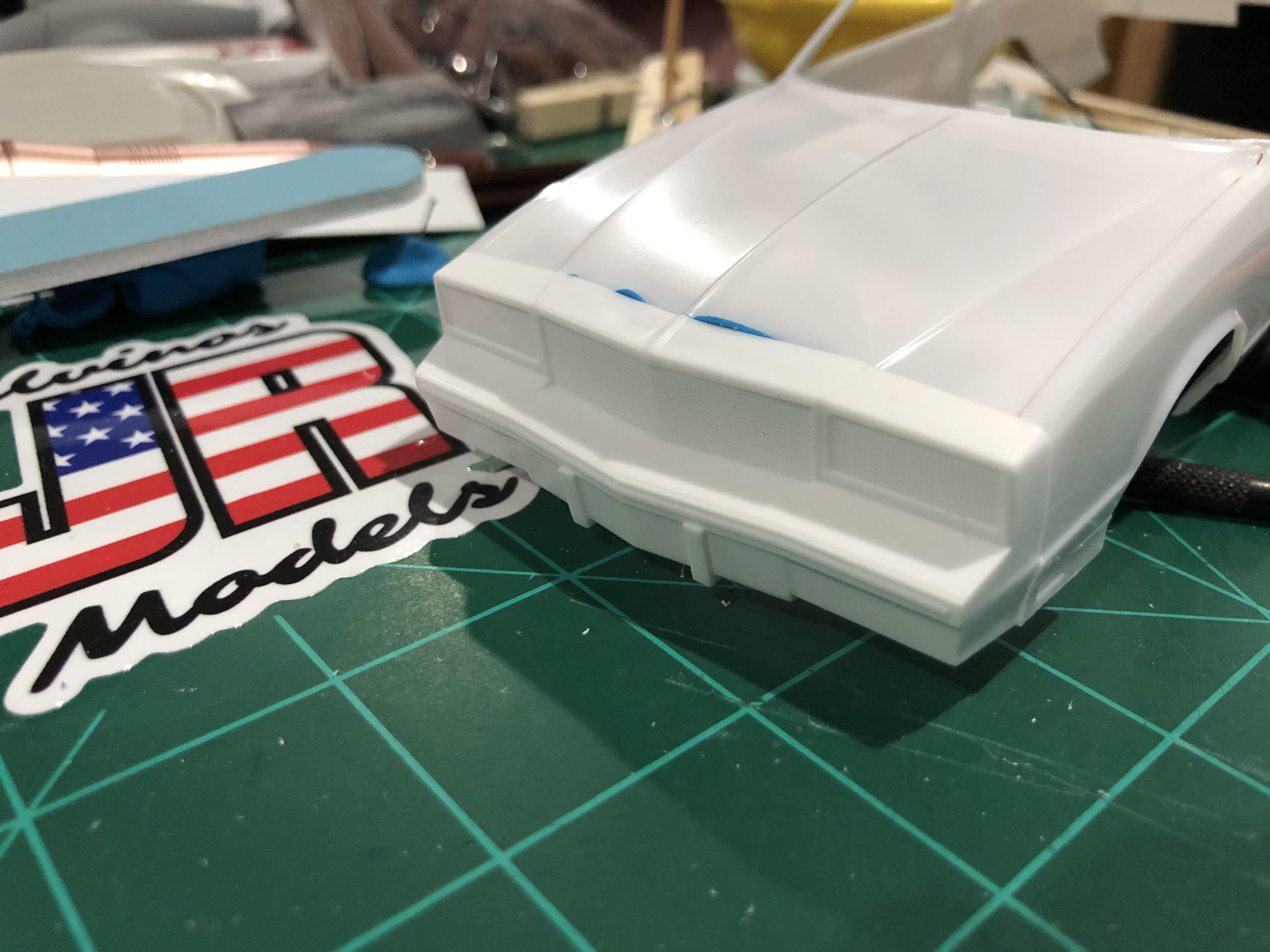

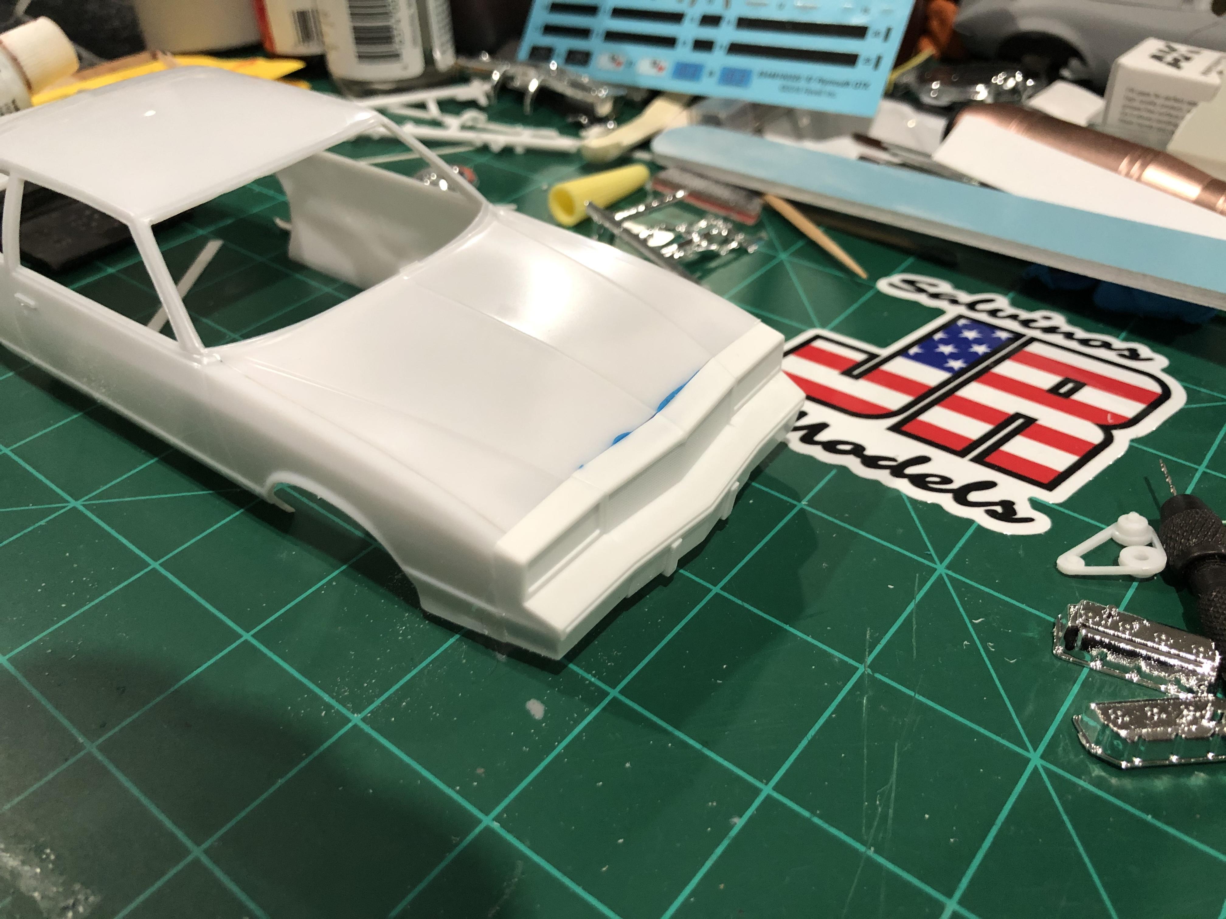

Recently, Salvinos J R Tooled up an LS nose for the NASCAR Monte Carlo kits. Since Stock Cars in the 80s hadn’t gotten completely away from their production counterparts yet, I thought I would test fit this nose on the most recent release of the Monte Carlo SS.

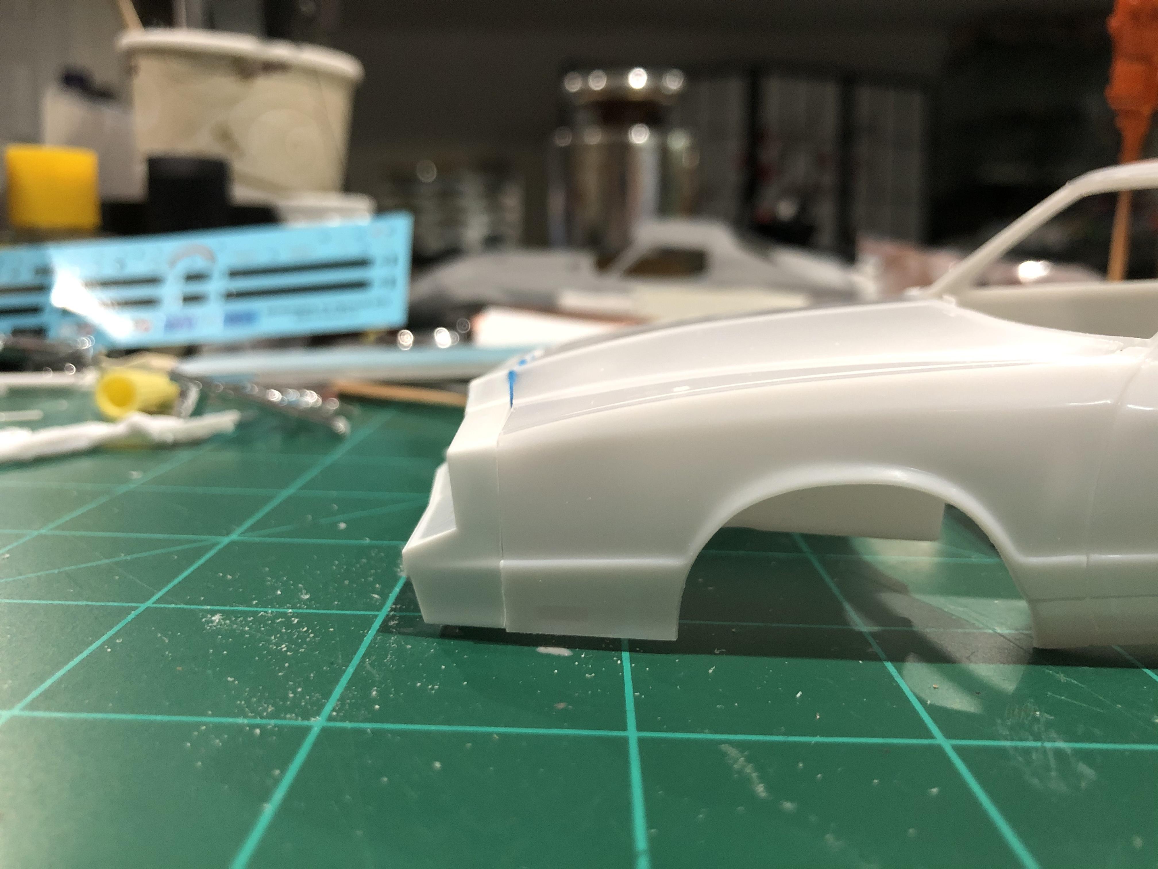

Mounting it directly to the front fenders resulted in a nose pointing up. So I pulled the top away from the hood until the lower body line leveled out.

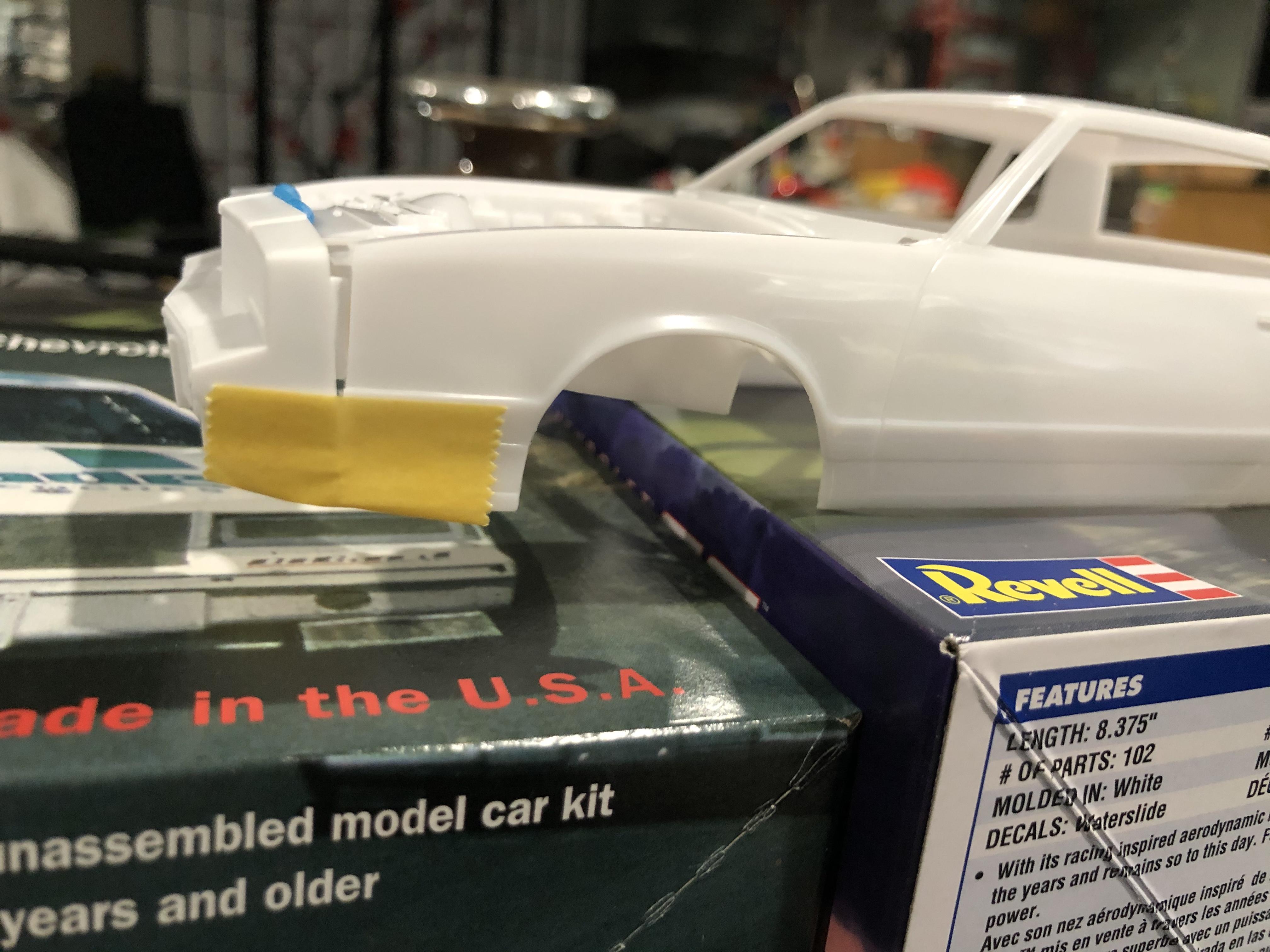

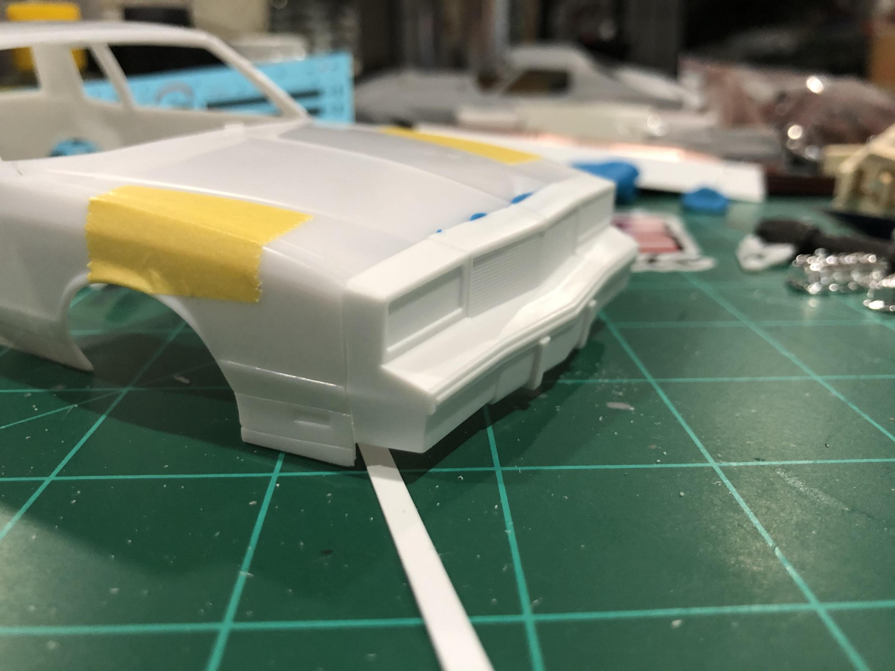

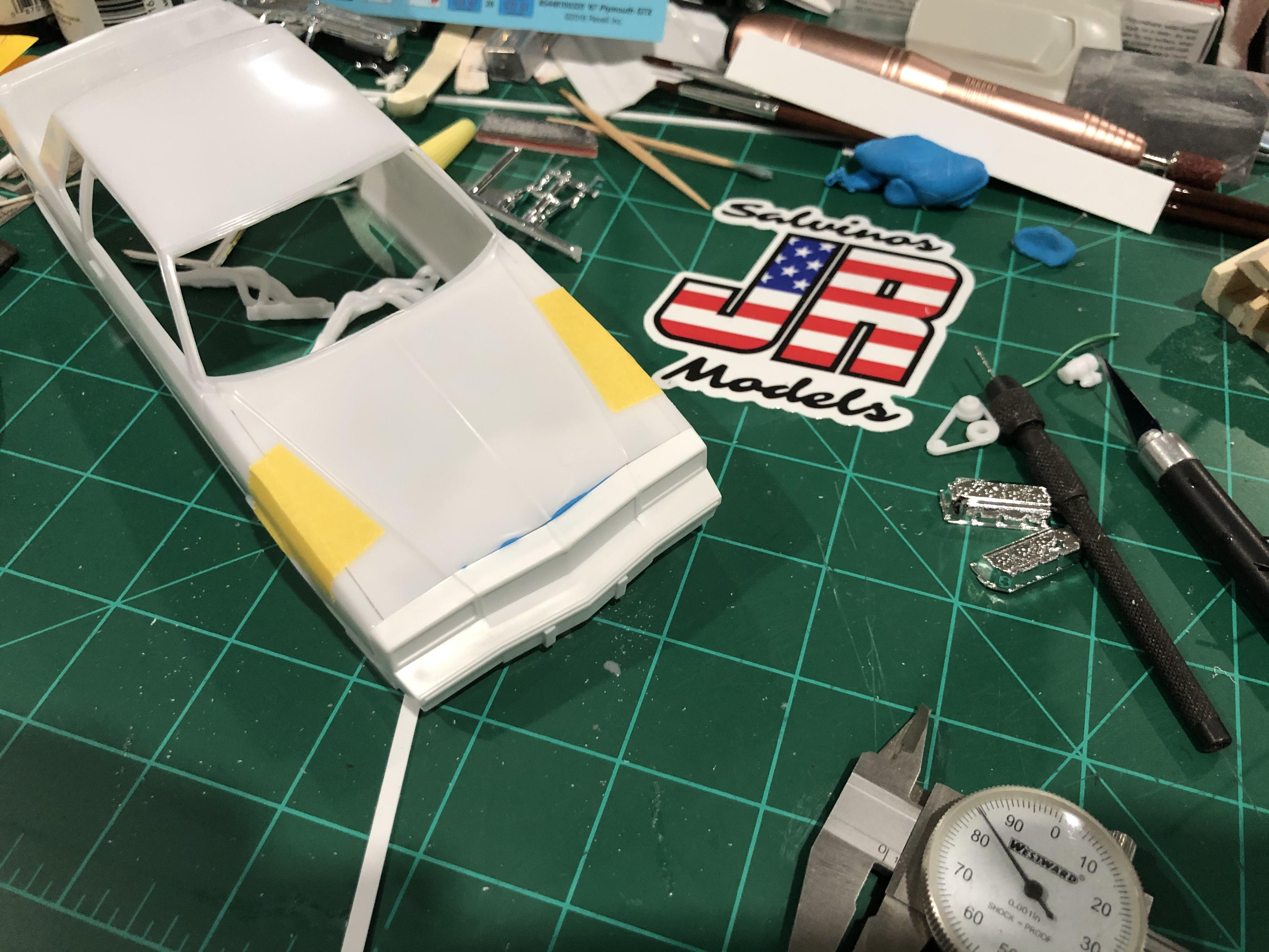

I measured the gap at the top and transferred that measurement to the bottom. I placed a piece of tape from the measurement to the top corner and cut out a pie slice from each side.

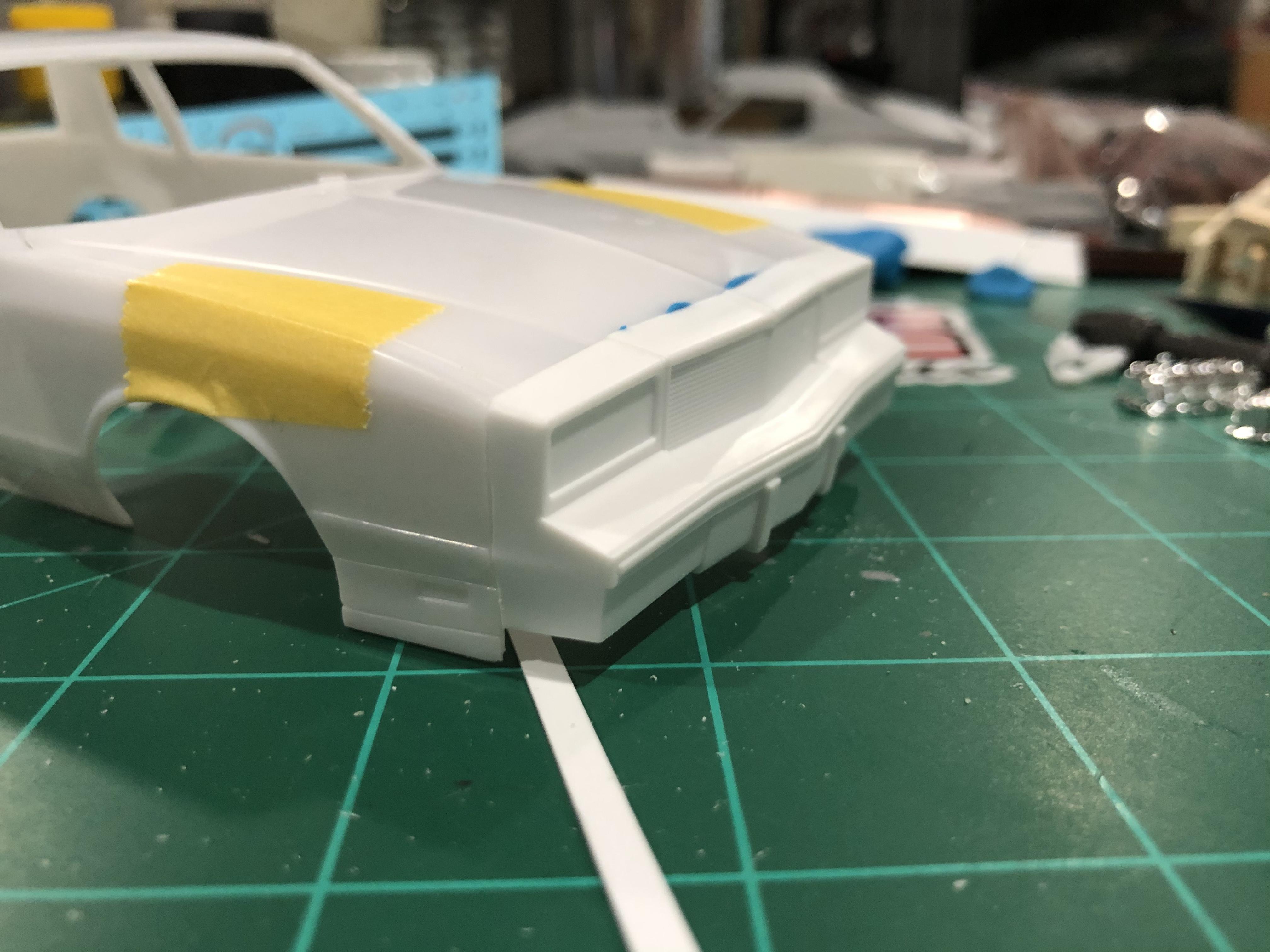

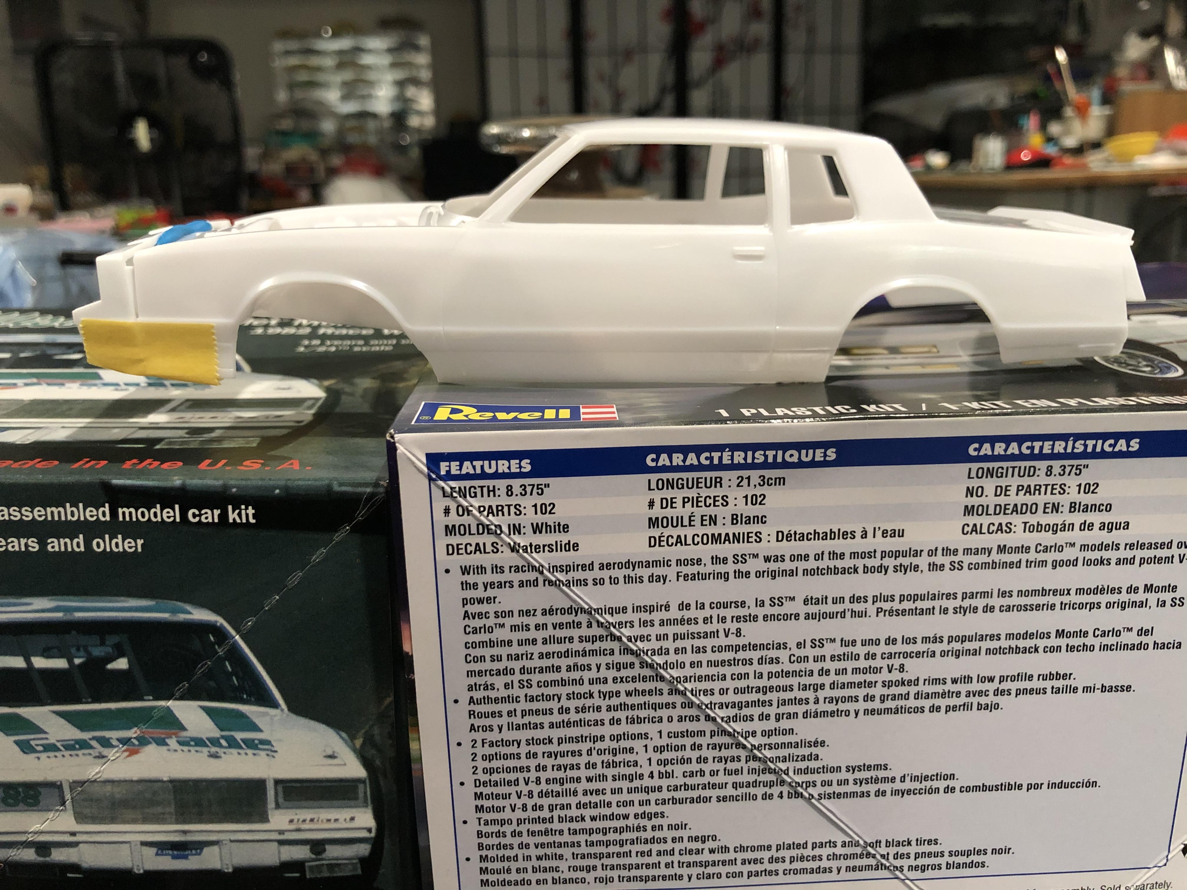

That pulled the whole nose into the fenders. The result matched what I found in the dealership brochure.
I think this is going to work pretty well. I will have to scratch build a grill and headlights right now.
