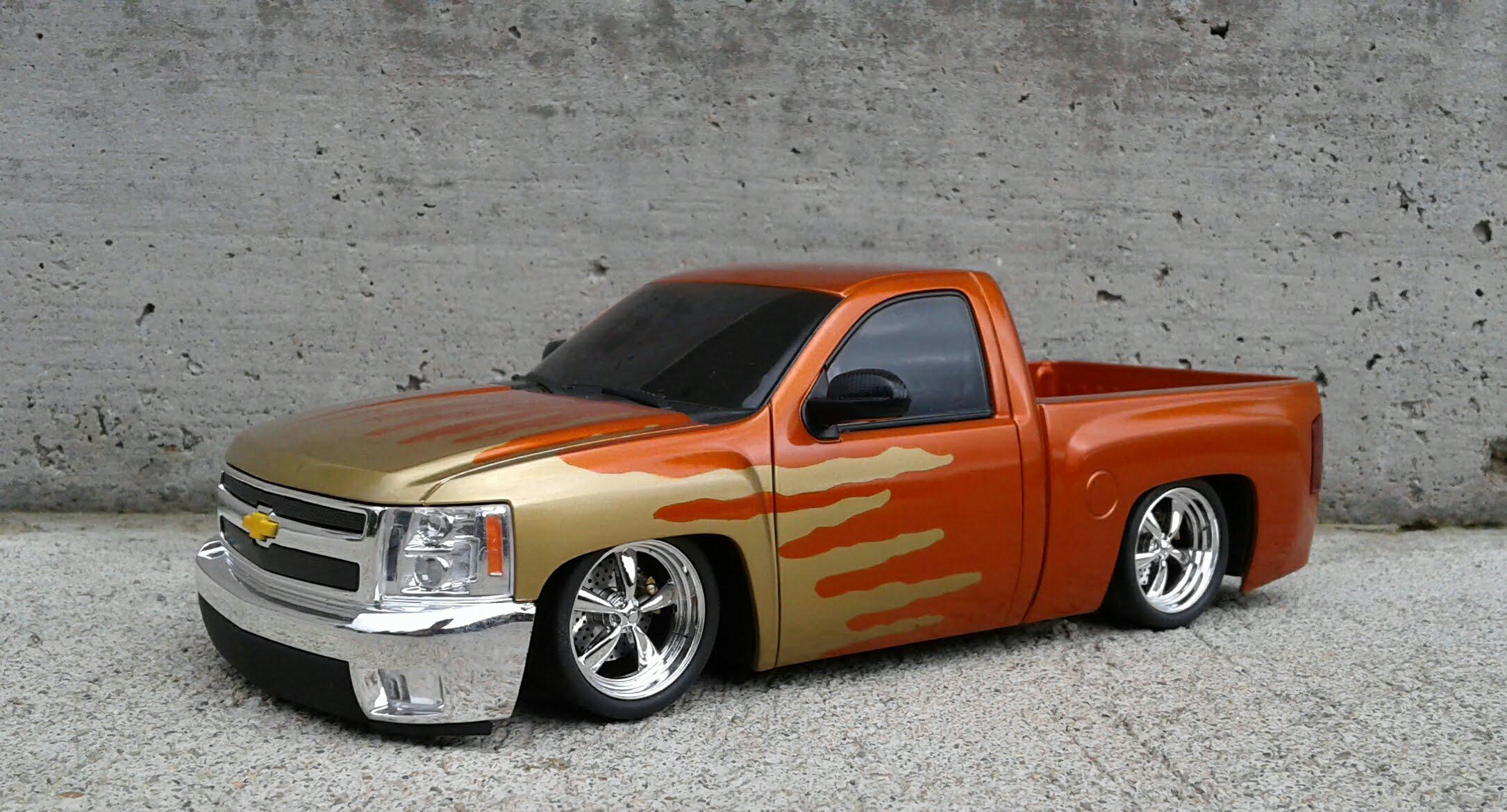

On 11/18/2021 at 12:18 AM, Plowboy said:
The blue painters tape can work. But, it has to have a cut edge and be burnished well. The scallops on this '37 were masked with a single piece of 2".
This Silverado was also done with 2" blue painters tape.
But, Tamiya tape is still better for more simple masking. When you buy it, spend the extra and get the dispenser. No ruined edges or lint stuck to it. Just pull it out and use it.
My man those are some SWEETTTTTTTTTTTTT! rides.
