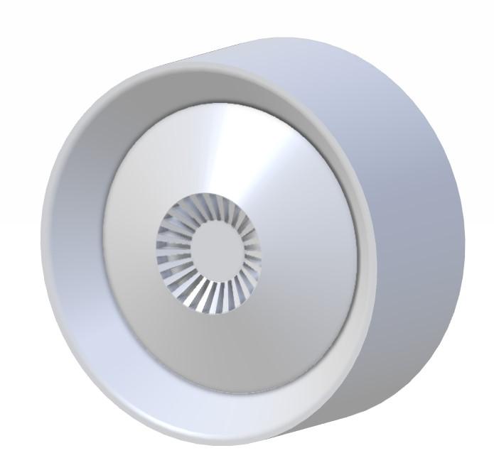

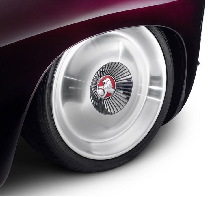

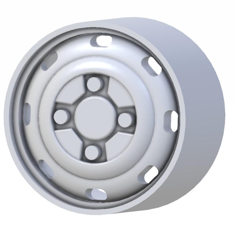

Repstock Posted September 24, 2022 Share Posted September 24, 2022 On 2/4/2022 at 7:42 PM, MeatMan said: Just did these for a member. It was a nice little project. Designed in Alibre CAD and printed on an Anycubic Photon Zero. Still learning to use both. I like to use Blender for file cleanup and repair. It has so many features it kind of intimidates me though. I find it easy to make a cross section of say, a wheel cover, and use Revolve Boss to make it whole. I can't seem to do anything with the drawing after this, like adding holes and such. Any thoughts? Quote Link to comment Share on other sites More sharing options...

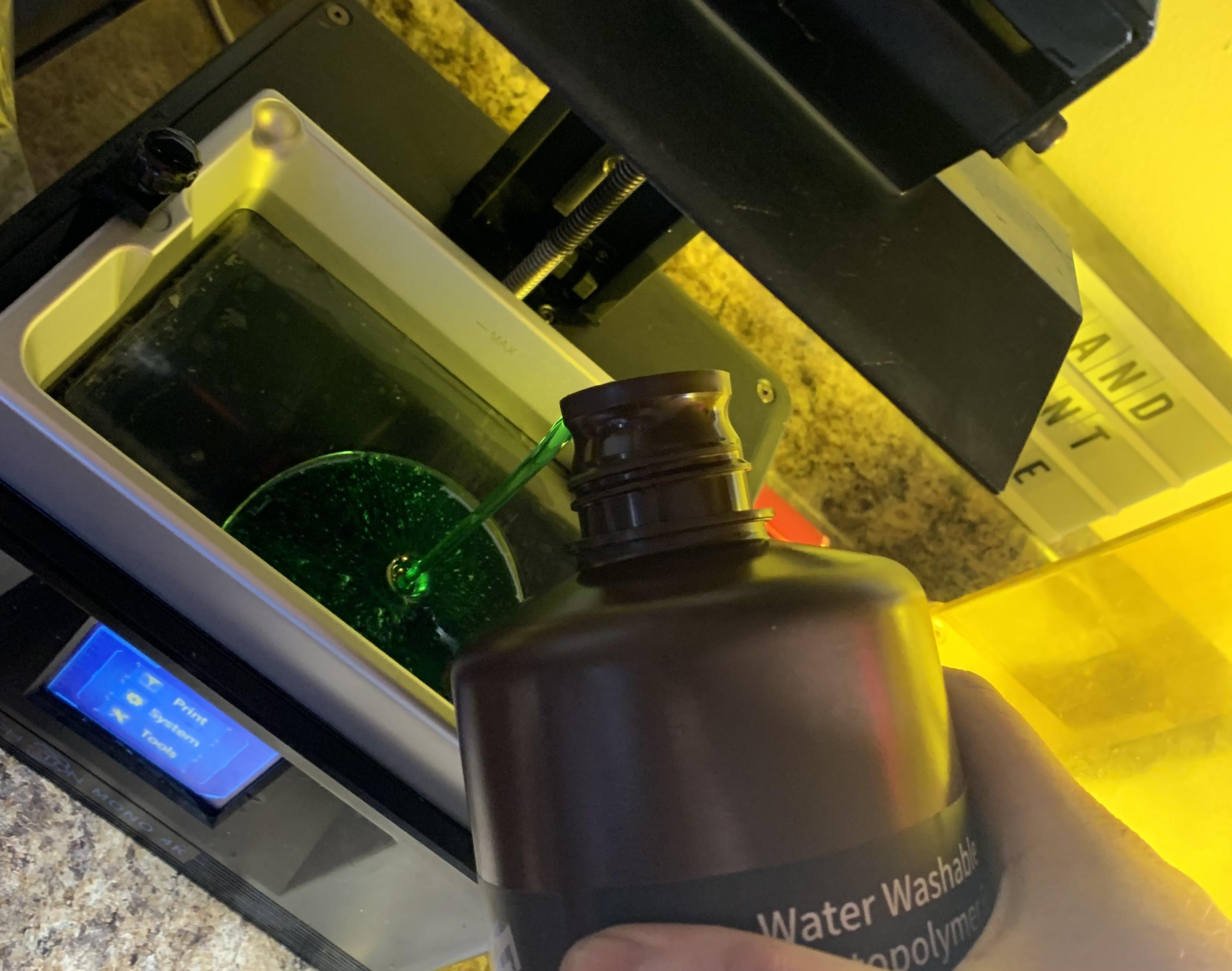

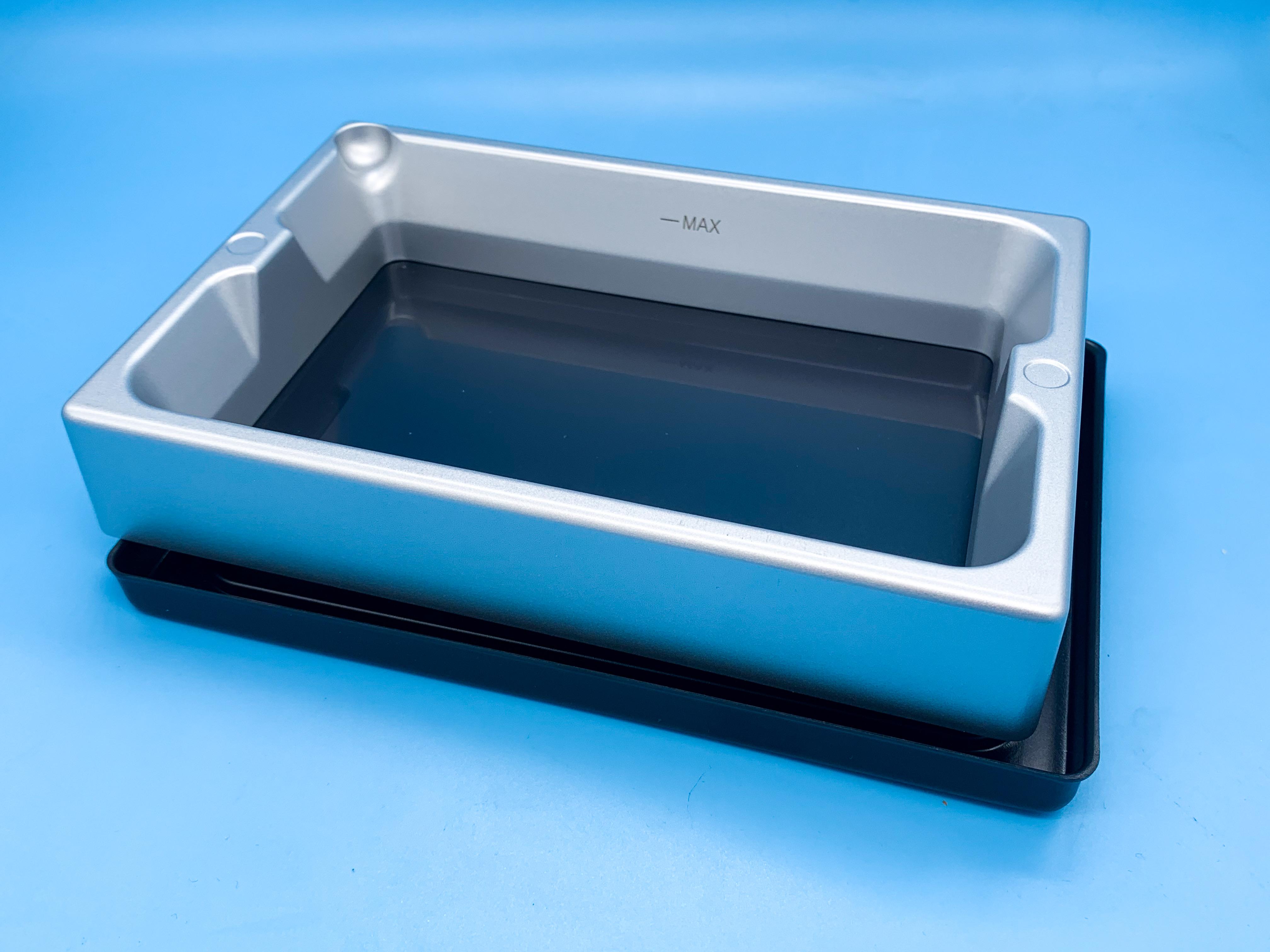

CabDriver Posted September 24, 2022 Share Posted September 24, 2022 On 9/22/2022 at 6:43 PM, stitchdup said: Does a bigger printer need a bigger wash station? I actually hadn’t considered that you’d need a bigger wash station for a bigger printer - I bet someone makes one! Of course, if you’re printing a couple of smaller things, it’s no biggie to just wash them separately. My normal wash cycle is 6 minutes, and another six for curing, so it’s not a BUNCH of extra time to do two rounds if needed… I picked up some extra vats for my Photon today - the original one had a tiny hole that I spotted in the FEP - it hasn’t caused any damage to the machine luckily, but it time for a change. Got a couple of these for $40 delivered from Amazon - pleased with the quality and they’ve got a nice sturdy metal frame: I also wanted to switch over to a water-washable resin, so I picked up some of the pretty green Elgoo to try: Looks like Halloween! Did a quickie test print on a low res setting to make sure the new vat was going to work ok, and see how the new resin prints…need to tweak my settings because the first few layers separated - guess they need more time on the first layers to help the parts hold together. Was pleased with the first attempt with this new stuff tho! 1 Quote Link to comment Share on other sites More sharing options...

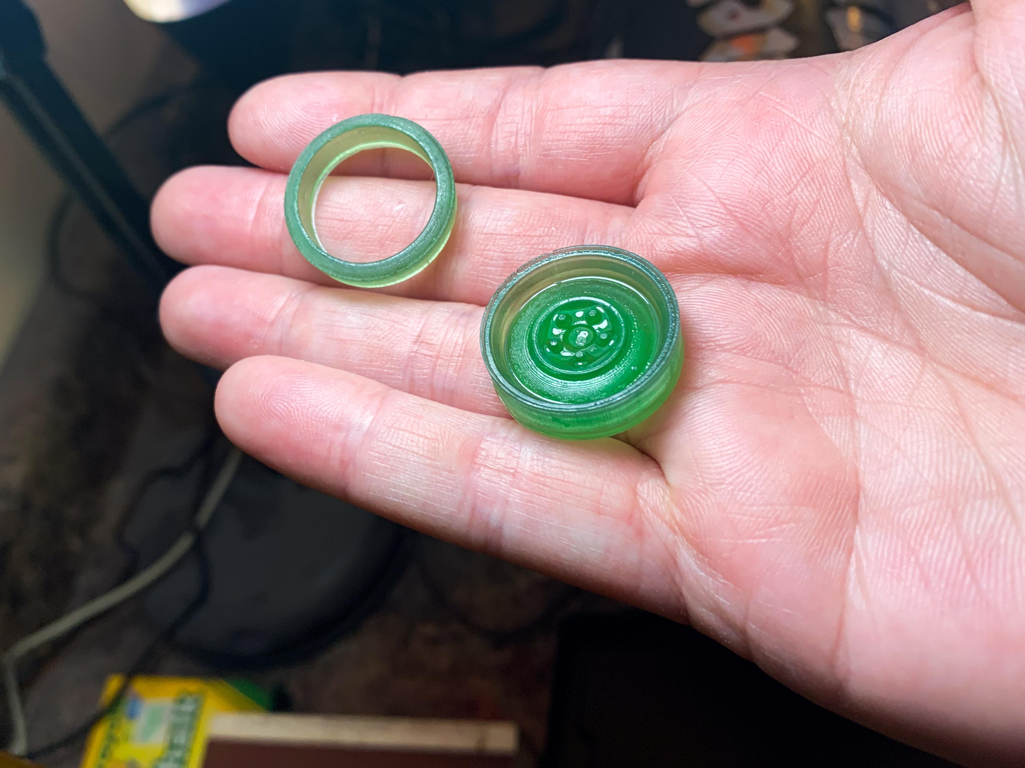

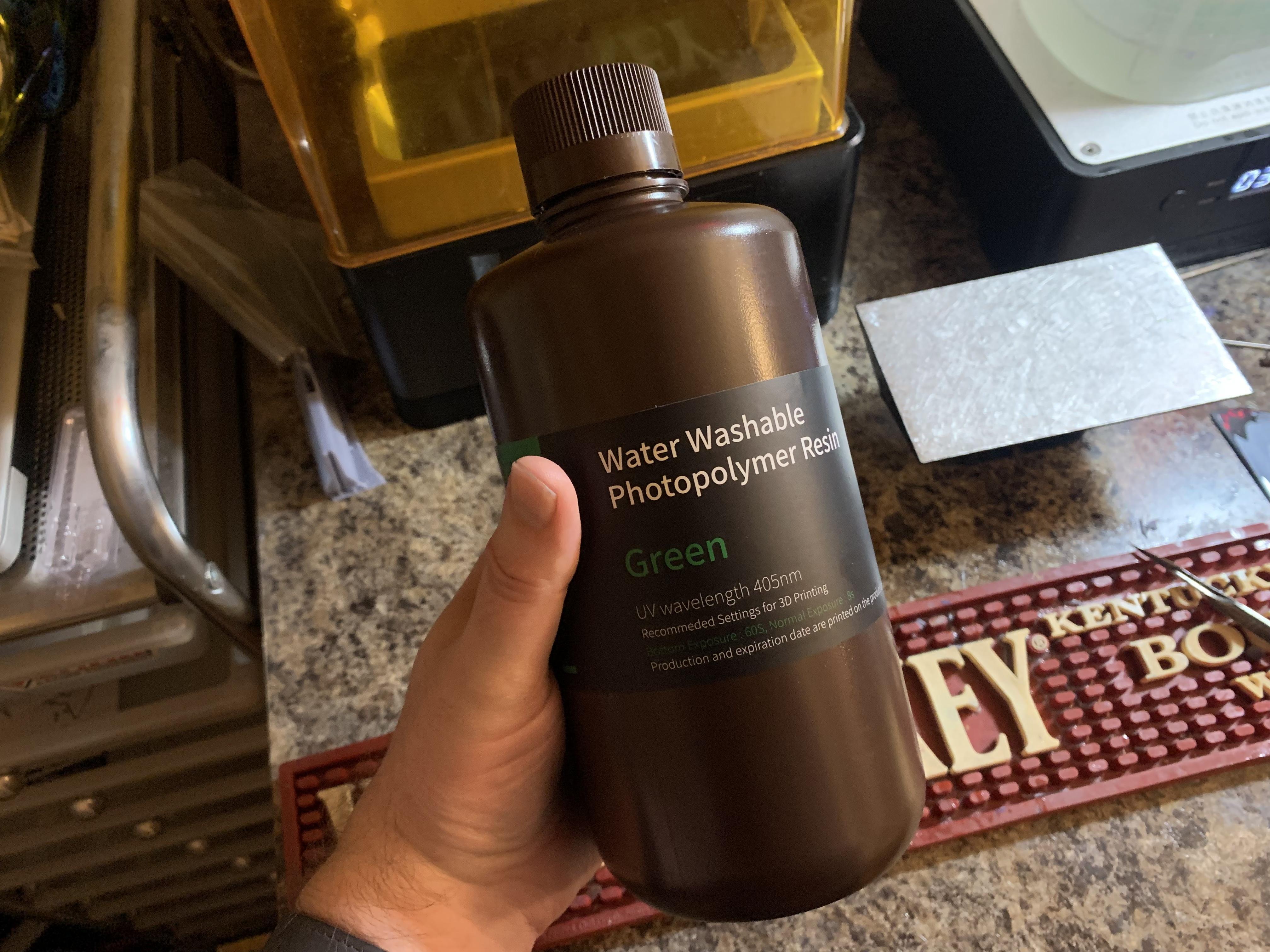

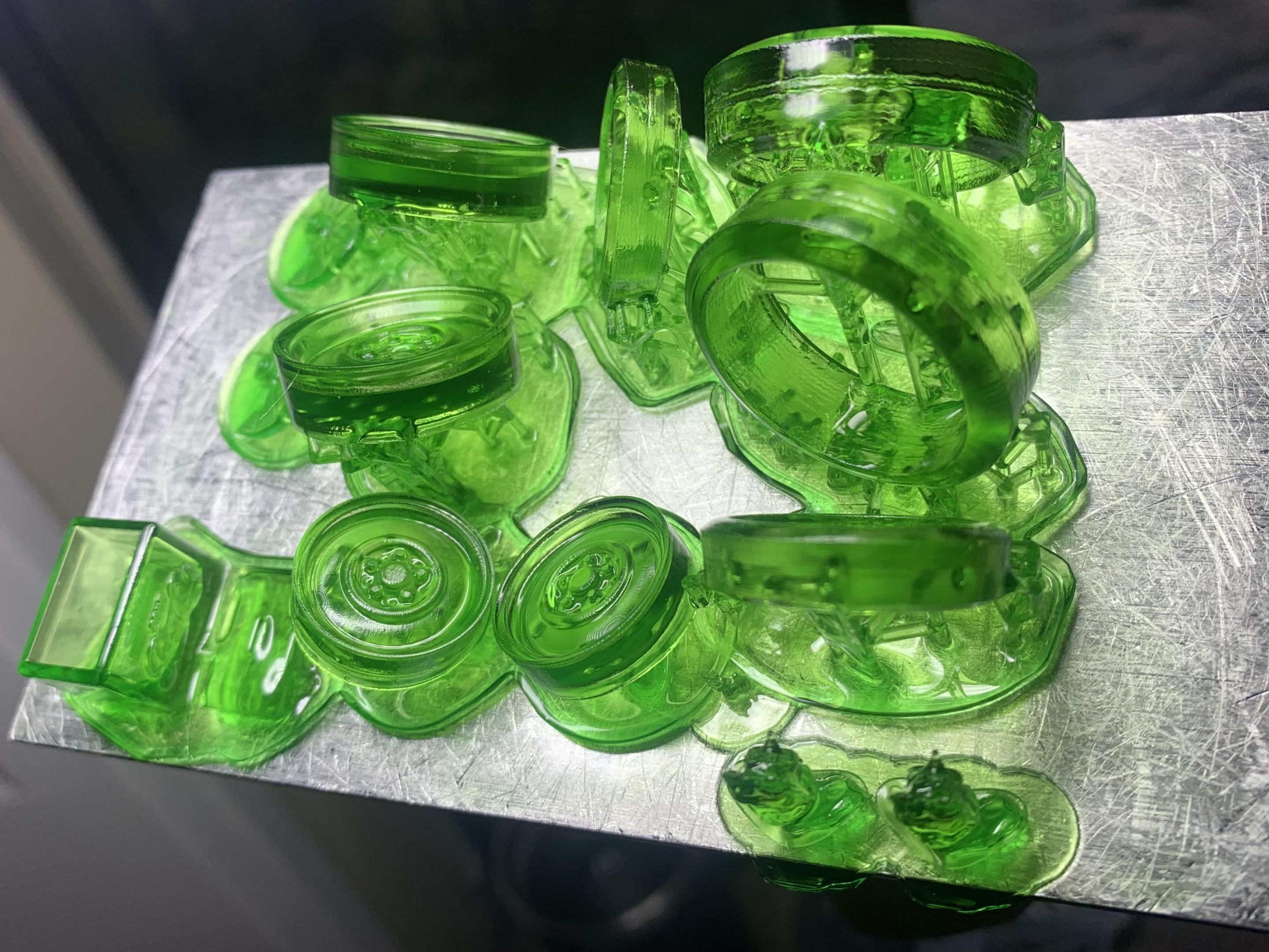

stitchdup Posted September 24, 2022 Share Posted September 24, 2022 17 hours ago, CabDriver said: I actually hadn’t considered that you’d need a bigger wash station for a bigger printer - I bet someone makes one! Of course, if you’re printing a couple of smaller things, it’s no biggie to just wash them separately. My normal wash cycle is 6 minutes, and another six for curing, so it’s not a BUNCH of extra time to do two rounds if needed… I picked up some extra vats for my Photon today - the original one had a tiny hole that I spotted in the FEP - it hasn’t caused any damage to the machine luckily, but it time for a change. Got a couple of these for $40 delivered from Amazon - pleased with the quality and they’ve got a nice sturdy metal frame: I also wanted to switch over to a water-washable resin, so I picked up some of the pretty green Elgoo to try: Looks like Halloween! Did a quickie test print on a low res setting to make sure the new vat was going to work ok, and see how the new resin prints…need to tweak my settings because the first few layers separated - guess they need more time on the first layers to help the parts hold together. Was pleased with the first attempt with this new stuff tho! looking at those parts brings up another question. is clear resin available and is it any good? the inside of the rim on those wheels makes me think printing lights might be possible Quote Link to comment Share on other sites More sharing options...
CabDriver Posted September 25, 2022 Share Posted September 25, 2022 5 hours ago, stitchdup said: looking at those parts brings up another question. is clear resin available and is it any good? the inside of the rim on those wheels makes me think printing lights might be possible I’m just starting to play with it myself, but taillights printed with red translucent resin would undoubtably work. The clear stuff looks like it wouldn’t probably be QUITE transparent enough, you’d think - but I saw a guy on YouTube polish some clear printed headlight lenses with a Dremel and a polishing bit and they actually looked pretty good! I don’t think printing a usable windshield or glass would be feasible, but theres definitely some stuff you could do! I’ll try and find the video if I can remember where I saw it… Meanwhile in printing adventures today, I got some decent prints with the clear green stuff - and I LOVE how easy it is to clean them up after printing! 2 Quote Link to comment Share on other sites More sharing options...
1930fordpickup Posted September 25, 2022 Share Posted September 25, 2022 The green is cool. It would make some interesting rims because of the color. Quote Link to comment Share on other sites More sharing options...
MeatMan Posted September 25, 2022 Share Posted September 25, 2022 9 hours ago, CabDriver said: I’m just starting to play with it myself, but taillights printed with red translucent resin would undoubtably work. The clear stuff looks like it wouldn’t probably be QUITE transparent enough, you’d think - but I saw a guy on YouTube polish some clear printed headlight lenses with a Dremel and a polishing bit and they actually looked pretty good! I don’t think printing a usable windshield or glass would be feasible, but theres definitely some stuff you could do! I’ll try and find the video if I can remember where I saw it… Meanwhile in printing adventures today, I got some decent prints with the clear green stuff - and I LOVE how easy it is to clean them up after printing! I bought the same green resin a few months ago and like it for certain prints. You've got some really nice stuff though that I wouldn't have thought of doing in translucent. Quote Link to comment Share on other sites More sharing options...

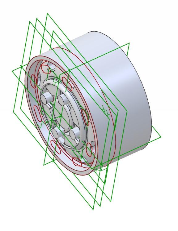

MeatMan Posted September 25, 2022 Share Posted September 25, 2022 (edited) On 9/23/2022 at 11:13 PM, Repstock said: I find it easy to make a cross section of say, a wheel cover, and use Revolve Boss to make it whole. I can't seem to do anything with the drawing after this, like adding holes and such. Any thoughts? Hey Tom, I've never tried it that way but have seen vids on it. I'll have to try it because I'm trying to replicate some for the Effijy I had printed and can't quite get some details to work. Below is a pic of some wheels I created for my CBR Karmann-Ghia, the Effigy wheels I created, and a pic of what I was trying to duplicate. Have you tried creating planes and extruding the feature onto the face like in the last pic of my KG wheel? Edited September 25, 2022 by MeatMan Quote Link to comment Share on other sites More sharing options...

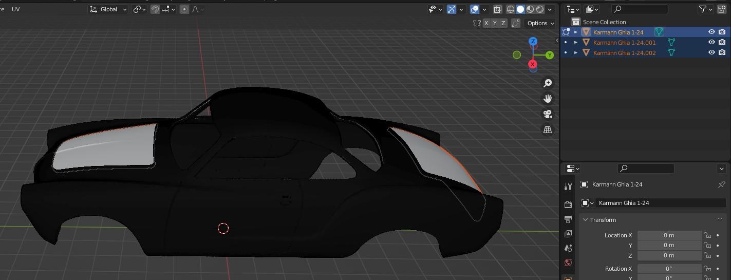

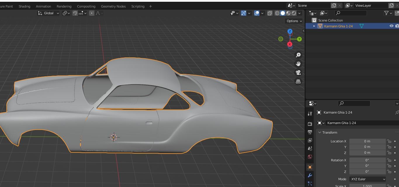

MeatMan Posted September 28, 2022 Share Posted September 28, 2022 (edited) On 9/27/2022 at 6:13 AM, MrObsessive said: The first one is printable, but to be honest, it looks like it's meant more for a FDM printer (filament), than a SLA printer which is the vat type. The second one is a .obj file and could be made printable, but not without a lot of work to get the proper wall thickness. The third one while printable, I wouldn't trust it as looking at the rockers and wheel wells, is just too thin for me. It'll print, but then you might have a tough time getting it off the supports with the risk of the resin "tearing". The last one also looks like it's meant for a FDM printer also. The topology on that one is reeeeeaaal rough. You'd have to do an awful lot of editing in Blender to straighten that one out, and if it's too much for Blender to handle, the program can crash without warning. Models that are solid like that can be edited to be hollow, but get set for a great deal of work to get rid of all the faces/vertices on the bottom and inside the body. There's no way really to tell if a file can be separated without first contacting the designer. It'll all depend on how they formatted the file, and how they designed what parts are to be separated where. The printable files can be tough to thicken up if too thin, as they've already been "altered". Yet again another reason I'd rather do my own files from the very beginning (.obj), than to try and fix another file that's already been thickened up in many cases. On Cults, usually if the model is displayed in blue, the file is already printable. The file type should be listed on the side------.STL files mean they are printable, but that can be very subjective from file to file. I've been able to separate parts from a couple of drawings in Blender though without checking with the designer. I was able to print my Karmann-Ghia with the hood & trunk separate. Go into Edit mode, right click on the body, select Separate, Loose Parts. Some drawings will have a long list of parts that require selecting individually to see what gets highlighted. I recently had to remove the middle of a set of wheels to get only the rim and it showed all the rim bolts, spokes, and parts separately but I was able to remove the spokes and get the part I needed. Edited September 28, 2022 by MeatMan 2 Quote Link to comment Share on other sites More sharing options...
MrObsessive Posted September 28, 2022 Share Posted September 28, 2022 2 hours ago, MeatMan said: I've been able to separate parts from a couple of drawings in Blender though without checking with the designer. I was able to print my Karmann-Ghia with the hood & trunk separate. Go into Edit mode, right click on the body, select Separate, Loose Parts. Some drawings will have a long list of parts that require selecting individually to see what gets highlighted. I recently had to remove the middle of a set of wheels to get only the rim and it showed all the rim bolts, spokes, and parts separately but I was able to remove the spokes and get the part I needed. Oh yeah, I've been doing that for quite a while in Blender. The problem comes in however that not all models are designed that way, as I've got a number of them that no matter what you do, Blender will not separate the parts UNLESS you manually copy the faces in edit mode, duplicate the object, save it, then go back and delete the faces and import the object again under a new part name after it's been separated. Many times, this isn't known until AFTER you bought the file and have to find out. The designer if available, should be able to tell you what parts are separated where and how. Quote Link to comment Share on other sites More sharing options...

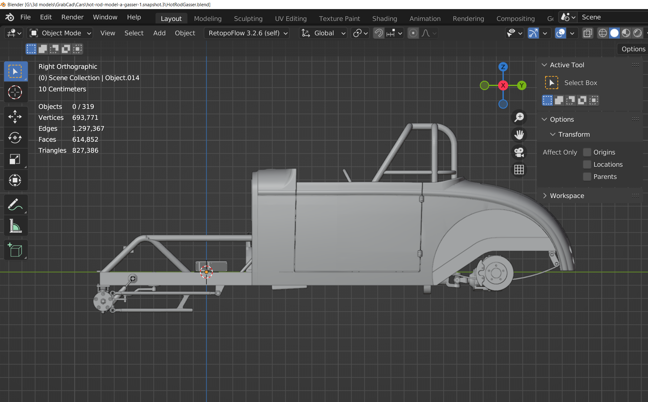

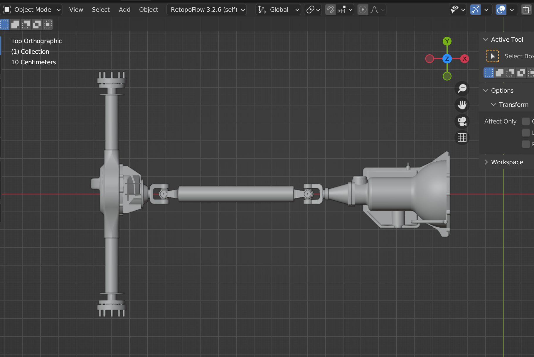

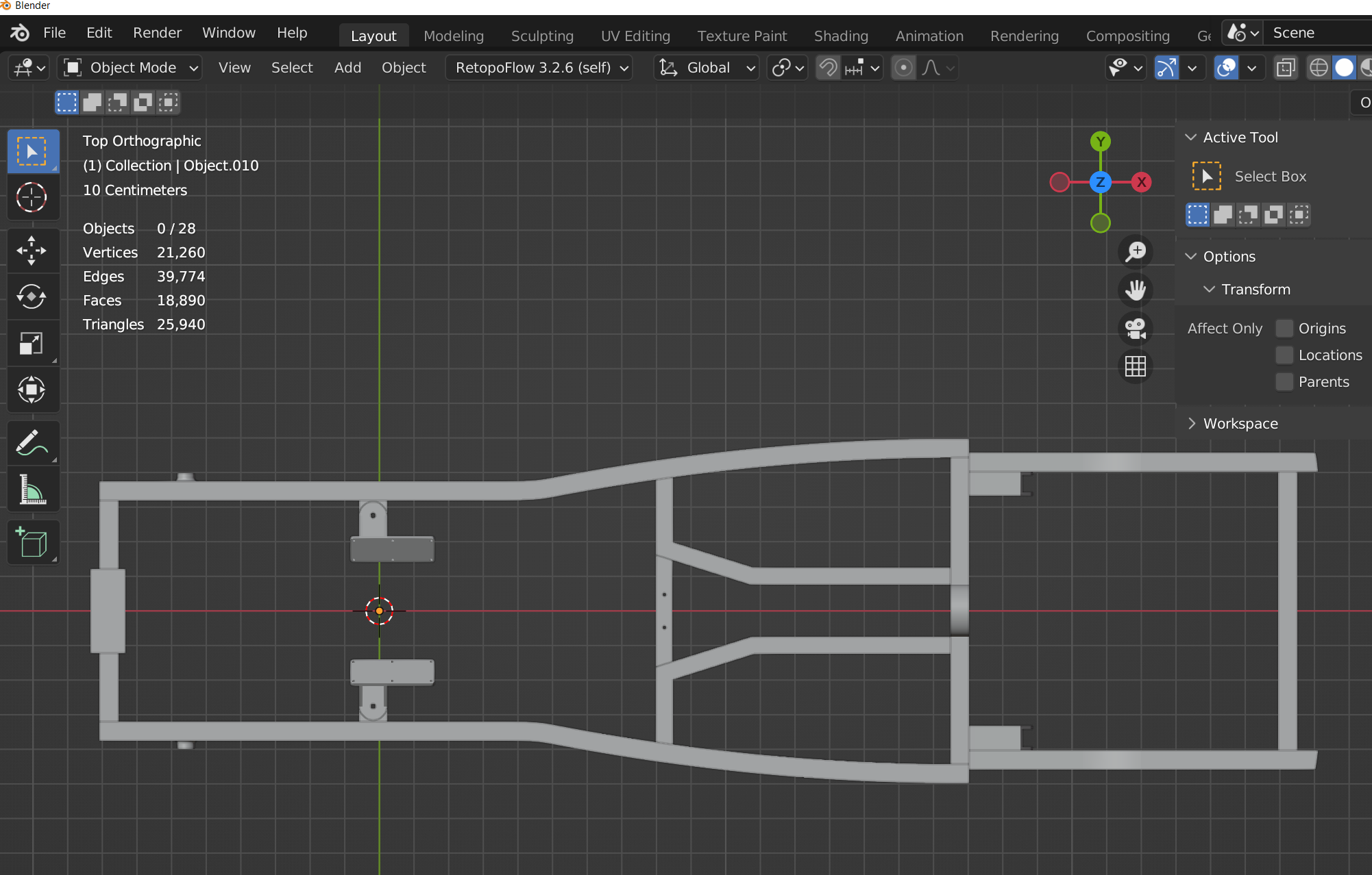

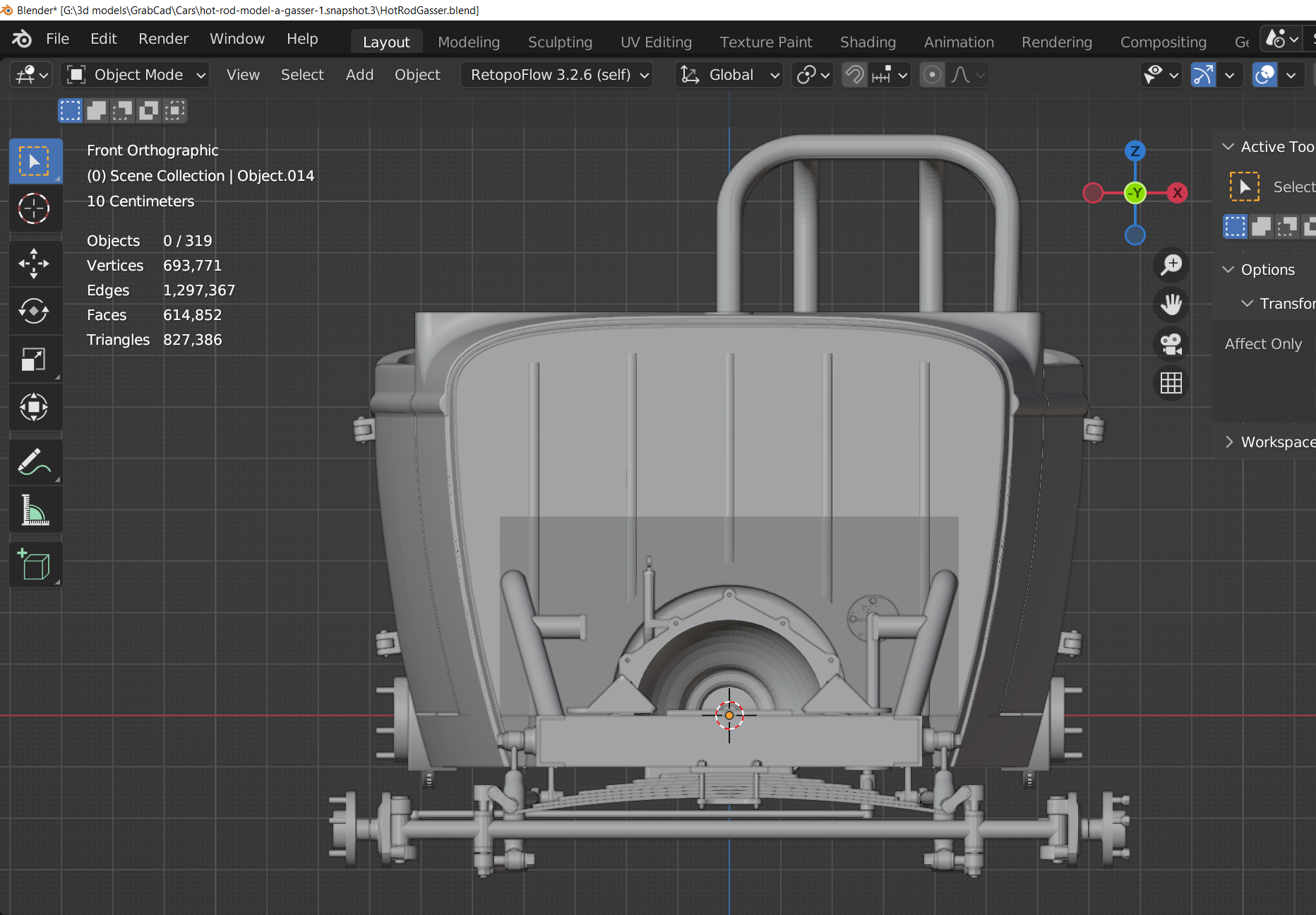

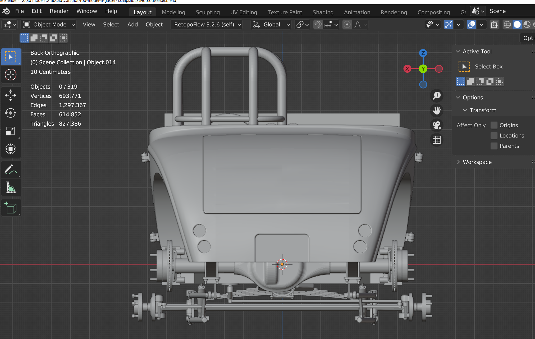

Kenmojr Posted September 28, 2022 Share Posted September 28, 2022 (edited) I found this partially completed model of a hot rod gasser at GrabCad. It is missing some parts like engine, grille, moon tank. https://grabcad.com/library/hot-rod-model-a-gasser-1/details?folder_id=5620843 Edited September 28, 2022 by Kenmojr Add screen captures 1 Quote Link to comment Share on other sites More sharing options...
