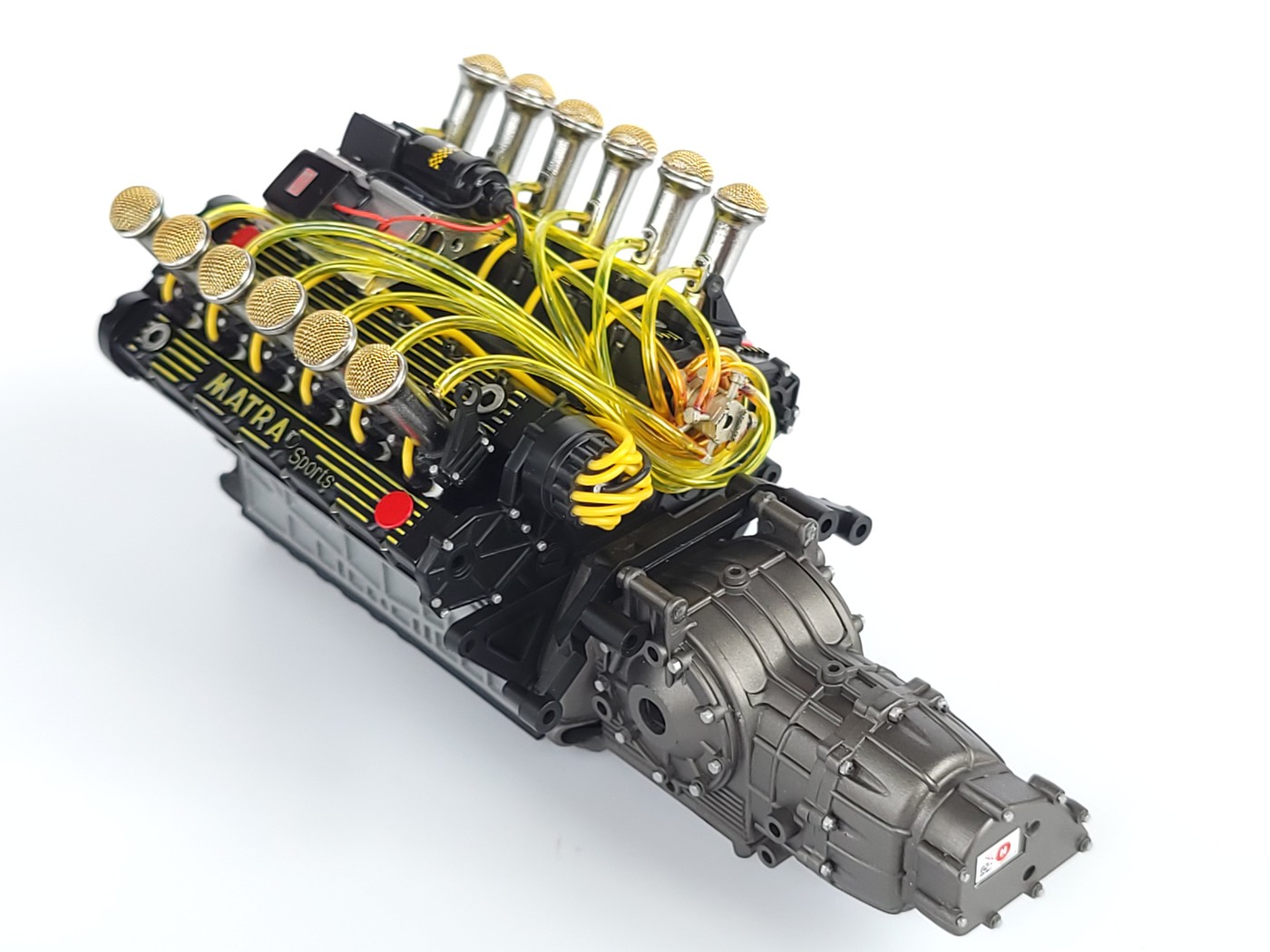

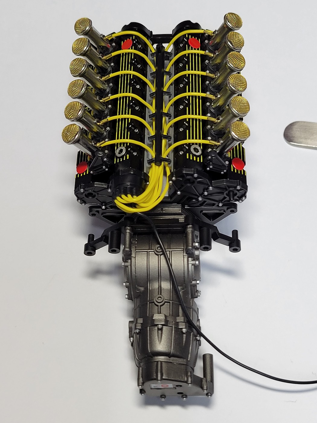

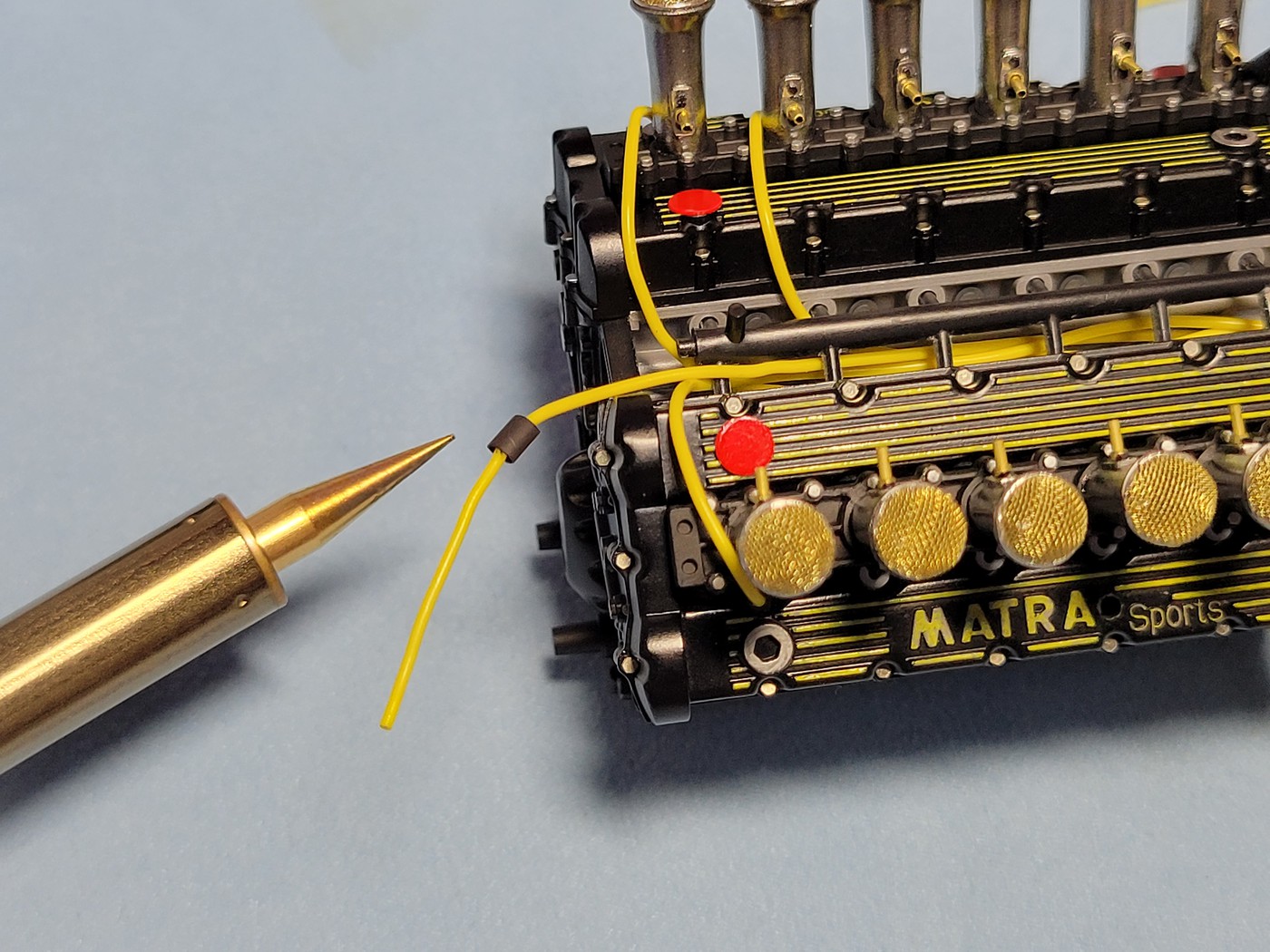

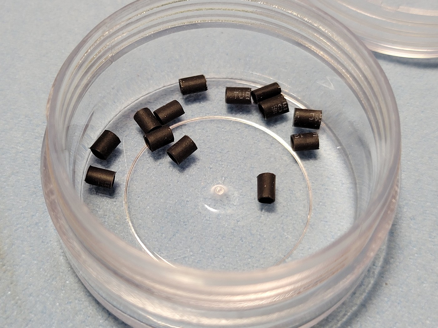

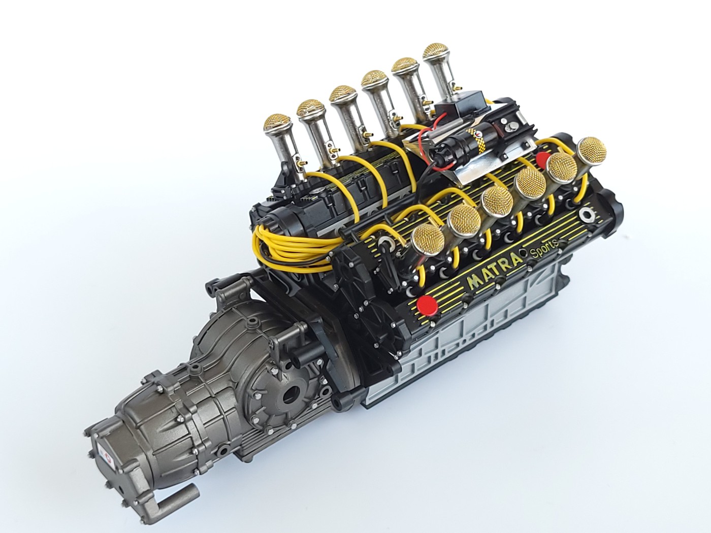

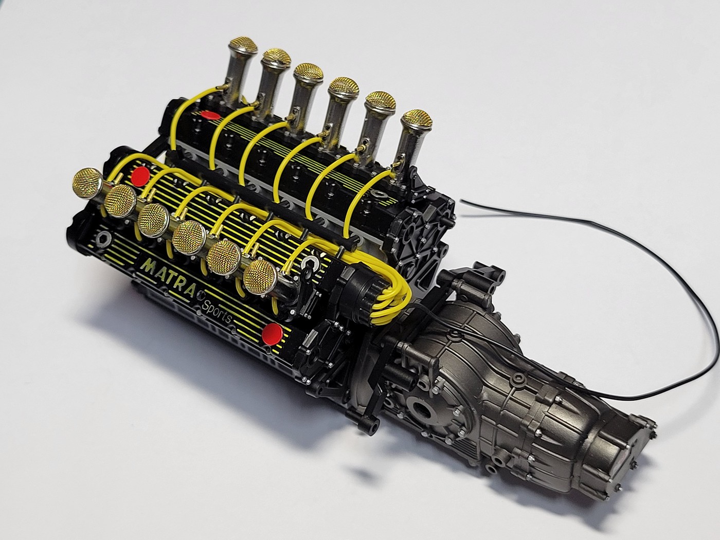

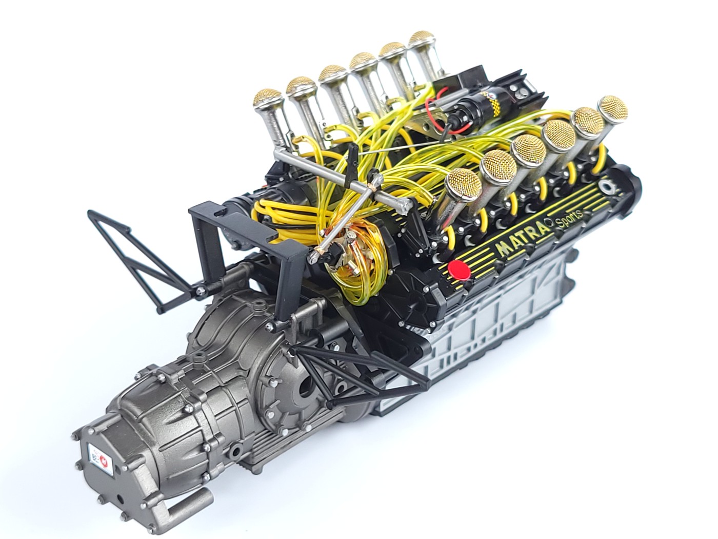

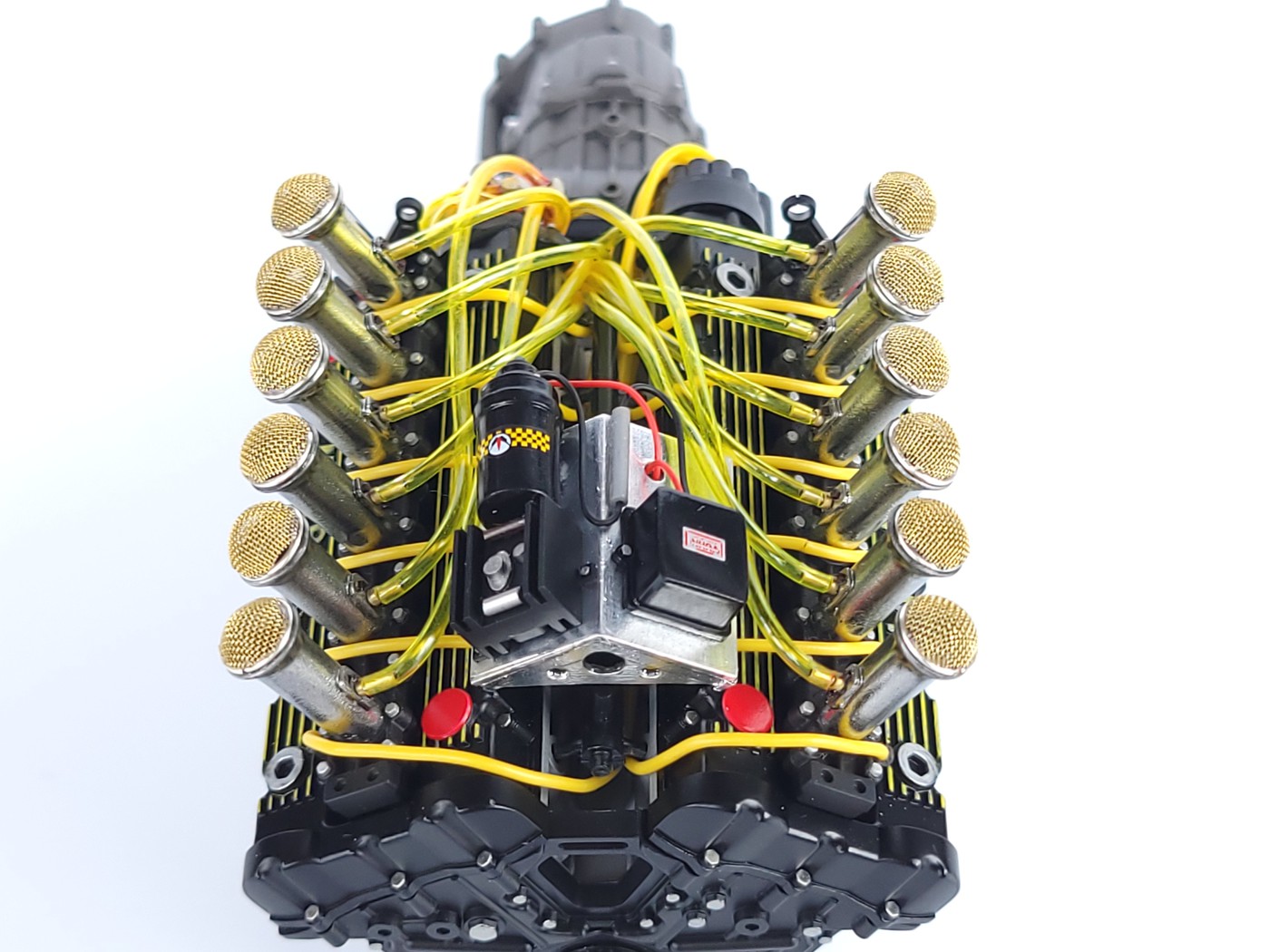

Nacho Z Posted August 1, 2022 Author Posted August 1, 2022 Now that I had the basic drivetrain assembled it was time to start adding some detail. The kit provides red wire for ignition wire but this does not appear to be period correct. Most evidence points to yellow ignition wires. I found a museum display engine with red ignition wires but that was all that I found. I had to source yellow wire as I didn't have any on hand that I liked. I added boots to the ignition wires on the cam cover end of the wire. To make the ignition wire boots I bought a cheap heat shrink kit and used the smallest size in the kit. Each boot is 3mm in length and 1mm ID. I inserted each wire into its respective hole so that the wire was taut. I marked the wire at the hole, removed it and then slid a piece of heat shrink up to the mark. I used a wood burner to heat the heat shrink. This was a very precise way to apply heat. I then reinserted the wire. And the final results. I'm currently working on the fuel lines and the electronics package. The electronics were minimal and basic, a box or two on top of the engine. I have added a few details to the kit provided items. I hope to share that with you next week. As allways, let me know what you think. All comments, questions, suggestions, and critiques are welcome. 1
OldNYJim Posted August 2, 2022 Posted August 2, 2022 That engine turned out GREAT! Love the super-neat wiring job you did!
Pierre Rivard Posted August 2, 2022 Posted August 2, 2022 A beautiful beast, can't wait to see it with the rest of the detailing.
Nacho Z Posted August 3, 2022 Author Posted August 3, 2022 On 8/1/2022 at 11:16 PM, CabDriver said: That engine turned out GREAT! Love the super-neat wiring job you did! Thanks, Jim! I appreciate it. On 8/2/2022 at 7:35 AM, Pierre Rivard said: A beautiful beast, can't wait to see it with the rest of the detailing. Thank you, Pierre, I’ll be posting another little update soon. These 1:12 kits lend themselves to some extra detail.

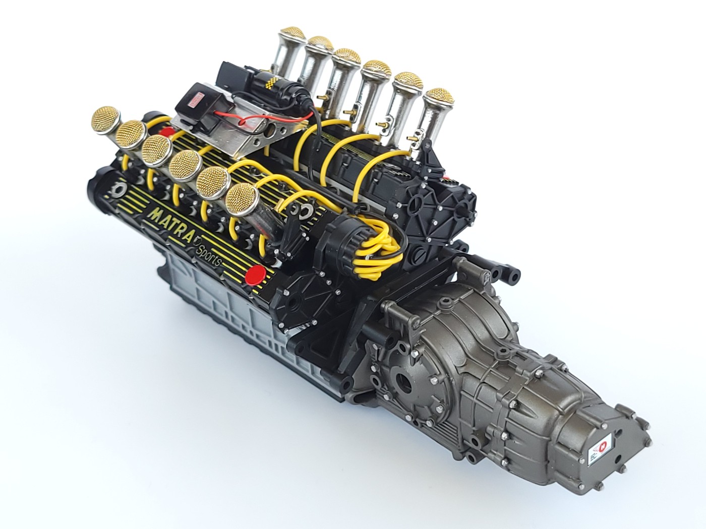

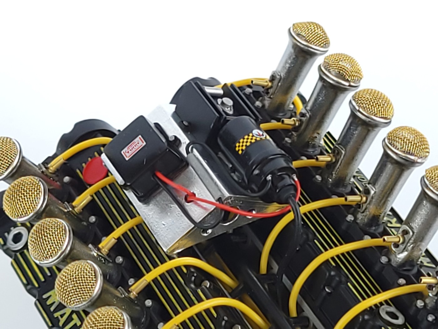

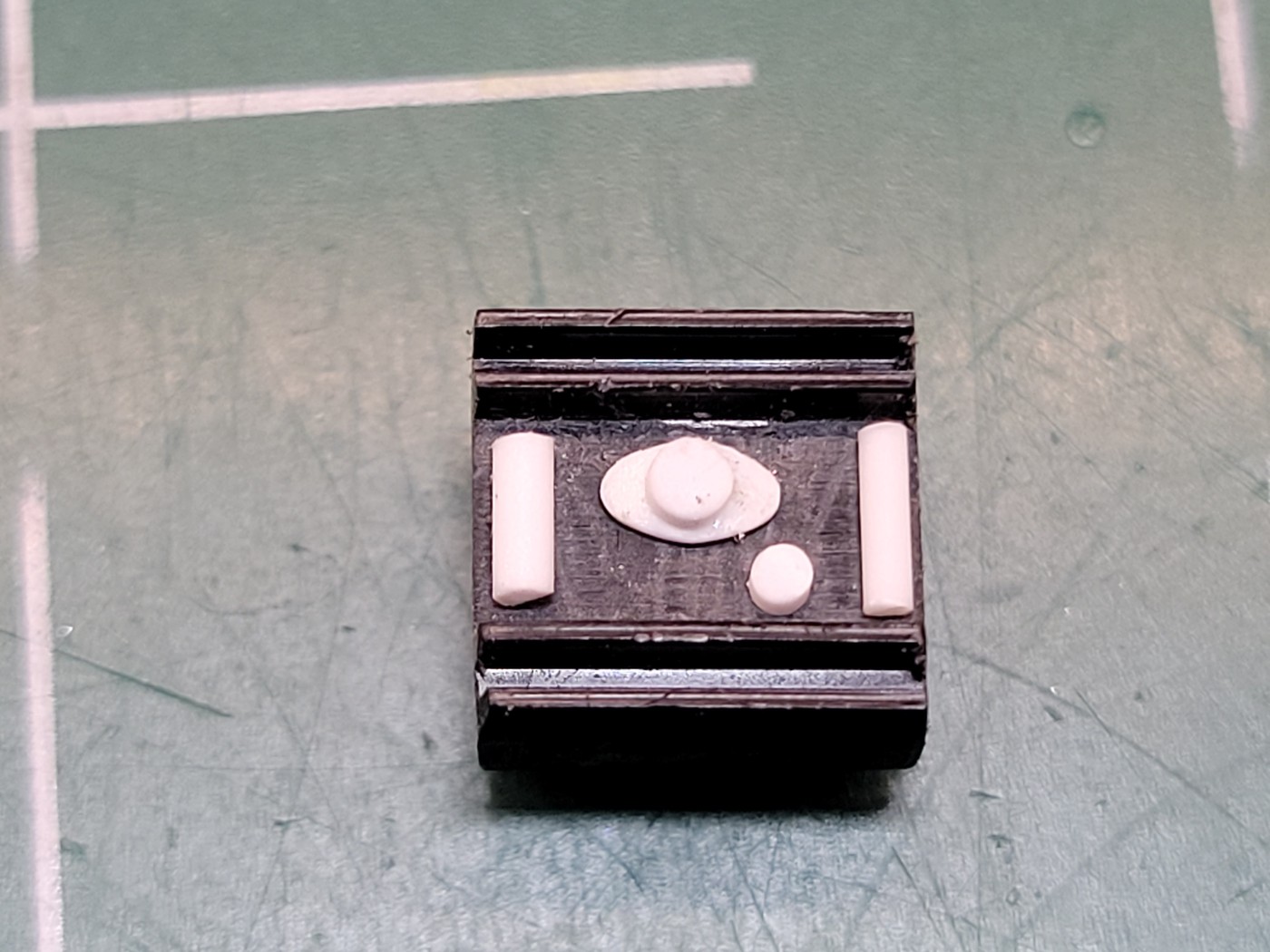

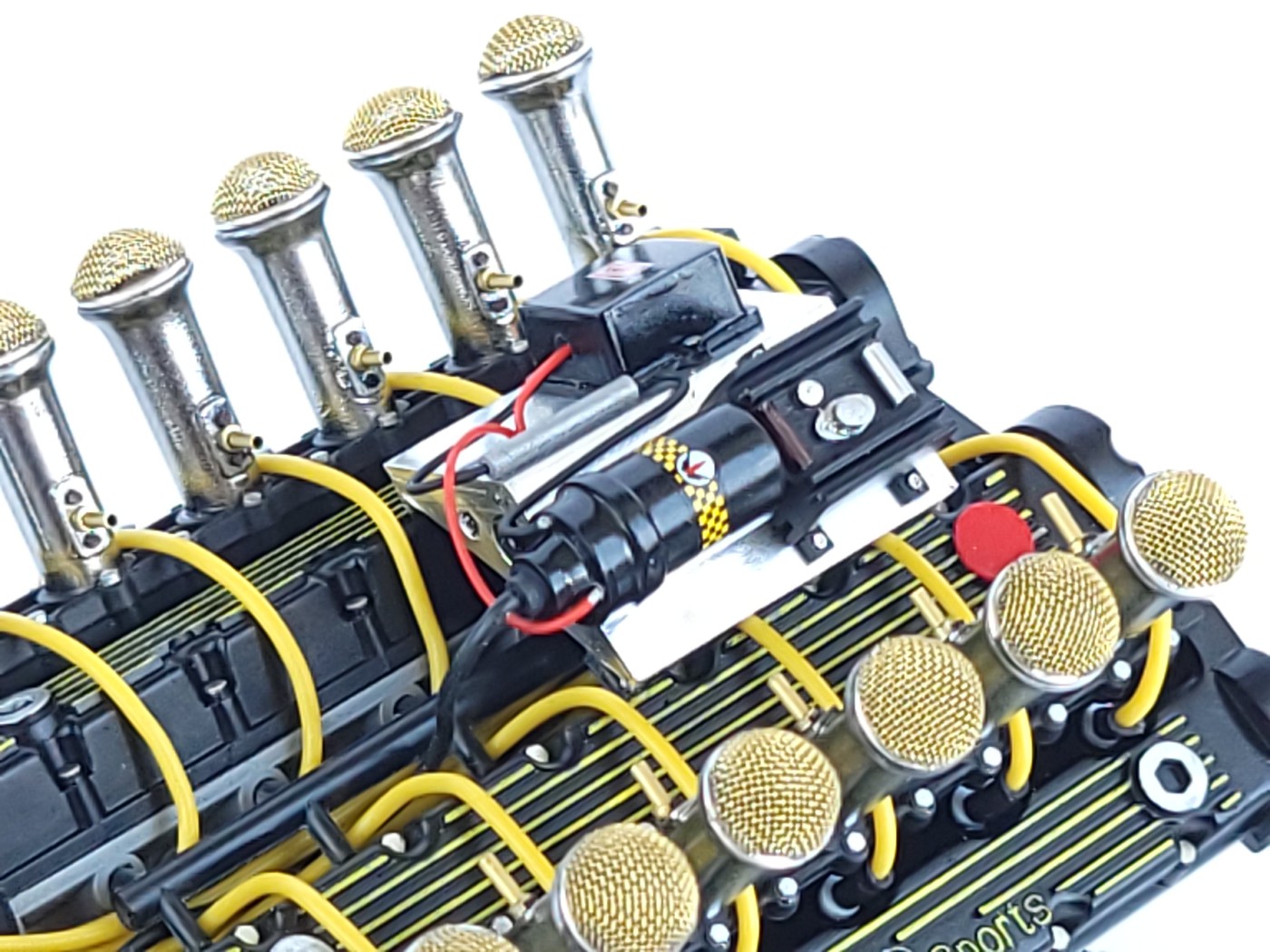

Nacho Z Posted August 9, 2022 Author Posted August 9, 2022 In a project like this you really have to think about the order that you are adding details. I will be adding the small electronic module before adding the fuel lines. DISCLAIMER: I took some educated guesses with the details. I may or may not have gotten them all right but overall they look the part. There wasn't much going on with electronics in 1968 F1. This photo along with a few others from slightly different angles was all I had to go on. (sorry if the picture is huge) Kit supplied parts. Notice the uninspired module with 3 blobs of molded plastic, (middle, right). I tried to make a power transistor. Not perfect but an improvement over the kit depiction. If I had to guess from the picture of the actual unit, capacitor on the left and resistor on the right. Power transistor in the middle. I painted them accordingly. I added 3 mounting tabs with photo-etch philips screw heads. The platform was covered in BMF and the components were added. I also added what I believe to be a power resistor. I took artistic license with the wiring of it all. At some point I had to say enough is enough. It looks good mounted to the engine. I would love to hear your thoughts on this. I know these old, big scale, foreign F1 cars don't get a lot of love but would be happy to know that people are at least checking out the build thread. Up next is the fuel pump, fuel lines and throttle items. 2

mrm Posted August 9, 2022 Posted August 9, 2022 I love all the details you are adding and the authenticity you are striving for. On that note, those ignition wires look way too perfect and symmetrically positioned. If that could be even considered a "downside". The engine looks just amazing so far.
MarkJ Posted August 9, 2022 Posted August 9, 2022 Wow, this makes my head hurt thinking about doing this micro type of scratch building work like the transistor. I'm in awe.
Nacho Z Posted August 9, 2022 Author Posted August 9, 2022 19 hours ago, Chris Smith said: Looking mighty sharp! All those little things will add up in the end. Thanks for the kind words on my build, I really appreciate it Thanks, Chris! I sure do hope that the final result will look “right”. And as for your model, you give me something to strive for. 14 hours ago, mrm said: I love all the details you are adding and the authenticity you are striving for. On that note, those ignition wires look way too perfect and symmetrically positioned. If that could be even considered a "downside". The engine looks just amazing so far. I appreciate it, Michael! I know what you are saying about the ignition wires. Because of how they are routed and how they go around the funnels, it really puts them in place, so to speak. My issue is that they are too bright and just a fraction of a fraction too big. The fuel lines really kind of “messy up” that whole area. Thanks for the comments! I like seeing things through someone else’s eyes.
mrm Posted August 9, 2022 Posted August 9, 2022 10 minutes ago, Nacho Z said: I appreciate it, Michael! I know what you are saying about the ignition wires. Because of how they are routed and how they go around the funnels, it really puts them in place, so to speak. My issue is that they are too bright and just a fraction of a fraction too big. The fuel lines really kind of “messy up” that whole area. Thanks for the comments! I like seeing things through someone else’s eyes. Perhaps you can use a Tamiya weathering kit and just rub some "dust " on them, just enough to take the shine off.
Nacho Z Posted August 9, 2022 Author Posted August 9, 2022 9 hours ago, MarkJ said: Wow, this makes my head hurt thinking about doing this micro type of scratch building work like the transistor. I'm in awe. Thanks, Mark! I try to do something new to me on most of my models. This is by far the most scratch building I have ever done. I honestly don’t think I’m all that good at it and I tend to be lazy about it sometimes. I thank you for the kind words, I really do appreciate it! 3 hours ago, absmiami said: Yup Hahahaha, I think that is a good thing. I’m not on your level by any means, (that Miller is sooooo cool!), but I appreciate you dropping in on my project!
Nacho Z Posted August 9, 2022 Author Posted August 9, 2022 4 minutes ago, mrm said: Perhaps you can use a Tamiya weathering kit and just rub some "dust " on them, just enough to take the shine off. See now, that is something I never even thought about. I don’t really have any weathering supplies but that is an excellent idea. I may have to look into that. Thanks!

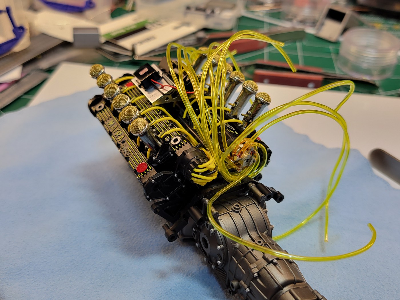

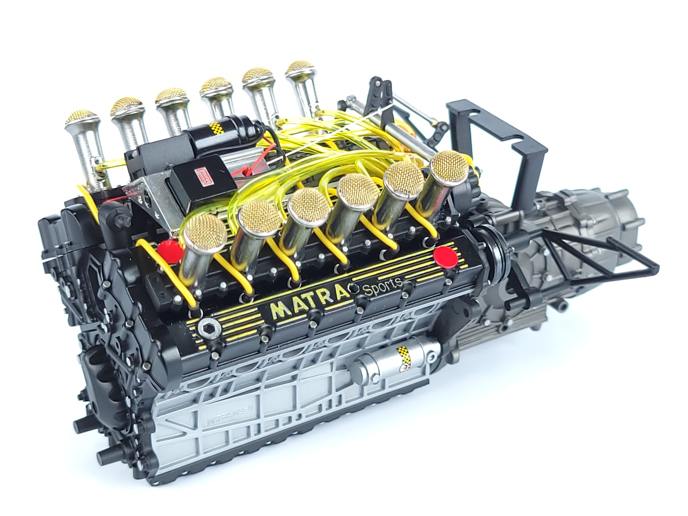

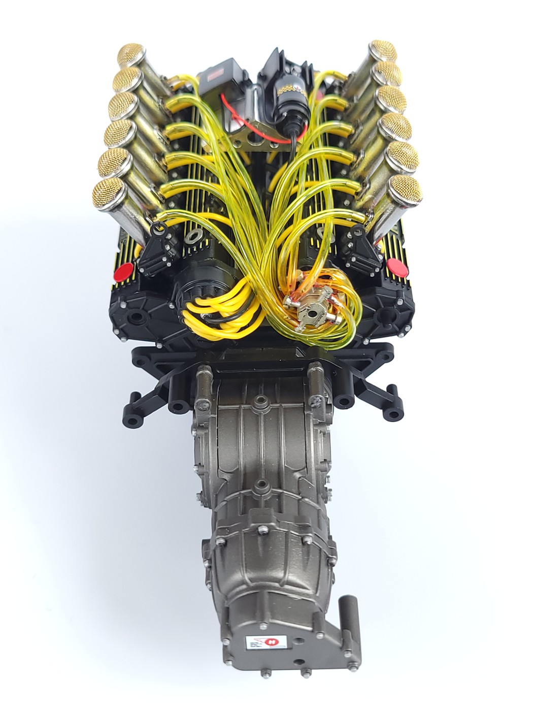

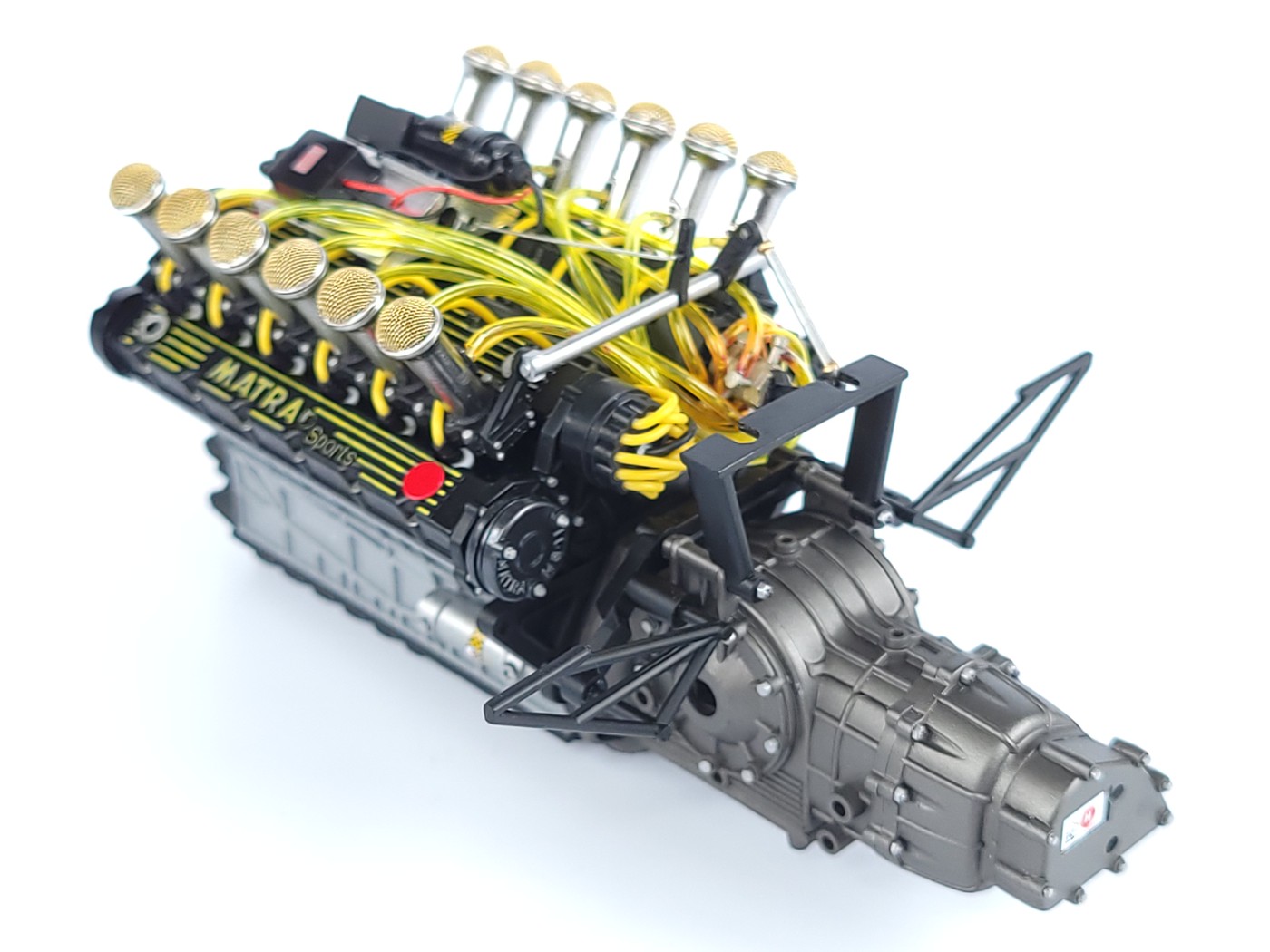

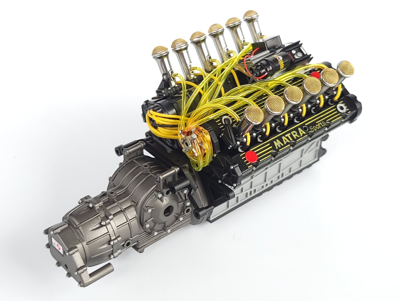

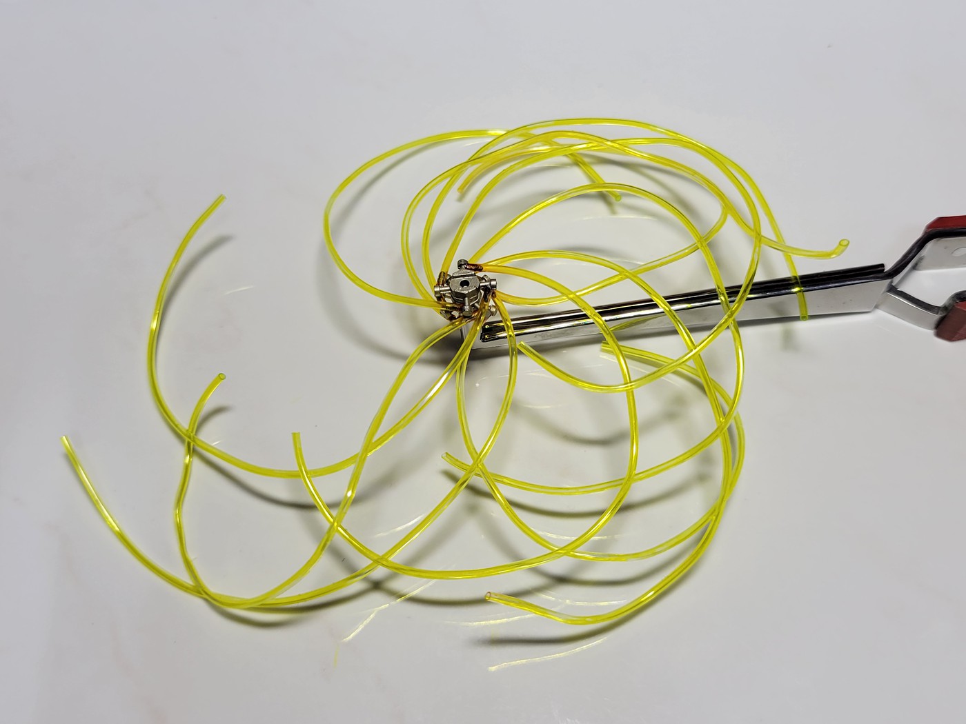

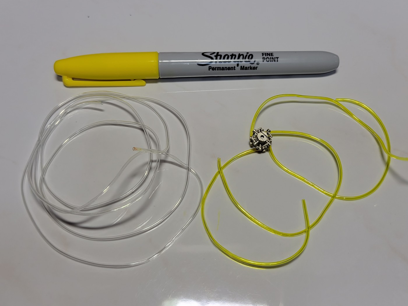

Nacho Z Posted August 16, 2022 Author Posted August 16, 2022 It is Monday night which means it is time for another update. A quick thank you to those of you who have stopped by and commented on the build so far. It is appreciated! Fuel lines. I was kind of dreading this. In my experience tubing like what is supplied likes to kink when curved too sharply. Also, I couldn't stand them being clear, (not sure why). My scratch built injectors were made based on the kit tubing so I had to use it. I tried several things to tint the clear tubing but nothing would stain it. I settled, and I do mean settled, on using a Yellow Sharpie to literally color the tubing. Even the Sharpie would wipe off if handled too much. The entire length of tubing has been colored and cut into 12 equal lengths. They were then glued to the fuel pump. I let the CA glue cure overnight. When I came back I noticed that the glue reacted to the paint on the fuel pump fittings and turned them an orange-ish color. In progress shot. Fuel lines in place. Notice the fuel pump. That is a lot of tubing in a very small area! As always, comments and questions are welcome. Thanks for looking! 3

Pierre Rivard Posted August 16, 2022 Posted August 16, 2022 John, this engine is simply wonderful to look at. It could be a model to display on it's own. I've done some weathering on engine and other mechanical components but I would not do it on this baby. it looks like it just came off from the rebuild bench and ready for installation before the Grand Prix weekend. It's perfect for your build. You inspire me to up my game on engine detailing. Thank you for showing us your process.
Rich Chernosky Posted August 16, 2022 Posted August 16, 2022 John, I know what an absolute pain those fuel lines are. Your persistence has paid off handsomely. This is turning out to be one amazing engine.
mrm Posted August 16, 2022 Posted August 16, 2022 I have gone through the troubles with building a couple of Protar 1/12 Ferraris and a couple of Tamiya’s. What I did when using the kit supplied clear tubing was actually flow diluted Tamiya clear orange. Best effect I ever achieved. And it will never rub out. If you still have enough clear tubing left, I think it would be worth a try and will be an improvement over what you have now. An alternative eliminating the possibilities of kinks is fishing cord. If you go to most fishing supply stores, you will probably go home with enough clear “tubing” in various scales to last you a lifetime, for free. Just tell them what you need it for and they will give you all sorts of pieces. Something I have also tried is clear beading cord, which is super cheap and available in any Walmart or craft store in a variety of sizes. Again, three bucks will probably set you for life.

Nacho Z Posted August 19, 2022 Author Posted August 19, 2022 On 8/16/2022 at 9:37 AM, Rich Chernosky said: John, I know what an absolute pain those fuel lines are. Your persistence has paid off handsomely. This is turning out to be one amazing engine. Thank you, Rich! It is great having you follow along! On 8/16/2022 at 10:18 AM, mrm said: I have gone through the troubles with building a couple of Protar 1/12 Ferraris and a couple of Tamiya’s. What I did when using the kit supplied clear tubing was actually flow diluted Tamiya clear orange. Best effect I ever achieved. And it will never rub out. If you still have enough clear tubing left, I think it would be worth a try and will be an improvement over what you have now. An alternative eliminating the possibilities of kinks is fishing cord. If you go to most fishing supply stores, you will probably go home with enough clear “tubing” in various scales to last you a lifetime, for free. Just tell them what you need it for and they will give you all sorts of pieces. Something I have also tried is clear beading cord, which is super cheap and available in any Walmart or craft store in a variety of sizes. Again, three bucks will probably set you for life. Some very good information, Michael! I knew of the injecting liquid in the tube but was really unsure of how it would turn out. I always second guess myself like that. Turns out I had more than enough tubing and could have tested it. I absolutely agree that clear orange would have been much better than the yellow I went with. Maybe on my next 1:12 F1. I had a local friend tell me about the fishing line. Fly fishing I believe is what/where he said to look for. Again, something to try on my next build. As it turned out, the kit tubing was fresh enough that it did not kink. Didn't even want to...lol. Thanks for all of the great input. I will never think that I am good enough to not listen to great modelers such as yourself! Keep the suggestions coming!
Nacho Z Posted August 23, 2022 Author Posted August 23, 2022 This Monday night update is a smaller one. I have done about all I can do to the drivetrain until I get it installed in the chassis. I added the throttle linkage pieces and a few of my own. I also installed the exhaust brackets and a radiator bracket. 3
