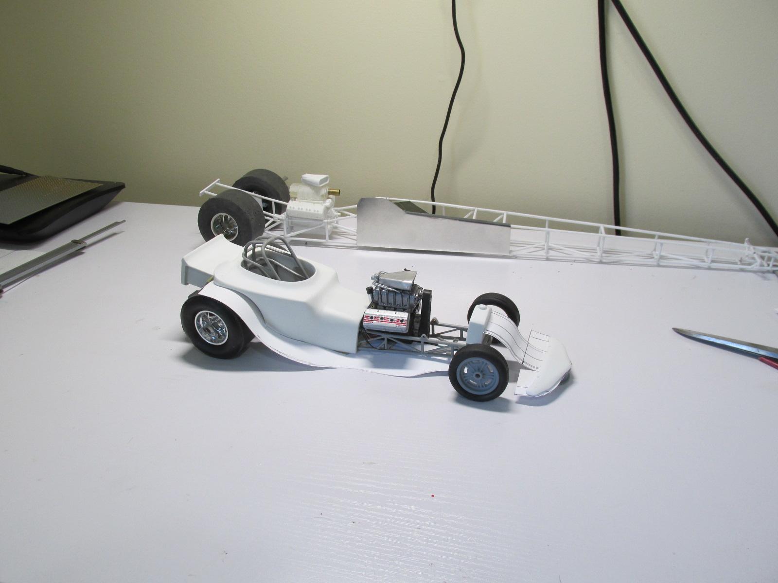

Ian McLaren Posted July 27, 2022 Author Share Posted July 27, 2022 Narrowed the field somewhat, not sure what this is going to be but the foundation is straight and square. 1 Quote Link to comment Share on other sites More sharing options...
misterNNL Posted July 27, 2022 Share Posted July 27, 2022 That long lean dragster frame looks mighty tasty. Quote Link to comment Share on other sites More sharing options...

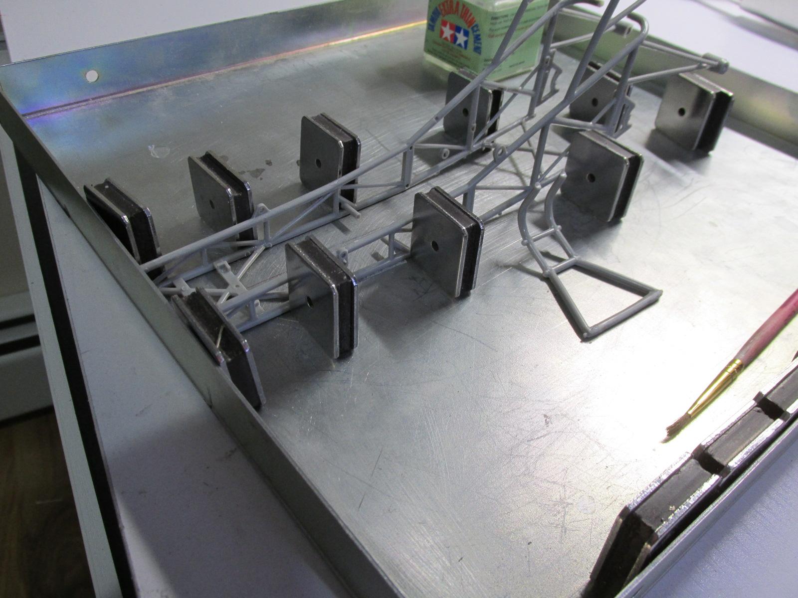

Ian McLaren Posted July 28, 2022 Author Share Posted July 28, 2022 7 hours ago, misterNNL said: That long lean dragster frame looks mighty tasty. Yes it does but I think I have to order a few parts before I can make significant progress on it, than and I built the Royal Canadian with a brass chassis after I started this. I still have the jigs for the chassis and they are suitable to redo this in brass instead. Wheels and tires are also high on the list of needs and being a mid 80s car both the front and rear wheels differ significantly from what it readily available. We will see. Quote Link to comment Share on other sites More sharing options...

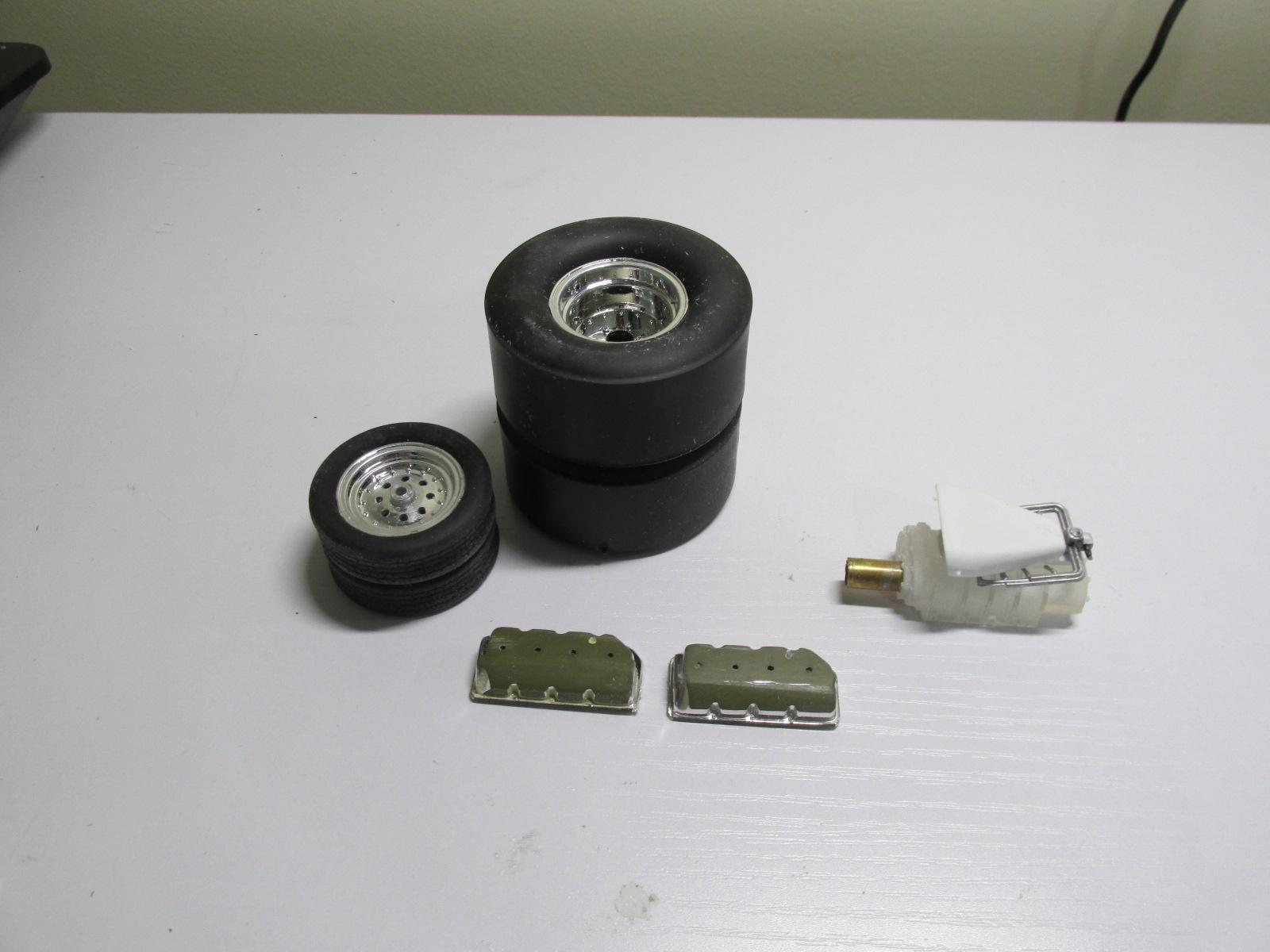

Ian McLaren Posted July 30, 2022 Author Share Posted July 30, 2022 May go this way on this one, this is not the intended motor just a Donovan that was laying around. 1 Quote Link to comment Share on other sites More sharing options...

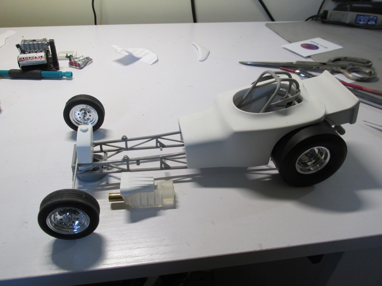

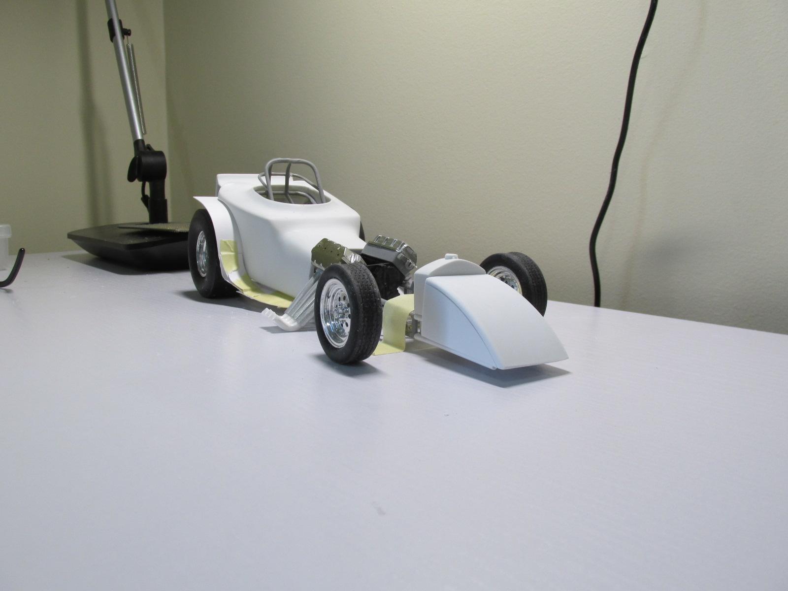

Ian McLaren Posted July 30, 2022 Author Share Posted July 30, 2022 (edited) After looking at the above for a while the plan has evolved in another direction. Extent the frame, shorten the wheelbase, relocate the rad/fuel tank and fab a nose piece. Also put the correct engine in with the 14-71 and fabricated the two wall headers. Thinking the nose may be a little too long. Edited July 30, 2022 by Ian McLaren 1 Quote Link to comment Share on other sites More sharing options...
Ian McLaren Posted July 31, 2022 Author Share Posted July 31, 2022 I took 4 Scale inches off the nose and now the balance seems better , at least to me. Also playing with a more subtle rear fender/ body extension. Not sure I'm liking the spoiler / kick up on either the pick up bed or rear body upper corners. 1 Quote Link to comment Share on other sites More sharing options...
Ian McLaren Posted July 31, 2022 Author Share Posted July 31, 2022 (edited) I guess I should explain the some what unusual series of posts on this build. I'm trying to show my process for a clean sheet phantom build from the beginning. I am including all of the steps and miss steps in the process. Once the design is more of less finalized I'll revert to a more conventional style of posting. I hope you hang in there with me and perhaps pick up at least some things to consider when you strike out on the uncharted path. Case in point some changes to the body itself, removing the two rear spoilers. Things to consider, while removing the items may enhance the retro feel of the model they are going to drastically affect the aerodynamics and downforce of the car, so to be functionally correct that will have to be replaced. More on that later. Edited July 31, 2022 by Ian McLaren 1 Quote Link to comment Share on other sites More sharing options...

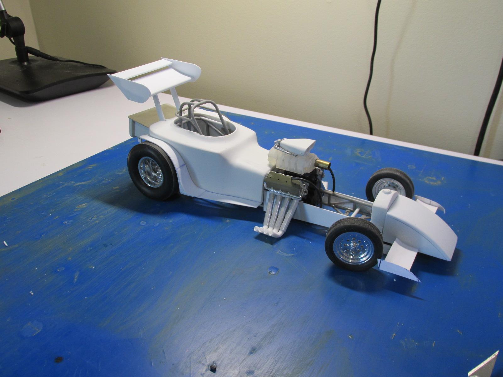

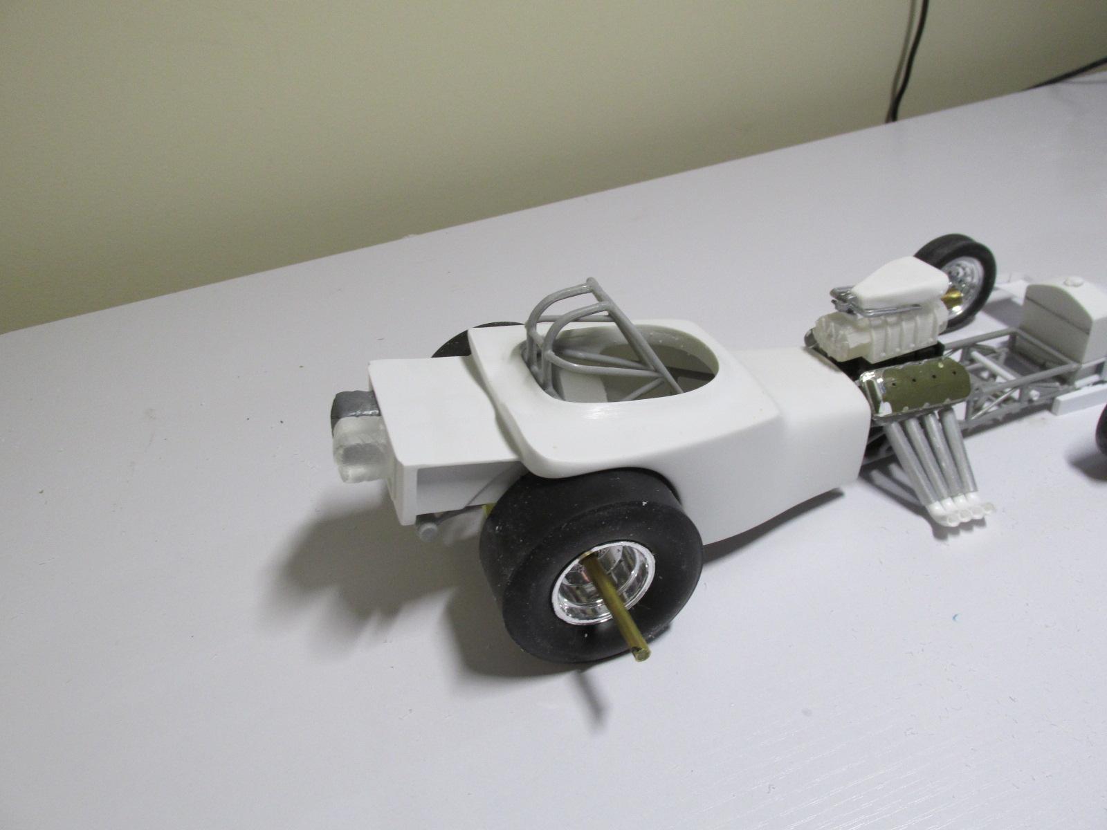

Ian McLaren Posted July 31, 2022 Author Share Posted July 31, 2022 Skeleton of the rear fenders and running boards on, better shot of shortened nose, maybe canards these are just cardboard mock ups 1 Quote Link to comment Share on other sites More sharing options...
Ian McLaren Posted July 31, 2022 Author Share Posted July 31, 2022 Got some extra time on the bench, started refining the rear fenders / running boards. They are staying 1 Quote Link to comment Share on other sites More sharing options...

Ian McLaren Posted August 1, 2022 Author Share Posted August 1, 2022 Earlier we removed the spoilers from the basic body and noted something would have to be done to restore functionality. Here is that something, I have scratch build a two element rear wing which should be more than enough to balance the design. Fairly low tech wing 18 degrees AoA on the main element for starters, Seven degrees on the second ( should probably have more but I'm bowing to esthetics here as I like this look). I also talked about steps and missteps and this change is probably going to bring some of those up shortly. Note*** the wing is not mounted to the model here just balancing on the pickup bed on to of a paint mixing plastic cup. 1 Quote Link to comment Share on other sites More sharing options...

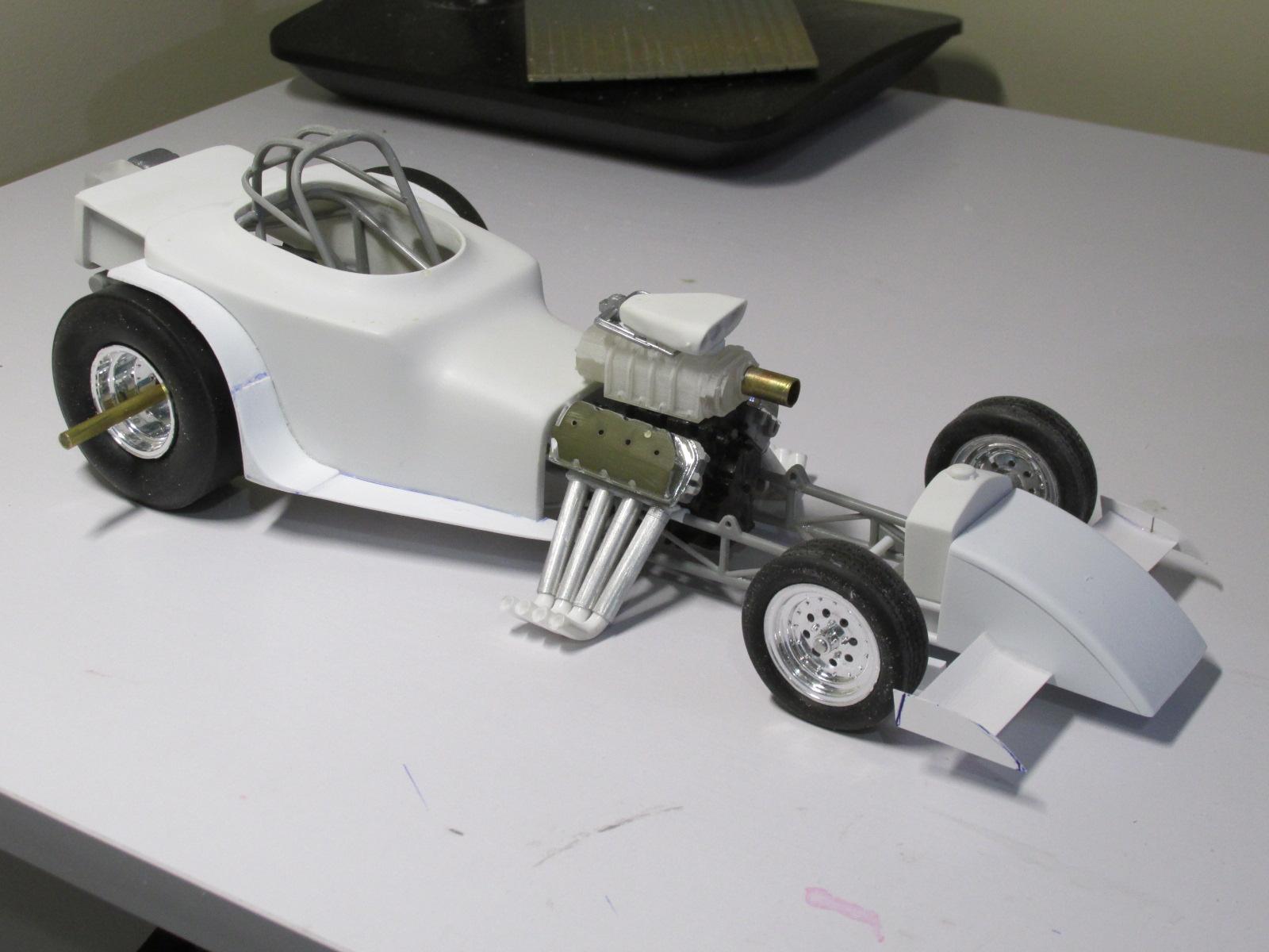

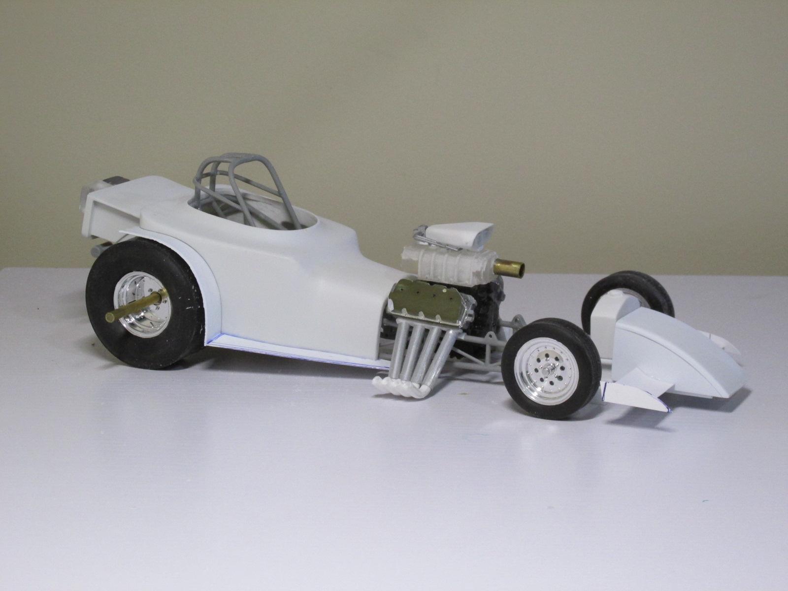

Ian McLaren Posted August 3, 2022 Author Share Posted August 3, 2022 Still deciding on the wing mounting choice but here it where is stands right now with the wing temporarily mounted but in what I think will the final position and other additions. Rear pickup bed opened up and fitted with a steel cover that is held in place with three rare earth magnets as is the nose and canards. Also shown frame close out panels first attempt in plastic, to be replace by the final aluminum units once all of the attachments and brackets are in place and final body and nose positions have been finalized. The front suspension system I had first installed created clearance issues with fire systems steering and main fuel line to the engine. Redone setup also regains some of the original wheel base now at 110 inches. Quote Link to comment Share on other sites More sharing options...
