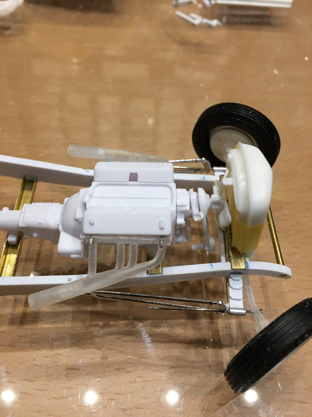

Mr. Metallic Posted September 15, 2022 Share Posted September 15, 2022 (edited) On 9/12/2022 at 2:40 PM, Calb56 said: Wanting to use one in a 32 build. Best one with Thunderbird covers? Just curious. Y block in 32 is a great idea. Let me give you a couple pointers since I'm familiar with that process. The Y block and it's front cover/water pump/pulleys/fan assembly is quite long, an very tight fit in the friendly confines of the 32 engine compartment. This project happened to include a lengthened frame, and even so you can see how tight the fit is. All of this can be overcome with a little slice and dice and parts swapping. This engine is from the Revell 57 Ford, with some speed parts from Maple Leaf Modelworks Edited September 15, 2022 by Mr. Metallic 1 Quote Link to comment Share on other sites More sharing options...
espo Posted September 15, 2022 Share Posted September 15, 2022 One thing to consider with a Y block Ford in a '32 Ford or anything with a crowded area around the front of the engine. The OEM Oil Sump is in the front of the engine and the pump itself is on the outside of the block on the driver's side. Since we're just dealing with plastic here, just do a 180 with the Oil Pan and mount the sump to the rear. This should go a long way to clear any cross members or suspension issues. Quote Link to comment Share on other sites More sharing options...
Mark Posted September 15, 2022 Share Posted September 15, 2022 Didn't two-seater T-Birds have oil pans with the sump at the back? The Y-block was a legit engine swap for early V8 Fords in the late Fifties and Sixties, look through period magazines and you'll see a bunch of them. Rod & Custom featured a black '32 Vicky with a Y-block that had the supercharger setup, I believe they even did a Model Sketchpad feature on it where they broke it down into components and suggested kit sources for them. 1 Quote Link to comment Share on other sites More sharing options...
