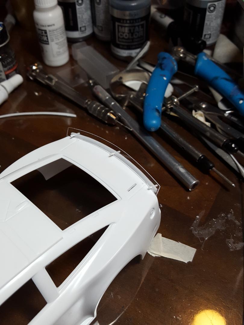

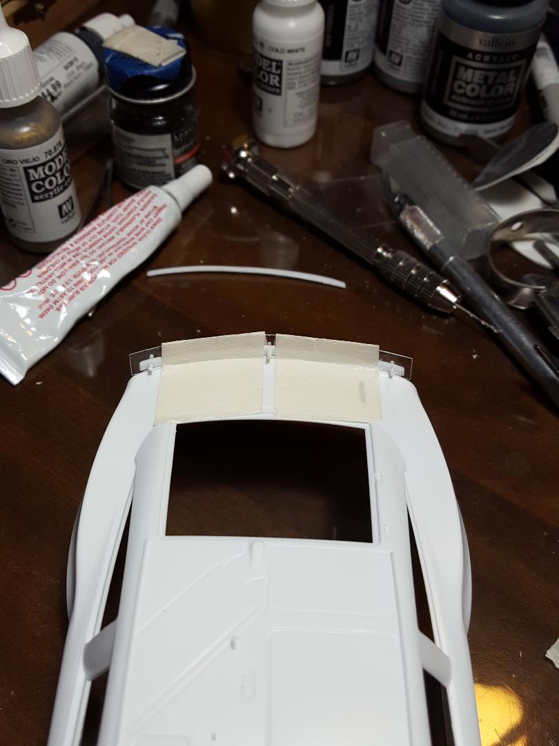

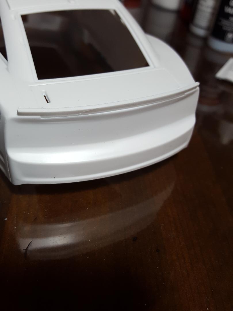

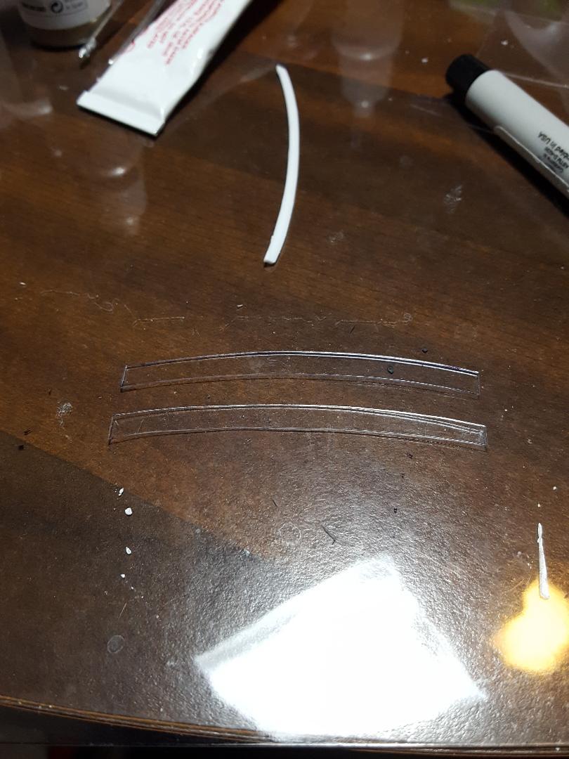

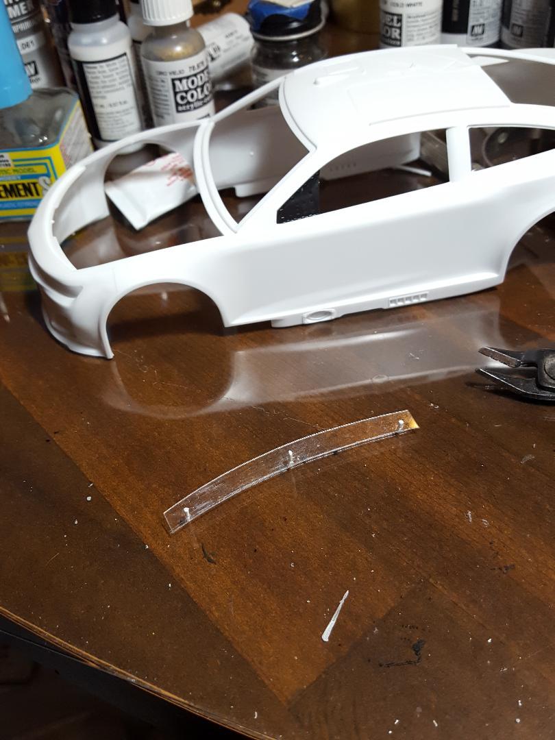

MarkJ Posted November 14, 2022 Author Share Posted November 14, 2022 2 hours ago, Merkur XR4Ti said: On some of the later issues of the kits, there's a transparent spoiler. I might have an extra you can have, if I can dig it up. Steve, the kit I have has a clear seven-inch spoiler and a body color 4-inch spoiler, so I had to convert my 4-inch spoiler to a clear one because I'm not building a Daytona or Talladega car. Quote Link to comment Share on other sites More sharing options...

MarkJ Posted November 14, 2022 Author Share Posted November 14, 2022 15 minutes ago, randman said: Is the smaller spoiler clear? I know the large super speedway spoiler is clear, but I wasn't aware the smaller one is available in clear, although I haven't opened any of the newer releases. I've been making my own smaller clear spoiler. Randy, you did what I had to do. It would have been nice if they had cast both spoilers in clear. From what I understand the 4 inch spoiler is used everywhere except Daytona and Talladega . Maybe it's also being use at Atlanta. I'm not sure. Quote Link to comment Share on other sites More sharing options...

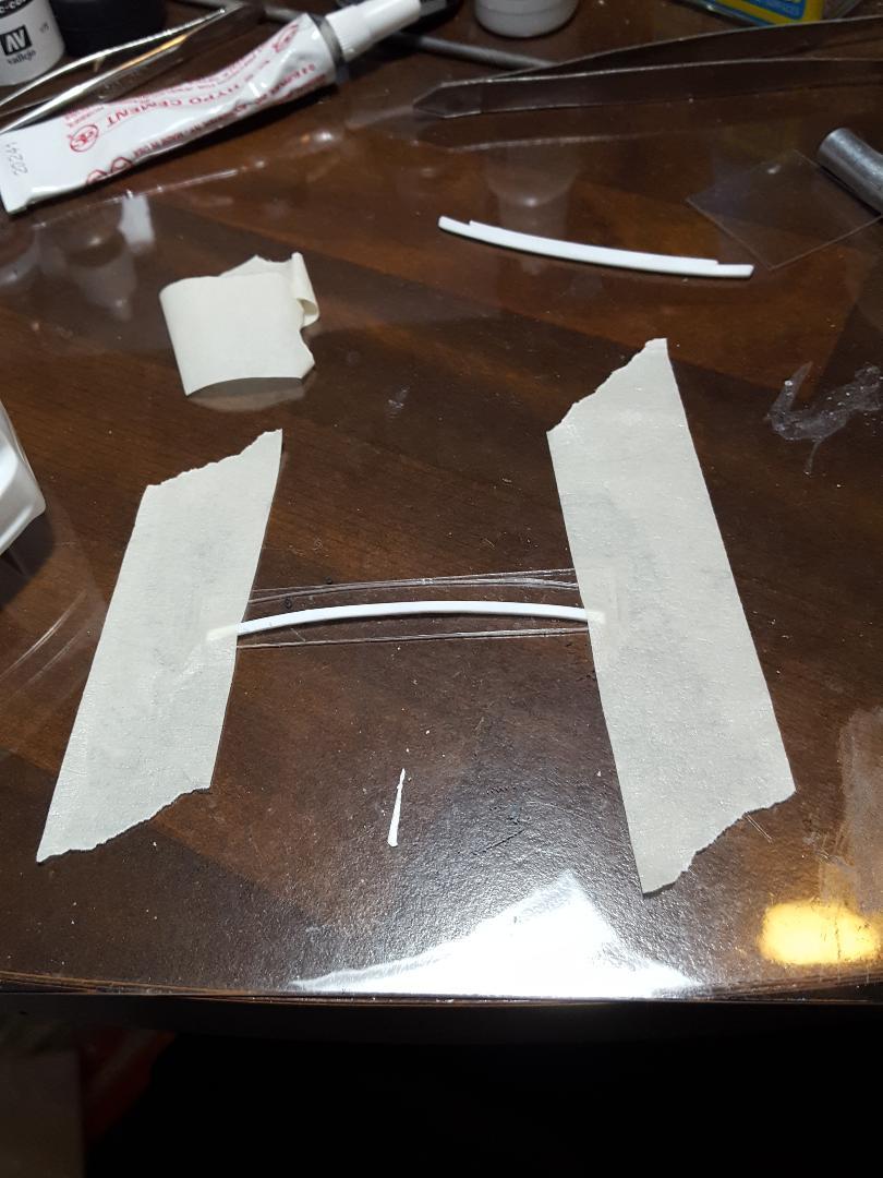

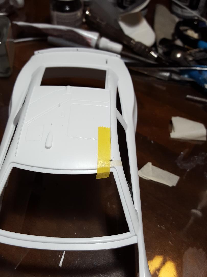

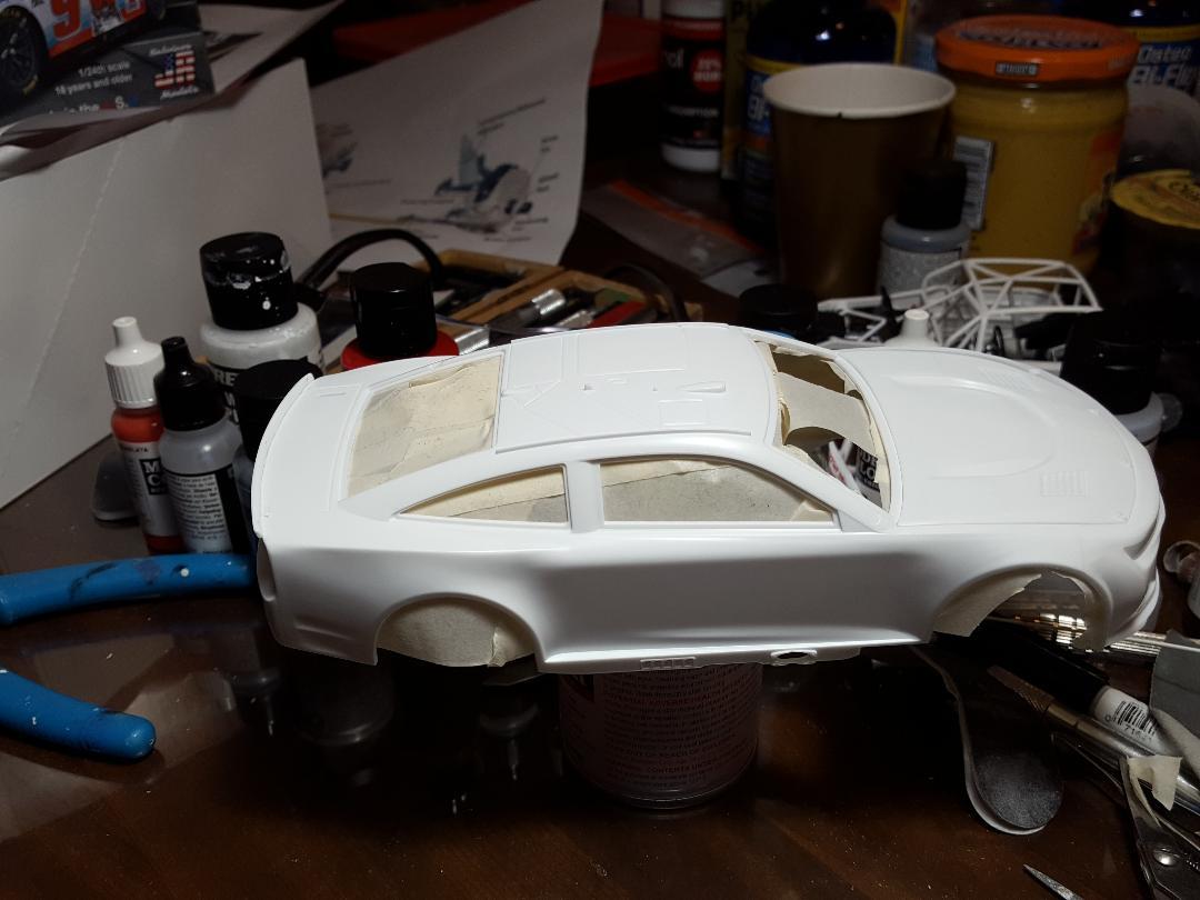

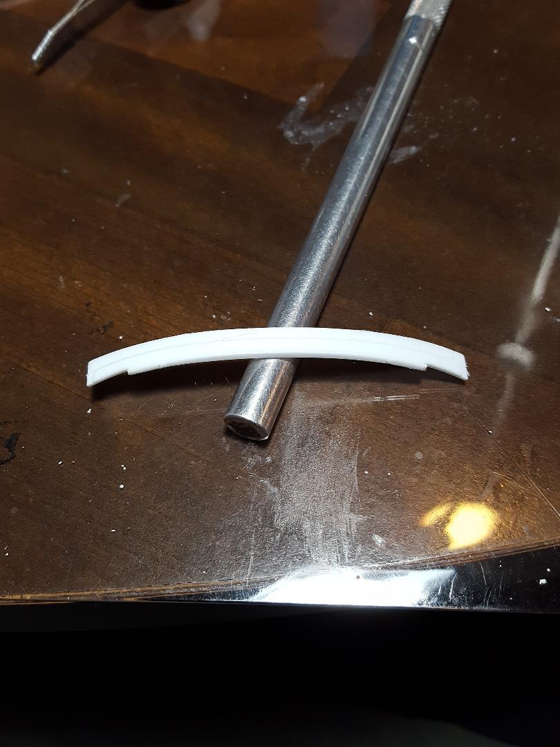

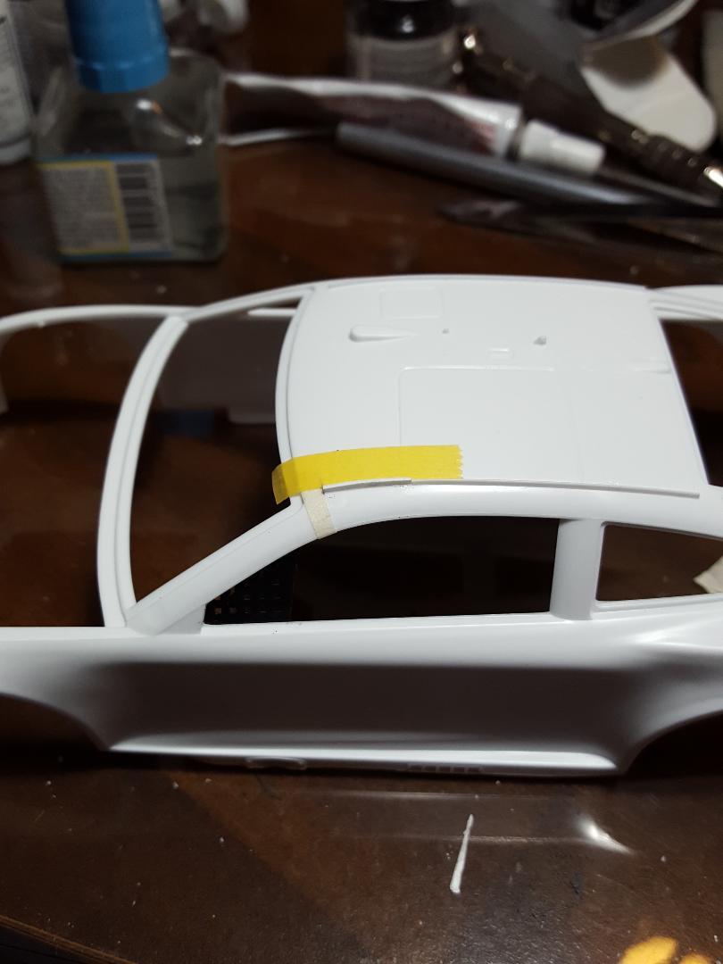

MarkJ Posted November 15, 2022 Author Share Posted November 15, 2022 Got the left roof ridge done. Now I can move on to priming and painting the body. I'm going to tape inside the roof because I think that part needs to be white like most of the chassis is. If I don't I'm sure I will splash some body color paint on it somehow. Quote Link to comment Share on other sites More sharing options...

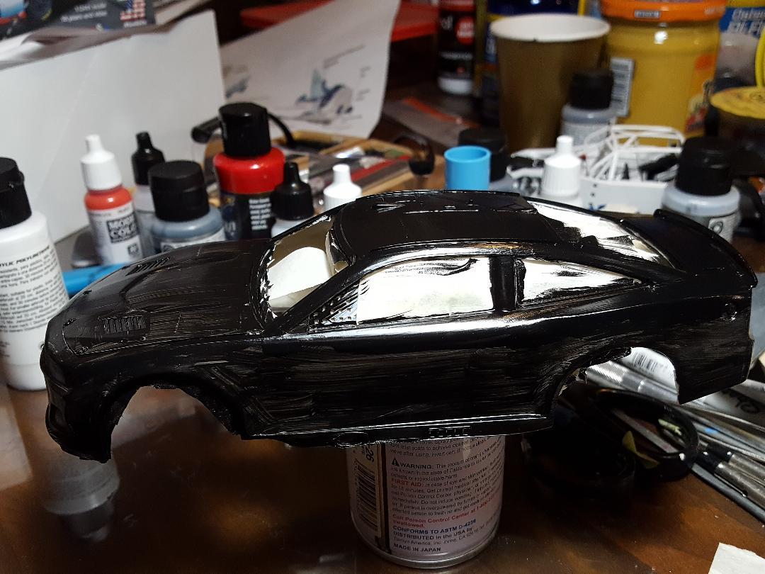

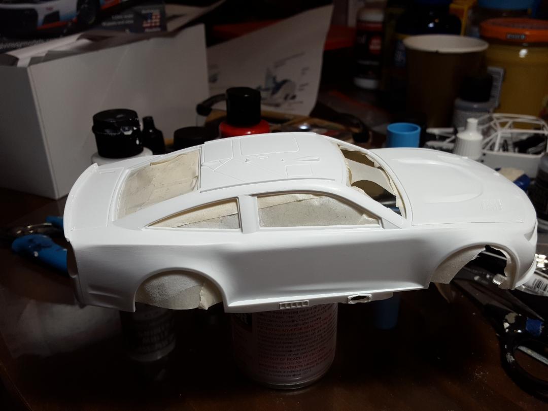

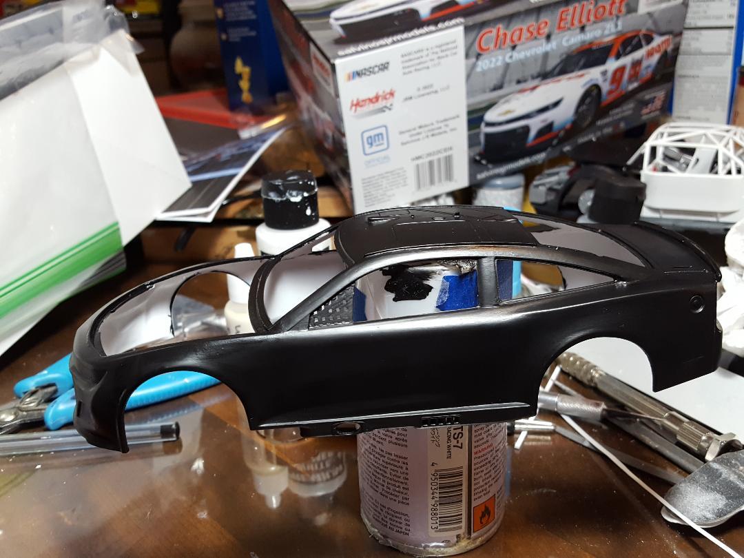

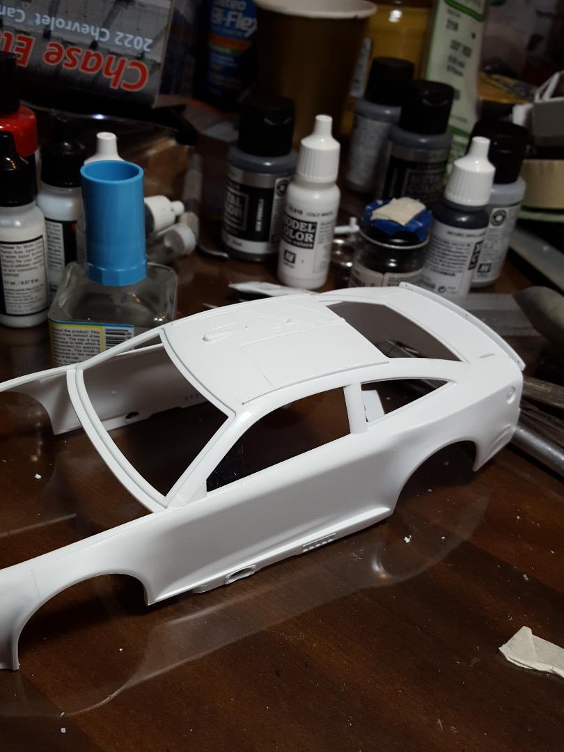

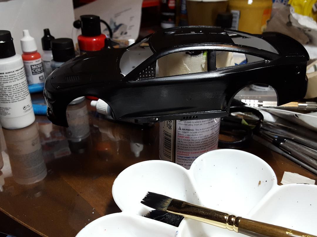

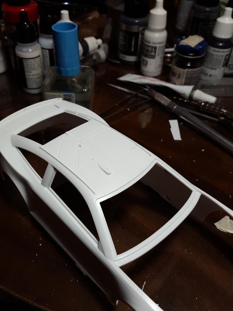

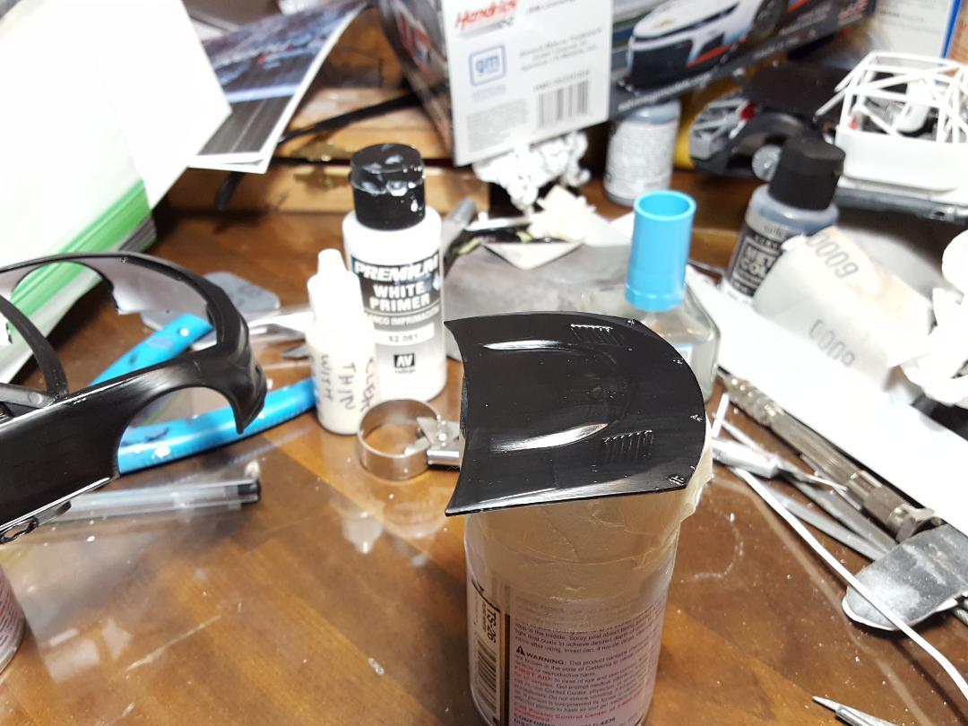

MarkJ Posted November 17, 2022 Author Share Posted November 17, 2022 The pictures below are body ready for primer, body primed and the last two are first coat of black paint. Quote Link to comment Share on other sites More sharing options...

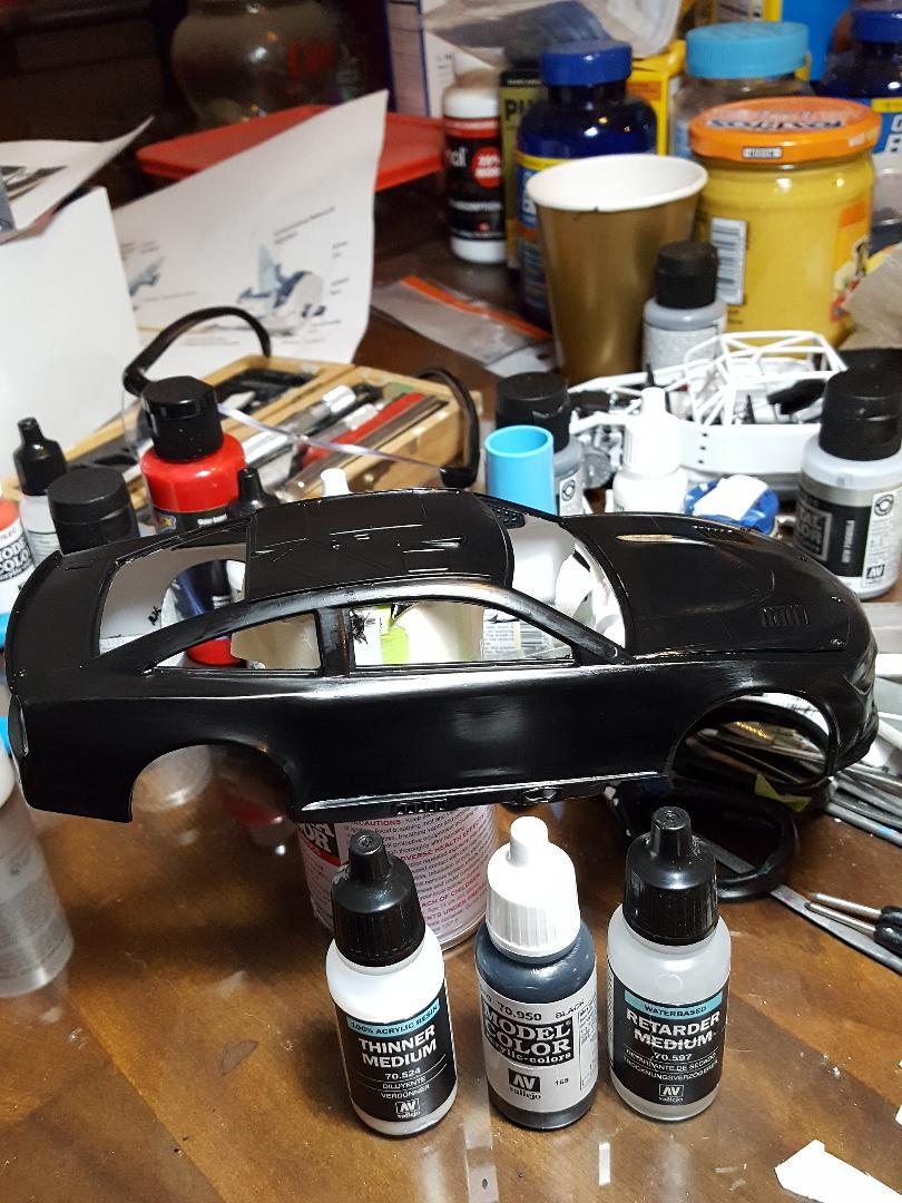

MarkJ Posted November 17, 2022 Author Share Posted November 17, 2022 Sanded the first coat down and then hit it with another coat using a more satin black. Product I used is in the last picture. I will lightly sand this trying, not to go through to the primer and then hit it with an acrylic gloss clear. I will then polish that and see what I have. Quote Link to comment Share on other sites More sharing options...

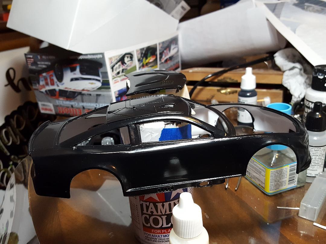

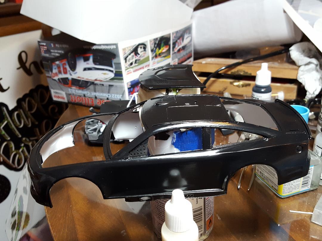

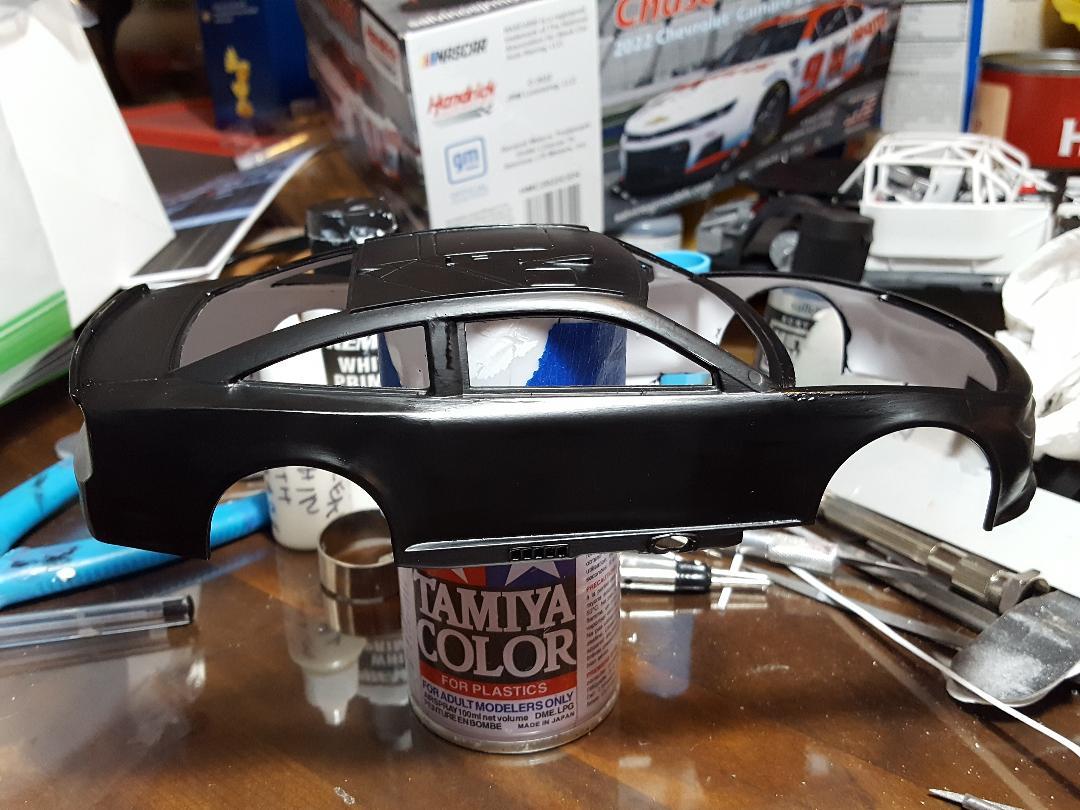

MarkJ Posted November 20, 2022 Author Share Posted November 20, 2022 Here is the final coat of black. Next up will be the gloss clear acryl and polishing with 6000,8000, and 12000 grit polishing cloths and hope I don't go through to primer. Quote Link to comment Share on other sites More sharing options...

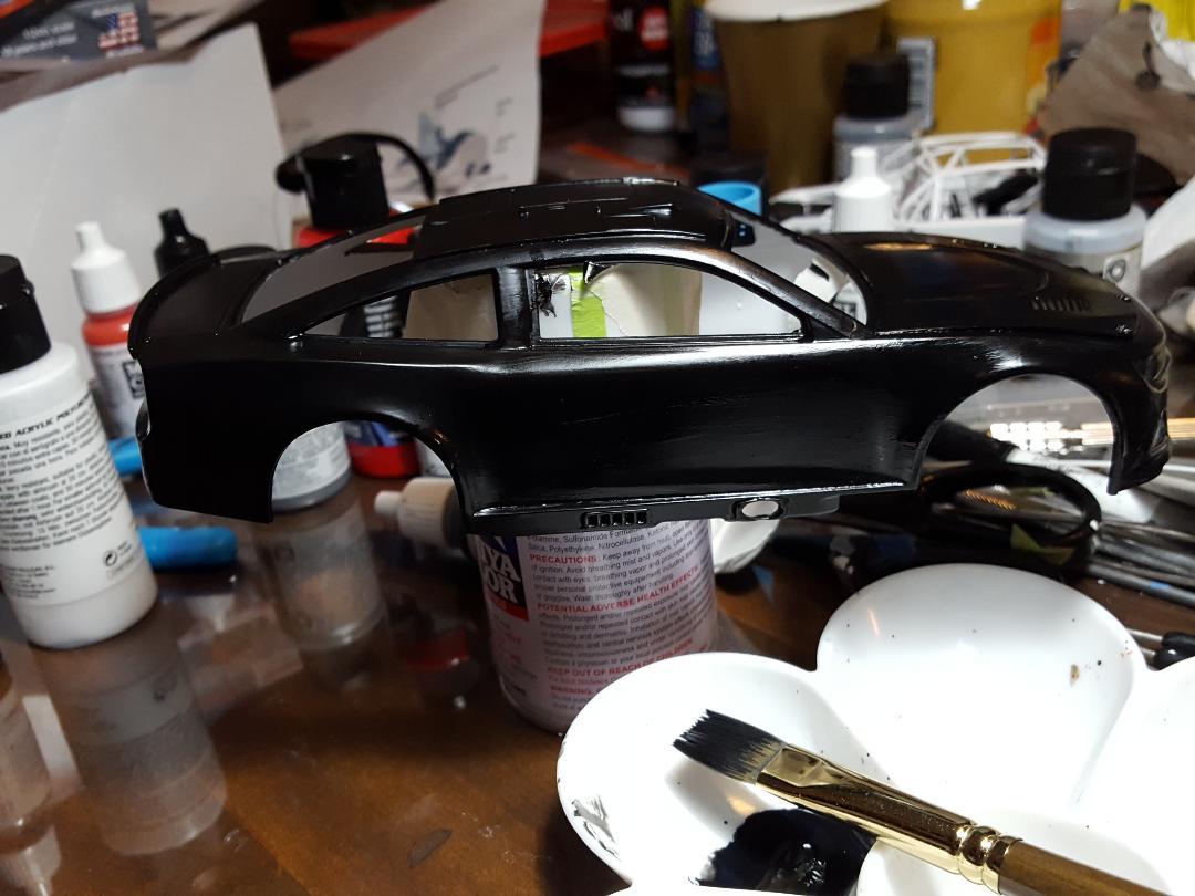

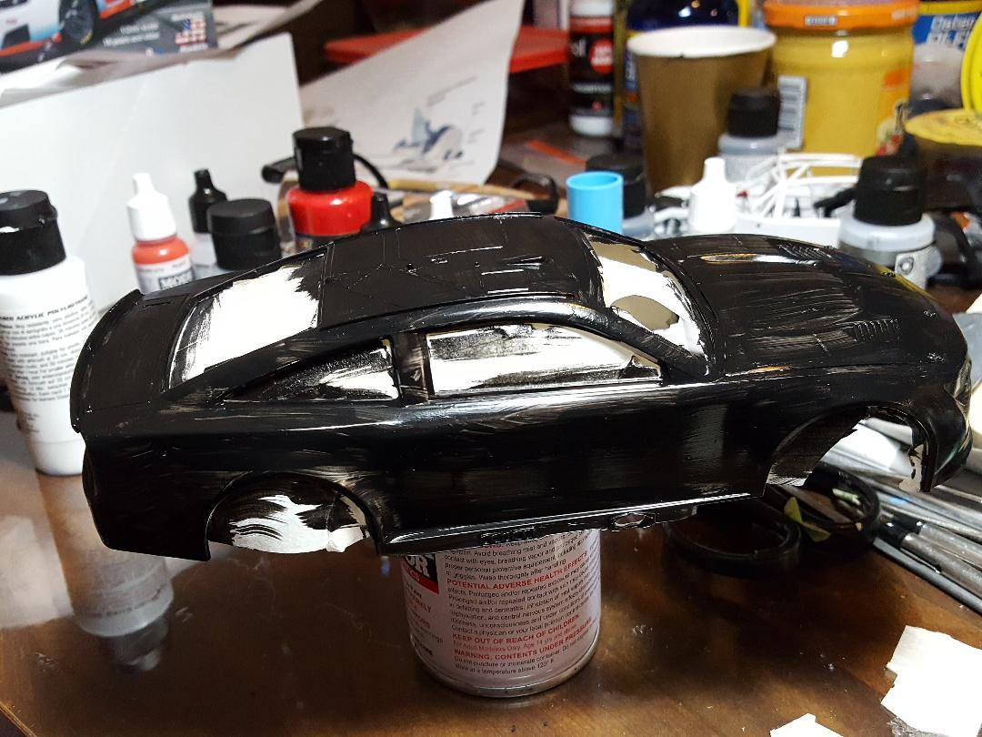

MarkJ Posted November 21, 2022 Author Share Posted November 21, 2022 This is the first coat of Model masters gloss clear acryl brushed on the body. Need to polish it with 6000, 8000, and 12000 polishing pads. And probably put on another coat. Quote Link to comment Share on other sites More sharing options...
Merkur XR4Ti Posted November 22, 2022 Share Posted November 22, 2022 You brushed that? It looks tremendous! Quote Link to comment Share on other sites More sharing options...
MarkJ Posted November 22, 2022 Author Share Posted November 22, 2022 6 hours ago, Merkur XR4Ti said: You brushed that? It looks tremendous! Thanks, Steve. But it still needs some work. Yes, I'm committed to brush painting. It's been cold and rainy here for the last week. If it wasn't for brush painting, I would not have got any painting done. Quote Link to comment Share on other sites More sharing options...

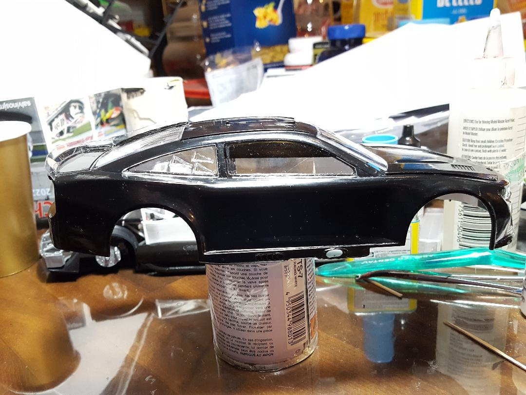

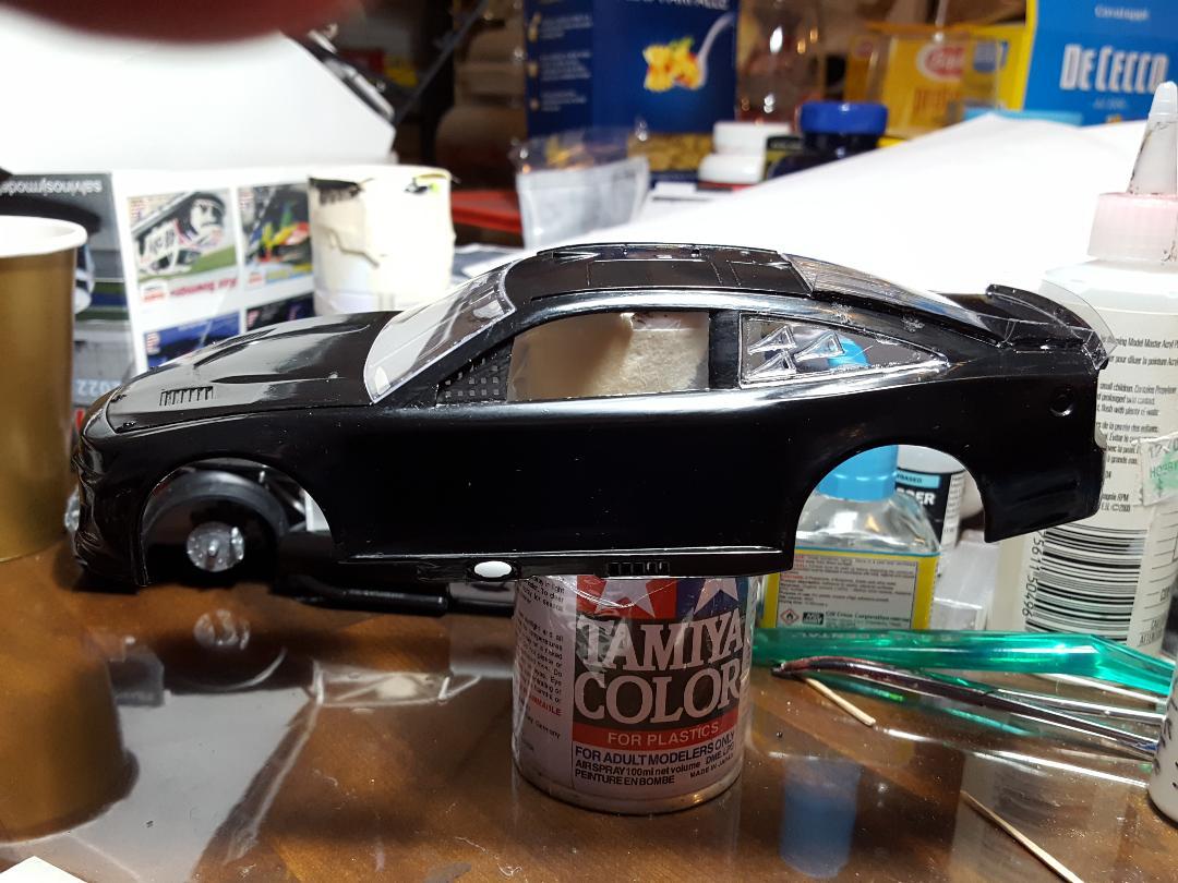

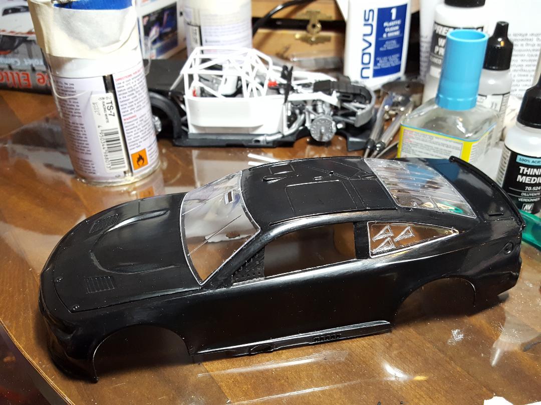

MarkJ Posted November 23, 2022 Author Share Posted November 23, 2022 Installed the glass. Not fun at all. Hope it stays in. Quote Link to comment Share on other sites More sharing options...
Pierre Rivard Posted November 23, 2022 Share Posted November 23, 2022 Paint looks good my friend. You can do black you can do anything! This is much harder than the little light blue thing I'm working on at the moment... Quote Link to comment Share on other sites More sharing options...
MarkJ Posted November 23, 2022 Author Share Posted November 23, 2022 After I posted the photo above, I realized the left top corner of the windshield had popped up. I went back and fixed it. Did any of you guys use shoe goo? I figured there was no way I could use that and not make a tremendous mess, but it probably would hold the glass down. I used that canopy watch crystal glue. Quote Link to comment Share on other sites More sharing options...
MarkJ Posted November 23, 2022 Author Share Posted November 23, 2022 4 minutes ago, Pierre Rivard said: Paint looks good my friend. You can do black you can do anything! This is much harder than the little light blue thing I'm working on at the moment... Thanks. Pierre. Paint is not that great, but I'm hoping the future will bail me out along with all the decals that cover most of the body. Where are you posting the wip on the light blue car? I would like to check it out. Quote Link to comment Share on other sites More sharing options...

randman Posted November 30, 2022 Share Posted November 30, 2022 On 11/23/2022 at 3:08 PM, MarkJ said: After I posted the photo above, I realized the left top corner of the windshield had popped up. I went back and fixed it. Did any of you guys use shoe goo? I figured there was no way I could use that and not make a tremendous mess, but it probably would hold the glass down. I used that canopy watch crystal glue. I use Evergreen Canopy glue on mine. As you mentioned, one corner does seem to pop out on its own so I find some way to hold the whole thing down until the glue dries. Quote Link to comment Share on other sites More sharing options...
