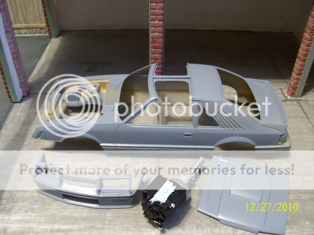

GTMust Posted December 27, 2010 Share Posted December 27, 2010 It's about -10c here(don't know what that is in farenheit - about 12?). Anyway, there was no wind and the sun was shining, so I heated a can of Testor's gray primer (in the can), and shot a couple of guide coats across the plastic to see where it would need more filler. I don't have anywhere to spray during the winter so most of my builds have to wait until the spring when the weather warms up, to get completed. I just work on the interiors and chassis, etc, until then. I also have started work on the engine and tranny. Funny.... I always thught the engine would be Ford blue, but both my 1:1 cars are original and they're painted black. So that's what I painted the plastic one. Quote Link to comment Share on other sites More sharing options...

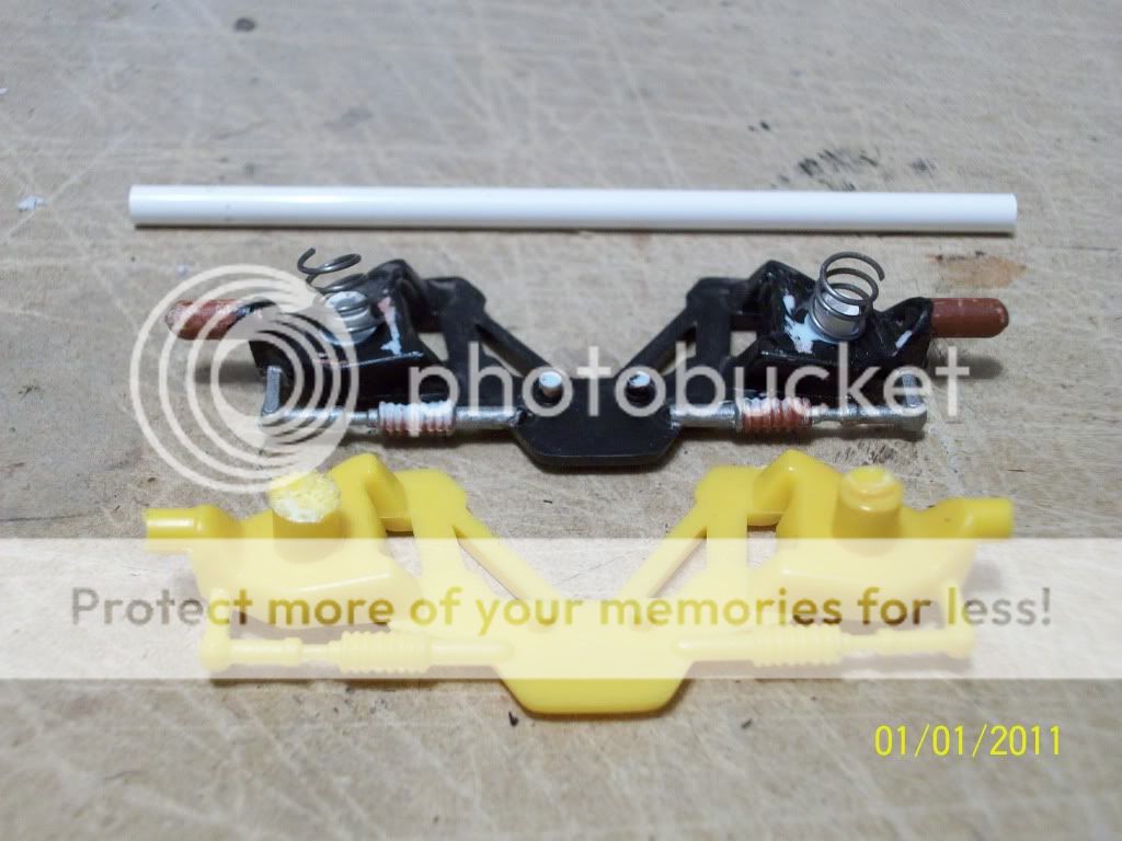

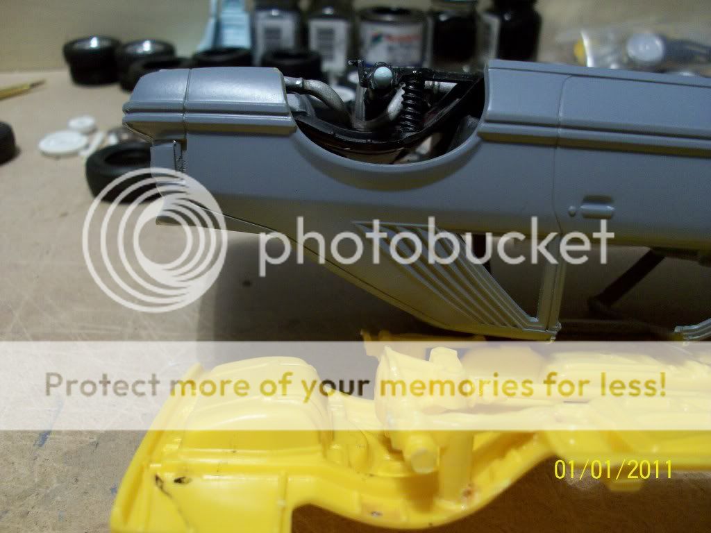

GTMust Posted January 2, 2011 Share Posted January 2, 2011 First of all, I hope everyone had a great holiday and the hangovers and swollen stomachs are settling back to normal! Backyard Billy (AKA GTMust) has being working while we've been playing. The plastic blobs have been replaced with real springs at front and rear. Front and rear shocks still have to be added. (Compare to the stock kit parts) The engine has been installed (minus it's accessories). The motor came from the wrecking yard without an oil pan. Unfortunately Billy didn't realise that the 5.0 Mustang should have a double sump oil pan until after the engine was installed, and he had used one from another 302. He figured it would work just as well so he left it. Work has started on the steering. The completed shaft can't be installed until the body and chassis are finally joined together and painted. Unfortunately Billy broke the windshield header when he removed the original windshield, so additional bodywork will be required in this area. Quote Link to comment Share on other sites More sharing options...

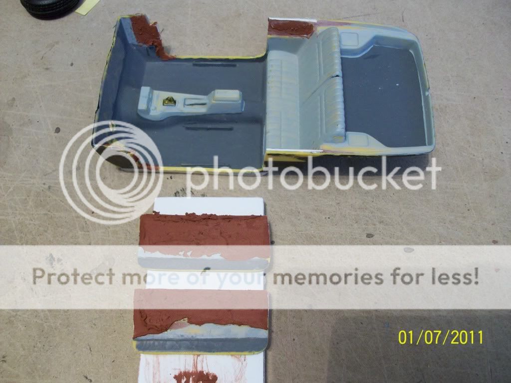

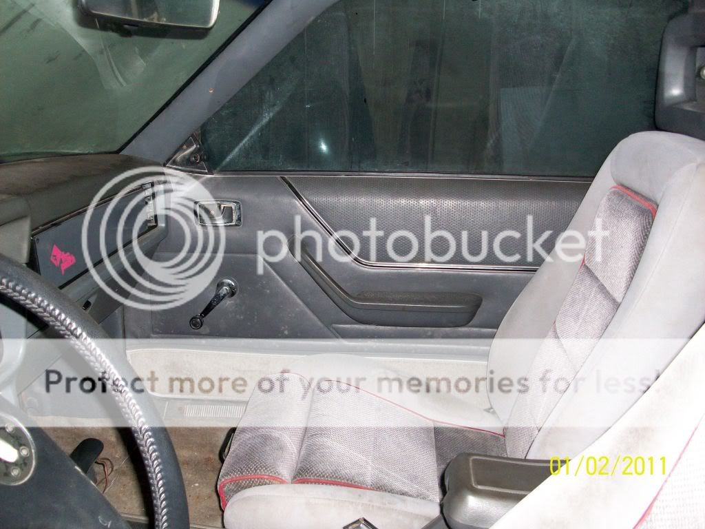

GTMust Posted January 7, 2011 Share Posted January 7, 2011 The interior door panaels on all the Monogram Fox Mustang kits are pretty simplistic and bear little resemblance to the real door panel. The door panel design did change over the years, the earliest being represented (kinda) in the cafe racer kit and almost unchanged in the '93 Cobra kit. Backyard Billy was trying to update his '81 to look like the '85 style...... so the door panel design had to change, especially as the panels can be easily seen though the open T-tops. Here's what the '85 should look like: To update the look of the interior, the inner door panels were removed and the molded detail scraped off. Then 3M auto body filler was laid over the door and the surrounding interior and left to dry. Later I will try(?) to carve some more accurate detail into them. While that was drying, the chassis was given a weathering wash and some aging added to the exhaust sytem. It seems that the 4 cyl, turbo exhaust is the same as the '85 GT except for the Y pipe, at least my 1:1 '85 is. So this was a simple swap. Dual exhausts were perhaps added in late '85 or in '86? Still have the rear shocks and front struts to add. Struts are not included in the kit so I will pirate some from the parts boxes. Quote Link to comment Share on other sites More sharing options...

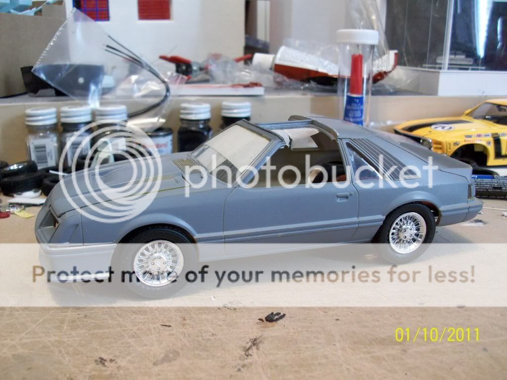

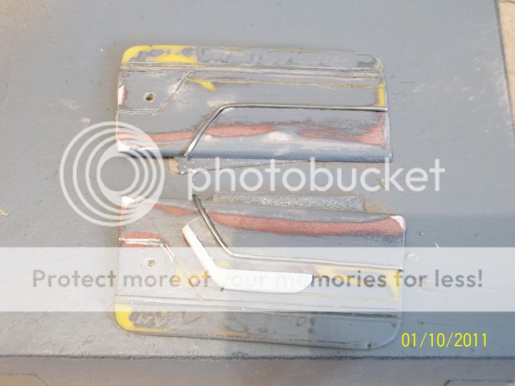

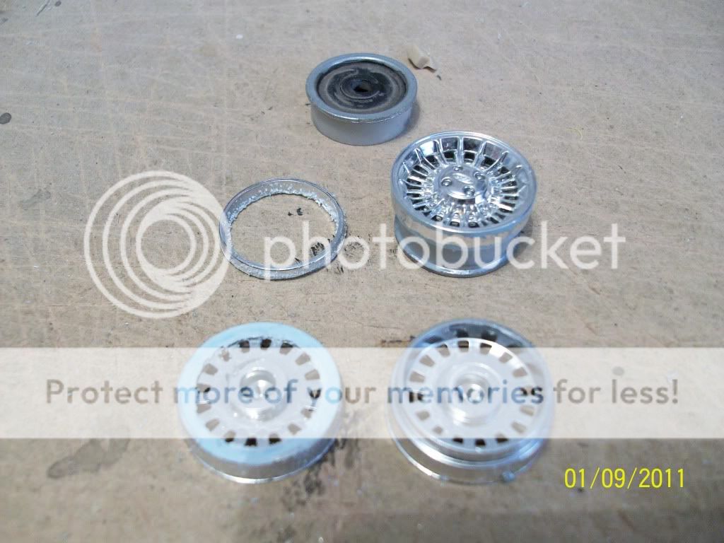

GTMust Posted January 10, 2011 Share Posted January 10, 2011 Another quick update. I have the door panels filled and sanded and pretty much ready for primer. I carved the panels to closely match the photo of the 1:1 door panel and added some solder (dry fit for now) to represent the chrome trim. I have made two armrests, one is shown here and added them to the panel. I've been struggling with what kind of wheels to use. I originally intended to use 5 spoke chrome Cragars, but couldn't find a match in my parts boxes between the rims and suitable tires. I didn't want to use the typical Monogram/Revell no-names, and the only decent looking other tires I had were 14". Then I found a set of Goodyear L60-15's, but they wouldn't fit the Cragars. So I asked Backyard Billy what he used. It appears that Billy still has the car and has been updating it from time to time as cash and his searches through the junyards would allow. But he could never afford to do a five bolt changeover to his brakes so the Cragars were out. Back in the late 80's he found a set of turbine rims from a wrecked '88 GT, thought they looked neat, so he bought them and added them to his car. He also picked up a few more goodies and added those as well. We'll see some of those in future posts. I was able to use the turbine rims from the New Monkees kit, but had to modify them to fit the L-60 tires. I cut them down and attached the rear drum brake to the rim with the tire sandwhiched between. For the front brakes, I dug through my parts box and found some trim rings for the rear of the wheels that were deep enough to work with the cut down turbines. There are round "things" that hold the wheels onto the chassis in the kit, but they didn't work with my new set up, so I cut them up and used the large ring piece as a spacer for the rear wheels... and the tube piece as the spacer for the front wheels. I don't have a picture of this, but it seems to have given me the correct wheel stance that I was lookin for..... basically as a stock Mustang looks with the four bolt turbines. Here's a pic of the car dry fitted to check. Quote Link to comment Share on other sites More sharing options...

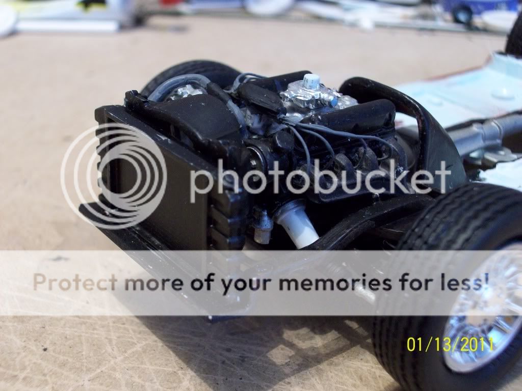

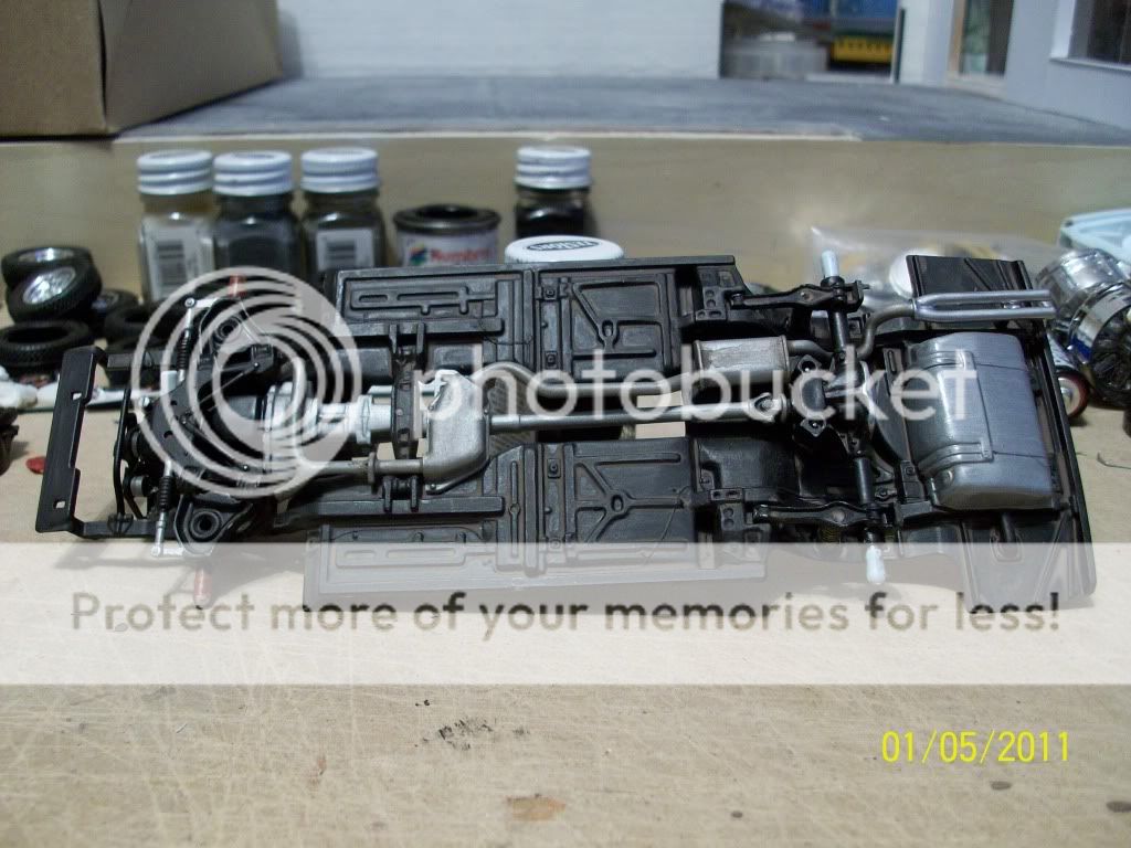

GTMust Posted January 13, 2011 Share Posted January 13, 2011 The 5.0 has been plumbed and wired and installed in the chassis. I'll add heater hoses and finish the wiring after the body is added. Quote Link to comment Share on other sites More sharing options...

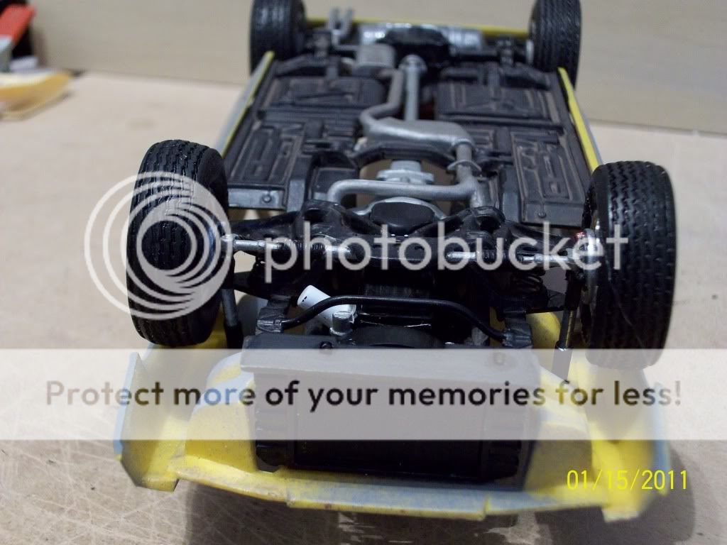

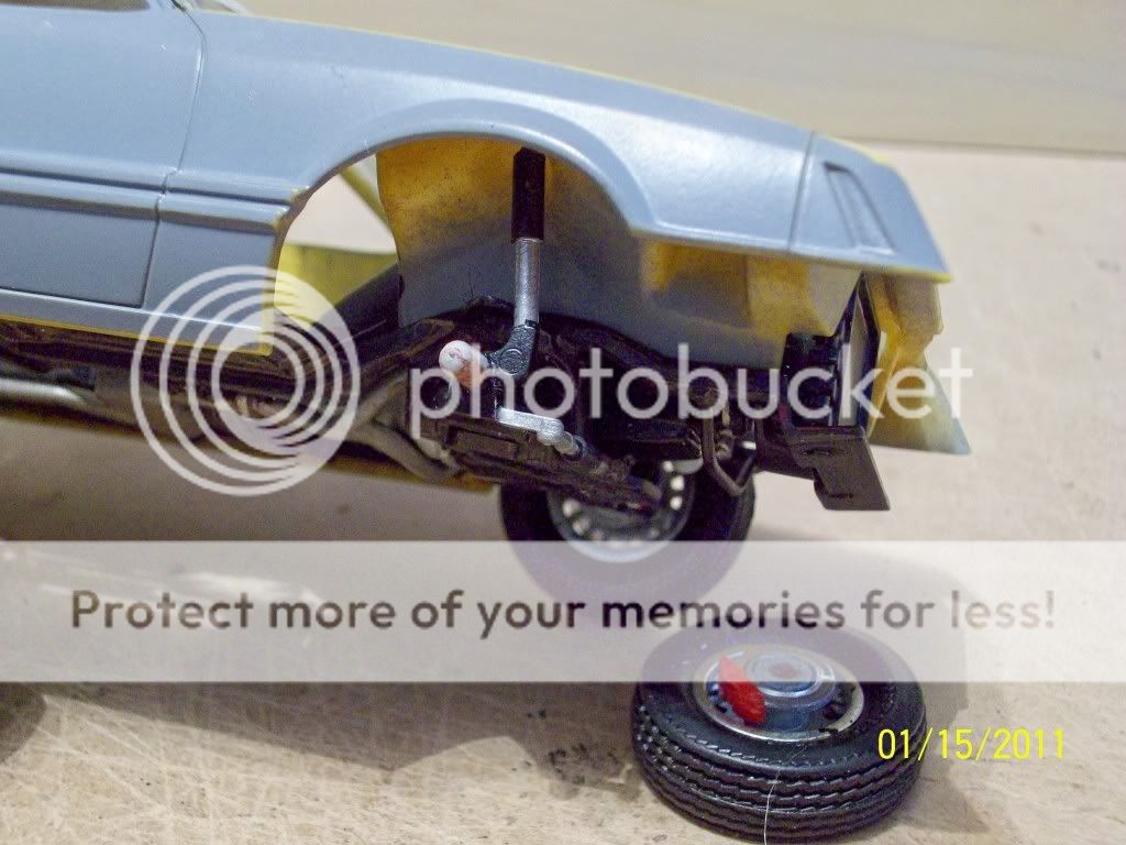

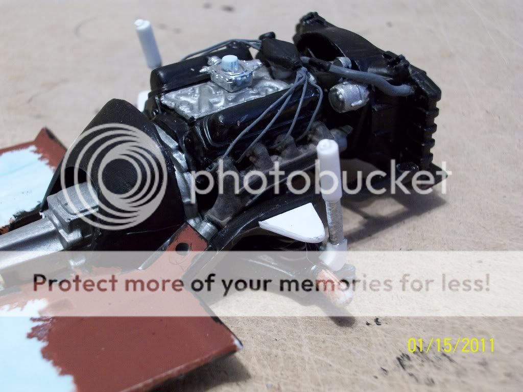

GTMust Posted January 15, 2011 Share Posted January 15, 2011 I'm usually an OOB type builder, but for some reason, this build has taken on a life of it's own. So I had to add some detail to the bare Monogram front suspension (or lack of)! Especially as it can be seen through the open spokes of the turbines. I started by robbing an AMT Chevy van glue bomb of it's shocks and adapting them to act as front struts. Then I added upper control arms to the existing chassis. Front disc brakes came from the Revell 26 Ford T sedan delivery which I am building in another thread and modified to fit. The idea here was to get an indication of the front suspension without going overboard, as most of it will be hidden by the body. Here's some build shots: I still have to extend the front sway bar and add the end links (the kit has the center part of the sway bar but it's not attached to anything. While that was all drying, I test fitted the GT tailight lenses (another of Billy's visual upgrades in the late 80's). Good job I did as they didn't fit! After much cutting, filing and sanding, now they do. Here's a picture of the mods I had to make to the driver's side, before doing the same to the passenger side. With that completed, it's time to turn my attention back to the interior. Stay tooooned....... Quote Link to comment Share on other sites More sharing options...
