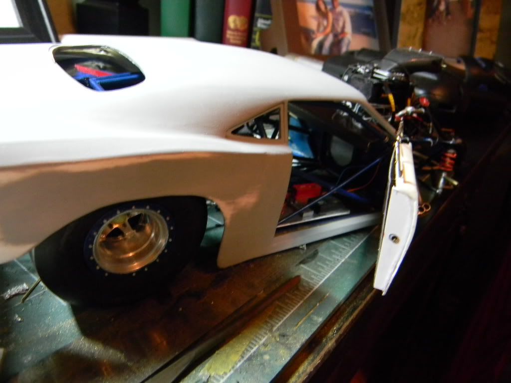

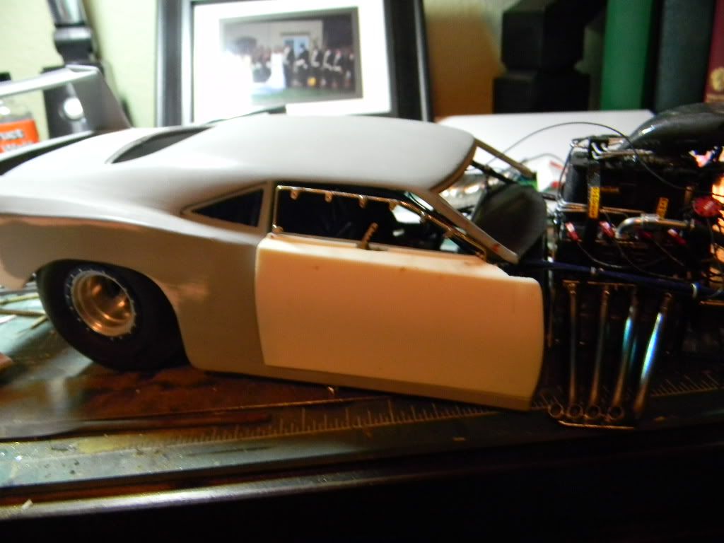

Romell R Posted February 5, 2012 Author Share Posted February 5, 2012 Okay I am confused What are the round pieces sticking out from the frame? Are you going for a not finished car and these are going to be the cleco fasteners? Sorry sometimes I can be a bet slow. Hey Jim the parts that stick out will eventually be mounts for the tabs that hold the window to the frame I made them long so I can cut them to the preciese size so the window will be held at te correct distance from the frame. Quote Link to comment Share on other sites More sharing options...

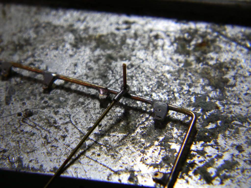

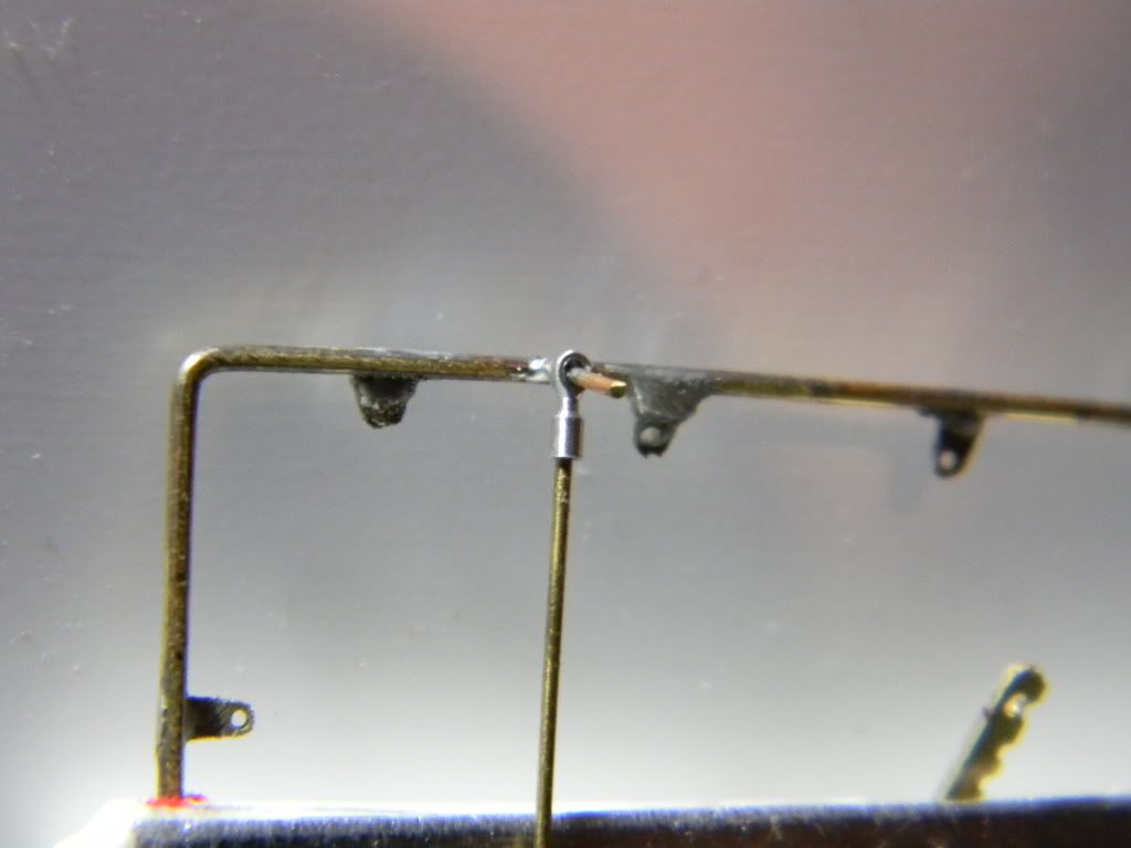

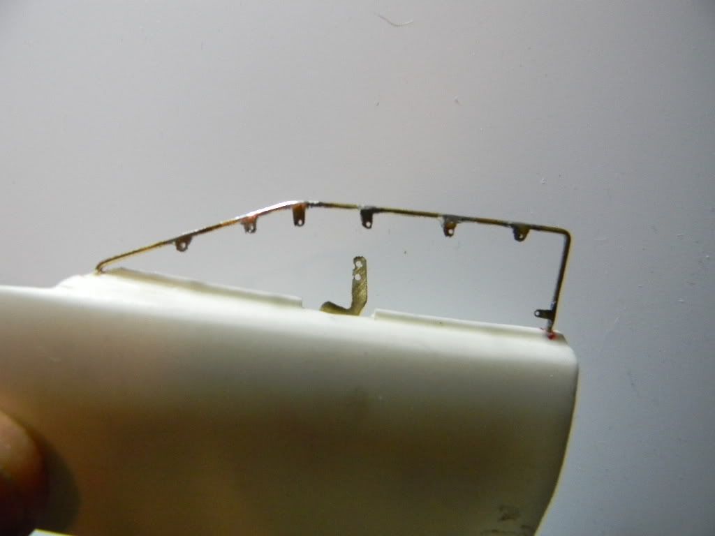

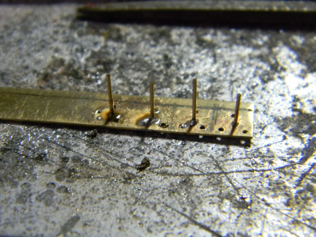

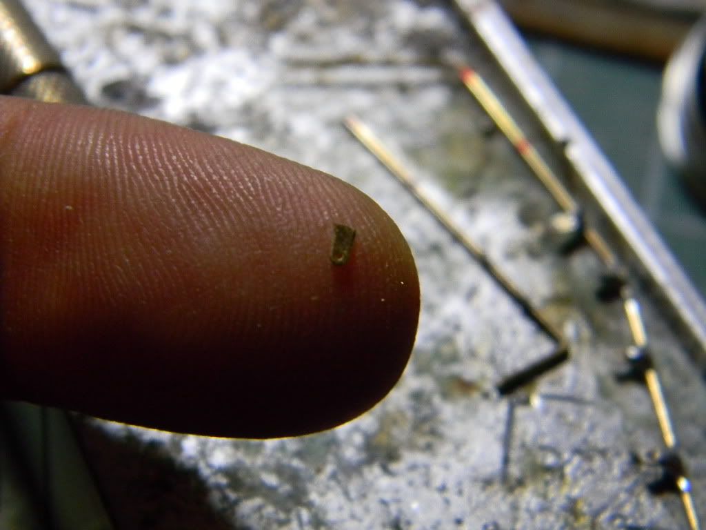

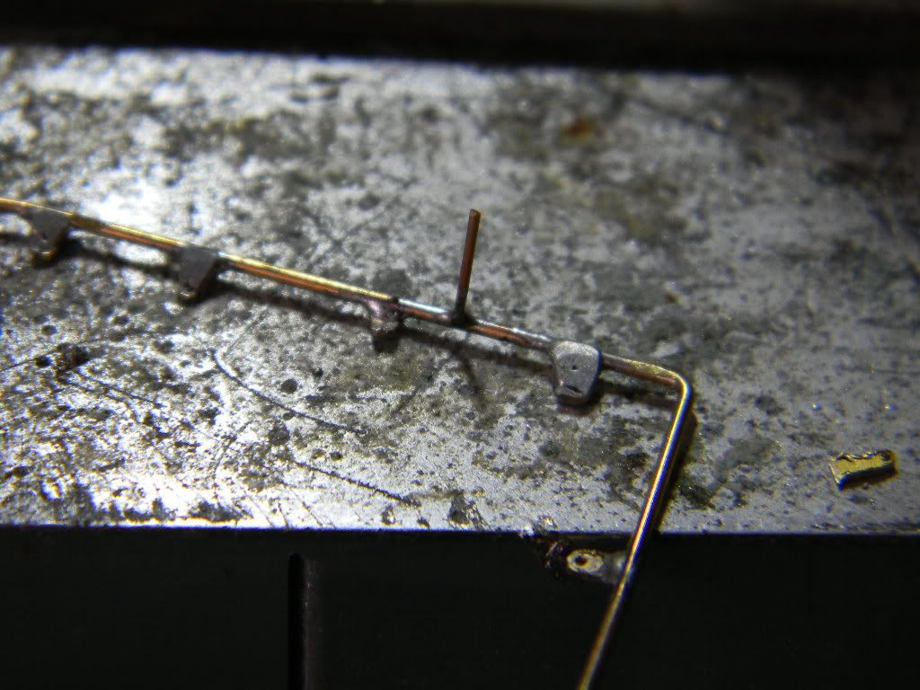

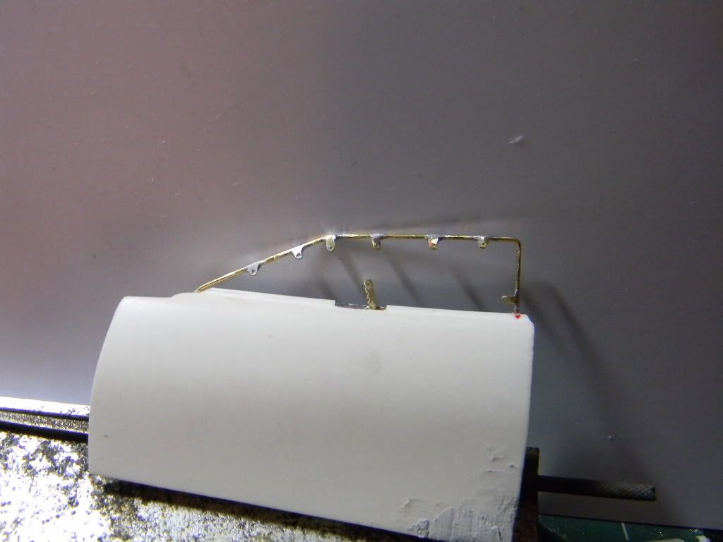

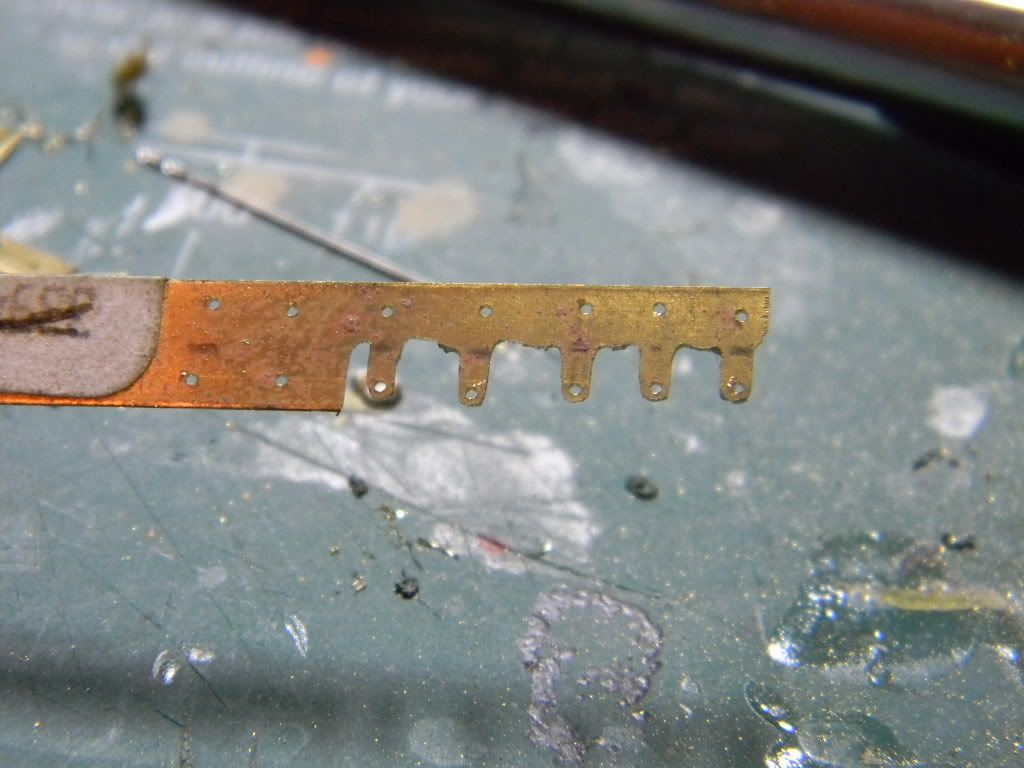

Romell R Posted February 5, 2012 Author Share Posted February 5, 2012 Well today it was back to the drawing board for me. the picture dave provided proved invaluable. and it showed me another way to do my window frames. this will be the last set I do, as this one will be correct once finished. anyway on with the update. I had to make tabs for the window to attach to,... talk about some tedious soldering! but it had to be done. I started by drilling some holes in thin brass with a #61 drill bit then I cut my tabs around the holes this is the size of the tabs I had to solder onto the piece of wire used as the frame. the soldering starts ok I think I can live with this.....but i still have some details to add..... I hope you enjoyed this update. Thx again Dave for all your advice thoughout the project. Quote Link to comment Share on other sites More sharing options...

FASTBACK340 Posted February 5, 2012 Share Posted February 5, 2012 I had to think about the work you did again. Individually soldering those brass tabs that are 1/2 the size of a grain of rice.... Wow... nice job! Quote Link to comment Share on other sites More sharing options...

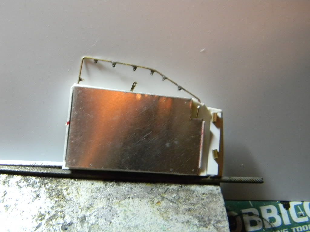

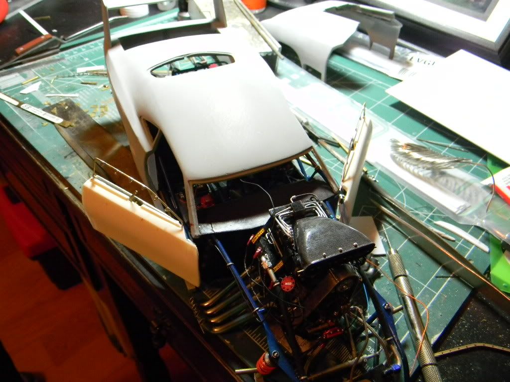

Romell R Posted February 6, 2012 Author Share Posted February 6, 2012 Charlie : sure man we can crank out 1000 more as long as my delivery date can be in the year 2112 LOL! John : they are really small huh....imaging me trying to solder these things ,... now imagine me pulling my hair out with each one LOL! Scott : yeah I dont do good work when i get lazy I needed someone to give me a wake up call so I could get back to business as usual. Thx fellas for your kind compliments. Now I have a small update with the doors partially put together I'll let the pictures do the talking. Thx for joining me again. Quote Link to comment Share on other sites More sharing options...

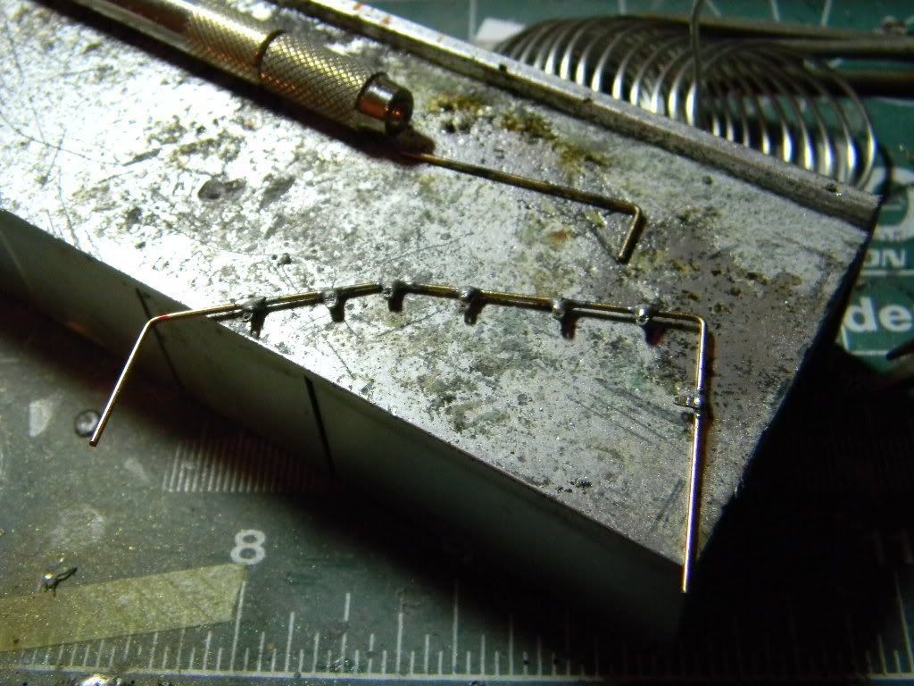

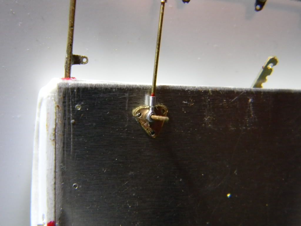

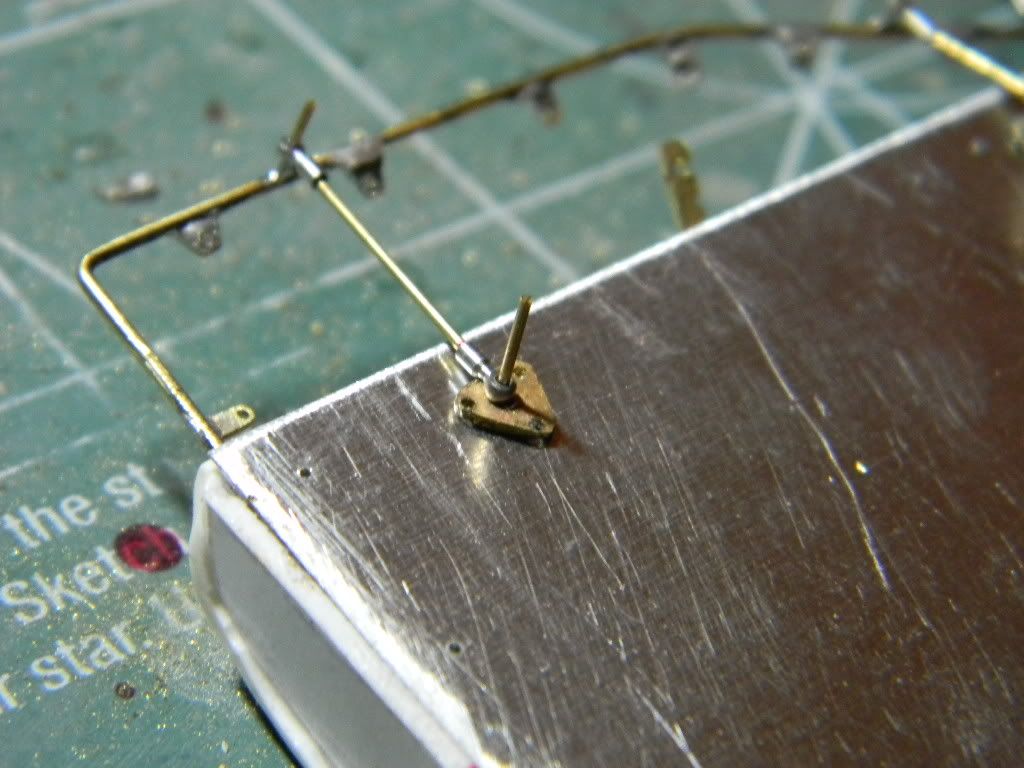

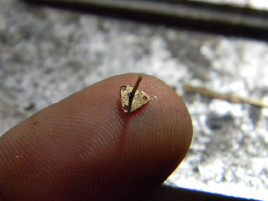

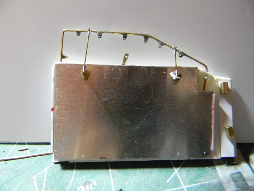

Romell R Posted February 7, 2012 Author Share Posted February 7, 2012 Thx fellas for all the kind comments, Well since Im getting back in the swing of things I thought Id finish the window frames up with one more touch let me know what you think. again i'll let the pics do the talking The rest on the next page....... Quote Link to comment Share on other sites More sharing options...
Romell R Posted February 7, 2012 Author Share Posted February 7, 2012 Heres the rest enjoy! Cya reall soon ....... Quote Link to comment Share on other sites More sharing options...
