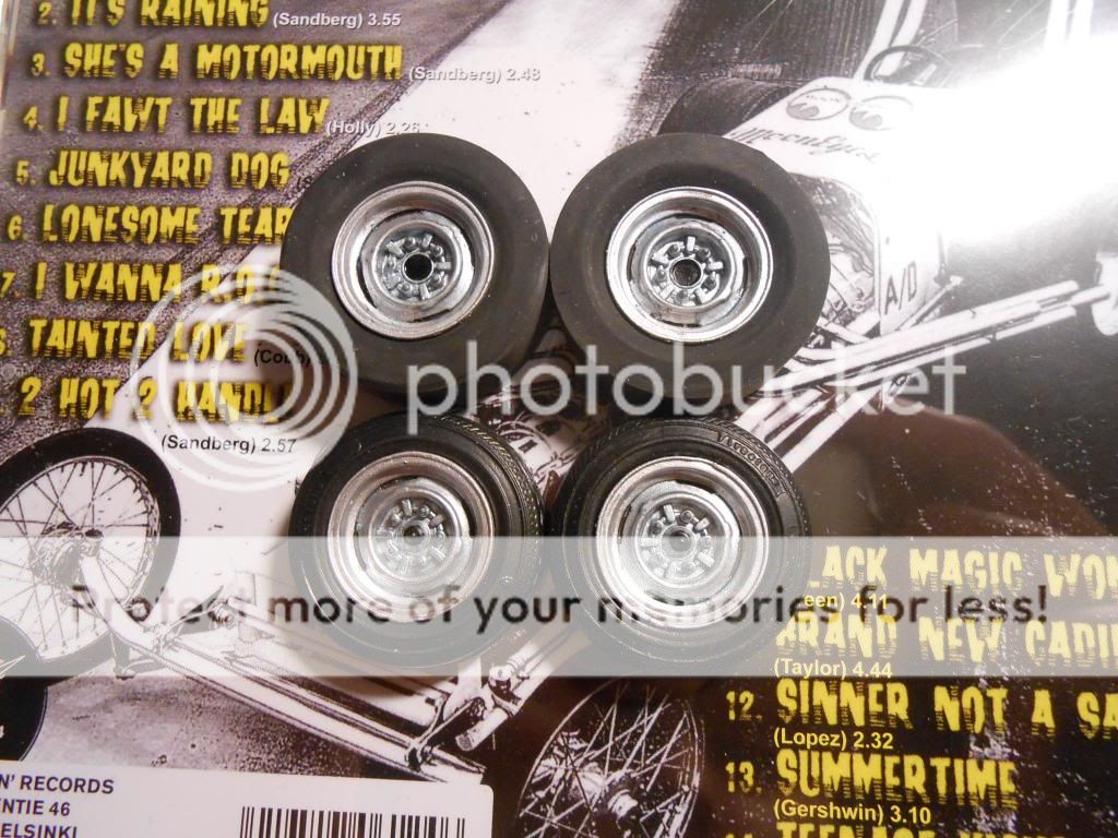

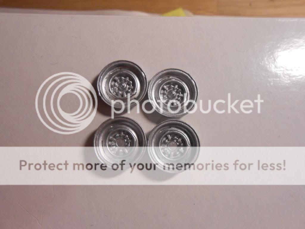

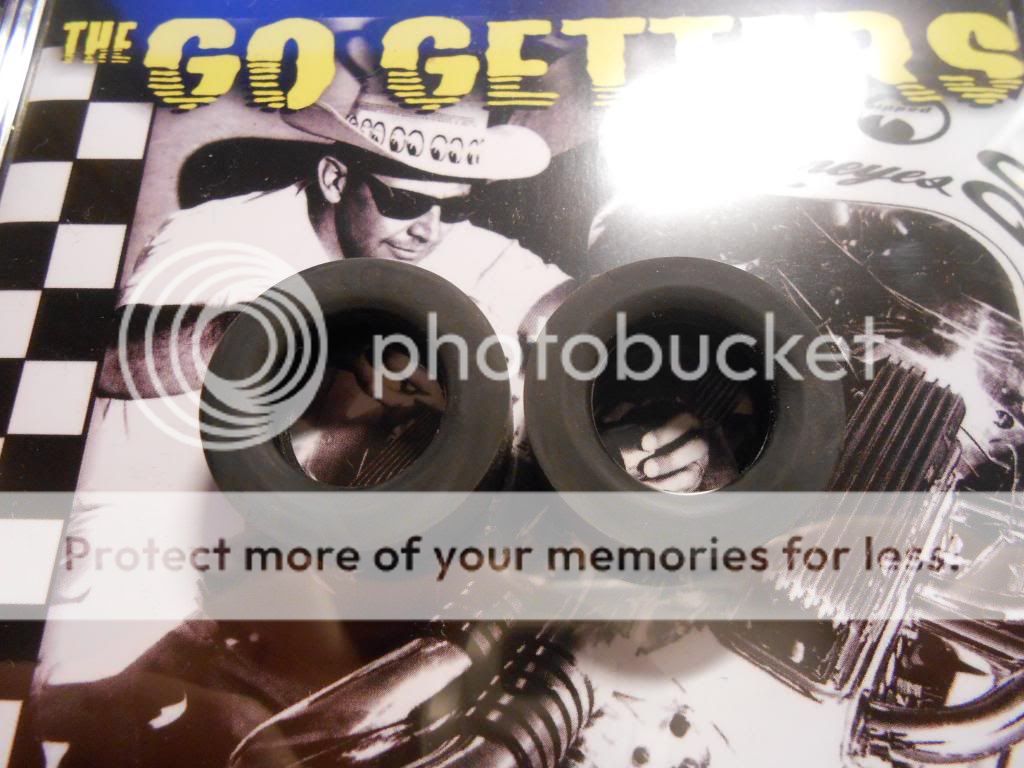

W-409 Posted December 25, 2013 Share Posted December 25, 2013 I have a big bunch of projects on my bench, '62 Impala is waiting for the second clear coat to dry, '50 and '61 Oldsmobile Customs are waiting for paint to dry in the interior parts and then there is a '60 Fury Mild Custom on my bench as well. But this just had to get going. Santa brought this Yesterday and since it is '60s Stocker I started it immediately by searching reference material about this car. I found more information that usually when building something from this era, so I could start building right away. As I already posted on Car Kit Reviews section, my kit (as well as many others) had one Racemaster and one Good Year slick tire. I sanded the tire texts away with a 400 grit sandpaper. Then I sanded the tires up to 1,000 grit and they looked pretty good. I might finish them with 2,000 grit paper, but I'll have to think about that... Then I moved on to the engine. After some sanding and removing mold flash, I glued the block halves together. With some Liquid Glue by Tamiya and sanding, I got the seam smoothed out and then I painted the block and other parts with Humbrol's orange. The wheels were also painted with Humbrol Polished Aluminium. Here are Pictures of the parts trees... Here the first picture shows one sanded tire and other one as it came from the box. The other one shows both tires sanded smooth. Engine and Wheels. And last... One picture of the real car. Quote Link to comment Share on other sites More sharing options...

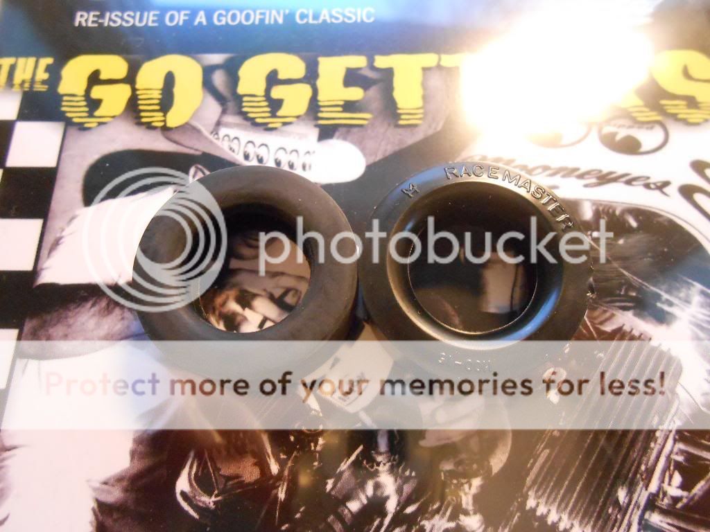

Dragfreak Posted December 25, 2013 Share Posted December 25, 2013 (edited) Got this same kit for Christmas as well, not sure what ill do with her maybe a x275 radial car if I get my hands on a set of some resin drag radials. I'll be following along Niko, nice work so far! -Edit, I just looked and mine has two race masters unlike yours.. Edited December 26, 2013 by Dragfreak Quote Link to comment Share on other sites More sharing options...

slusher Posted December 26, 2013 Share Posted December 26, 2013 Nice start Niko, I like how you did the slicks. I trimmed the letters off a set by using my hobby knife once then sanding. Next time I will just sand... Quote Link to comment Share on other sites More sharing options...
W-409 Posted December 26, 2013 Author Share Posted December 26, 2013 Thanks for the comments Everyone. Steve: This kit seems to be worth buying and building. These Novas are really nice cars. Jason: Looks like many people got this one for Christmas. Drag Radial car would be an interesting one for sure. Of course I'm more Stock Eliminator kind of guy, but whatever you build from it, I know it'll be an incredible build. Two Racemasters...Dang, you had better luck than I did ! Sean: That book might be a good one. I gotta see if I can find it somewhere with a reasonable price. And interesting information, too, something that I didn't know but I read somewhere that this Nova that I'm building had no decals on it, all texts etc were hand painted. Carl: That trimming with a Hobby Knife would have been a good idea. It took some time to get the letters sanded smooth so I think you did it just the right way. Just a minor update. I detailed the wheels today. I started by painting the holes with Revell Flat Black and once that was dry I did two very light black washes for the wheels with black washing liquid from The Detailer. Then I painted the bolts and center caps (What are they called in English?) and test fitted how the wheels fit on the tires. Quote Link to comment Share on other sites More sharing options...

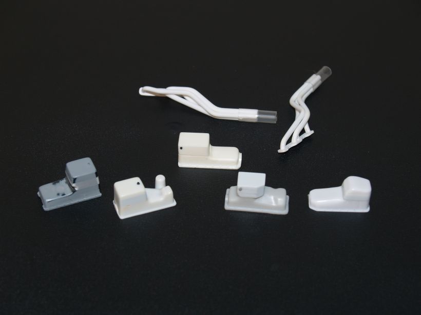

Alan Posted December 26, 2013 Share Posted December 26, 2013 (edited) Here are pics of the deep oil pans I scratched. (Two oil pans on the left) One far left is a Nova rear sump, the other a nova front sump .... As far as the air cleaner base, I vacuformed one, looks really good ..... I also built the fenderwell headers Edited December 26, 2013 by Alan Quote Link to comment Share on other sites More sharing options...

Dragfreak Posted December 27, 2013 Share Posted December 27, 2013 Here are pics of the deep oil pans I scratched. (Two oil pans on the left) One far left is a Nova rear sump, the other a nova front sump .... As far as the air cleaner base, I vacuformed one, looks really good ..... I also built the fenderwell headers How did you make the collectors on the headers? they look perfect! Quote Link to comment Share on other sites More sharing options...
Alan Posted December 27, 2013 Share Posted December 27, 2013 Those headers were for the Mon 70 Road Runner, the collectors are made from juice box straw lol Quote Link to comment Share on other sites More sharing options...

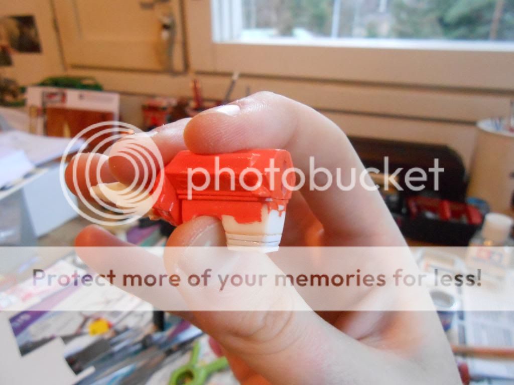

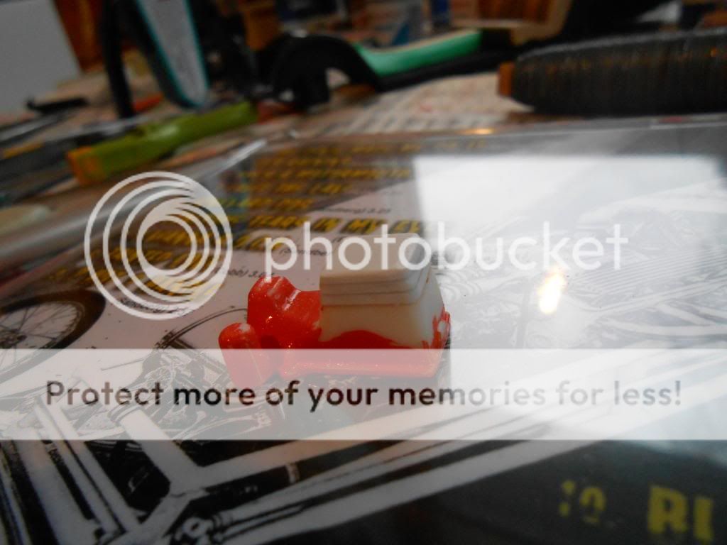

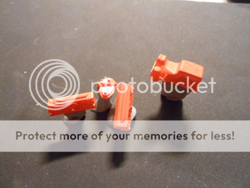

W-409 Posted December 31, 2013 Author Share Posted December 31, 2013 Thanks Guys. Just a little update on this one, I started working with the Oil Pan. It is still in rough stages, but it's getting there. I just put three pieces of sheet styrene on the bottom of that oil pan. Maybe not the best way to do this, but it is definitely the easiest. Next step is to add a little putty and sand it smooth, then I can paint and glue it on place and start working with the headers. Quote Link to comment Share on other sites More sharing options...

garryrenfro Posted January 2, 2014 Share Posted January 2, 2014 (edited) He also ran an extremely tall front tire ................ The kit slicks are also way too wide - should be 7 inchers. Speed City Resin makes some really nice M & H Racemaster 7" Cheater Slicks. The Lindberg '61 Impala Super Stock has the proper size Goodyear tire, and many of the mid-60's AMT Trophy Series kits had nice 7" Firestone slicks. There are probably other current kit sources available that I do not know. Edited January 2, 2014 by garryrenfro Quote Link to comment Share on other sites More sharing options...
W-409 Posted January 2, 2014 Author Share Posted January 2, 2014 Thanks Fellas, lots of great information here! Jim: You're not late at all, I have to repaint that engine anyway after modifying that oil pan, so color change shouldn't be a big thing. I think I'll go with flat black from spray can, that works very well at least. Heh, that battery thing can still be seen in today's Stockers and Super Stockers, that's another detail I need to concentrate on when I'm at that point. Thanks for the great info, I'll do my best to replicate these things in 1/25 scale. Håkan: That white fuel tank would be a neat little detail on this build. I guess if no-one proves that the fuel tank wasn't white, I'll paint it with Tamiya's Gloss White paint....Thanks! Garry: Yep 7" Cheater Slicks were the only legal tires in these classes, and I remember reading from a Junior Stock Book that the tires grew to 7½ inches after a few runs. That is one problem, you're right, but I test fitted a pair of those tires inside the Nova body and somehow I think it doesn't look as good as it does with these. I think I'll go with the kit rear tires, but I'm not completely sure yet... Quote Link to comment Share on other sites More sharing options...

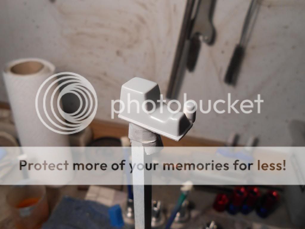

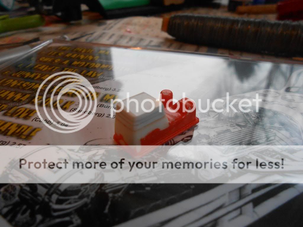

W-409 Posted January 20, 2014 Author Share Posted January 20, 2014 Thanks Guys! Well, not sure about the fast way with the Oil Pan... I still need some putty for that oil pan, but it was primered a while ago and I took the picture that day, but looks like I never posted it. So this is the first Primer coat, and still more putty is needed. Quote Link to comment Share on other sites More sharing options...
