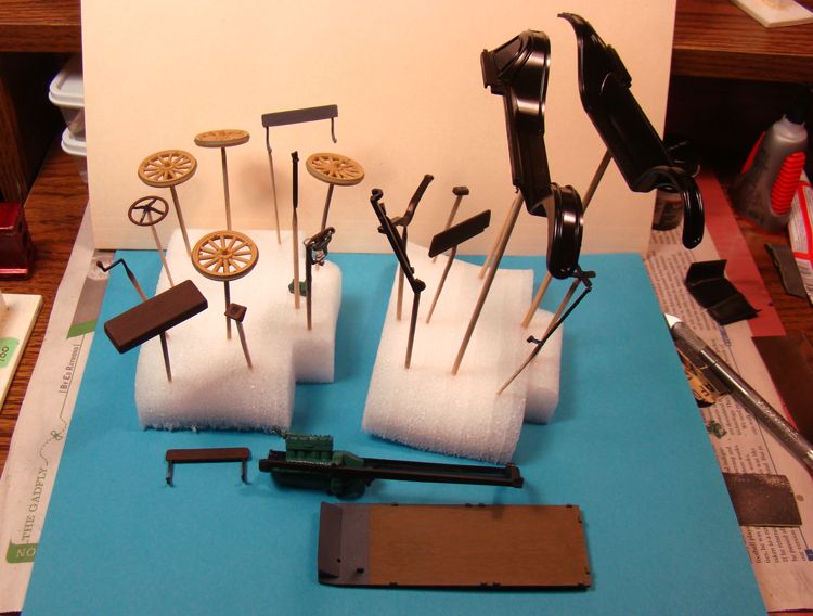

I started it around the holidays and until now it may be the most enjoyable model I've built. Like the times it represents, the kit is uncomplicated (65 parts), goes together well but is not perfect. It's essentially the same tooling as the other classic old AMT Model T offerings but with the box van body. I love the wheels but was disappointed with the alignment and offset of the spoke halves.

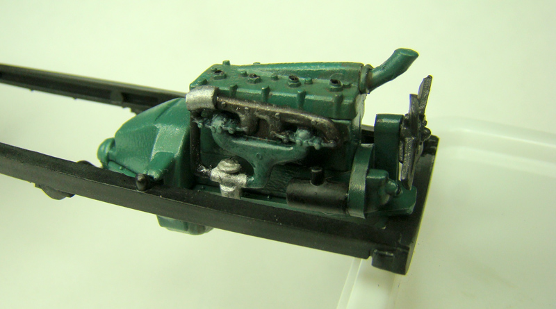

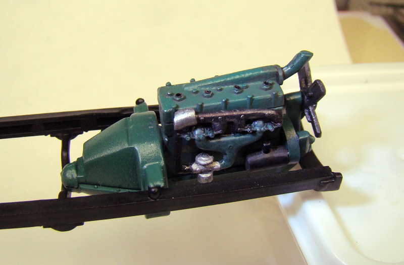

The engine is a delight. Detail is decent but, like the rest of the kit, prefitting is mandatory because many pieces don't have obvious contact points so alignment is "best guess" which can bite you five steps later.
The paint I bought for engine color was a let down so I ended up mixing my own grey/green, which was a lucky accident because it was closer to the color I wanted. Photo lighting doesn't bring that out well though.

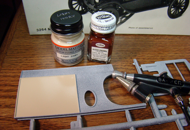

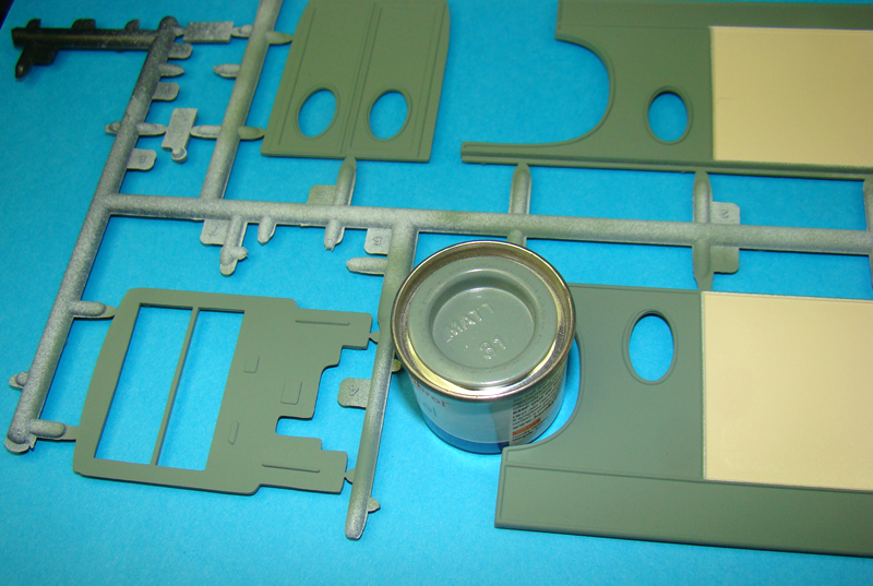

I wanted the body to be grey/green with and antique ivory billboard. To get the light color I mixed some brown into the Ivory and airbrushed.
The cap of the grey/green Humbrol paint looked exactly how I wanted the body color, but was pretty disappointed with how green it came out. Cap had probably faded from sitting on the LHS shelf but I'm forging ahead. I also failed to notice it's a flat color, but that too may be a happy accident.

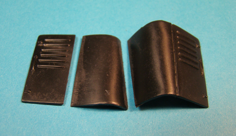

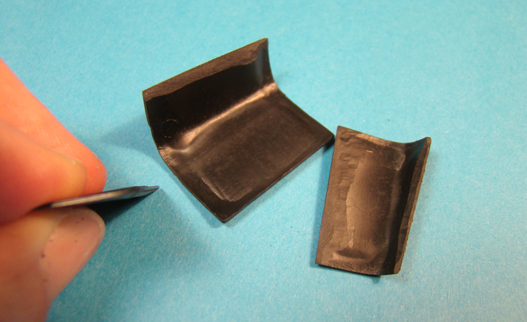

I want the hood to be displayed open so I cut it at the hinge marks on the right side. I gotta admit I love the surface texture and am considering not painting it.
Then shaved the contacting edges so they can be glued in the open position without looking fat and clunky.

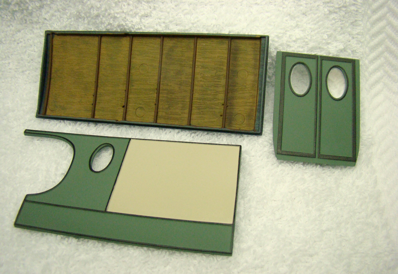

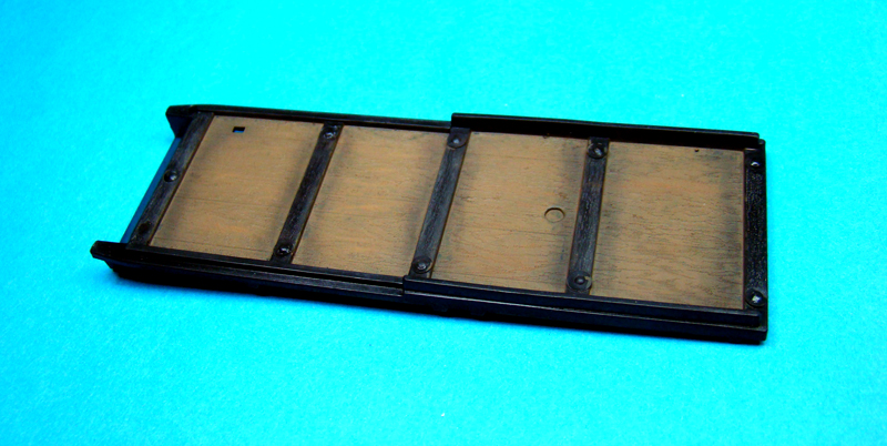

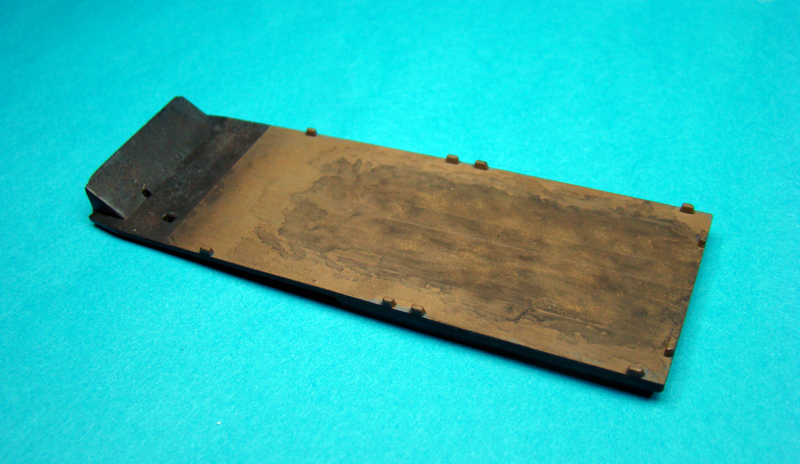

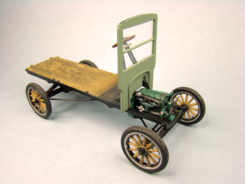

I know most of this deck bed will never be seen once it's inside the box, but I took great delight in weathering it. For one, I need the practice using Vallejo washes and pastel chalks, and secondly I like the molded texture, justing waiting to be brought to life. I imagine this is what it might have looked like in the spring of '24 after the thaw.
The underside is no exception. Fun to detail. I apologize for the annoying blue bkgnd on some of my photos but my camera color balances to that better than white.
Edited by Lunajammer
The wheels took me several evenings. They were airbrushed with Model Master Wood, as seen in a previous photo. The rims were painted black around all the spokes, then the retaining rings painted flat silver. Lastly they were weathered using Vallejo washes and chalk pastels.

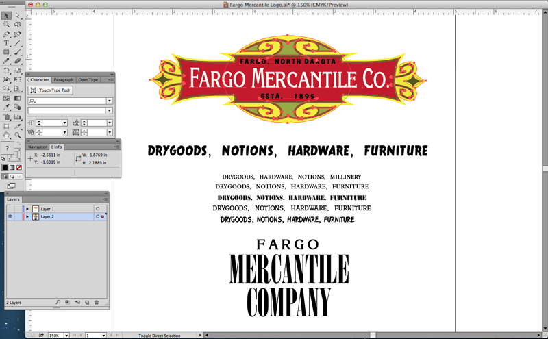

Here is a screenshot of the decal I'm making to go on the side. The logo is inspired by a piece of a label I found through some archival info put on the net by the Institute for Regional Studies at NDSU. I recreated it in Adobe Illustrator. Logo fonts are not exact to the hand lettering of the original but should be period appropriate.

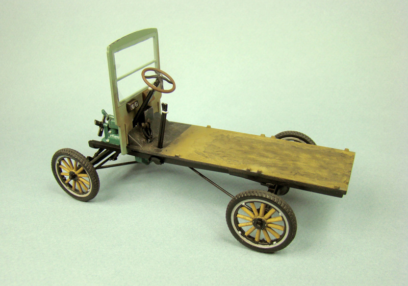

The chassis pieces have come together and it's got its shoes on. The kit windshield, like most kit glass, is about three scale inches thick. Really disrupts the believability of the rest so since the front is such a flat piece, replacing it with clear plastic sheet was a no brainer.
I also tried to continue with the chalk pastel weathering up the front panel.
I love that decal Mike! Remember that you cannot print white, if you are using an inkjet. So you would see the green of the body there. One way of doing it is to either put a blank white decal behind it, or mask off and paint the area behind the decal white. You'd want to do a test to see how the yellow holds up as well.
Never mind... I just scrolled back up to your photos and it seems you have made that panel white!
Edited by Tom Geiger
Yeah, I had clear decal paper in mind when I laid my plans. I just hope my "antique" white isn't too tan. I guess we'll know after I get my hands on some BMF laser paper. I have some old Microscale stuff but it seems to have gotten brittle.

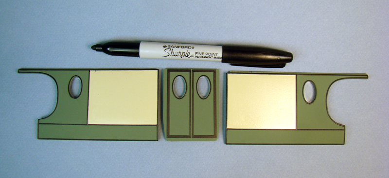

I didn't relish the idea of masking around all the trim work to paint it black, but I started doing so using BMF for masking. I didn't get far before stopping and re-thinking it for a better way.
After some testing I chose to use a Sharpie. It actually worked better than I expected. The finish was decent semi gloss and gave me razor straight lines. The only downside is you can't ink all the way down to the groove.

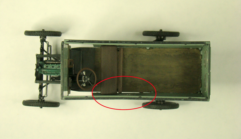

This is where the project lost its luster. In all my fine detailing I failed to take notice of how warped the body sides were until I was assembling the finished panels. It's creating problems with the fit of the floor, roof, and front panel and created a noticeable gap at the floor.
Really disheartening because it's my own fault for not paying closer attention and its too far along to find the will to backtrack and correct it. I think the overall piece will view fine since the faults are mostly out of sight.
when the roof is on and sides lettered, i don't think it will jump out at the viewer.
superb job on the wheels, too.
if the tire treads are directional, the front passenger may need to be flipped. these old tired (!) eyes can't tell from here.
Edited by southpier

Don't give up - you've done a great job! Don't know exactly what fit problems you are having, but you could use some thin Evergreen strip to "shim", or Tamiya tape to hold things together to correct them. I noticed that you had a regular nib Sharpie. I don't know if an ultra fine nib would allow you to get "all the way into the groove" as you mentioned earlier. Just a thought...
Ooooh, good eye. I hadn't noticed that they might be directional but they sure like it in the pic. Thanks for the catch, I'll look again.
Mike - Be careful with the Sharpie. Don't clear coat / dull cote etc over it. It will melt into the clear. Ask me how I know!
I have a narrow tip in my tools, but it's the side of the large nib that draws the lines. I suppose a guy could sharpen a narrow Sharpie to get into the crevasses.
Thanks for the overcoat warning Tom. I don't think I have to ask. ;)
I made my decals on the printer at work. Unfortunately, in the name of haste, I bought the Microscale decal sheet from our LHS. It's all they carried and I didn't want to wait for BMF decal sheets for this project. So far so good, of course I haven't transferred it yet.

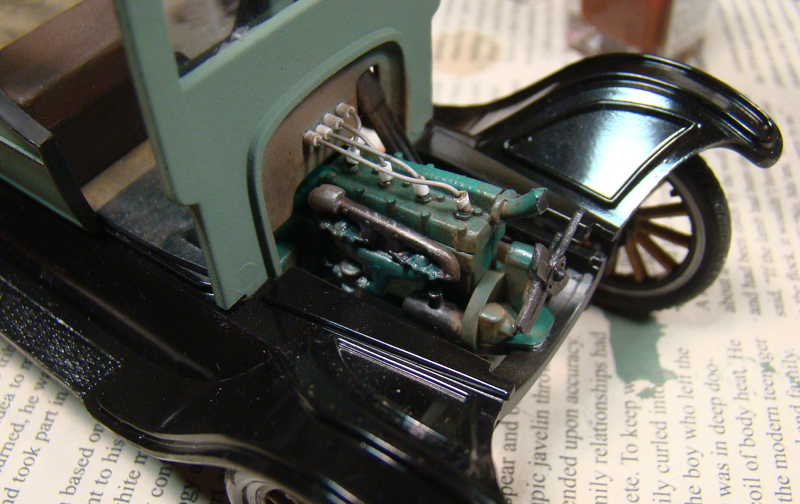

This weekend I wired the engine. Meh. <_< Could be better, but I'm forging ahead. You can tell I also got the fenders on.
